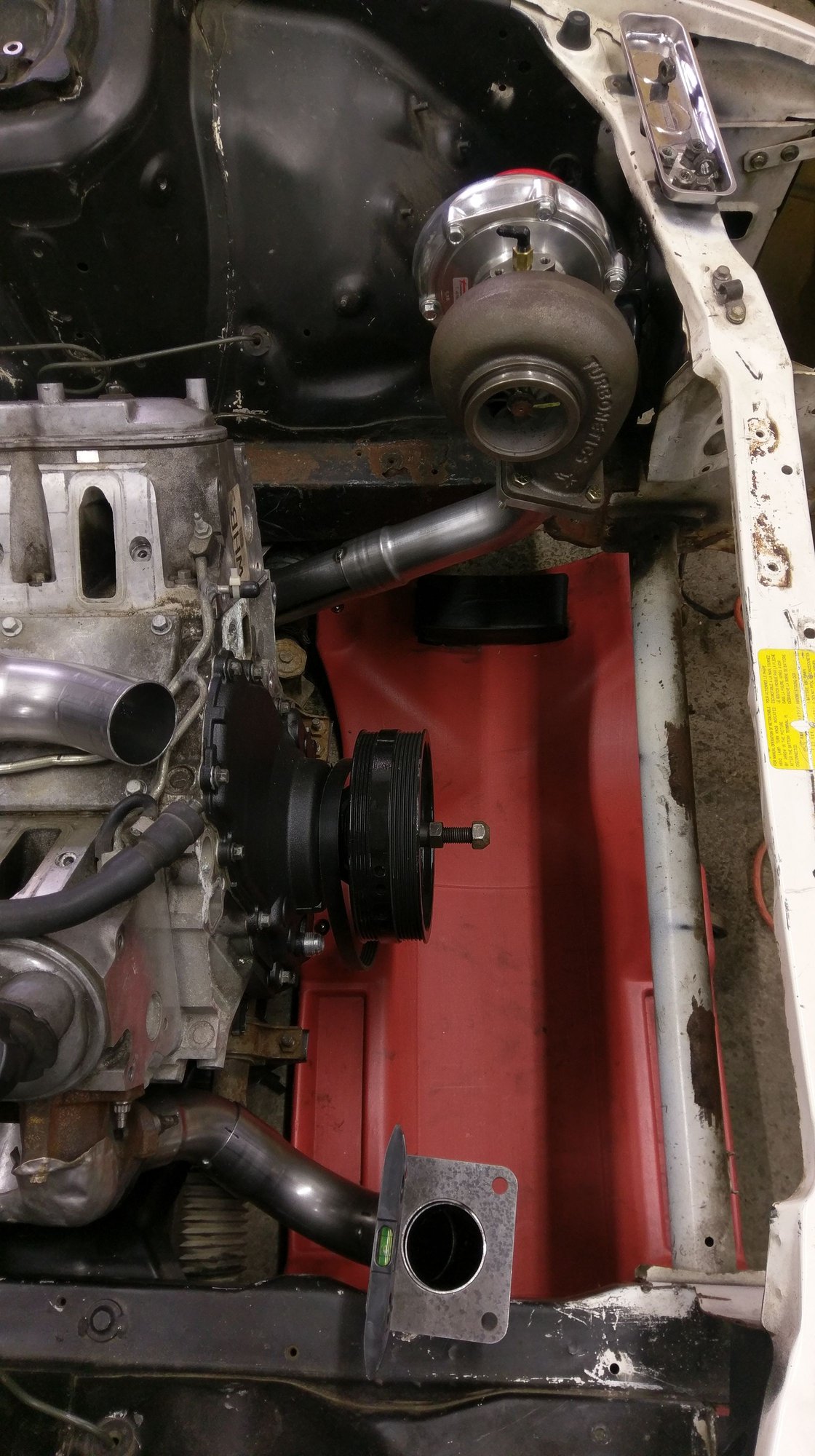

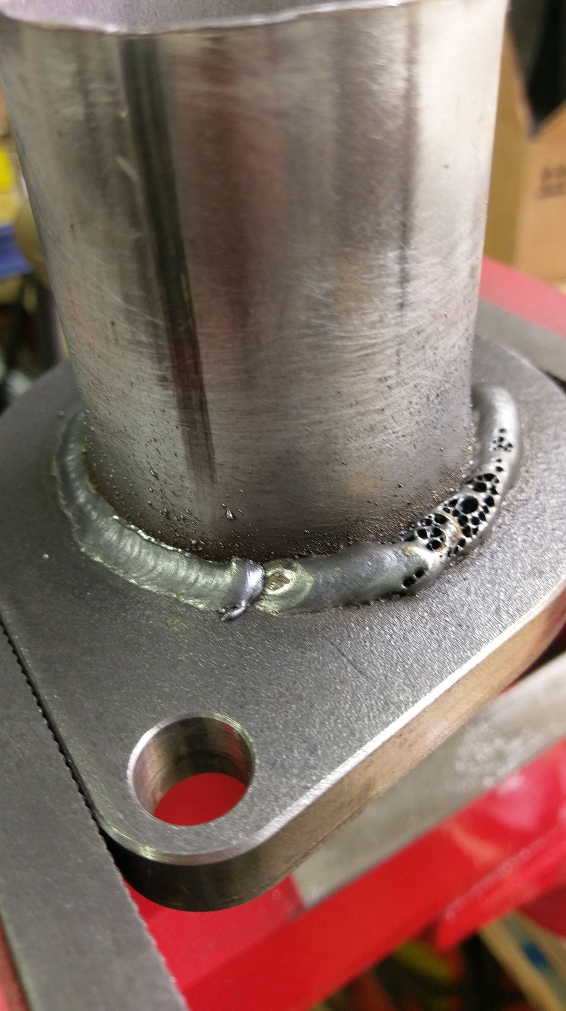

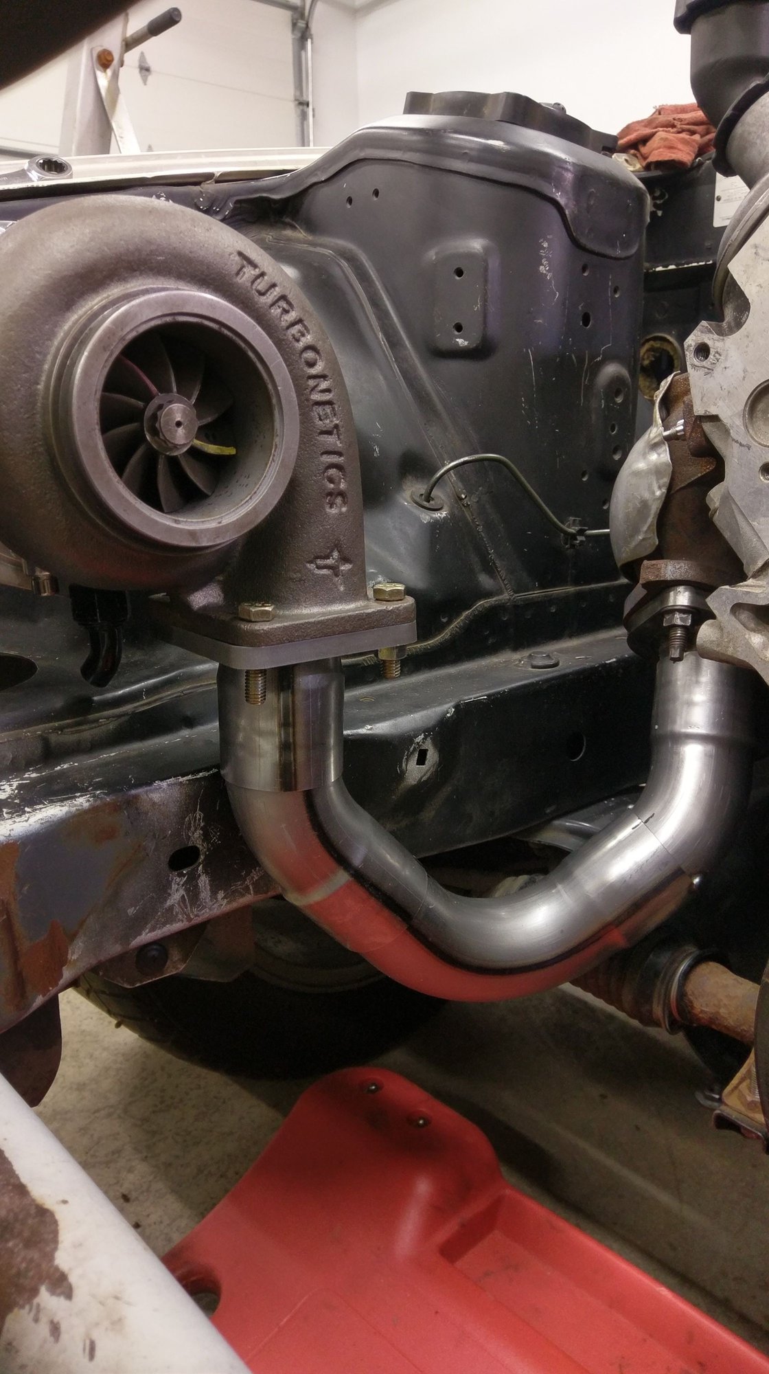

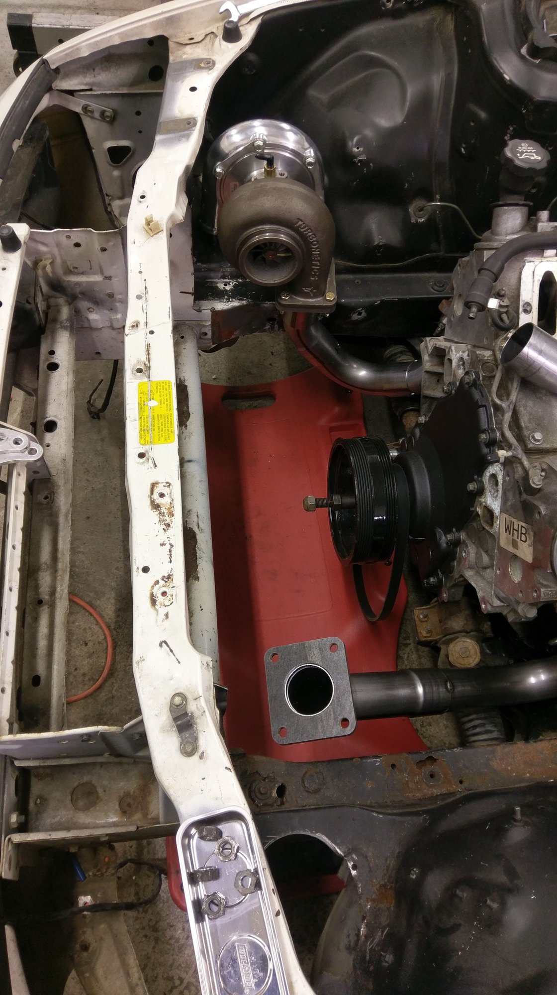

16gauge mild steel. I used a pipe expander so I could slip fit for strength and ease of placement and fitment. Slip fitting the pipes allows for easy placement and slight error adjustment of locating. Plus with the expander, I'm able to place the tube into all the flanges and expand it into the flange for a nice tight fit and easy clean weld.
Not to mention, it's way easier to weld a lap joint with a MIG, than a butt joint.
Just some 2.25" OD 16g mild steel, 90° and 45° bends from Columbia River mandrel bends. I'm using a MIG, I have a TIG but I'm not as comfortable with it. Only time I will have to change wire (309L .030" solid wire) is when I weld the 304ss wastegate flanges onto the 1.88 and 1.75" mild steel tube.

The cool thing about expanding the pipe for a slip fit joint is the ability to extend and retract the joints, as well as twist them as needed, all while it's held in position to get the best location possible. Slip fit provides built in error adjustment without tacking and re-doing everything a hundred times like a with a butt joint.
Personally I wish I could have found some 12g or 14g steel for more piece of mind.
For anyone looking, I used Lisle 17350 pipe stretcher kit off of amazon. It's a good kit and does up to 3.5" tube.
Oh and hot-dip galvanizing is only good for about 380°F before it flakes off completely. Aluminizing is good for almost 1500°F.
