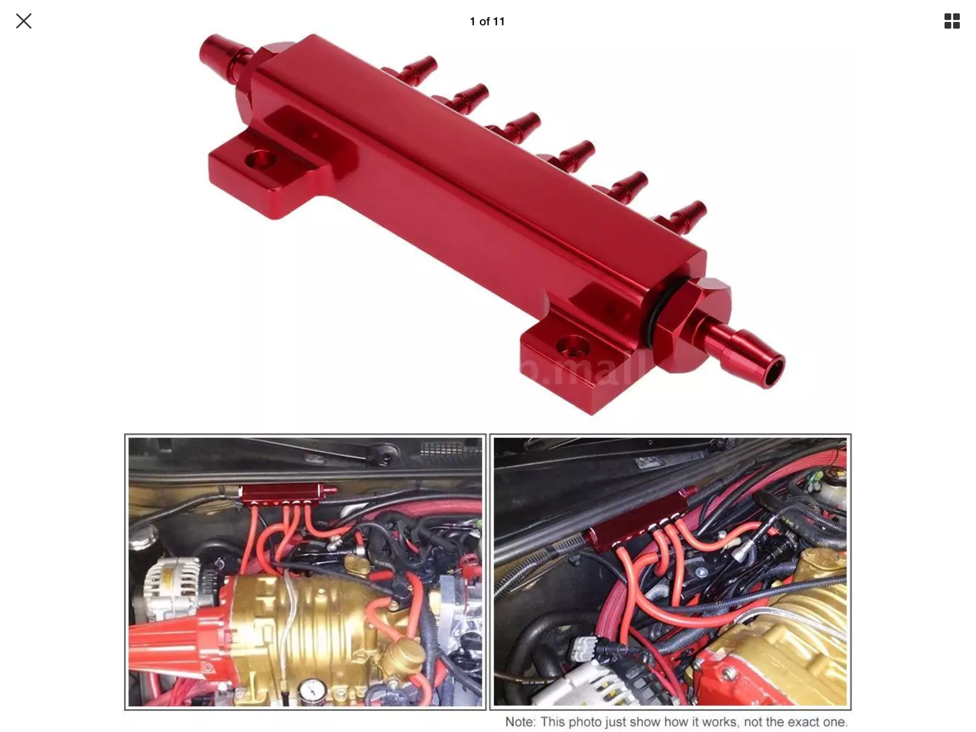

Hi guys , I'm sorry if this sounds stupid but I'm trying to figure out how to install a Hobb switch for my water pump on a air to water intercooler. I know the Hobb switch is triggered by a boost reading for example 4psi , I read that I can install this switch on my intake vacuum source (vacuum manifold) , doesn't this read vacuum ? Which is the opposite of pressure ? This is where I'm getting confused. I also need to understand where the boost gauge gets its signal. I know this is a stupid question but thanks in advance

"vacuum" source, is just a name for manifold pressure source. It's one in the same, a source that references the absolute pressure in the manifold, whether it be in vacuum or positive pressure.

So back to the Hobb switch, I can hook it up anywhere on my vacuum log?

yep that is a fine place to connect it
