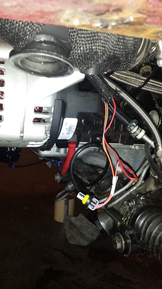

I finally got most my holley system in but have a question about the dome sensor.Can I tap into one of my other sensors like fuel or temp for the 5v and ground instead of going back to the ecu with them.And any suggestions on a good laptop for tunning with

You can tap the 5v ref. off anything.
