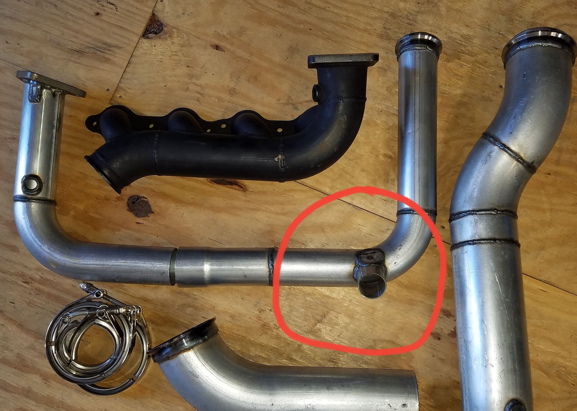

Terrible wastegate location but i guess it works great for hundreds of people using this kit

That does seem a bit inadequate for a single 44mm gate with a small turbo.

I would guess that location was just on the edge of inadequate, and the addition of the tailpipe did it-on the KB Racing manifold I put my wastegate right at the bend where it goes up to the turbo.
At the very least in its current location I would have angled the pipe in the direction of the flow. Pull the tailpipe and see if its back to normal.

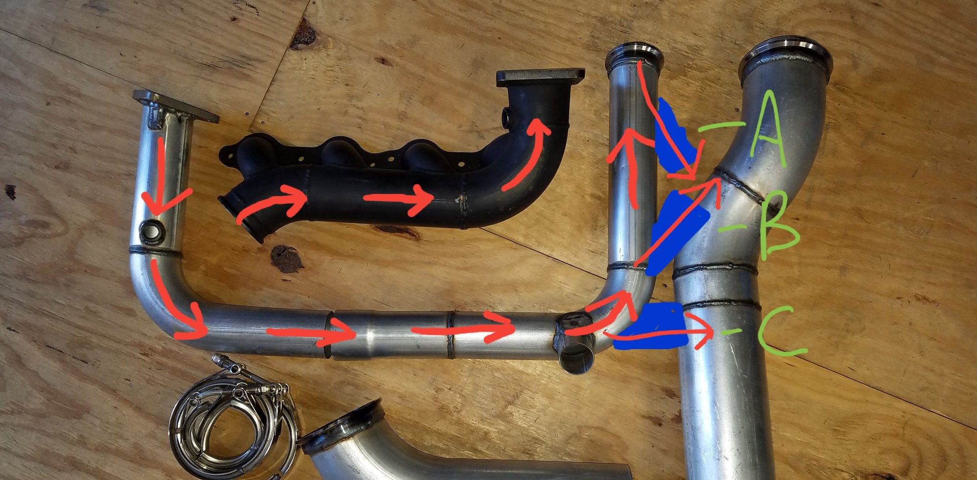

The size and priority (or lack thereof) of your wg appear to be what's causing the issue. If you did like mentioned above and locate it at the bend going up to the turbo, it would probably do better. Or you could do like denmah and others and locate the wg on the exhaust housing of the turbo.

Just to be clear on the wastegate flow.. A, B or C? I'd say C
