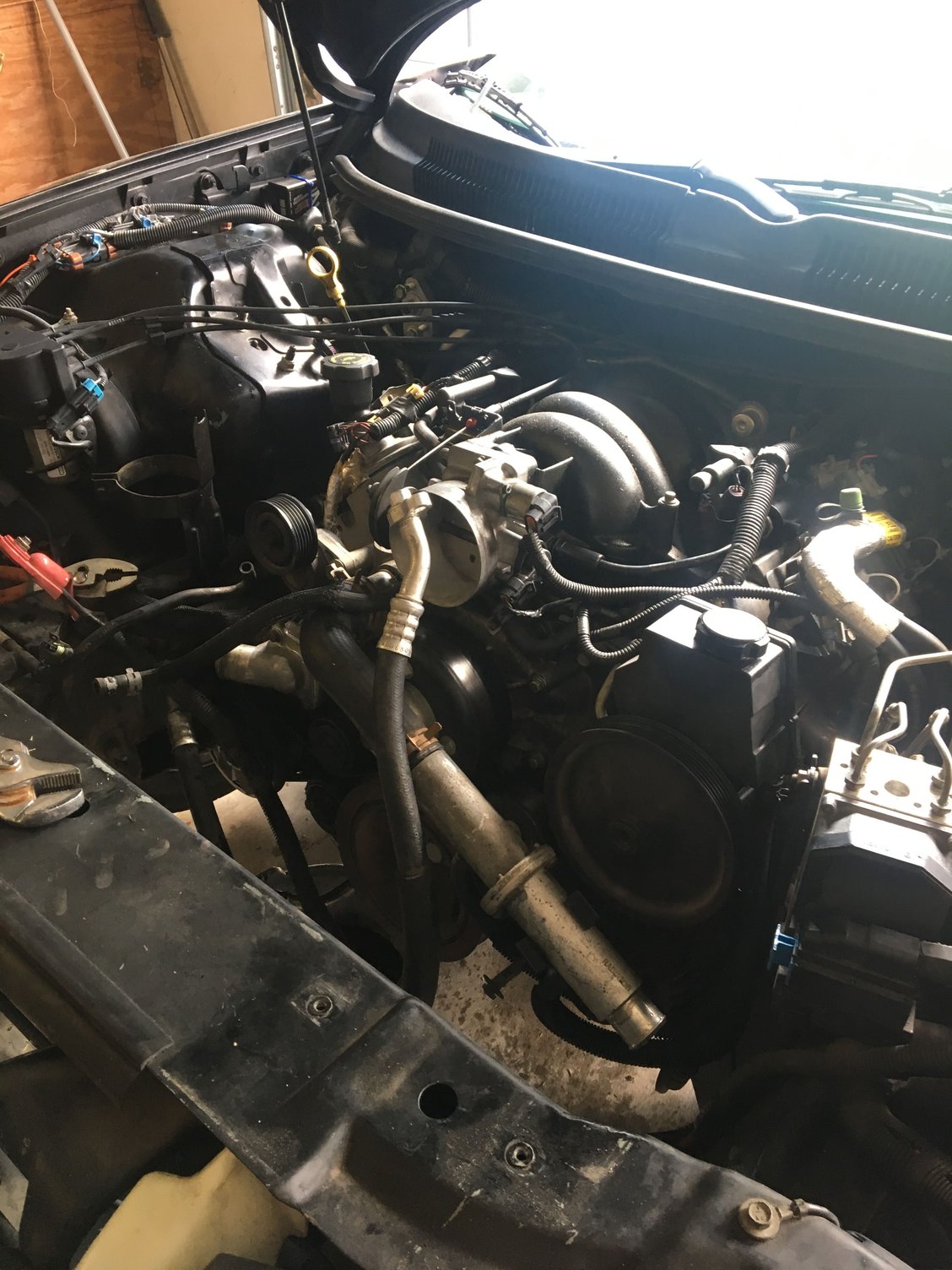

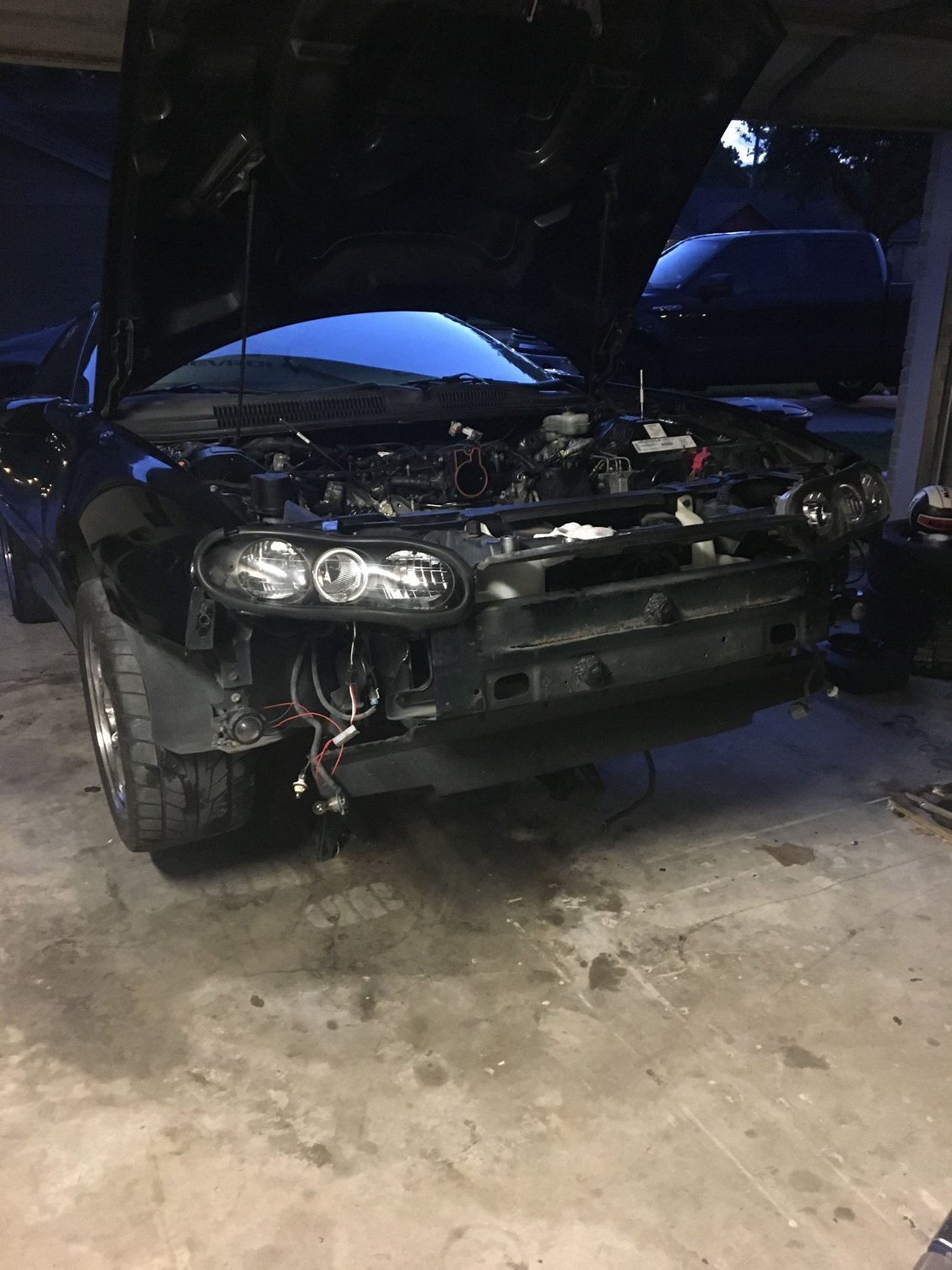

Pulled the ac and radiator out making room

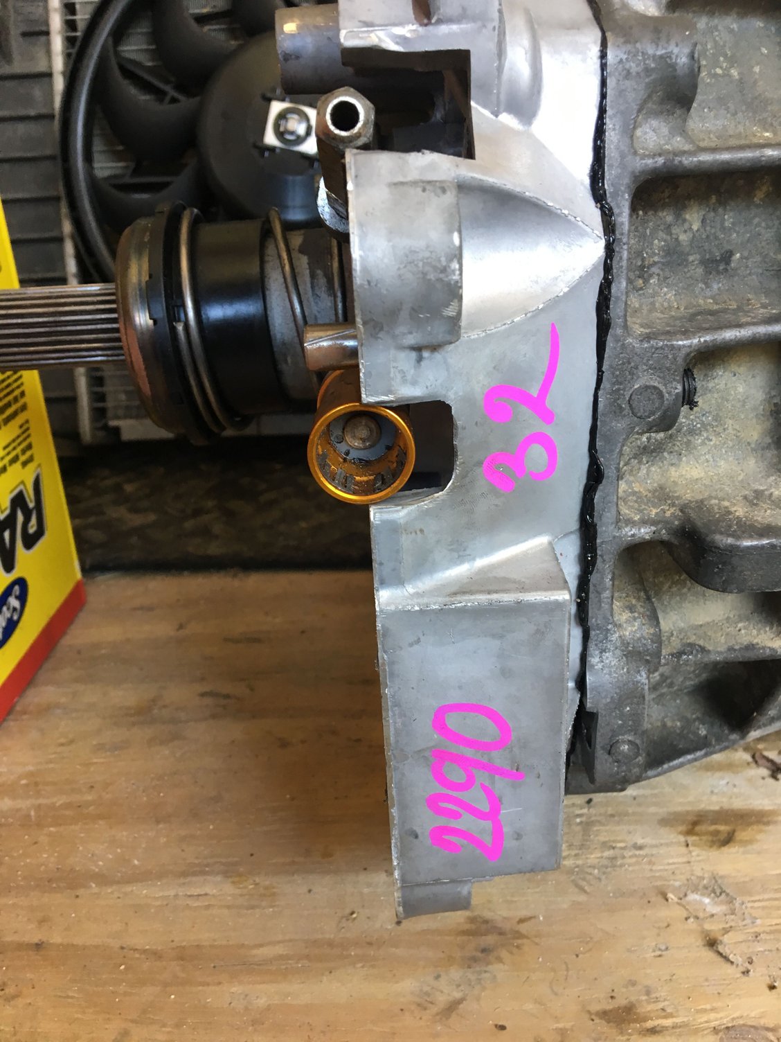

While I was working on getting the headers out I found this...

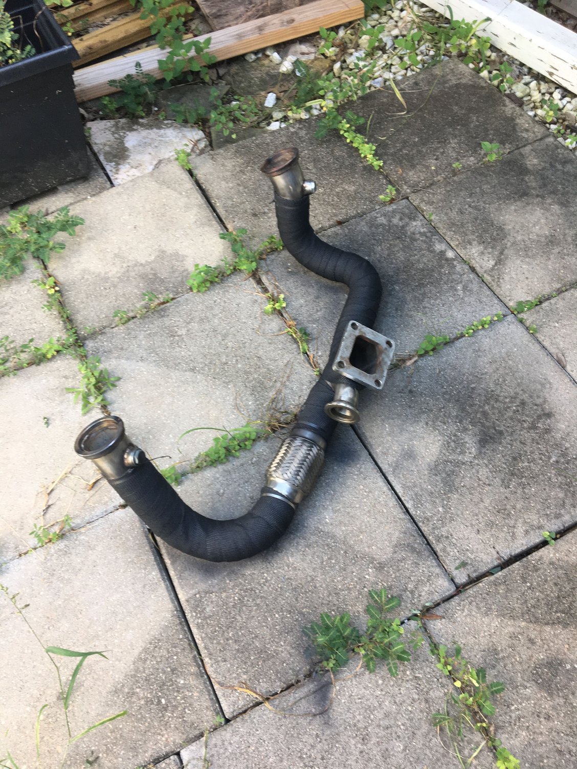

Passenger manifold fittedI hope to get the driver side manifold fitted today so I can mock up the crossover and finish getting the vbands welded.
As for the broken trans, im thinking of either fixing it or doing a 4l80 swap.

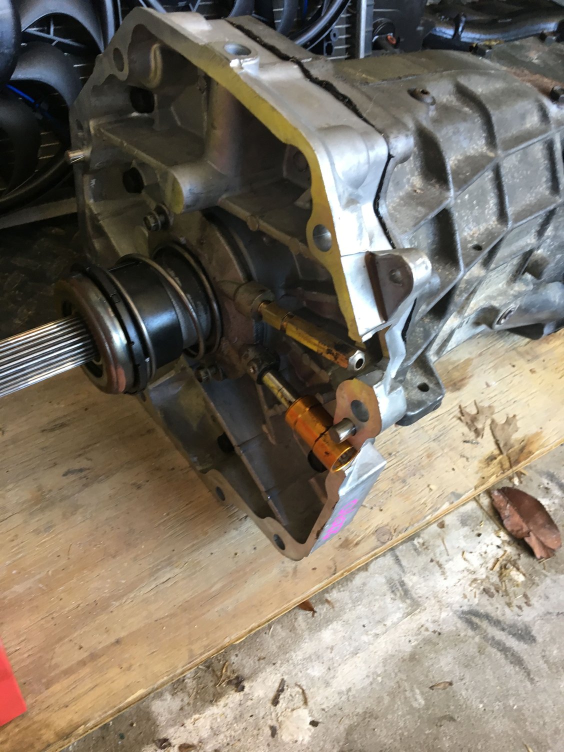

After last nights defeat with the lifter situation

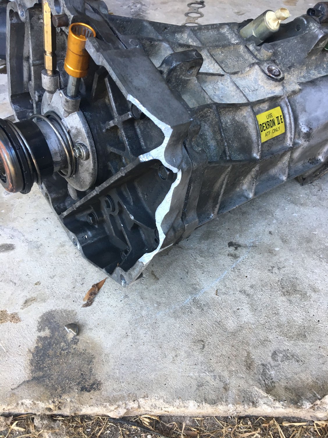

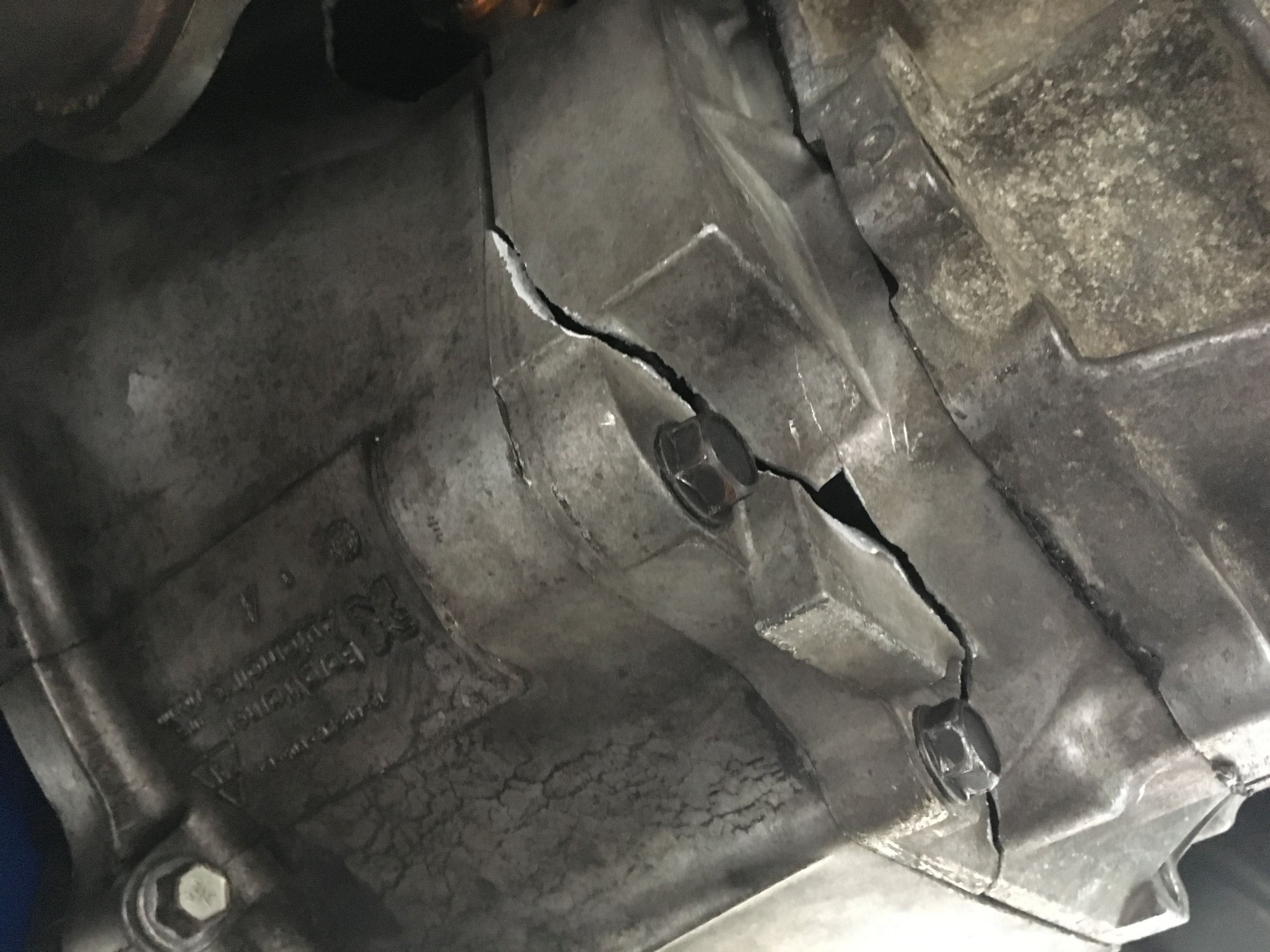

More carnage pics of the trans

damn how does one break the front cover?
Old Aug 14, 2017 | 06:23 PM
GaragebuiltSS's Avatar
Joined: Apr 2017
Posts: 55
not quite sure on that one. My theory is when the driveshaft broke it somehow managed to get that but not the tailshaft? Not real sure to be honest

It looks like someone tried to press the trans in place with the bolts without it being lined up correctly.
Old Aug 15, 2017 | 07:05 PM
Joined: Apr 2017
Posts: 55
hmmm wonder who that could have been. Wouldn't it have broke when it was being tightened? I'll admit, that's how I got it in last time. Done it before without a problem
Old Aug 15, 2017 | 07:27 PM
Black89Z51's Avatar
Joined: Nov 2011
Posts: 319
From: Newport News, VA
I could have caused a stress crack and let go when you had the other problem. It could have been the weakest link

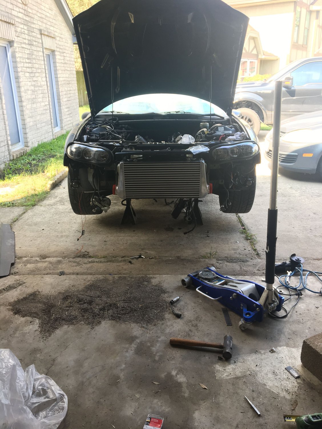

This weekend I got my intercooler mounted, crossover wrapped and the scavenge pump mounted.

Shiny FMIC, used all 4 mounting holes as it was flopping around with just the top secured

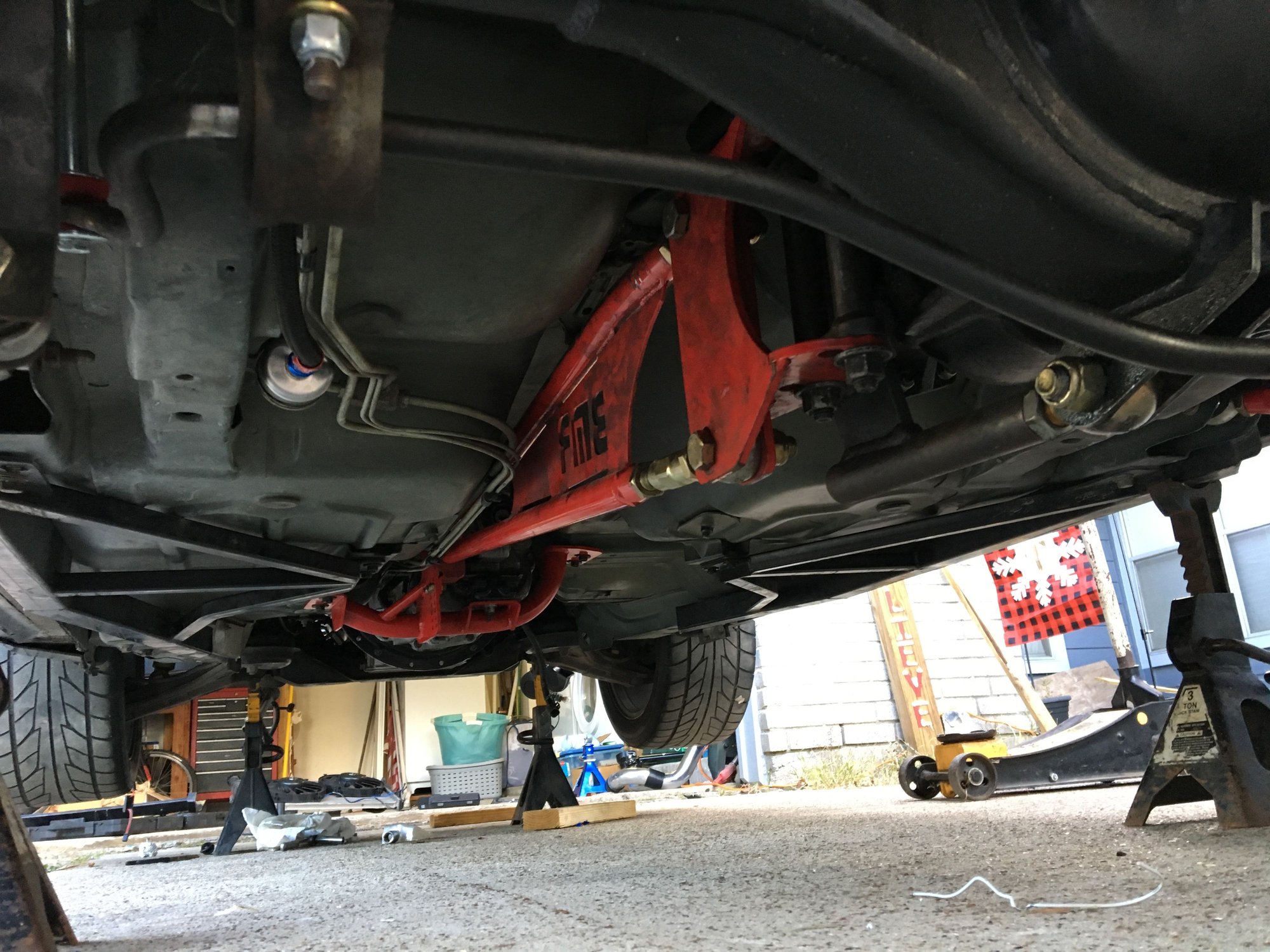

Pics of all the work done today are below. Bmr tq arm/cross member coming off the 9”

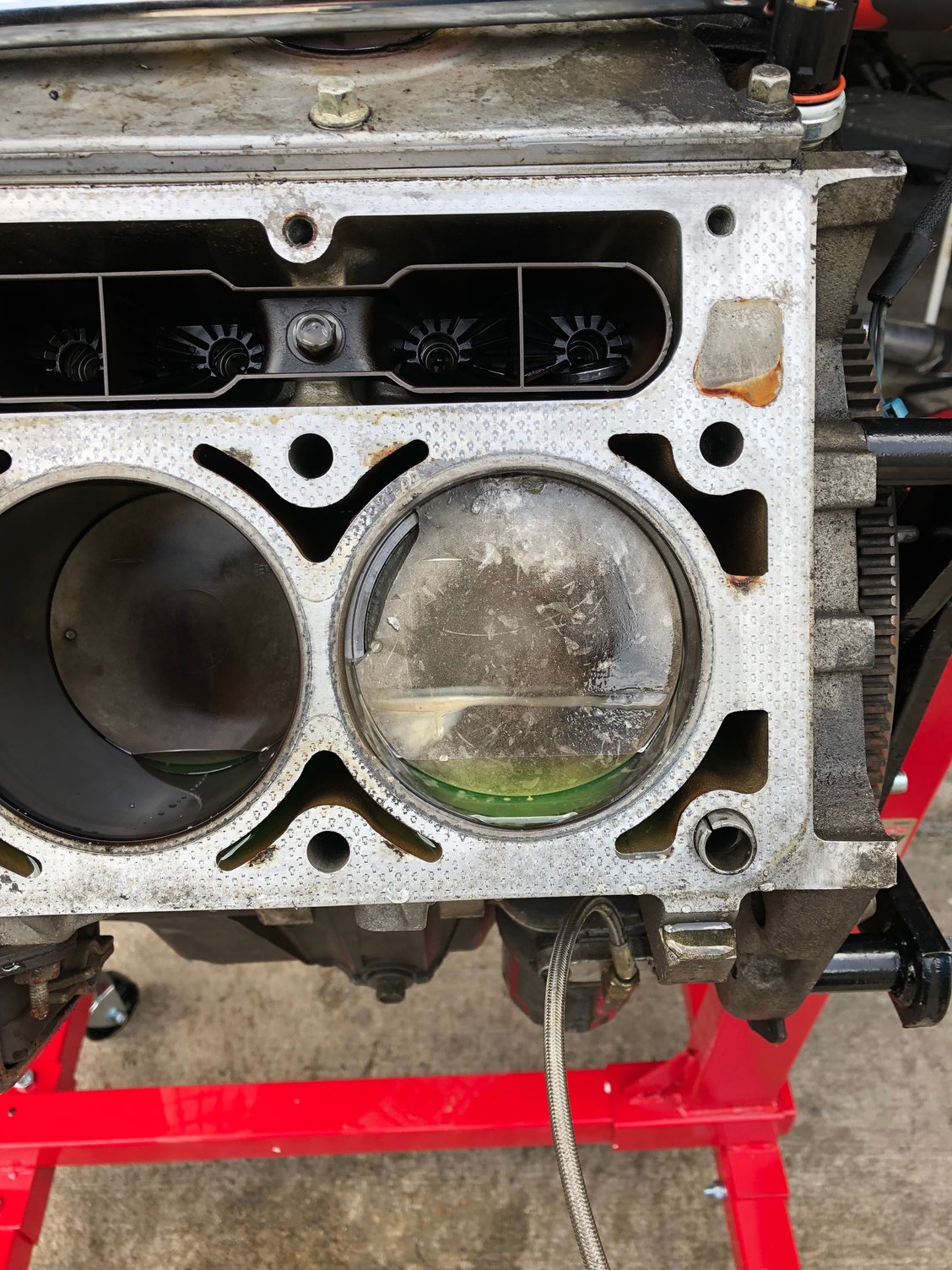

We got the car done, finally. Dyno tuned on 14# it made 530whp on pump 93 (thought it was a little low). I didn’t get much track time before chaos ensued though. Took it out to a local event right after we got it done and broke the driveshaft. Got that fixed and drove it on the street trying to get some miles on the setup. Long story short, I did a 4th gear pull and broke a ring land on #7.

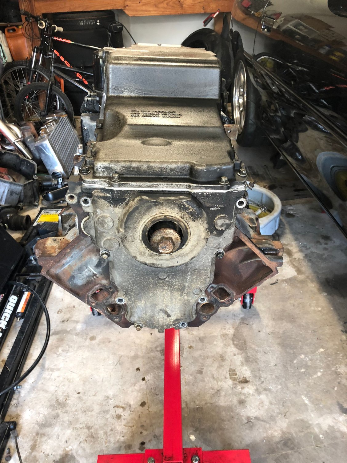

With that being said, the sbe ls1 came out and I picked up a 06 5.3. Has gen 4 internals but still 24x. That motor will be together this weekend and dropped in the car along with the trans. Hopefully I’ll have an update on Sunday but for now, pictures.
Ole #7
5.3 with my fbody pan. Rings gapped to 28 on top, 30 on bottom

I think you should spray some water-meth on it. Once I put in a super simple $100 set up I quit breaking pistons on the wawa pump gas we have here.

This 5.3 will be on E85, so I shouldn’t need the water/meth setup. If I was limited to 93 around here I would have done that but I knew I’d be making the switch to E.
i thought 530 was low too, especially since I’ve seen SBE ls1’s make more on pump with almost an identical setup.

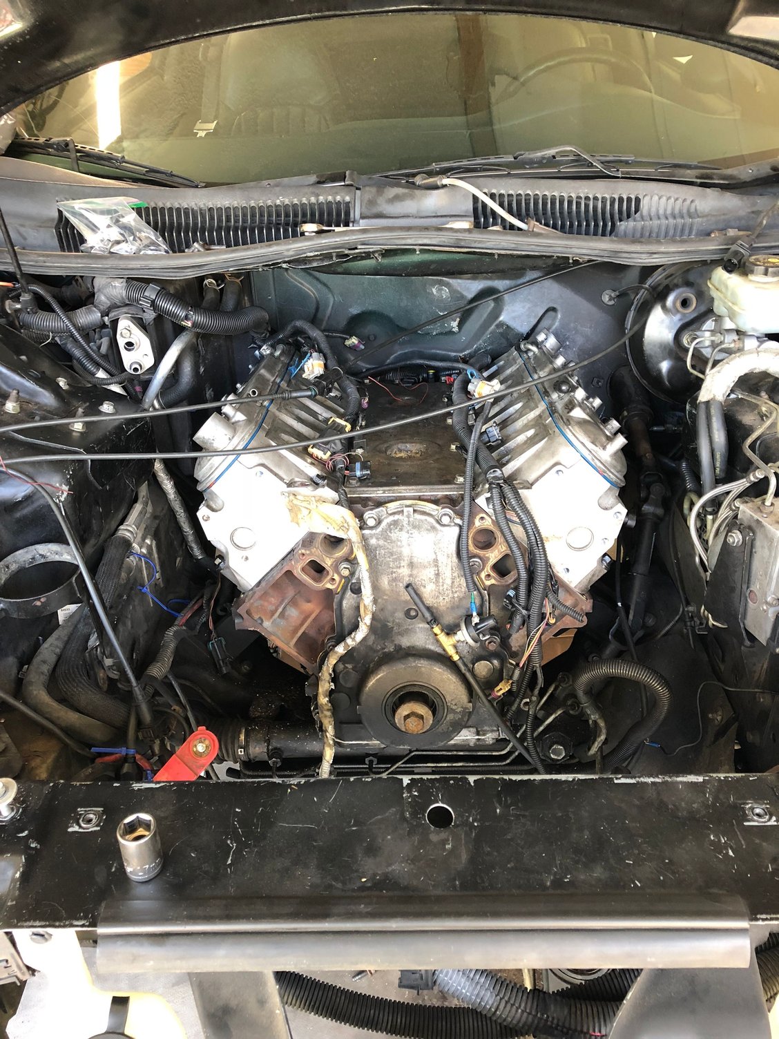

I got the 5.3 assembled and in the car this weekend. I would have gotten the trans in also but I had to order dowel pins. This coming weekend all the hard work should be done. Motor and trans will be in, accessories will be on and I will be ready to order fuel system parts and a griffin rad so I can stand it up.

Almost sounds like it was hurt from the beginning to pop like that. Any idea on AFR and timing?
Old Jul 17, 2018 | 10:48 AM
Joined: Apr 2017
Posts: 55
AFR was mid 11’s not sure on timing as i didn’t tune it.

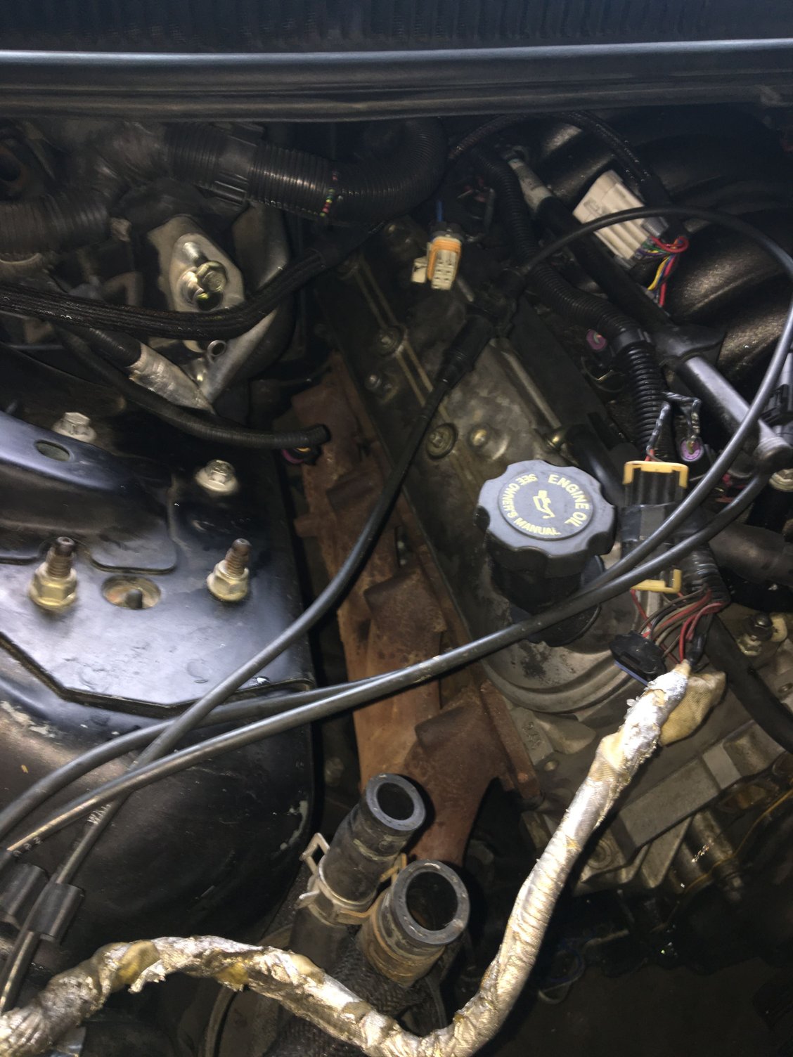

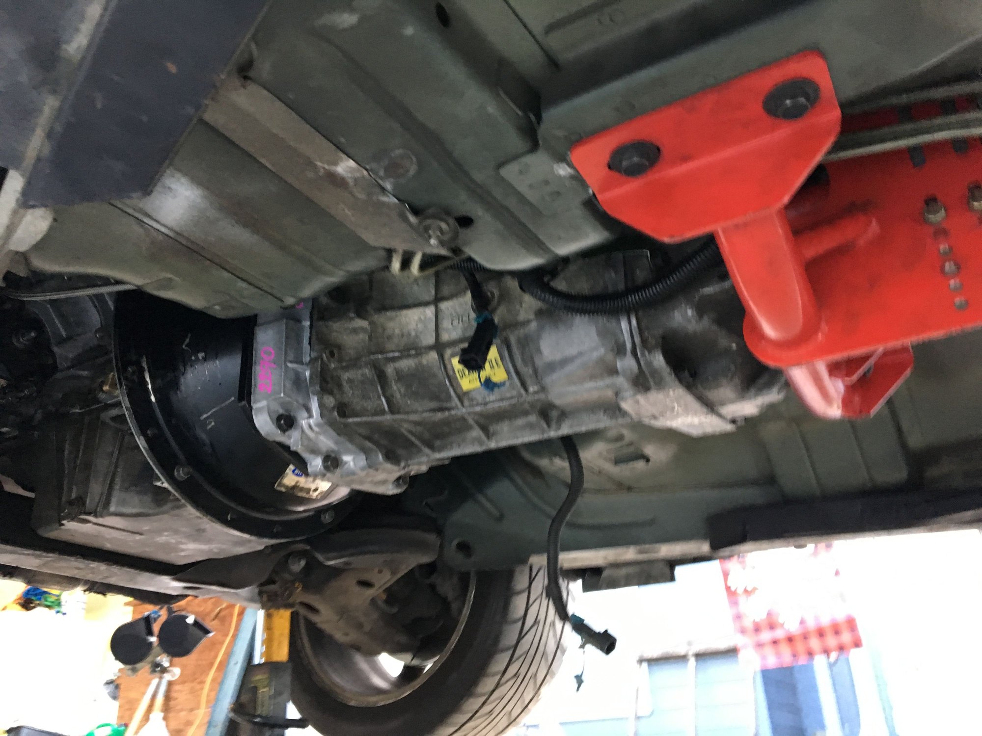

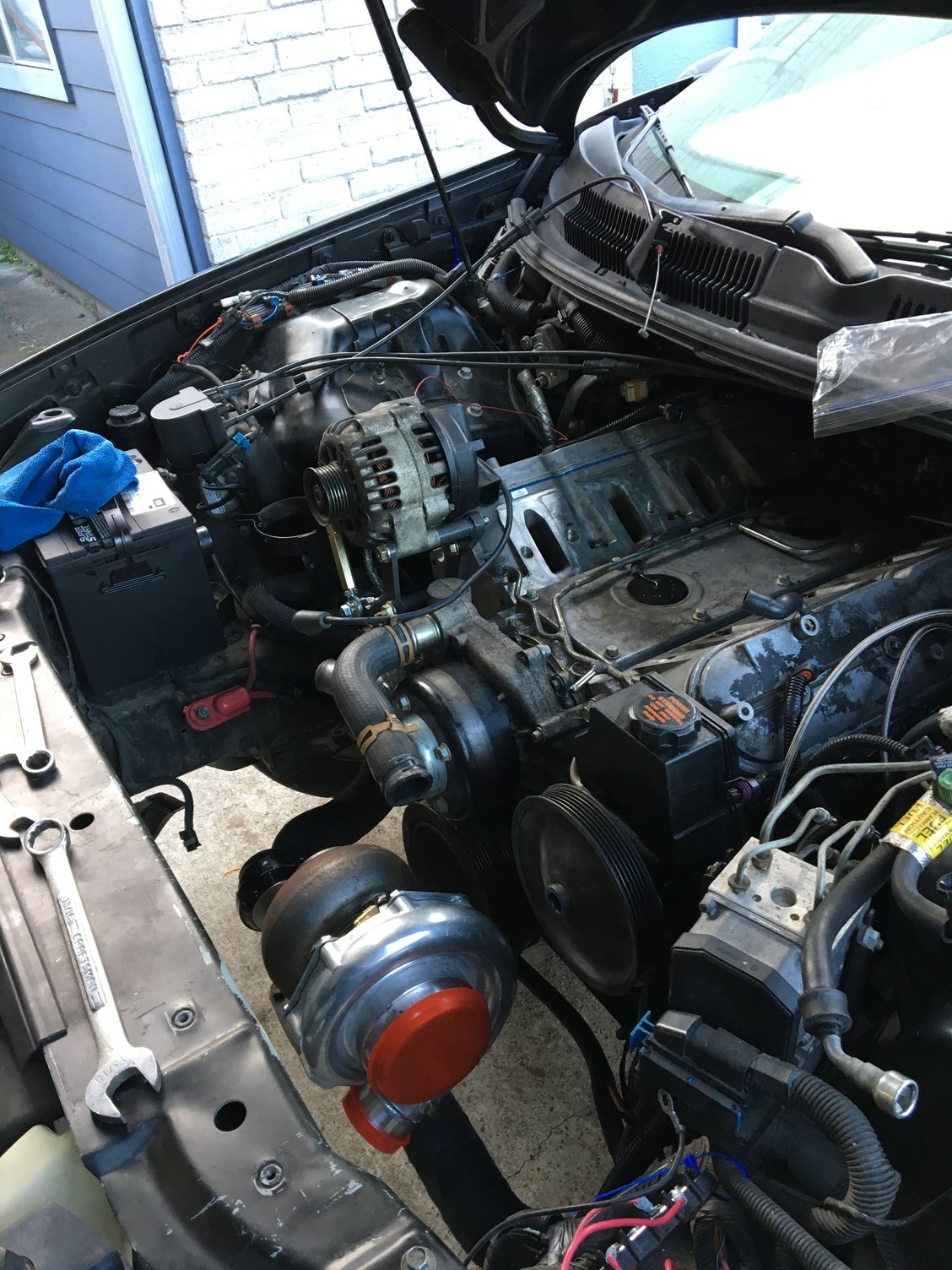

So I ran into a problem this weekend. We got the trans in Thursday night and got everything driveline related buttoned up. Got the manifolds on, PS pump and WP. I put the starter in so I could turn it over and build oil pressure. I turned the key and can hear the starter spinning, but it’s not making contact with the flywheel. I pulled it off and verified the bendix is extending and it is. Put it back in and no change. It’s a 5.3 (obviously), ls1 flywheel, ls1 starter no spacers anywhere. Do I need a truck starter to make this work? Also, I have a QuickTime SFI bellhousing. Idk if that makes a difference. If y’all have any suggestions on what to look at/check next I’m all ears. Hopefully I’ll have some time tonight to mess with it.
Old Jul 30, 2018 | 08:35 AM
Joined: Apr 2017
Posts: 55
I got the starter issue figured out. Guess the original starter wasn’t extending out. Like I said, I tested it on the bench and it extended but oh well. New starter and the problem is gone.

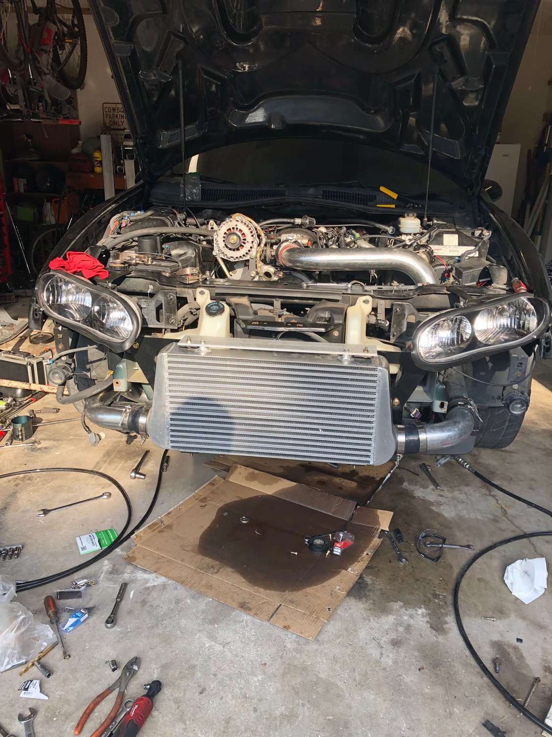

I got the rest of the car pretty much done. Crossover, turbo, intercooler and piping all in. Put a bigger spring in the gate also (10#). Hopefully we can turn this motor up.
I still need to order new rails and a regulator, along with a griffin rad so i can stand it up. Then I need to drop my other 450 in the tank and fix a power steering leak. After that it’ll be ready to rip

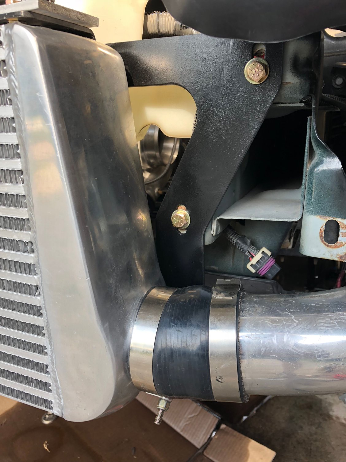

Peep these cool intercooler brackets a buddy made for me
