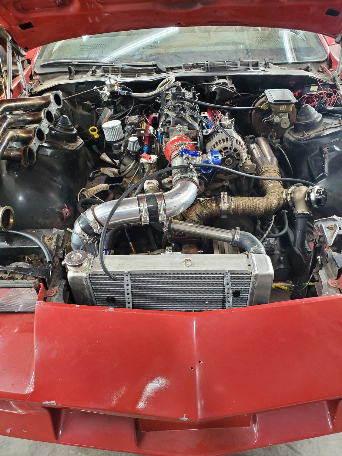

Had a bad header gasket but its 2 44mm wastegates but passenger side matches the driver side 3inch header collecter goes to 2¼inch pipe then into the t6 twinscroll flange

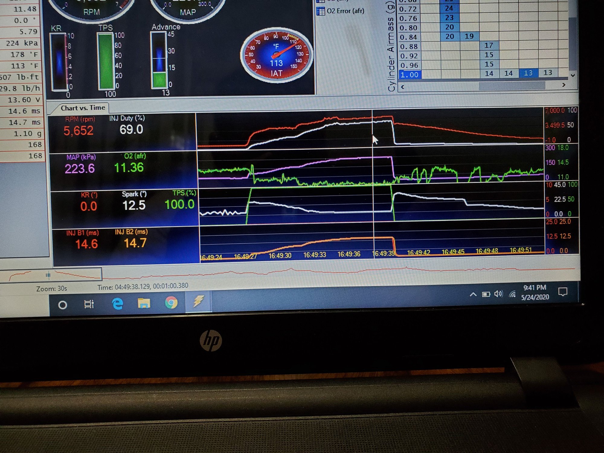

Originally Posted by Matthew Campbell 84z
3 window did u get to open the log i posted

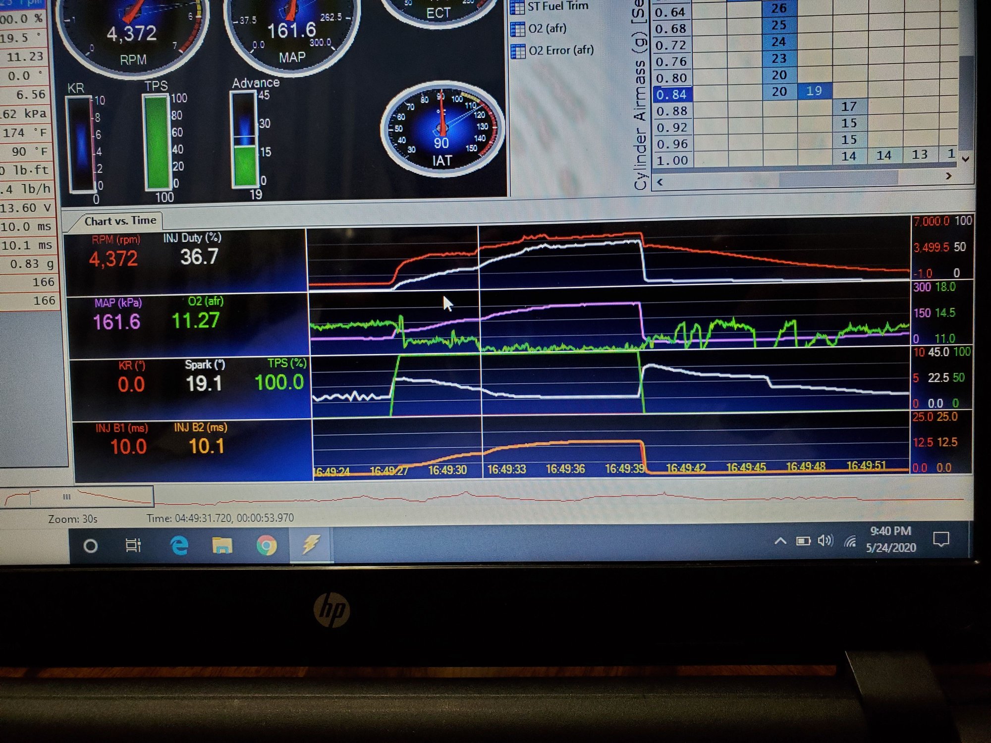

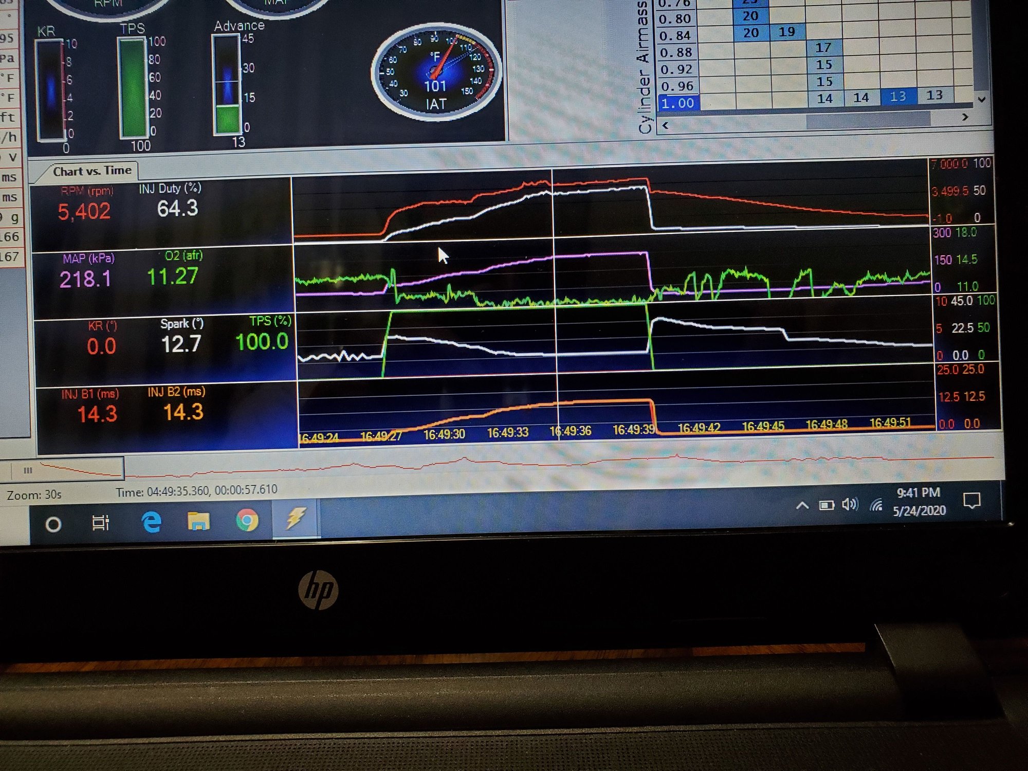

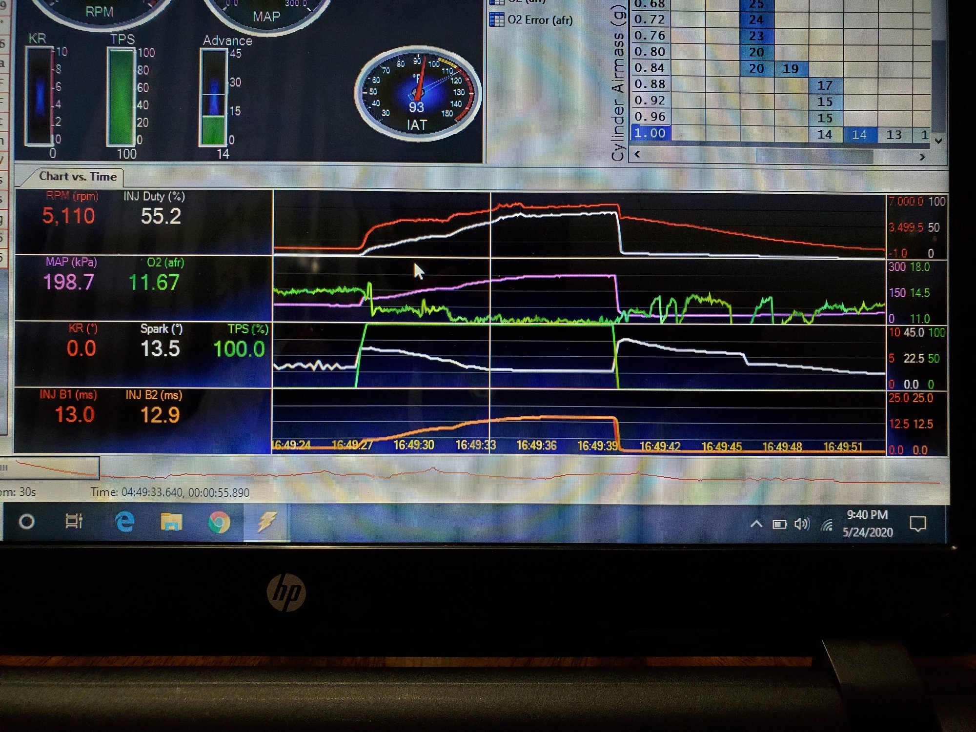

I haven’t. I need to download Hptuners to my laptop. Post a screenshot of the log including timing.

Is there an intercooler hiding in there Matt?

Likes: 187
Are you on the gas scale or E for AFR? (Looks fat either way).
Also, that things not making much vacuum at idle (79kpa). Should see more like high 50s Kpa. I’d look for a vacuum leak. Found too that it makes boost way to slow to give you a decent ET. How is the boost controller set up?
Did you degree the cam?
Old May 24, 2020 | 08:51 PM
  #47
Matthew Campbell 84z's Avatar
Joined: May 2020
Posts: 17
its set up for gas scale and by the end of the day I had it around 11.3 to 11.5 in high gear and yes there is a intercooler. I have the gm part# 12592525 map sensor 3 bar I don't think it's scaled correctly cause I see 116kpa when u first punch it(I believe it should goto 100kpa correct?) So yes ill have to redo the scaling on that. I could probably send u the tune file if u wouldn't mind looking at it im new to this and I've had it to a few ppl that just didn't help much and got burned but its running 7.50s so I'm getting there I just know it should be faster

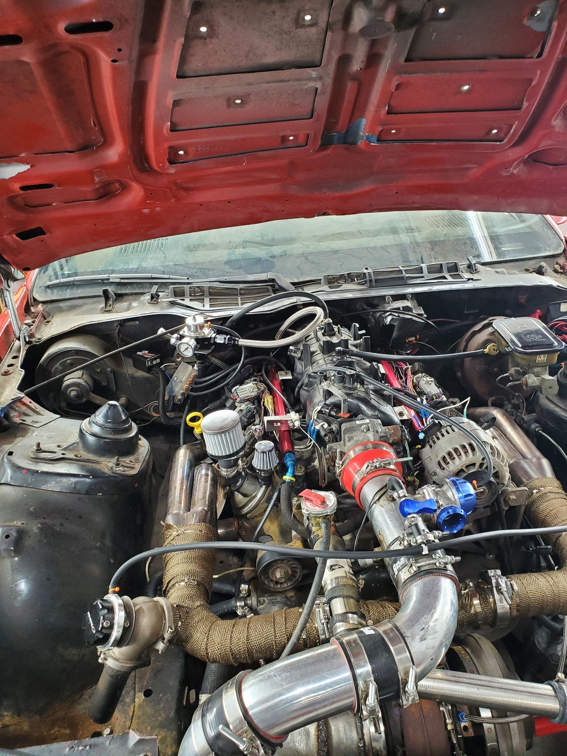

U can see my manual boost controler going to both wastegates in this picture. Thanks for looking and helping 3 window.
and no I installed the cam dot to dot straight up

towards the end of 1st gear the rpm is jumpy because its a **** track and there's bumps lol but on the street it is smoother pulling thru the rpm range my main concern was wen I dumped off the transbrake it looks like I'm just footbraking. Maybe I can look into my time slip and logs and see how much converter slip there is based on mph and rpm if I ran say 7.50 can I check my timeslip mph and the logged rpm 7.5sec after I released the transbrake?
Get that map sensor scaled correctly. That’ll kill everything if it’s off. Send me the tune and I’ll look. I’m not super familiar with hptuners, but I’ll see if anything jumps out. Your boost curve looks like mine on the street. I’ve run low 7s at 113 on the street on a Nitto Drag radial. No reason you should be a second faster than your are now at the track. Gotta get it to make boost quicker. I’ll bet the gates are cracking early. I run onboard air so boost control is wicked tunable and accurate.
I'm guessing I have about 30% converter slip at the end of my run from mph rpm tire size and gear ratio. My last run was 97 and I went thru the 8th at 5660rpm I'm thinking about getting this to try it while I send my circle d converter back to see if they can restall it but ill get to work on the scaling of the map tomorrow

Don’t bother with that converter. You’ll end up regretting it. The log you sent is using the E85 Stoich. That being said, you should never see under 7.3 on the E scale. That’s roughly 11.0 on the gas scale. You’re all the way down to 5.75 on the E scale. That’s richer than 9:1 on the gas scale.
Now for the converter.....you get on the two step within two seconds of getting it to the floor. That’s not bad. You leave on 8 psi (more than I have). Now the bad part, it flashes to 4700 and tugs the engine down. You can see where it rides the converter at 4700 for a bit. That’s well below any good torque. The thing is the fallback rpm isn’t horrible, however, it’s hard to tell because you short shifted it. You need to make a pass and wind it up to 6500-7000 and see what that does. You don’t want to adjust or swap a converter until you’re making the power you want. IMO it’s way too tight off the brake, by at least 700 rpms.
Now all of this could be do to it being so rich it’s not making any power. So here’s what I’d do....make sure the map is reading correctly, fix the fueling to something that makes more sense (can’t help you there in hptuner land), make a rip and see how the converter acts and go from there.

ok.. thanks ill try to get the map and fueling sorted out the best I can and try it again this weekend. Thanks for looking into it. Yes the tune is for e85 bc if I set it on gas scale my Vetable is thru the roof. So something else must be adding fuel. Thanks again for ur input. I appreciate it hopefully I can get this thing to run the way it should.
