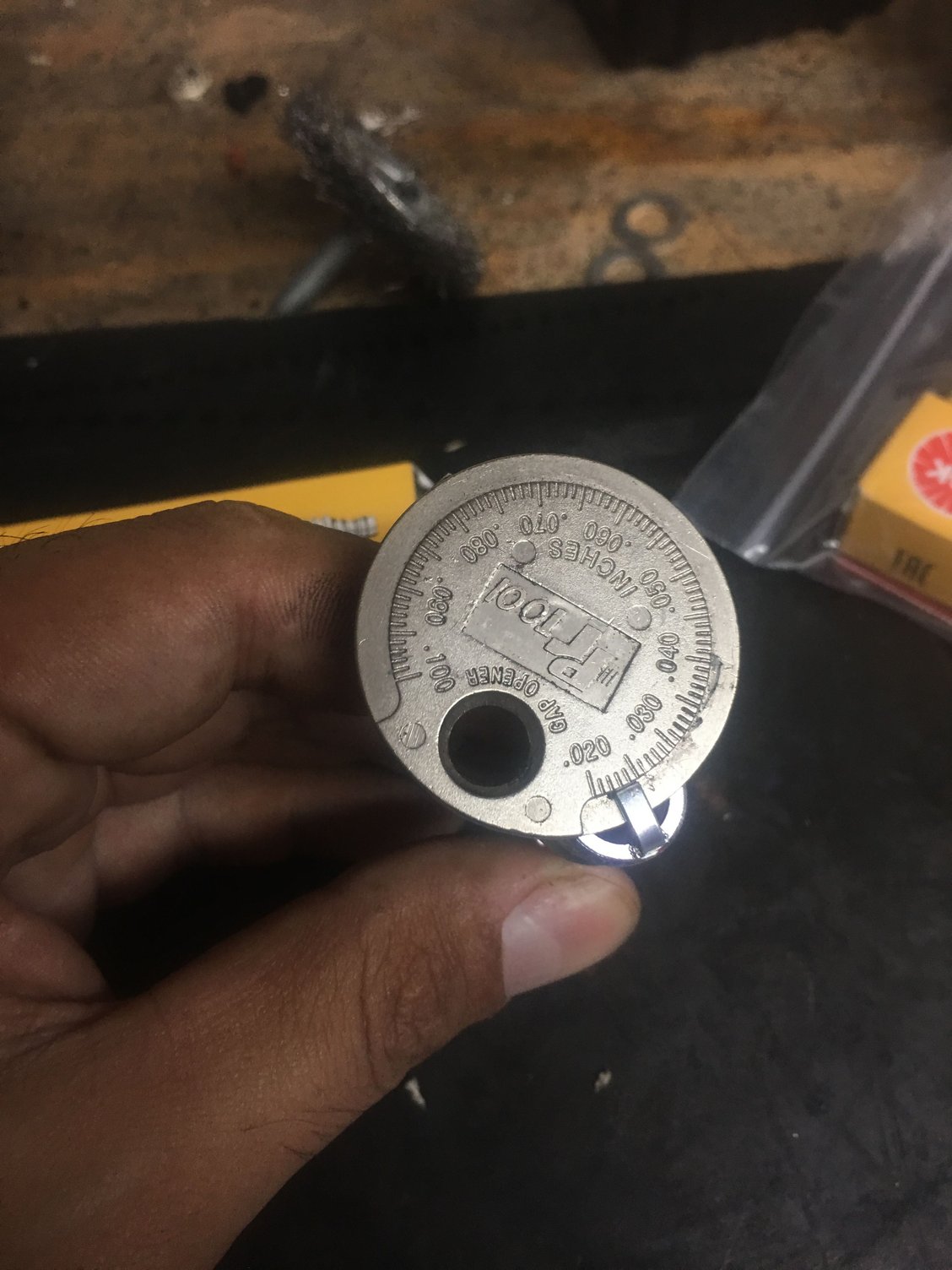

I just checked the plugs and they come with a .022 gap .. I guess I have to open them up .. I never would of thought the gap would be so tight
Old Sep 2, 2017 | 07:28 PM
ddnspider's Avatar
Posts: 14,628
Likes: 1,778
From: FL
That does not sound right for a tr7. You sure you got the right plugs?
Old Sep 2, 2017 | 07:36 PM
Ogoz23's Avatar
Joined: Oct 2016
Posts: 248
I have NGK BR7EF
Old Sep 2, 2017 | 07:43 PM
ddnspider's Avatar
Posts: 14,628
Likes: 1,778
From: FL
Wierd I just googled and confirmed the stock Gap on those plugs should be 028. Either way just Gap them somewhere at 28 to 32 and you should be fine.
