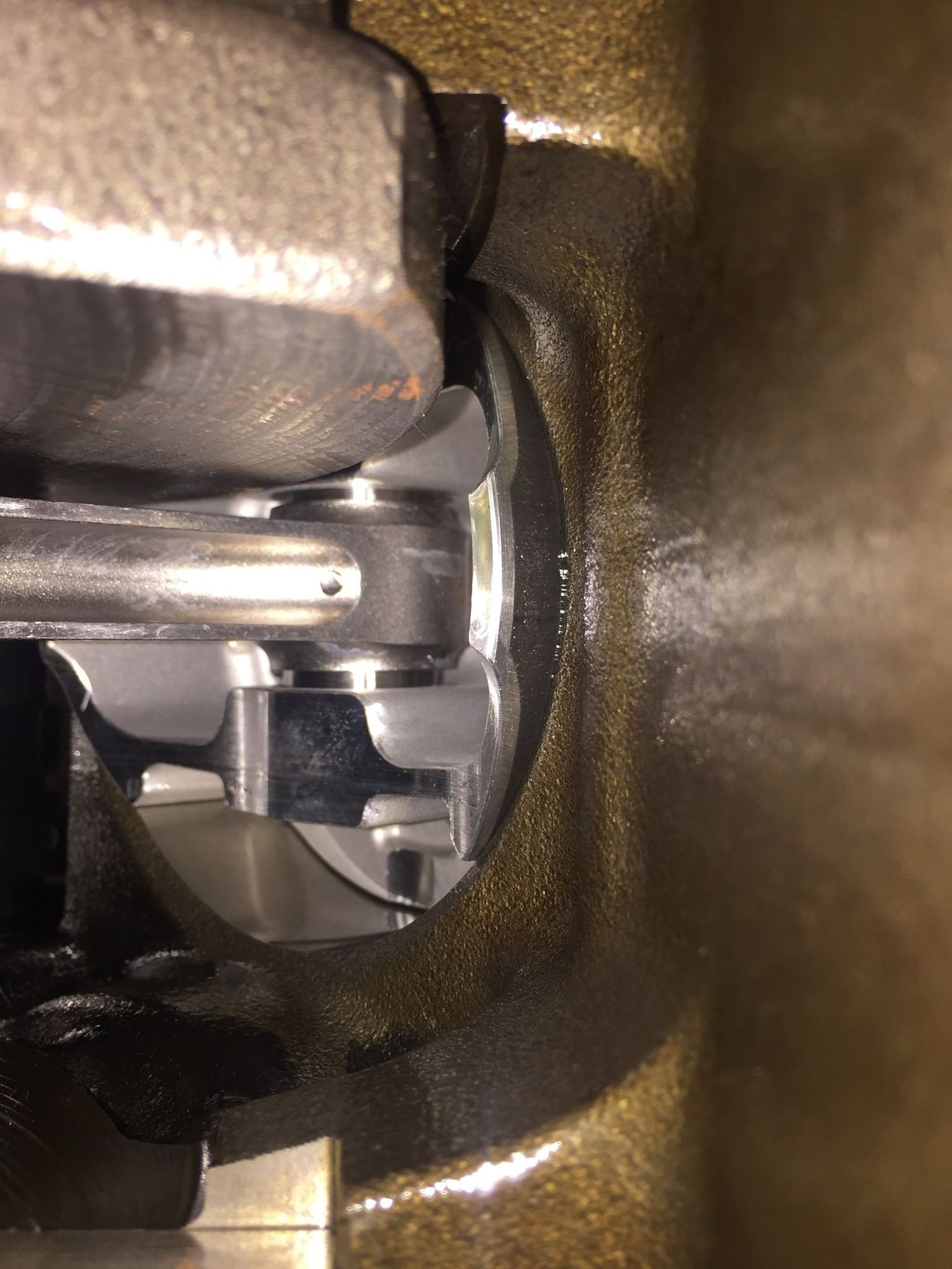

^ yup that skirt will get destroyed. 1/2" is a lot shorter. Maybe throw a 4.8 crank in it lol

It's a stock stroke build I don't see the piston getting anywhere near low enough to cause issue. I spoke with Erik and Brian with LME about it when shopping a re-sleeve quote and they both said run it as it.

Yeah the skirt gets no where near the bottom of the bore! Heres a stock stroke in a 6.0 block.

Test it with a 3.26 stroke (4.8) vs the 3.66 stroke see where the piston goes.

The piston at BDC will be the same in a 4.8 or 5.3. Shorter stroke and longer rod vs longer stroke and shorter rod.

You would be correct. TDC - stroke. It uses a longer rod to achieve TDC.

Sorry,
with stroke of 3.62 and 6.098 rod at 180* of crank angle is 3.62"
with stroke of 3.27 and 6.275 rod at 180* of crank angle is 3.27"
So the 4.8 would be 0.350 higher up.

Right, and with a custom piston with less skirt, maybe he gets it to clear....either way, I wouldn't run the block. Sleeved stock blocks always break and break fast.....

I slept on it and decided to pass on the block

probably wise. those situations are tricky, you can end up throwing a lot of good money after bad

Garbage, that sleeve is going to rip the skirt off that piston.
Thats where Im at. I dont see how that would NOT be an issue for a skirt.
