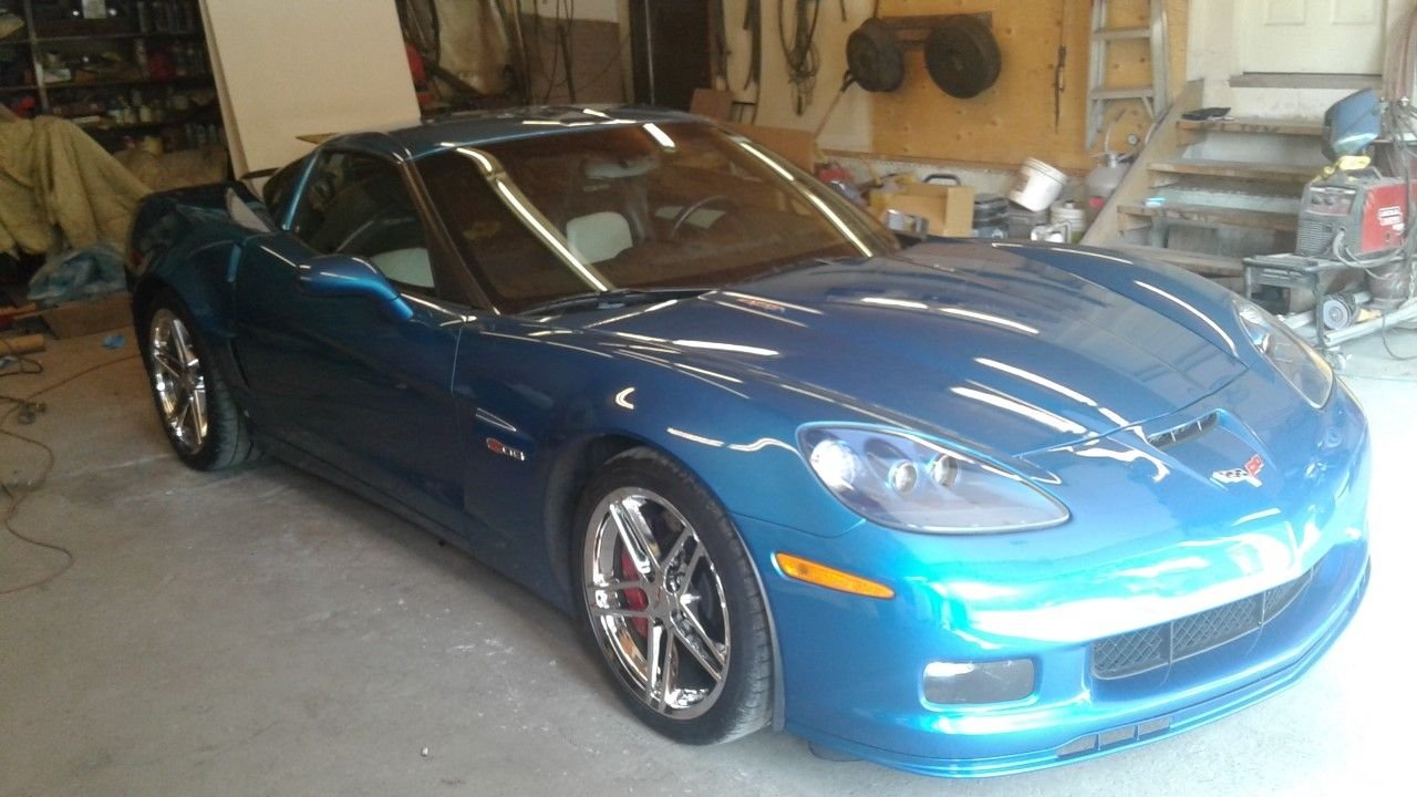

Soooo .. I finish the paint on this car today and owner says take it for a rip ..
Very fast car .. no doubt ... 505hp Z06 is no joke ... but I see that motor at 6-8 lbs being really fun.
Thoughts ???
