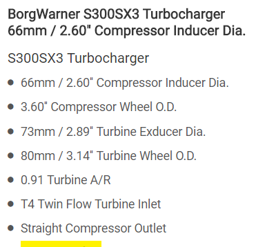

Soo heres what im looking for help on. I have two forged piston options for my price range. One will yield 9.13:1 the other 10.27:1- I'd love to spin this motor to 7,500-8,000 RPM and run pump gas. Assuming that turbos on the smaller side and i can only achieve 7-12PSI at such a high RPM will 93 support 10.27:1 with a good tune.
Looking for any and all feedback! I'm honestly not even really sure what kind of power this turbo can make or what expectations to have with it. I got it for a great price on my first 4.8 turbo build up and lost the motor from a fueling issue.

With either CR, you need to dump the turbo and cam for something bigger to get anything other than a low rpm stoplight racer or towing rig. This is coming from a guy who regularly tells people to go smaller on both. The difference is your stated goals vs what I commonly read from other people. You will be massively disappointed if you put the current random batch of parts together.

Honestly, you could take either CR past the point of non detonation related part failure with a larger cam and turbo. What strikes me is your rpm goals. The rpm you dictated with the size motor you will have will be making overkill levels of horsepower on the street or an unprepped track with almost any boost. The problem is that cam will support the same torque curve (low rpm) whether boosted or not. The difference is only in how big that torque number is. The turbo will have an "island" where it is most efficient, and on a motor of the size you are building, the efficiency range of that turbo stops well below your stated goals. You could obviously just spin the motor to whatever rpm whether it made power or not, but that is useless noise.

I honestly am unsure of what this turbo can do. I bought it for a great price and ran it on the stock 4.8 - I just assumed it would feed more as I understand little about turbo still. so- is it safe to assume I should go 10.27:1 . what expectations should I have for max power on this turbo?
