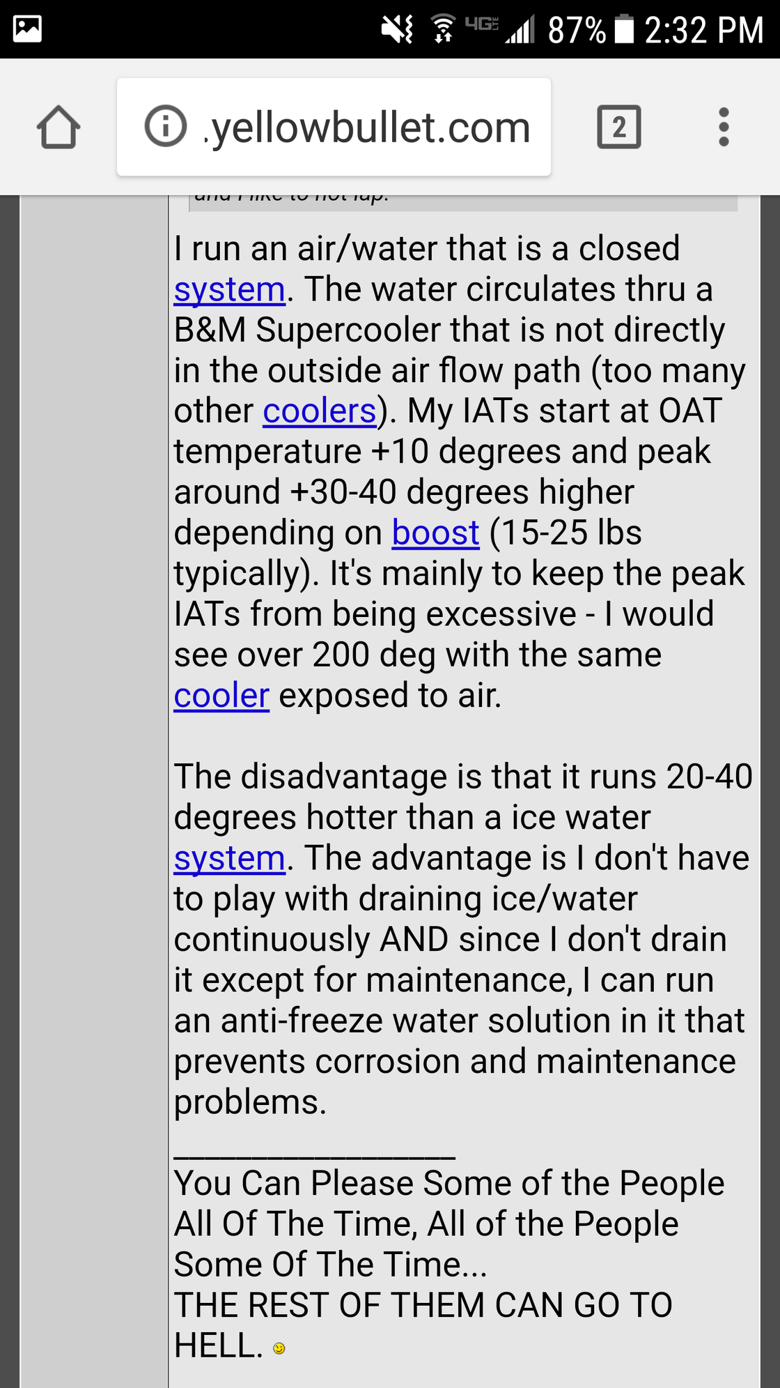

I beleive Randy Seward's true street mustang runs a closed loop system with b&m super cooler and ford lightning intercooler with a small remote fill reservoir that may package nicely.

Here's a link to what Randy used to run: http://www.yellowbullet.com/forum/sh...47&postcount=3
Here's what he stated about the super cooler: http://www.yellowbullet.com/forum/sh...86&postcount=2

here is his post from 1-19-17
