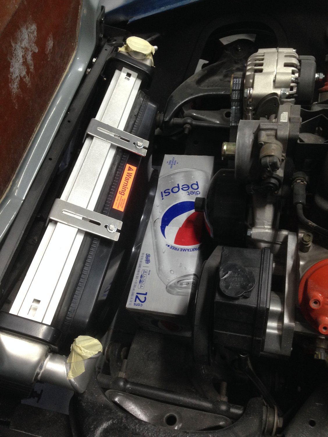

I appriciate the inputs, Far as changing the combo, not gonna happen. It's set and done. I'm looking at one spot that I might be able to fit a FrozenBoost Type 26. A 12 pack of soda is close to the same dimension (still about 1" short in width), but it's really tight. I need to spend more time measuring:
if that doesn't work then it'll have to be meth injection only...better than nothing at all. E85 could be a possibility with the GM sensor but I know my pump is not compatible with E85 if I recall correctly.

Isn't that your fan shroud just to the left of the soda? I would imagine that would block flow quite a bit unless its an illusion from the angle.
yes it is, and that would be an air to water cooler, no air/air (sorry didn't mention it)

I assumed a2w from your link to frozen boost...I was more concerned what other problems will arise from blocking your fan.
I see what you mean, it's an illusion.
