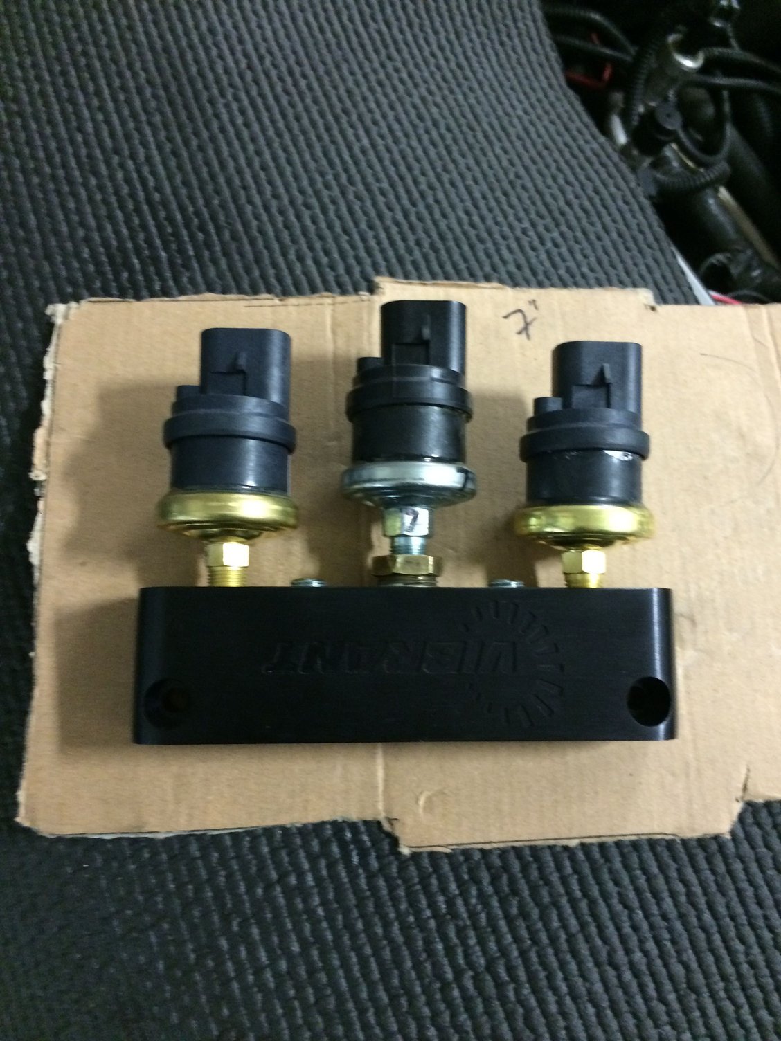

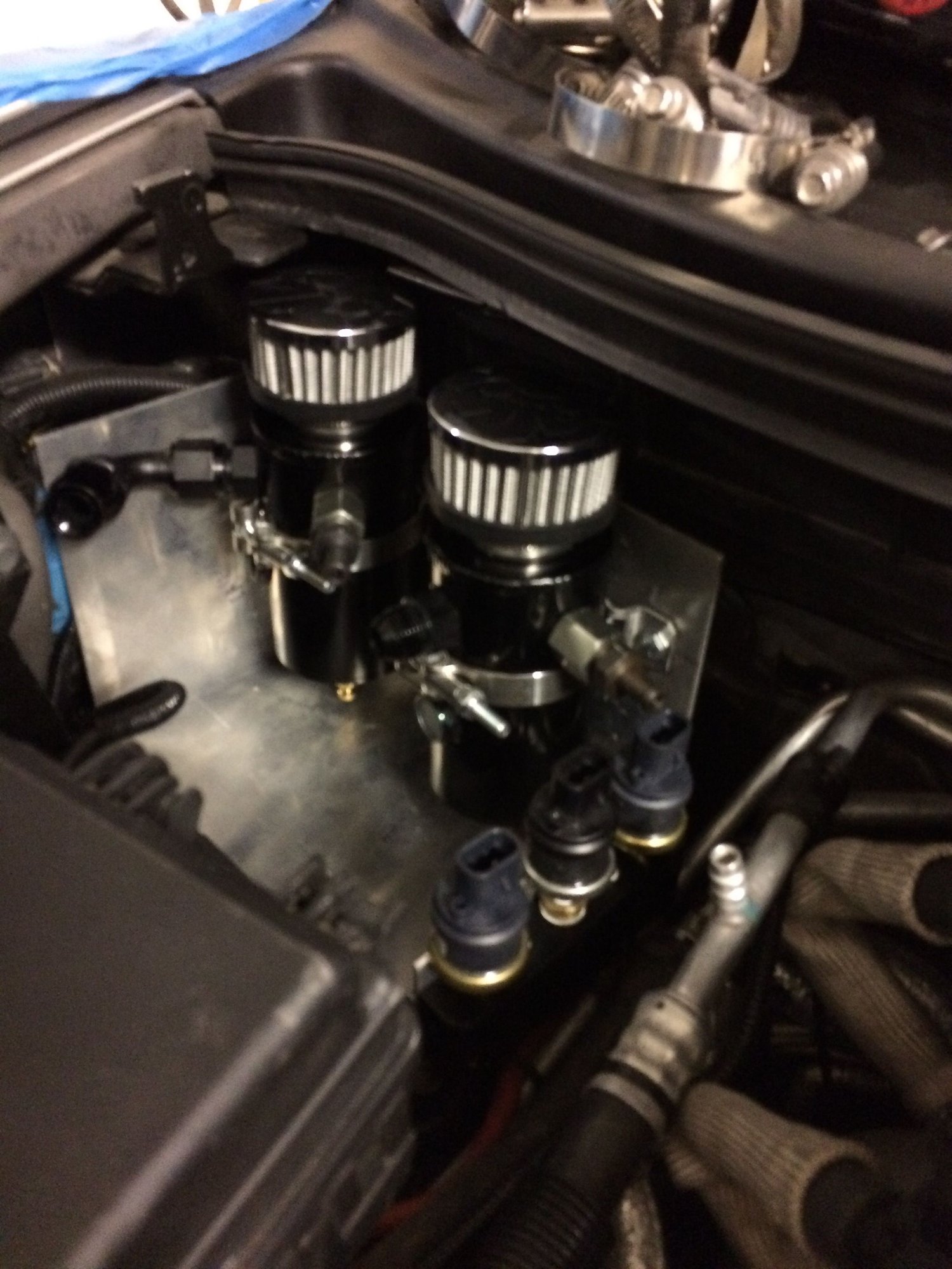

I mean run the stuff that needs vacuum off a vacuum block (manifold) whatever people call them. Just gives you extra ports. I use one from Vibrant but there are many makes. My BOV and 3 hobbs switches run off it no problem.
Holee sheet, I had never even heard of that before. Just like a USB hub! Haha That's the ticket, thank you!

ive never seen that type of hobbs switch that uses a socket connector. are they adjustable? where are you sourcing them?
They come in various PSI and are adjustable. They come from racetronix. Bit expensive but very reliable and the connectors are dirt and weather tight.
