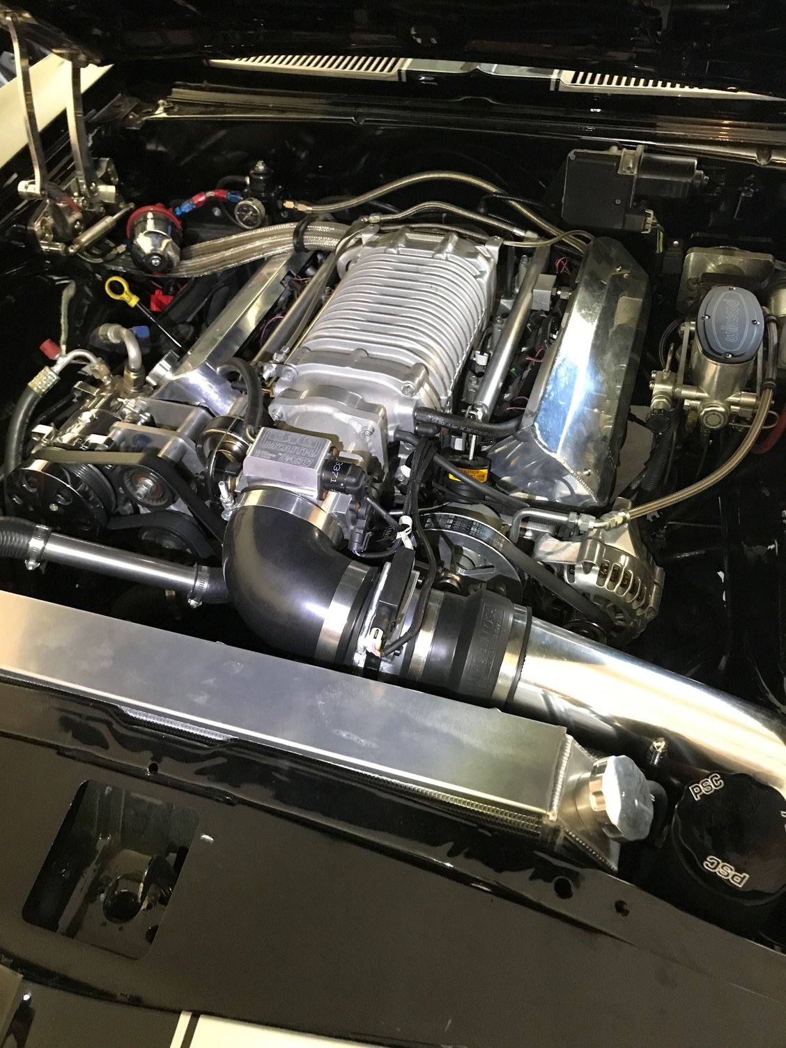

Okay fellows it has been a very long time since I have been on this site and taking some time to get acclimated to all the changes..
I just picked up a 67 Camaro with a stock Ls1 , brute speed blower cam, stock heads and a old Maggie blower _ I think it’s a mp122 or 112 I can’t member ..
The car put down 490 and almost 500 tq at the wheels ... I don’t know the boost but I think it’s maxed out for what the blower can do ...
Here is my question
If I replace the heads and go with a bigger blower cam can I get a good decent bump in power ? Let’s say and extra 30 to 40?
Yes I know it’s a stock bottom end and I’ve been told heads won’t make much of a difference ... I think if I can get this it will satisfy me for a while before I go spend 30k on a ls3 with whipple / tranny etc ..
Old cam specs 232/240 l .595/.608. 115 lsa
New cam specs 227/243 l .625/.615 115 lsa. ( tick stage 2 blower cam )
And for heads I was thinking tsp ascast 225..
Thanks for feed back in advanced

I don't see you gaining much in power as with the blower being maxed you'll likely be losing some of the boost it is currently making. I suggest adding a methanol injection kit to it, using 100% methanol. You'll pick up the power you're looking for by dropping the inlet air temps. Bob

Isn't a TVS2300 a fairly easy upgrade from those?

My tuner said I could get 20 - 30 easy since I have added methanol injection just by bumping up the timing since it is currently tuned with an SD tune and with a very extremely safe tune (ATI D1 ProCharger at 10-12 lbs of boost).
It's an AlkyControl system - very reliable and easy to install.
Got's to have enuf injector and fuel too, though

You can't even be bothered to know how much boost you are making, and you are talking about major upgrades? You need to get back to basics before trying to go any farther. If you don't want to do it, pay somebody to. You are currently on a path leading to nowhere but disappointment.

Sweet looking 67, looks like a lot of money went into it-first thing that pops out to me is the fuel filter-while it may not be a rest., it just looks out of place, lol. You def need to know boost, current tune, etc.

From personal experience ( as I have been down the MP112 path), upgrading from where you are now will not gain you a significant power increase. I was in you exact position and spent a fortune only to gain another 50hp or so. Not worth it. My advice is to Enjoy where you are.
If you absolutely need more: I would consider a small 75 shot of N2O. It will certainly give you that extra bump & also drop your IAT’s. All of these options have consequences & further development to make them most efficient. In this case if you want to increase from a small shot the N2O will require an adjustment to timing to keep it safe, that means either a computer/ management system upgrade of some sort or when you drive around with the “bottle off” you will have to have a dumbed down tune ( reduced timing) which is a bit anticlimactic.
IMO: stay where you are and enjoy that TQ. The #’s are just that. The TQ curve you presently have is the envy of most street car guys !
