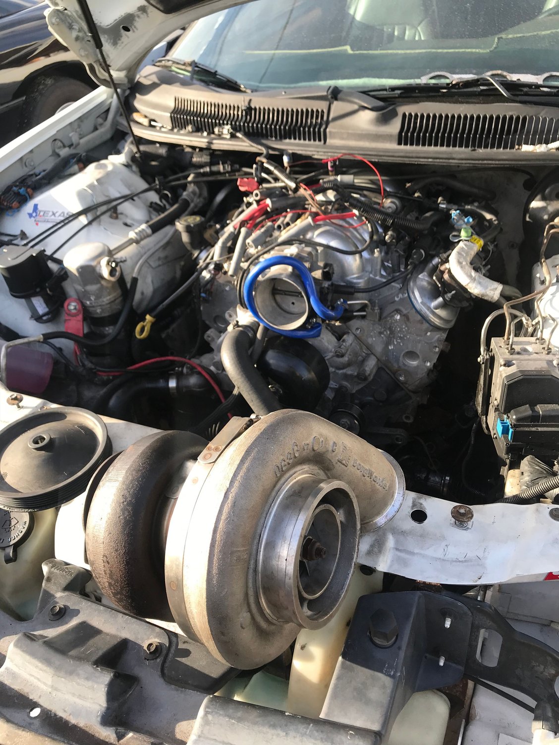

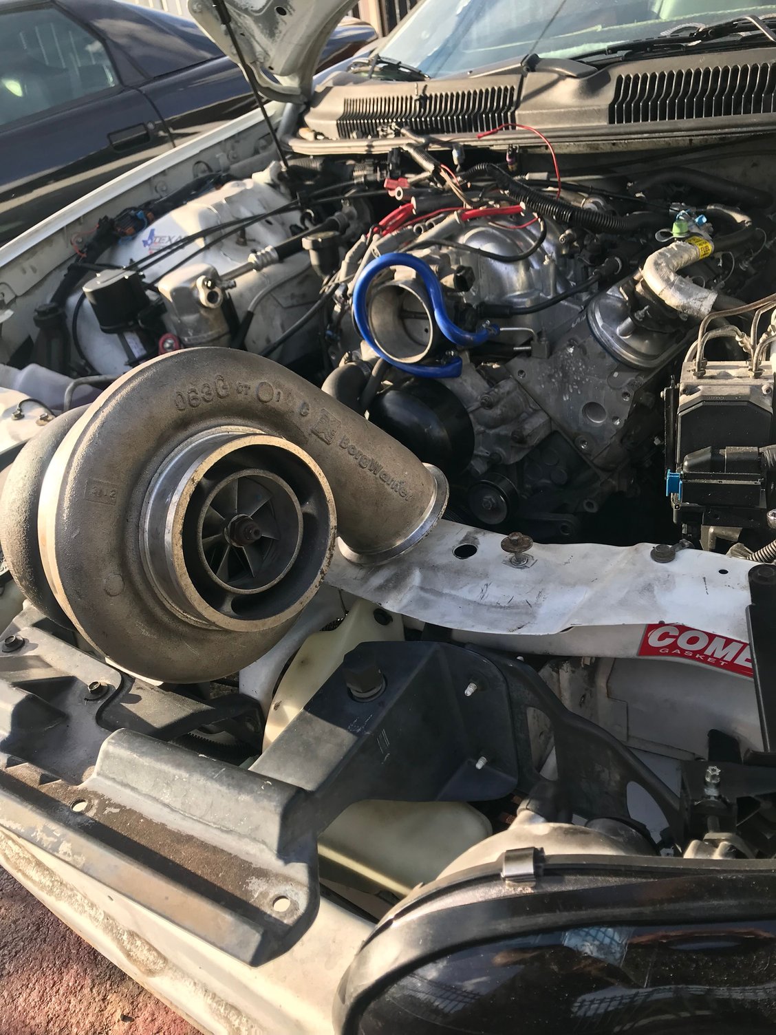

This is what I have

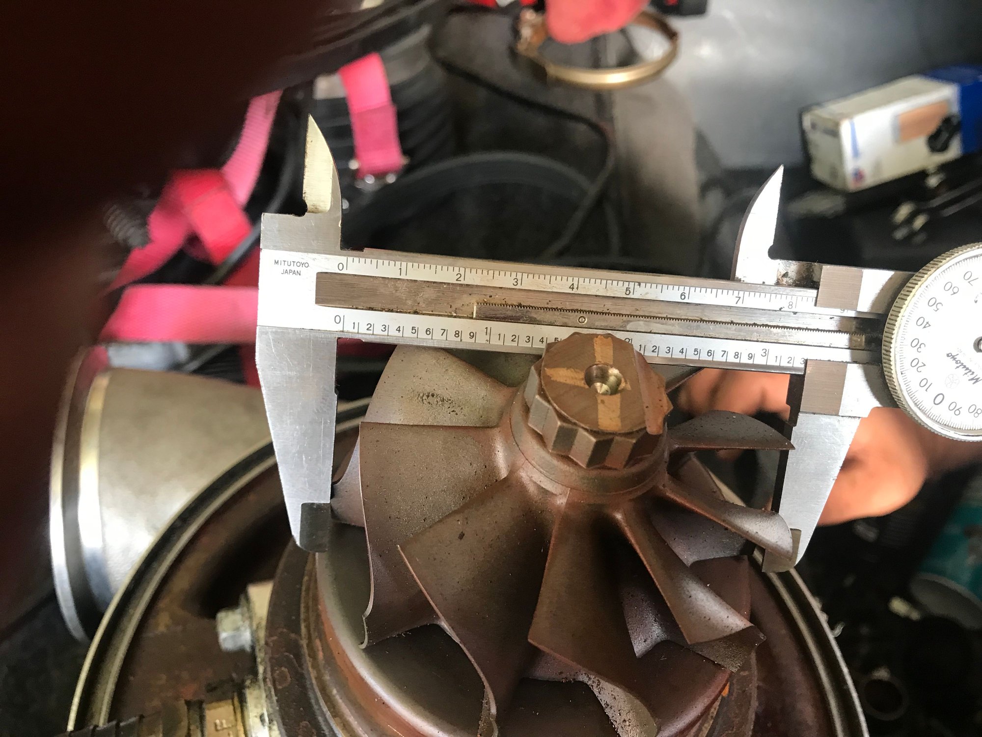

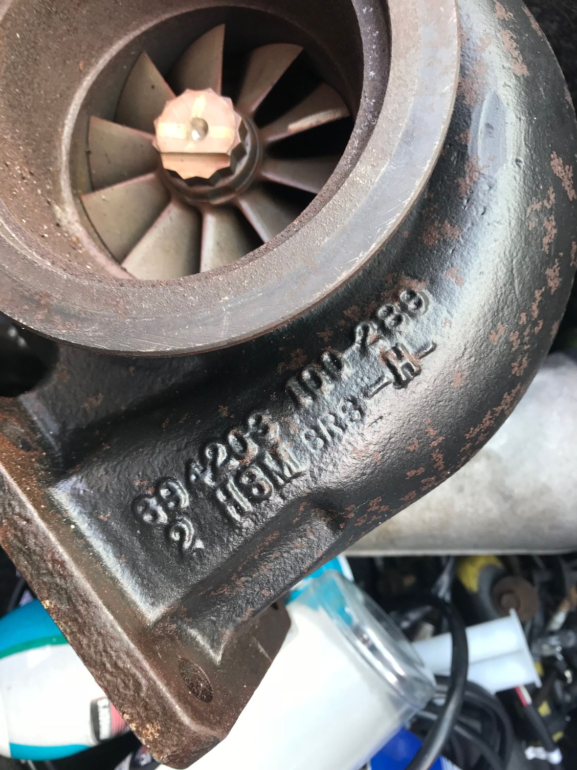

Originally Posted by jordoza
Pull the turbine housing off and measure the turbine wheel. Turbine wheel diameter will derectly effect which cam will be best for you.
This it I don’t really know much on this ?

Bad new is that turbine is pretty damn small for your 6.0 with a t4. Honestly that is an 83x75 turbine. Im putting two of those on my 6.2. That is not the best turbo for a single combo on a 6.0. It would work ok on a 4.8 maybe even a 5.3.
id sell that turbo and buy you a s475 96mm even though its a 75 instead of an 80 it will allow you to make more power. Sorru for the bad news.

Just as an aside also remember borg spec the turbos on the turnine side by the inducer which is 83mm but the exducer is only 75mm so it is comparable to a 75mm turbine on everyone elses turbos.
