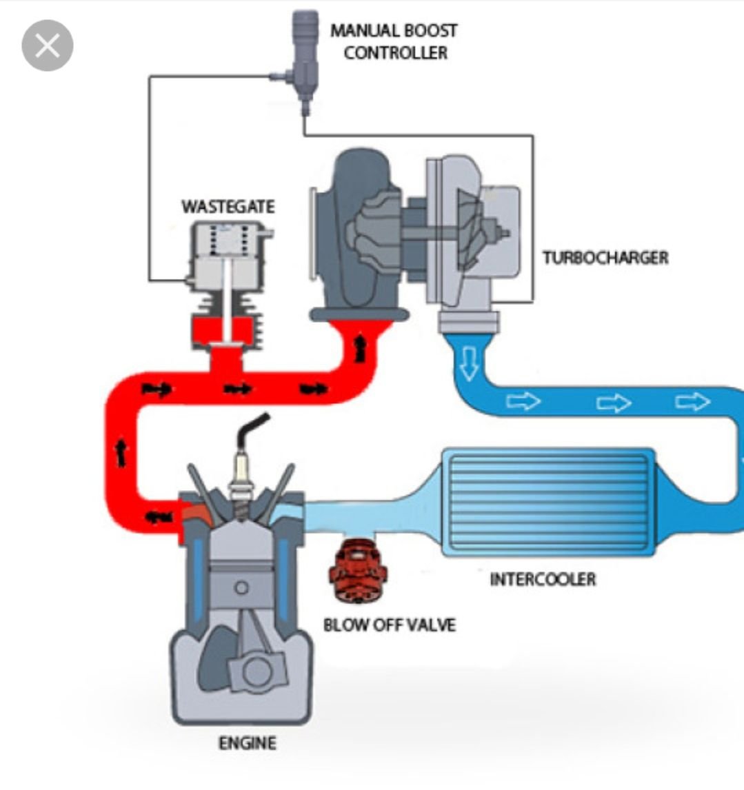

I'm a little confused as to why there is so many different plumbing options when I do a search on a manual boost controller.... I had a 8psi spring in a 44mm gate.... Hooked it up according to one diagram and it made double the spring pressure.... Hooked it up another way and made 8psi but regardless of how many turns I give the controller, it won't effect the amount of boost I make.... Someone shed some light on this for me! Thank you

Current setup
Originally Posted by JoeNova
An explanation of how you have it hooked up and which boost controller you used would help...
I just have a simple manual boost controller, nothing fancy... I've tried 2 different controllers and 3 different schematics with the same results that I posted in my 1st post.... Right now I believe I'm using the routing that turbosmart suggests..... I made 19psi on a 13psi spring tonight trying different schematics

The diagram you have is how I hook mine up.

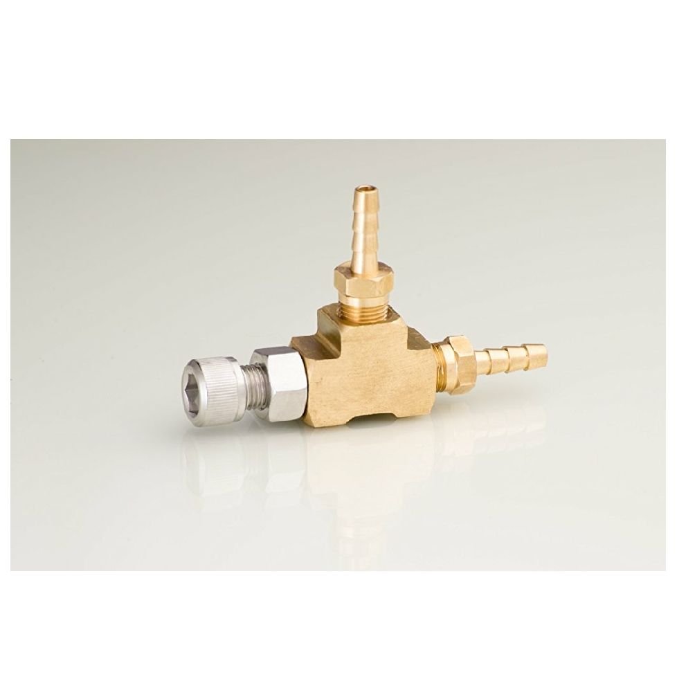

That is a **** poor boost controller. A $15 ebay special would work better. Also, if that one has no bleed hole in it, then you have to install a T on the line going from compressor to wastegate and then T off to the boost controller instead of putting it inline.

I had a cheaper eBay one, I bought this cause it had better reviews to try and rule out the controller itself.... This controller has a bleed hole on.the side of it so I shouldn't need a tee correct?

As long as it needs a bleed hole, you don't need to put it on a T.
Just a slight difference in the above pic, your bboost reference is to the intake manifold, not the turbo compressor......

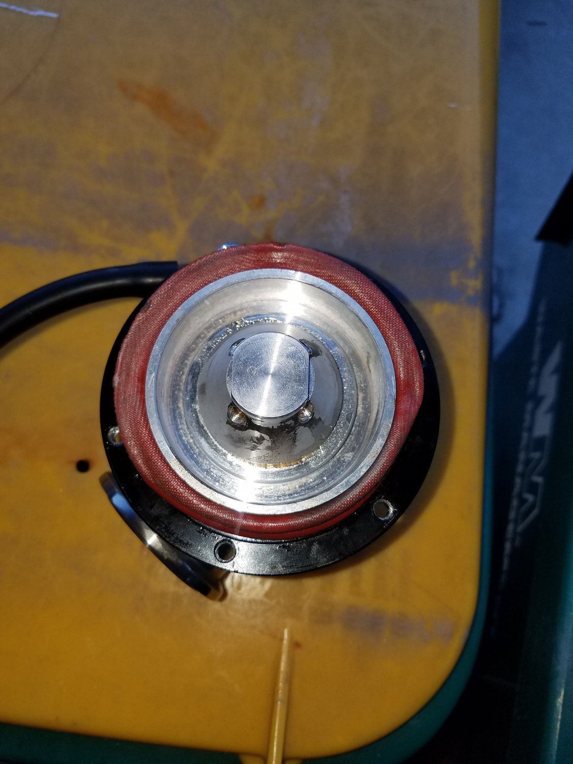

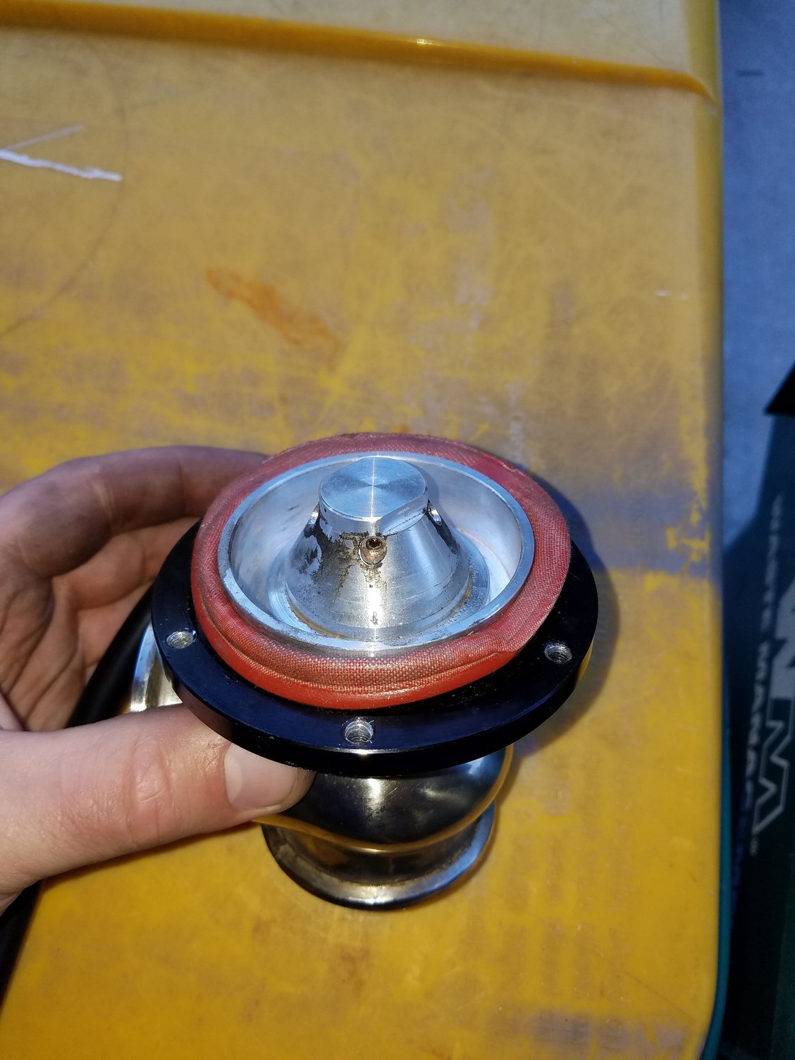

So I think I've narrowed it down to a waste gate leak....
1st red flag
Does this what I'm assuming is called a diaphragm is suppose to look like?
2nd red flag
I hooked up an airline to the inlet port and I could hear air pouring out of the area where the rod goes into the waste gate that has the exhaust valve looking thing on one end.... I'm guessing there's not supposed to be air escaping here??

yeah all my china gates have pissed air out of the bottom past the valve guide. i dont think it's that big of a deal.
looks like maybe it was pinched though or did it fold after you disassembled it?
