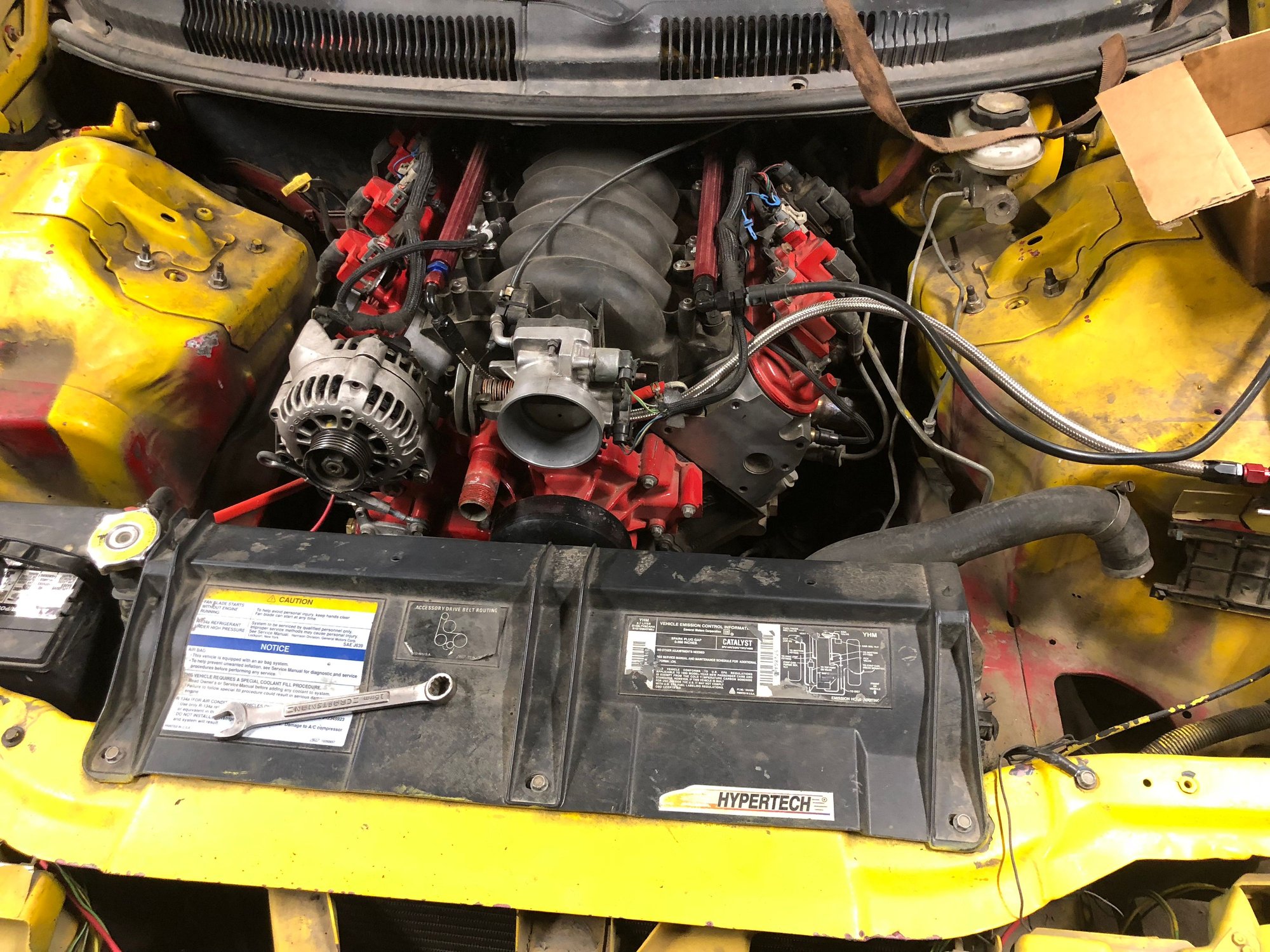

D ifficult to see but this setup was literally free if you have the truck stuff. Stock truck water pump modified by plugging the top outlet and tapping the front cover for a nipple, and two turn buckles for tensioning the alt.
been together like this and no issues for a few months now
