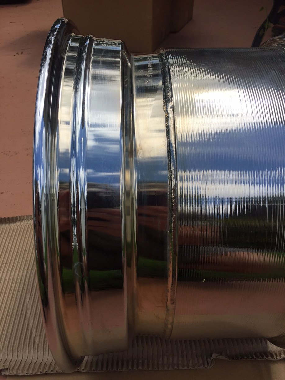

I already sent my 18 x 10.5 rims to a shop in California to get widened to 12.5".
Thing is....its not a cheesy Weldcraft or other typical widening job. This shop does it the right way with a complete donor inner hub. They have strict weld requirements and measurements. They do side load testing and high speed balancing. They weld both sides with double weld lines. This is not the ridiculous metal hoop that they just weld into the hub somewhere after they cut it in half with a sawz-all or band saw...LOL......that is utterly dangerous and weak and does not pass factory side load testing.
You have to send him your rims for an inspection and measurements of all thicknesses and whatever else they check, then they let you know if they will widen your rim. Its amazing work and my rims look like they came from the factory. You can't tell he widened them unless you really look for it. If the rims were just sitting there its hard to see that it was widened.
This guy widens rims for road race cars that take serious beatings in the twisties.......Only $225 per rim.
