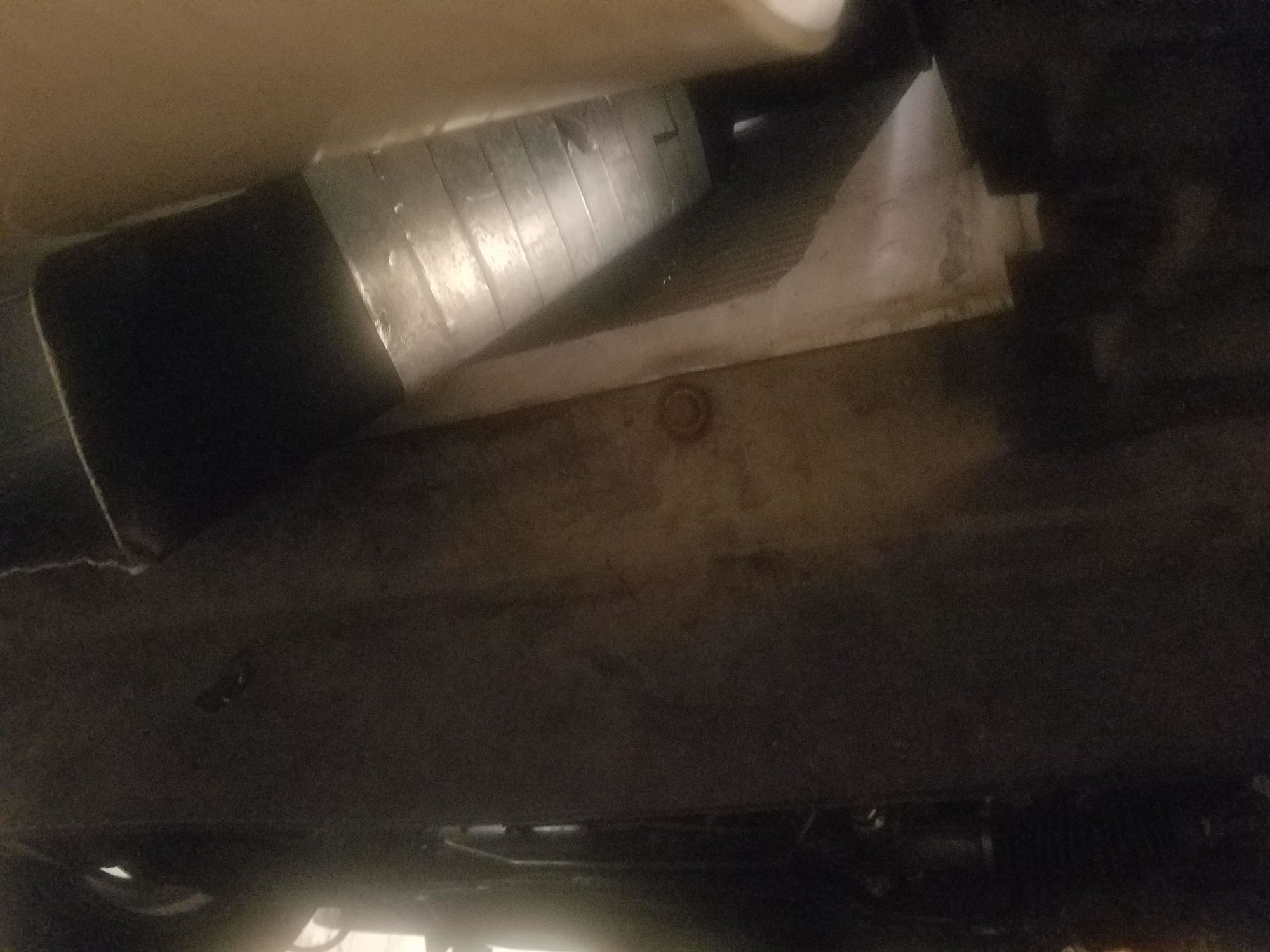

I bought it from Speed Inc. First pic is from them, others are from mine. Mine is all messed up cause I had it in the garage laying around. I put some heat shield tape around it, just for the heck of it. I have the non ac version. Just to let you know, the reason I had it off the car was because I live in TX, so in the summer it gets real hot and this thing sits in front of the radiator so I was seeing temps go up to like 210, I'll say. Nothing super bad but my car usually stay around 180-185 summer time. But now I had the fans programmed to come on sooner and I also have an slp fan switch, so I can put the fans on high or low between passes in the staging lane, plus is already cold here, is 33 degrees right now. Just a heads up!

Lol I can’t tell what I’m lookin at. What does non ac version mean?

Lol no prob. The non ac version is bigger, wider so more air can go through, but in order to use it you have to remove the ac condenser which sits in front of the radiator, if not it wont fit. They have an ac version which fits in front of the ac condenser, so you can keep the ac but it not as big. So just to let you know the second pic is the intake from under the car, so you see the intake, in between the radiator and the bumper (notice the air dam), thats how it goes all the way down. 2nd pic is through the intake from above and the last one is how the intake sits on the airbox. Not the best pictures I know! There are other companies with similar versions but I think these one was the only non ac one.
