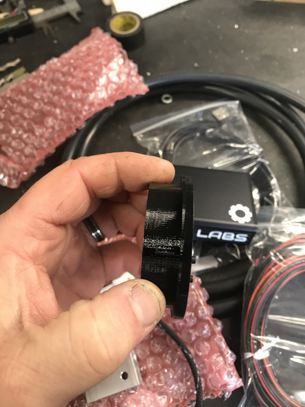

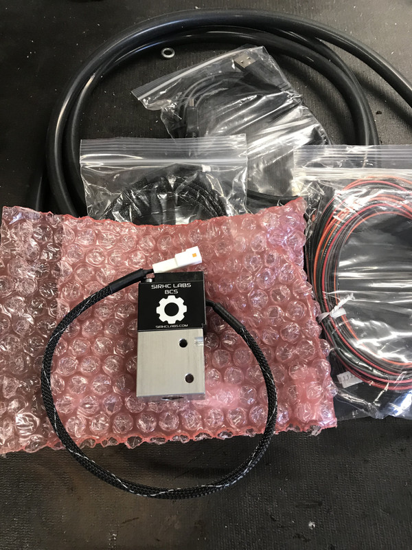

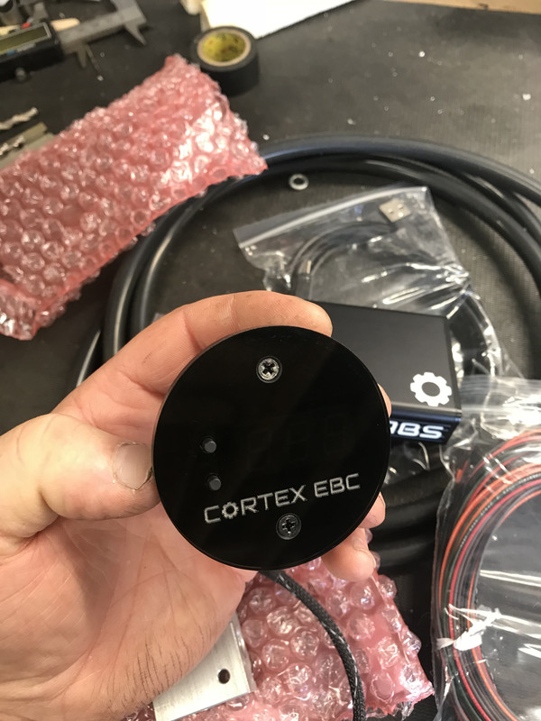

So basically what you can do is set your desired pressure for each gear. That’s using the basic setting. You have other options. Another neat one is the rpm vs tps. You can set boost at whatever rpm you want it to come in and what throttle percentage. Each gear has its own settings. Has overboost protection of course. I’m not even scratching the surface of what it can do in my car, but it’s alot of different options. If your looking for a boost controller that does real boost by gear, this unit is definitely worth checking out. I’m going to try and get some video of it for you guys. In the meantime here’s some pics
What comes in the box
Display. It does light up red but I’m getting a green one made to match my gauges
Here’s the control box

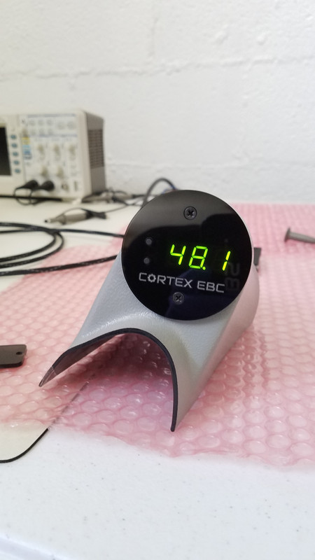

Check this out guys. My gauges are green and the red didn’t match so I asked for a green one. Chris at cortex made me a green one. Here’s the pic he just emailed me. That’s pretty awesome of him! I’m excited! Check it
