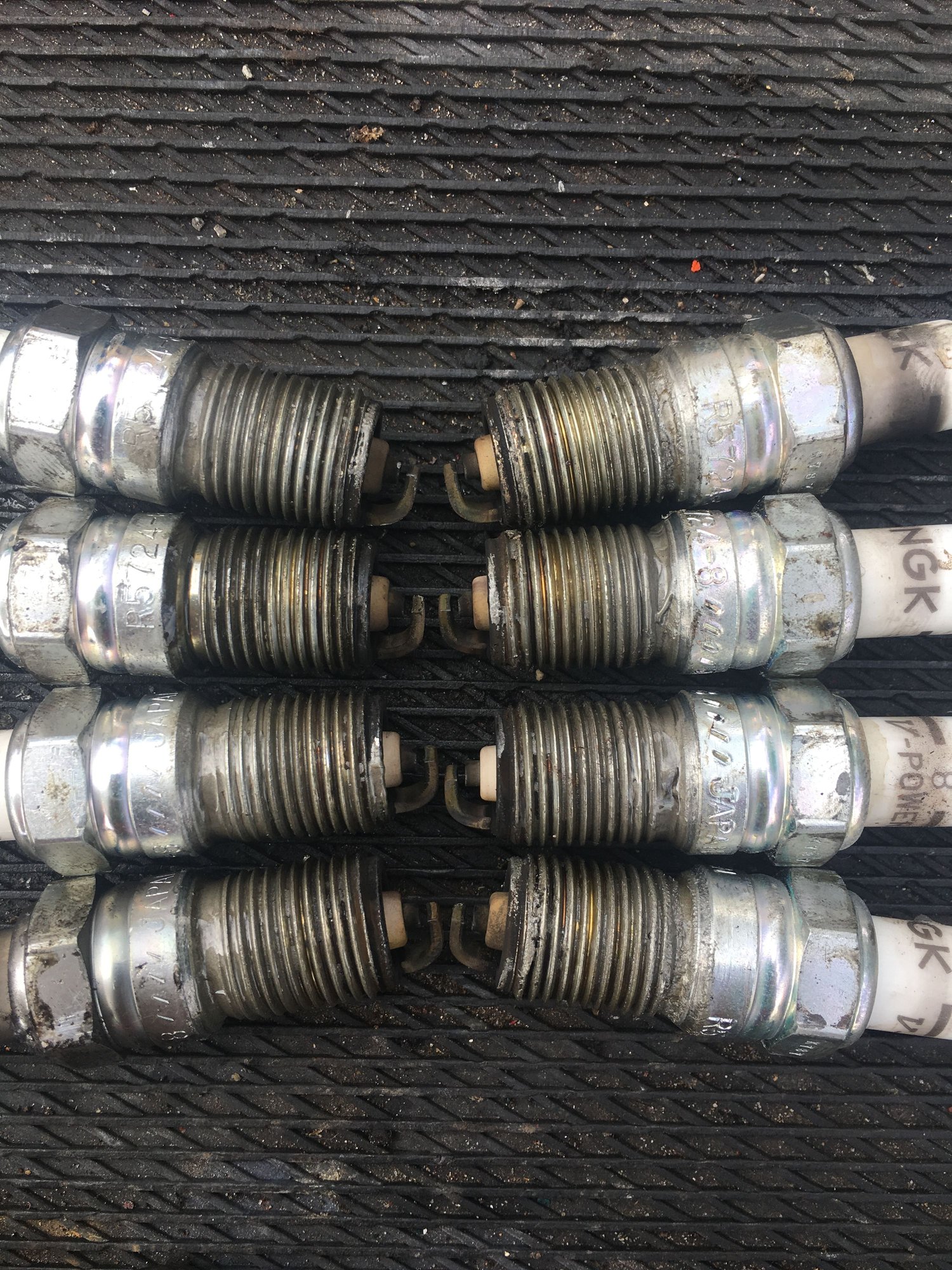

What do the plugs look like? Stock cam and ~9:1 CR?
plugs arent bad, i just had them out. distribution isnt great, #6 is the leanest. plugs are in order in the picture and have many thousand miles on them. they are tr8s
im constantly moving the tune around and ive never been to the track or dyno. its an awd pickup so the dyno isnt really feasible plus im too cheap for that kind of expense.
I drive the truck a ton and the plugs are a real pain to get out, but i need to get off my *** and read them if im so insistent on continuing to raise the boost.
its about 9:1 and cam is the cheapy elgin 220/224 112 lsa 108 icl. i ported the 5.3 heads and it has a tbss intake on it.

Can't read those plugs. You need to make a pull and shut it down and pull your leanest plug

youre right.

If you clean off the threads you'll at least be able to see how much heat is on the threads. An 8 is pretty cold with that low of timing. If you wanna mess around 1 day hit me up and we can swap your hottest plug and log.

You do know there is more to reading plugs, than just the color, right? You can see the timing mark on the strap when you look close. I always use some good reading glasses to really see what's going on.

yes i know that.
those plugs have a ton of miles on them, and the picture was taken a few weeks ago for a different reason.
i only posted them because someone asked.
