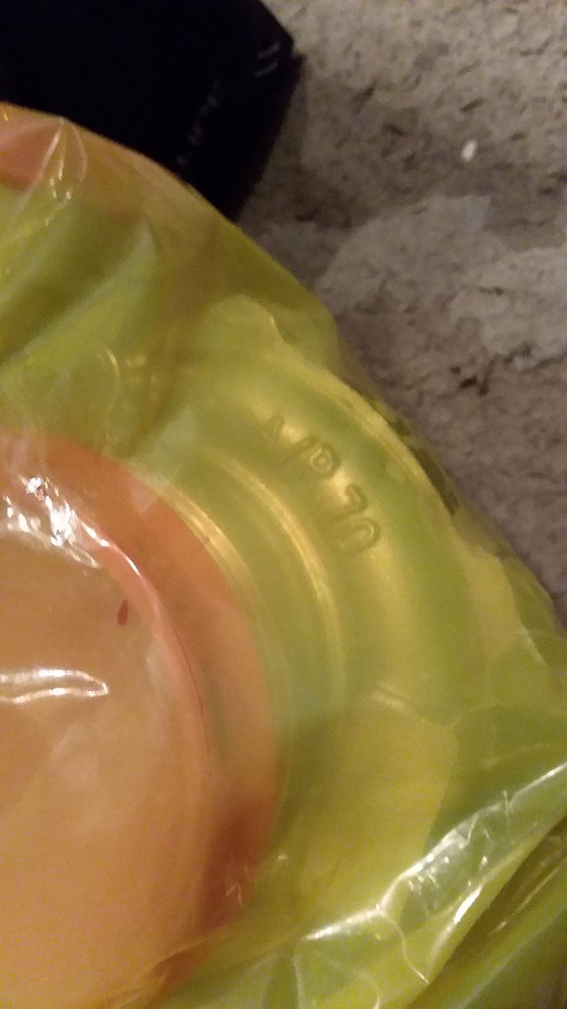

Oops, They sent me the 70mm instead of the 76mm, hoping they get my email to swap them out soon. Until then ill have to do some buttoning up around the engine but the build is going great so far, very simple and clean!
