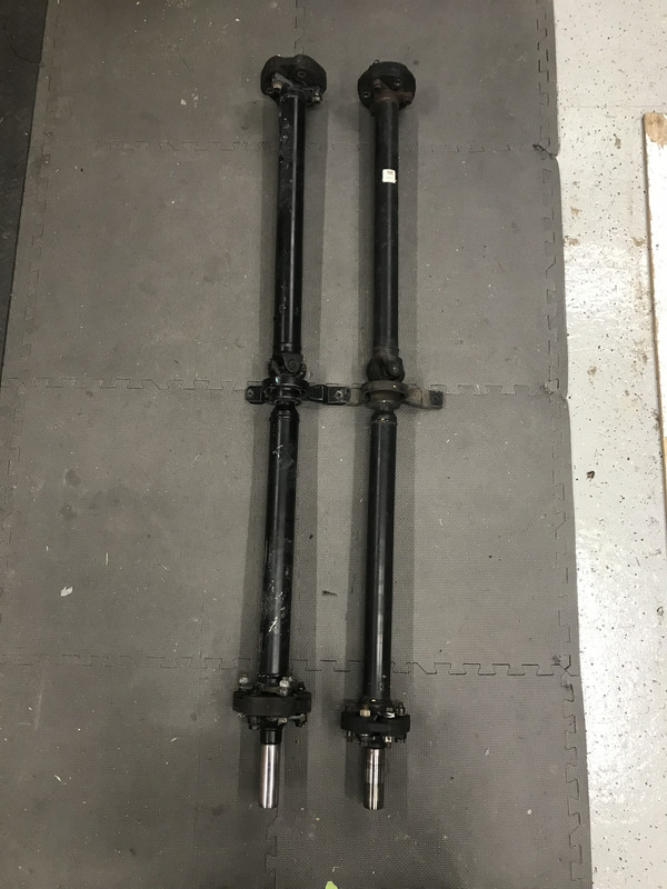

MT DRs at the power levels you are talking about will twist the splines on your halfshafts even before it breaks your CV joints. At your likely 4000lb curb weight, your 4l60 will need some sort of magic to live, and your higher stall torque converter will need a much better trans cooler than factory in order to live. With stock heads and cam I never got past 129mph in the quarter at 10#s of boost. That was, however, with an A/A IC and meth spray. I ran out of calendar pages to measure my 60' times, as I never really set up the suspension for drag racing.
Old Dec 22, 2018 | 01:36 AM
Kfxguy's Avatar
Joined: Apr 2017
Posts: 4,582
Likes: 759
From: Louisiana
good points. However.
1) I plan on upgrading the stubs. I am still running the stock drive shaft with the rubbers. Well I have a more heavy duty 06 model in the car now. I changed the rear end and the driveshaft to match. The shaft and Guibos are a bit bigger.
2) the 4l60, I’m not worried about. I built it and it’s done correctly. I built them to hold up in MUCH harsher applications. Think low 9 sec nitrous car that weighed 4000lbs with driver and put 750 to the wheels. Besides, I have tq management pulling some timing on the shifts.
3) I have a big cooler on it already. I can log my trans temp and it does not increase in temp when I make a pass. It stays 10 degrees below the coolant temp. That tells me it’s not slipping yet. Even with pulling timing on the 2-3 shift it will lightly chirp the tires. Trans is the very least of my worries. It breaks, I build it stronger. No problem.
Also, I was planning on putting a smaller stall in it anyways.
129 on stock heads and cam is impressive.
I do have some nitto nto5r tires I’ll probably run on it my first outing. I have a little voodo controller (I call my cortex ebc that because it’s like magic helping put the power down) that should help me get off the line decently quick but not too harsh. My plan on this setup is to leave about as hard as it did on motor and that netted me 1.7 sixty ft’s. Ramp it in after I’m moving.
Old Dec 22, 2018 | 08:43 AM

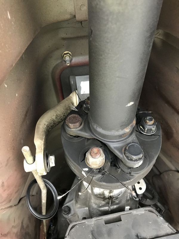

well I dunno. I shredded the 04 shaft rubbers and and center support in short order when I was not boosted. Then I swapped to the 06 stuff. Been beating the snot out of it since and now it’s boosted. I looked at the rubber stuff night before last and it doesn’t look stressed yet.
This didn’t take long at all to happen
the 05-06 is a thicker shaft, thicker rubbers and bigger diameter rubbers.

I could agree but sometimes if it ain’t broke don’t fix it. I haven’t put a driveshaft in because
1) all the vibration stories I’ve read and added noise the shaft transmits. My car is very quiet and I want to keep it that way
2) if I eliminate the cushion of the stock shaft then I’ll start breaking other stuff. I know the stubs are a problem for sure do I will replace those and the axles. Other than that, I’d rather keep it as factory and comfortable as possible.
Old Dec 22, 2018 | 02:21 PM

At least put a safety loop on it. You would be surprised how much difference it makes getting rid of those rubber parts though. I've had a couple GTO's with different setups. Daily drove the first one with a single piece BMR aluminum driveshaft. It did pick up a slight vibration at 140 mph. I have the DSS 2 piece aluminum shaft now with Sonnax u-joints and the direct fit billet blue flange on the rear it's so smooth at high speed without the mushiness of the rubber and I still have safety loops. It's just not worth cheaping out on somethings. My opinion only.

thanks for your input. I guess I don’t know how mushy it is because that’s all I’ve ever had in the car.

All the wobbly driveshaft stuff, seems to relate to those who opt for a 1 piece. They all have a very low critical speed due to their length and some questionable build quality. Why the latter seems a mystery.
A good well built 2 piece will be able to run to any speed you'll realistically ever achieve safely and smoothly. A lot of the 1 pieces seem to quote around 150mph limitation ? which is pathetic
And the stock rubbers on most cars dont seem to last very long. For parts supply in the UK, I know some guys were using a BMW rubber donut as they fitted the same and were easier to get hold of, as they are a common wear and tear item.
