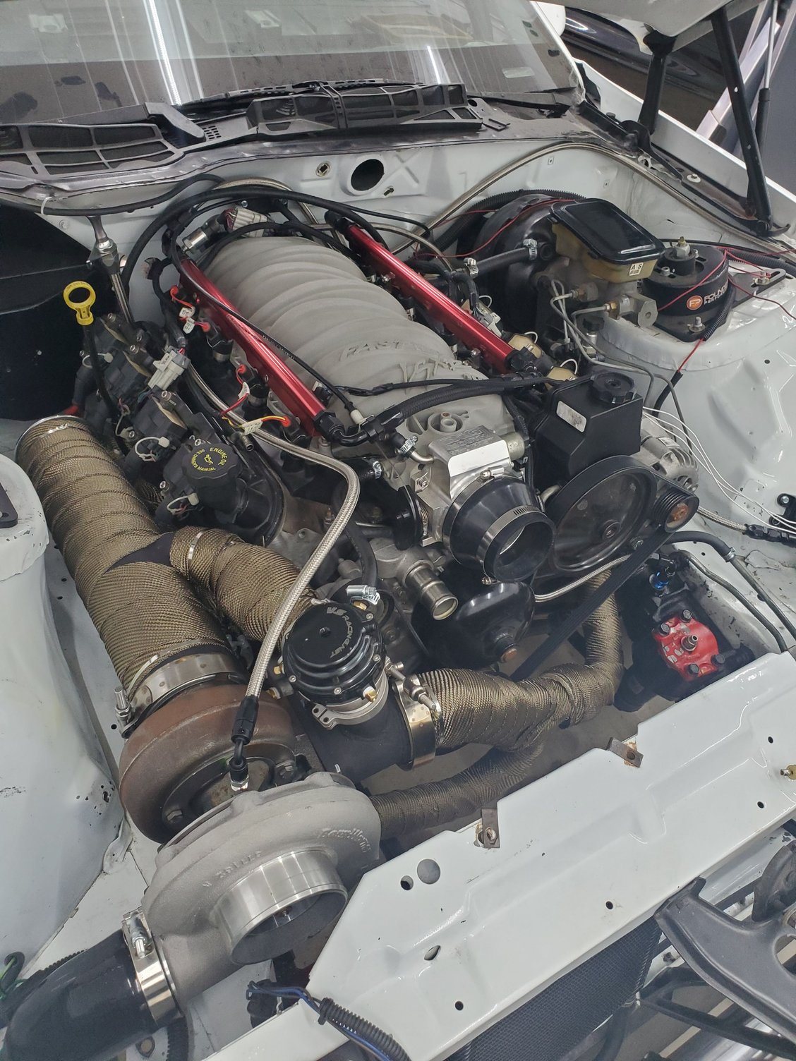

The setup is in a car I've had for years, done Drag Week, etc. I used a bunch of old parts I had including the Fast 102 intake. It's not light, with the 9" and all at 3550 raceweight.
Hotside is truck manifolds modified to fit, 2" pipes merged into a 3" to the T4 flange. VSracing wastegate, 3.5" downpipe to the middle of the trans pan. I haven't build the rest of the exhaust yet.
I data log every run with the Holley EFI, but never been on a dyno. Car runs crisp and the turbo lights off instantly now with the stock 02 LS1 cam. I tried everything with the Summit Stg 2, threw all sorts of timing at it, fuel, 2 step, you name it....didn't have much luck. I'd like to run something like the Triple 12 next year, but honestly I'd rather get all I can out of this setup just as my own personal challenge. The 10.79 was on 15psi. I'm out of fuel pump on E85 as the pressure was starting to drop. I'm switching to race gas anyway, just for convenience doing Drag'n'drive events next year.

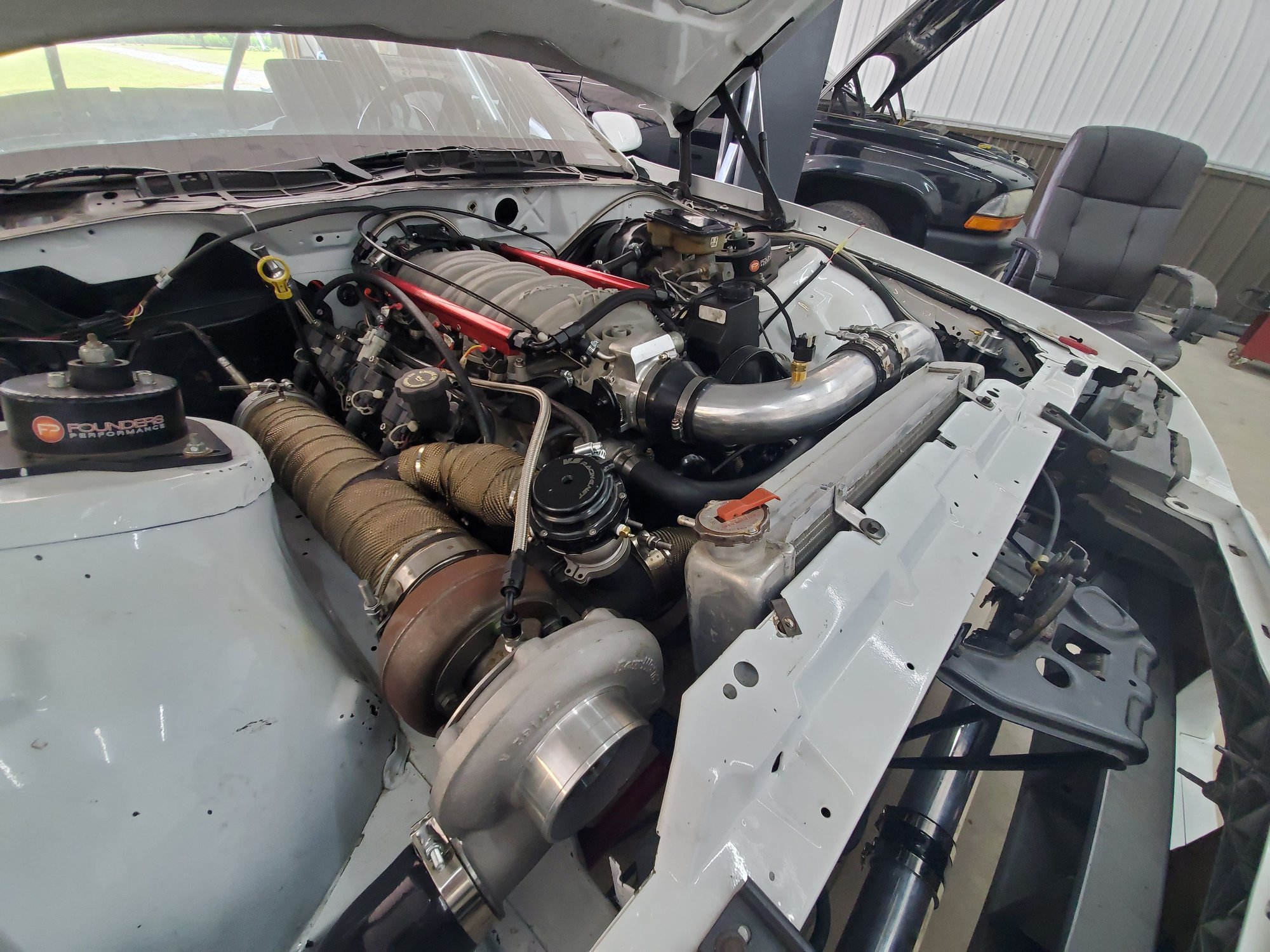

I've added the intercooler since this last pic. Knocked intake air temps from 210+ to 130 at 12psi! Crazy happy about those results.
