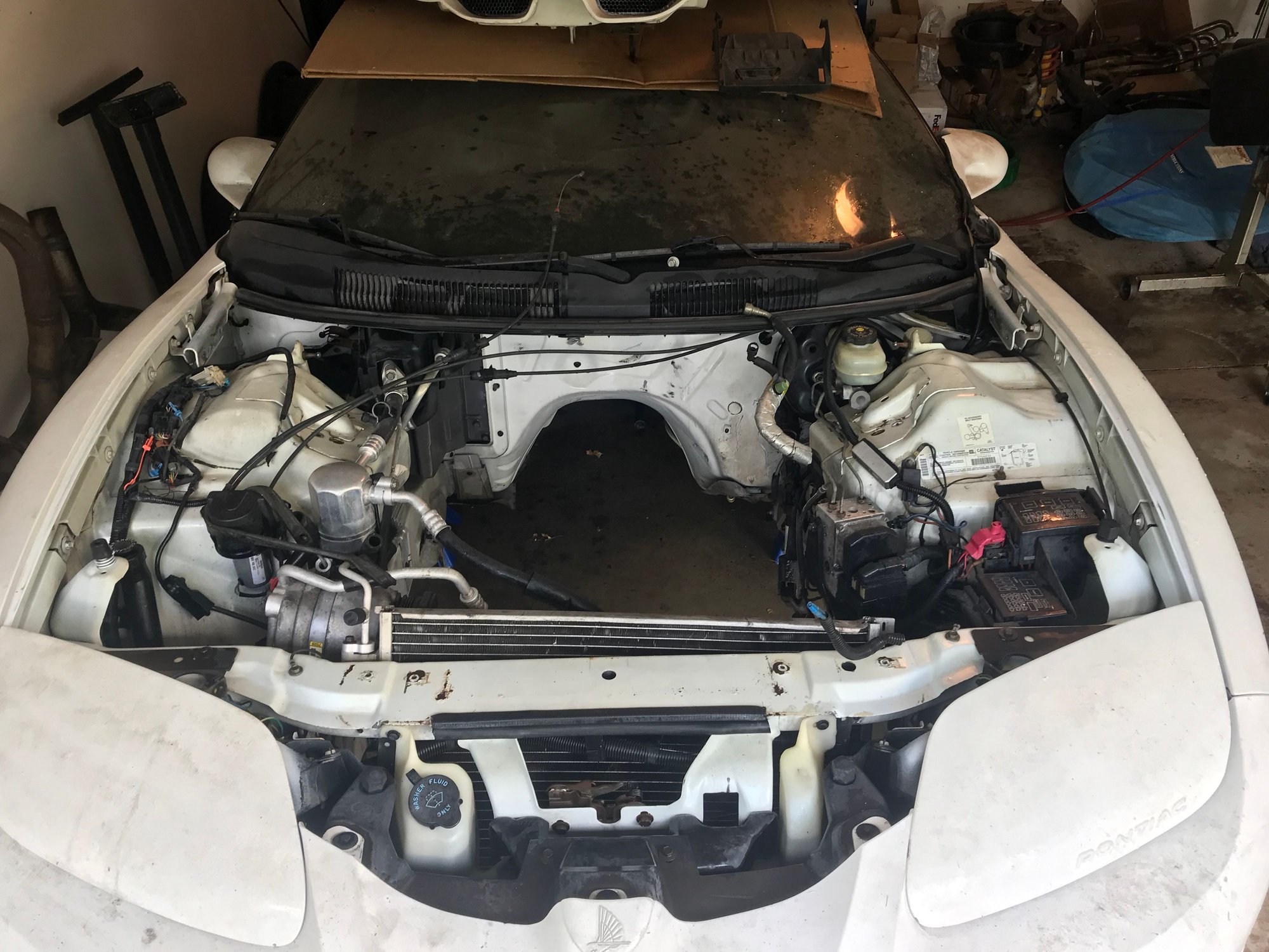

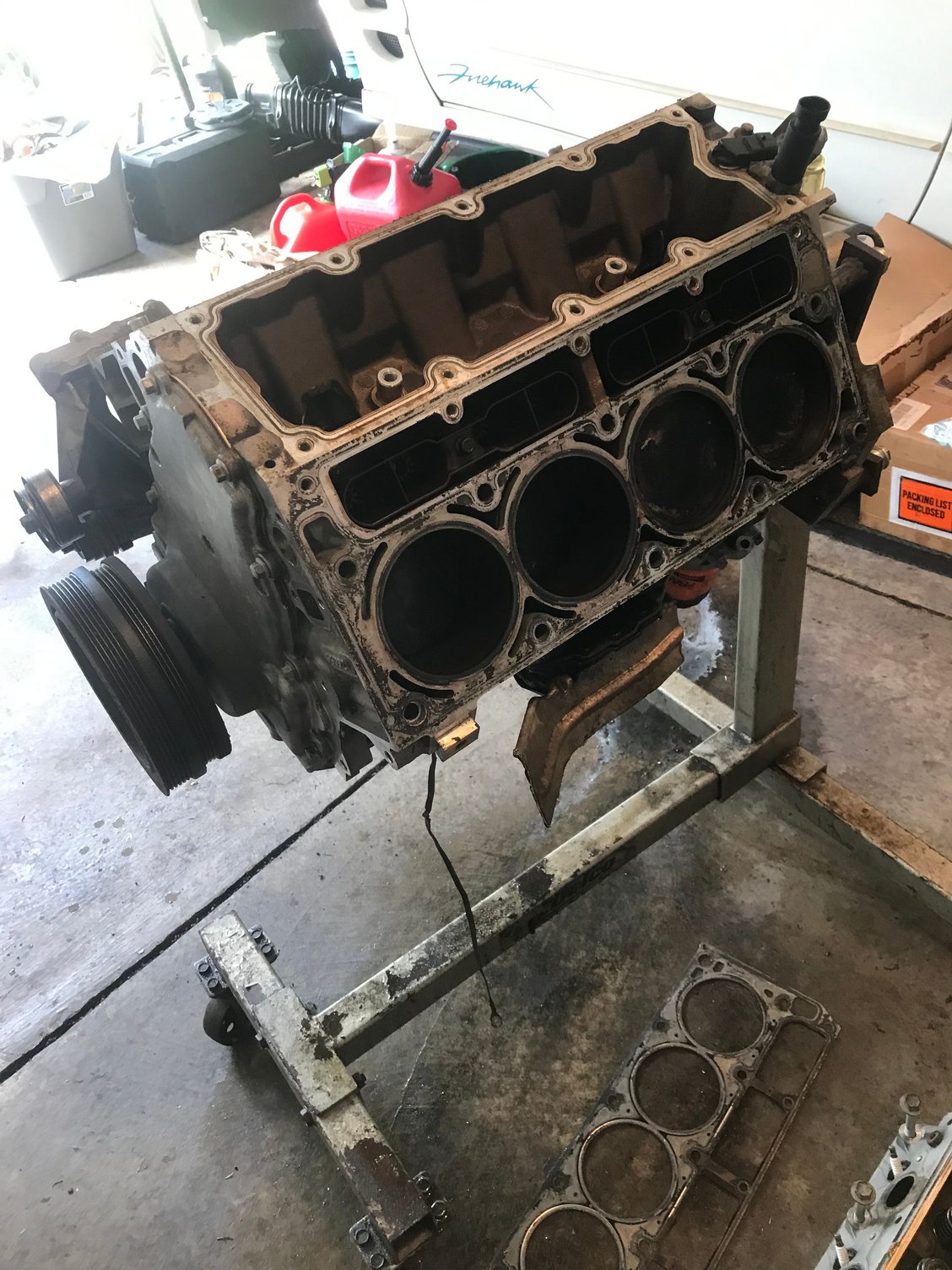

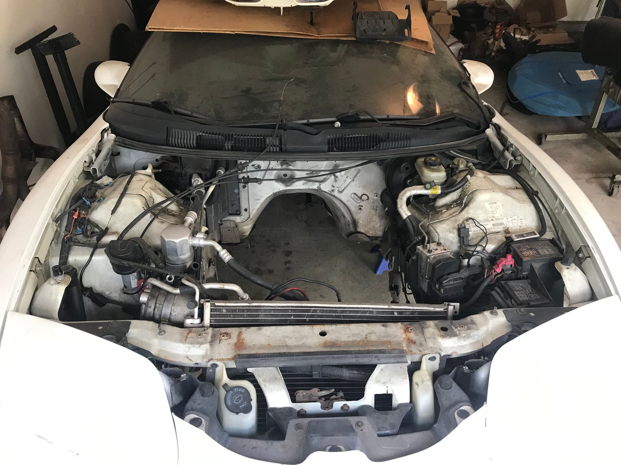

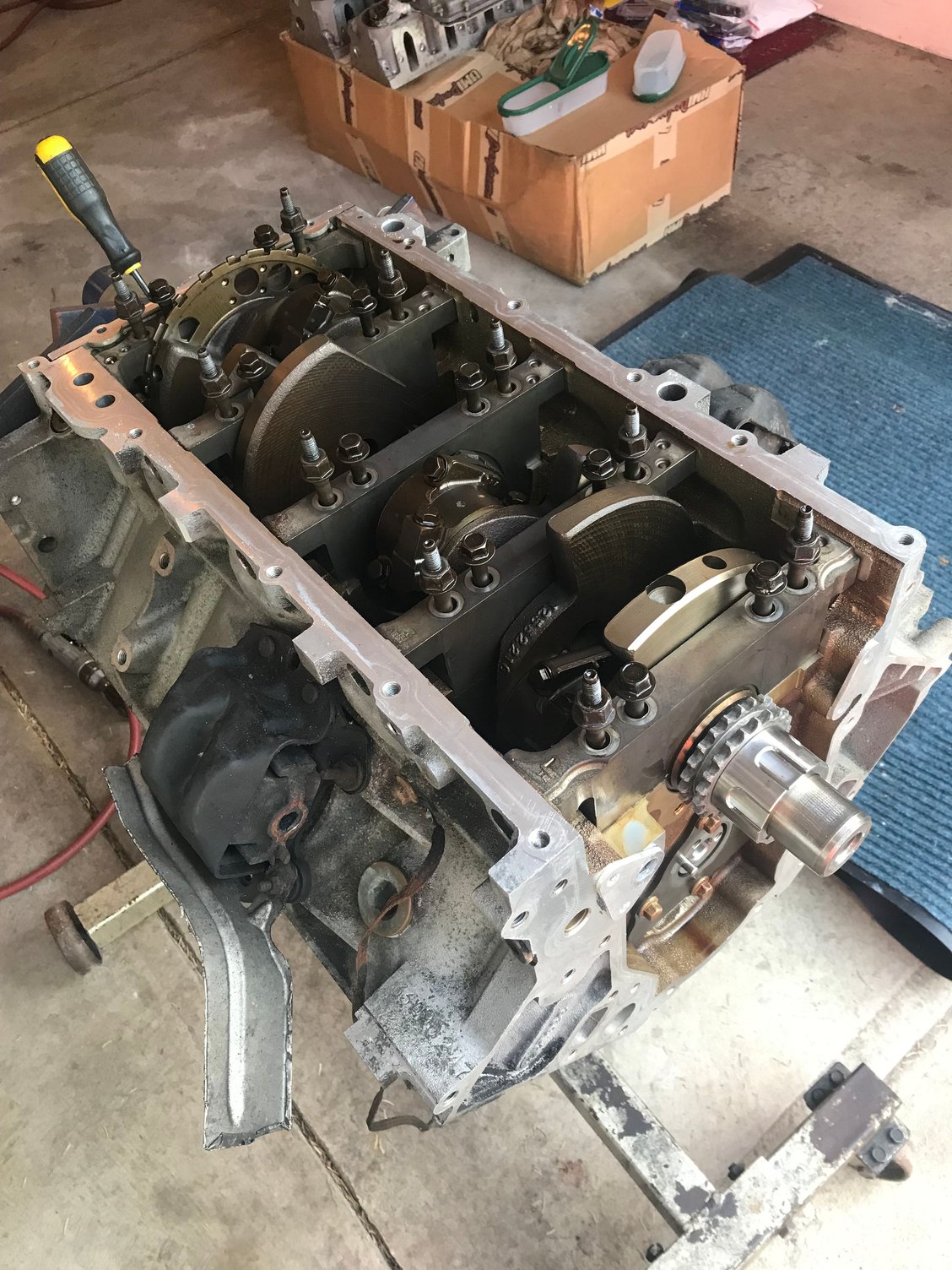

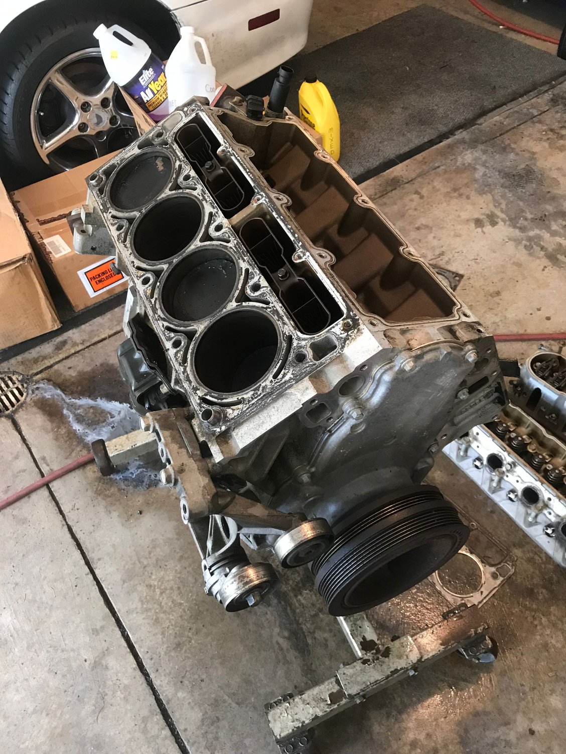

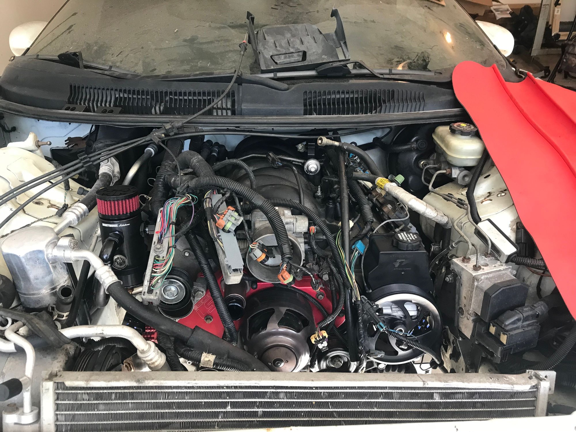

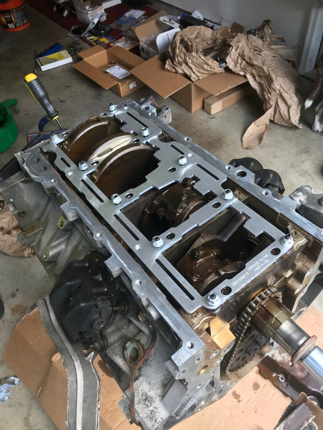

Engine and trans out. Before degreasing
After degreasing
Cylinder walls looked good - cleaned everything up a bit.
Another angle
Rollmaster double roller, ARP main and rod bolts, melling high volume oil pump.
Improved racing baffle and crank scraper - well-machined pieces!

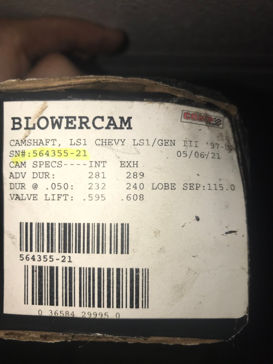

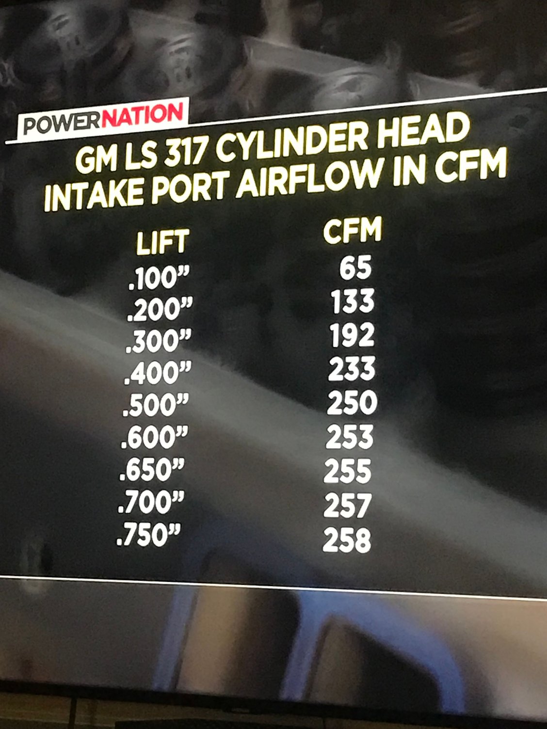

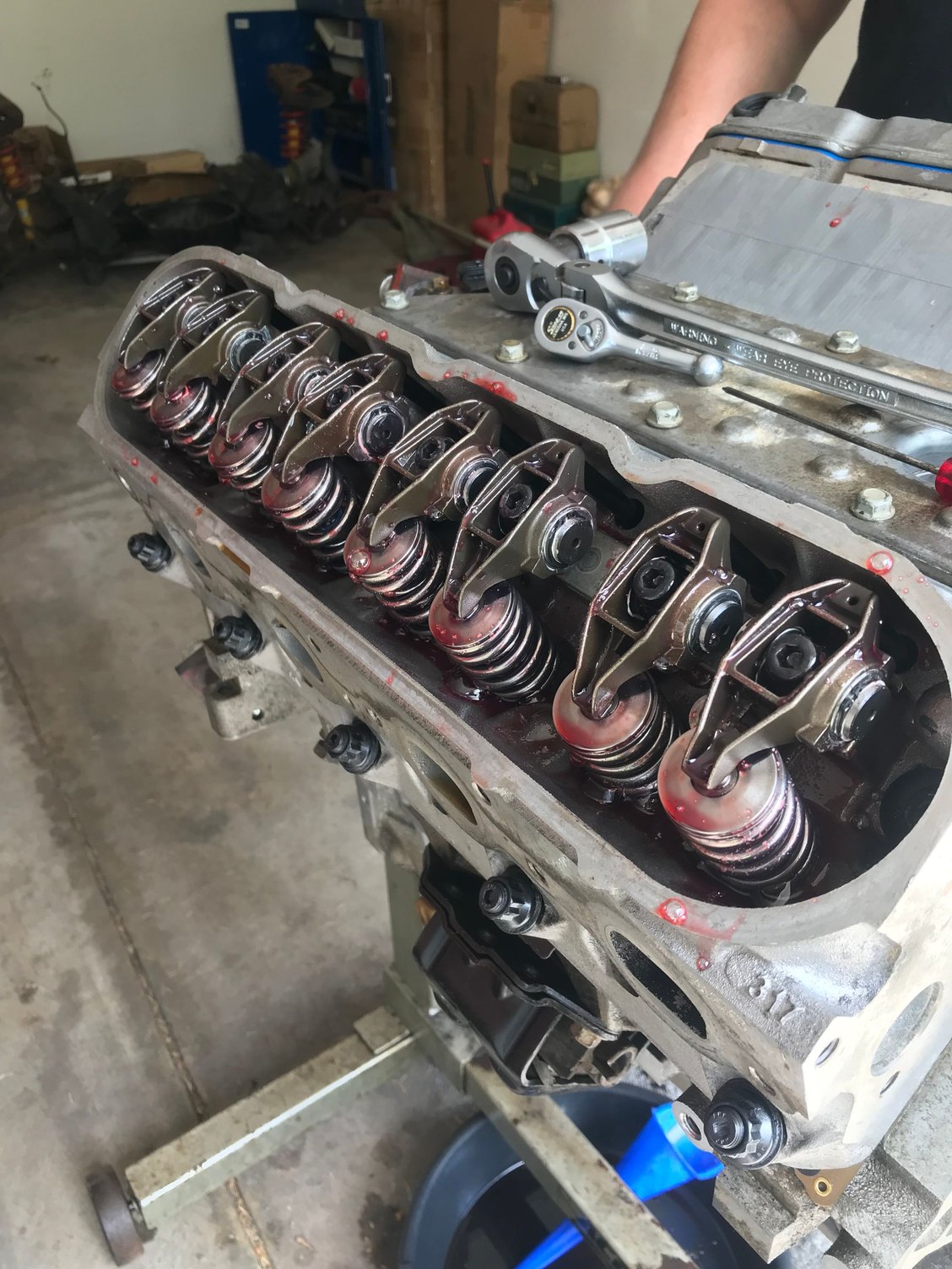

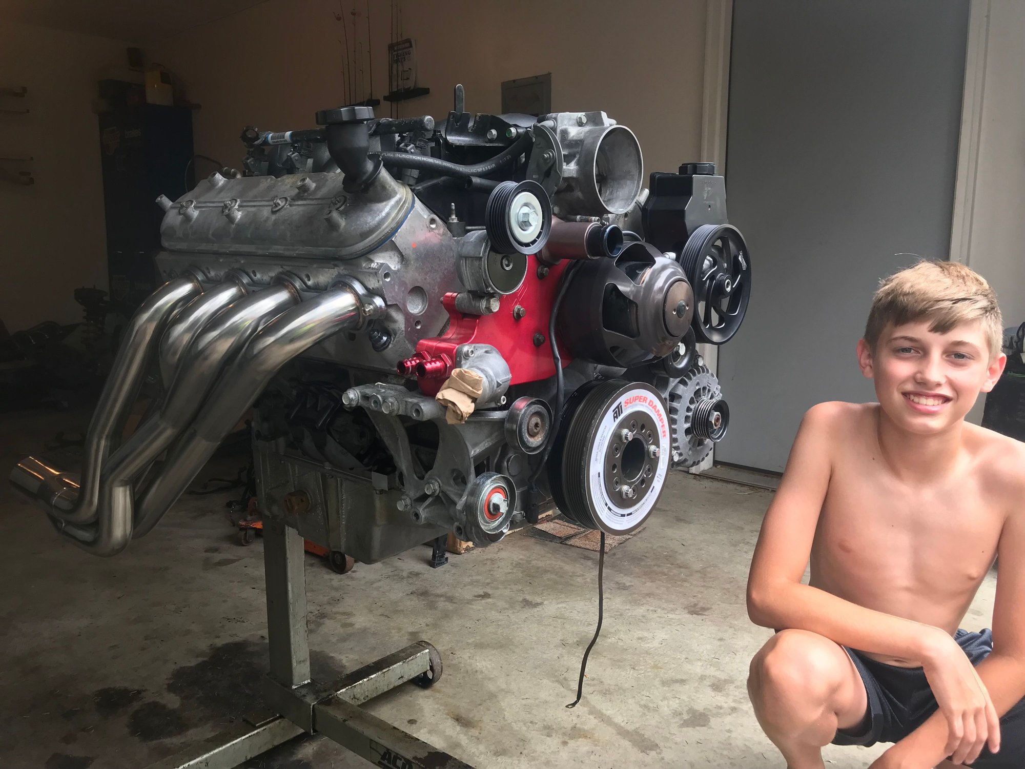

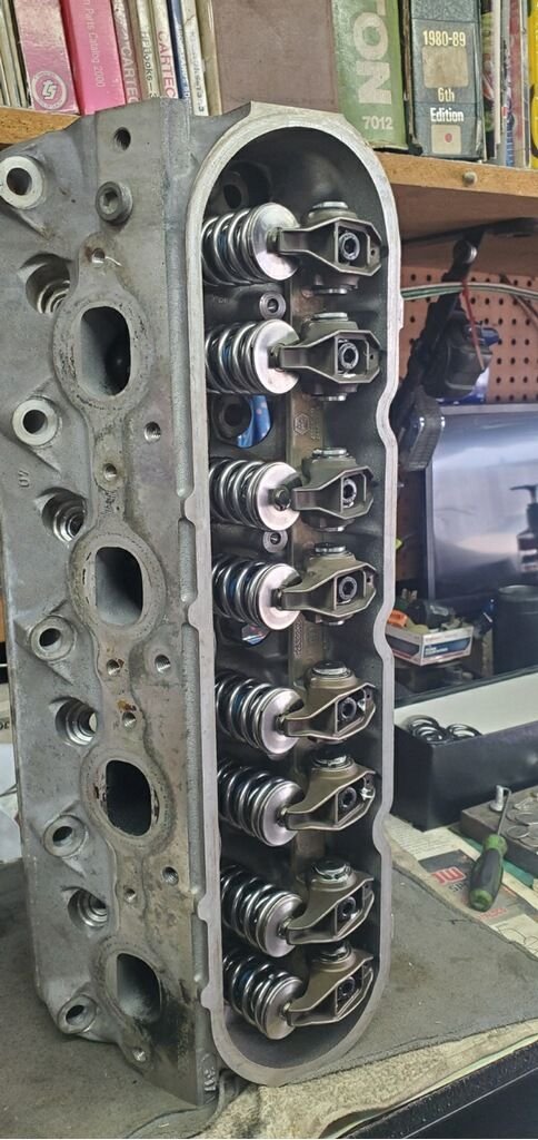

241’s are gone - 317’s are goin in. I had them resurfaced and then upgraded to .660 lift kit.
Ref for flow results off of a Powerblock episode.
Installed with ARP headstuds, new LS7 lifters, trunion upgrade to the rockers, hardened pushrods.
Cam specs - thanks to Brute Speed
He’ll remember this 10-20 years from now hopefully and look on this picture as I do now. He’s putting the headers on.
What else could I want?!?
It’s in!

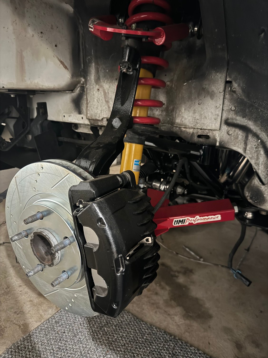

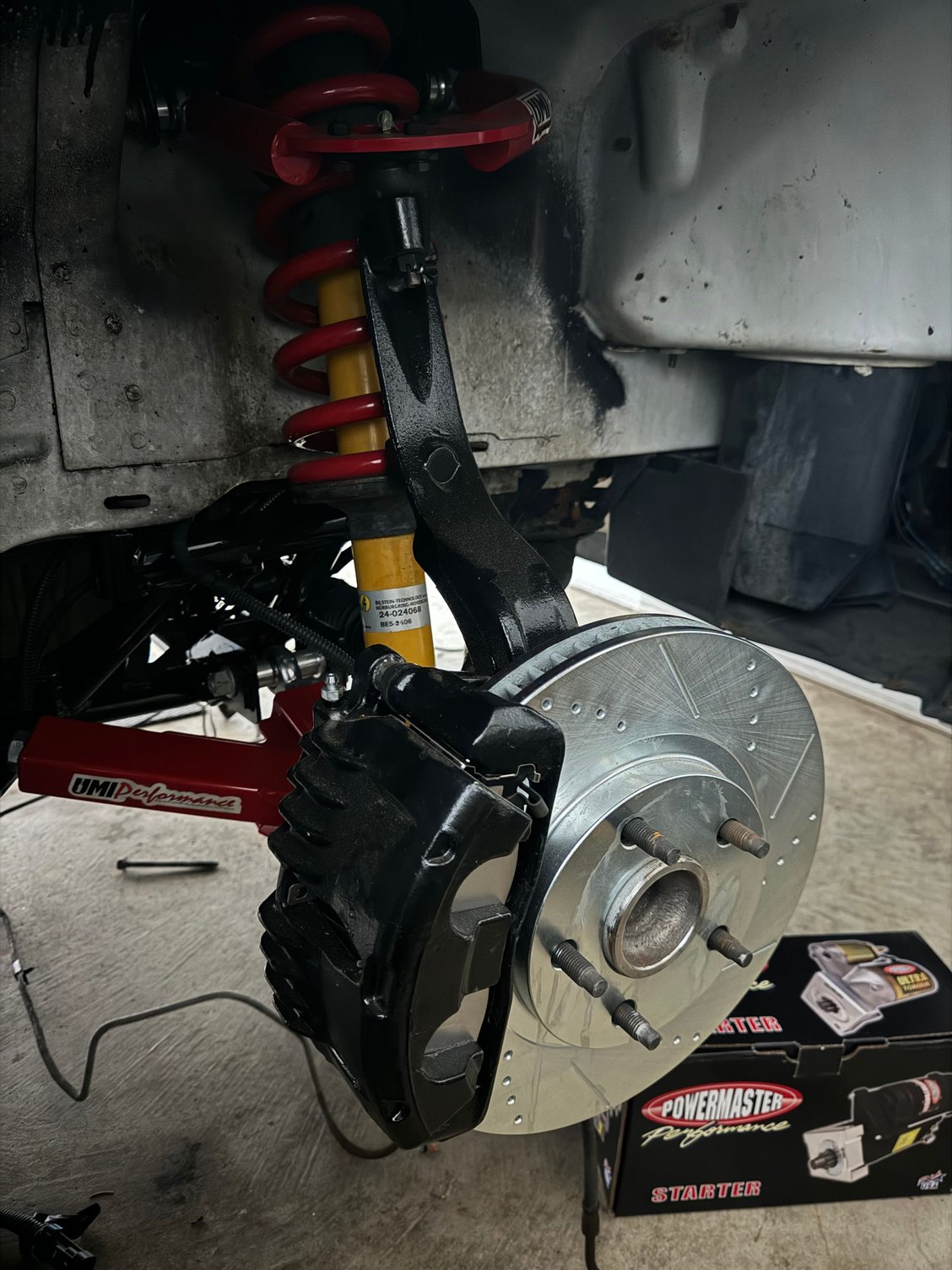

UMI double adjustable upper and boxed lowers, billsteins with BMR springs. Powerstop brakes all the way around.
Passenger side. Starter waiting to be put in as well. I’ve read horror stories of the shorter length bolt breaking the mounting ear off the block - figured for another hundred might as well get something with a little more kick.

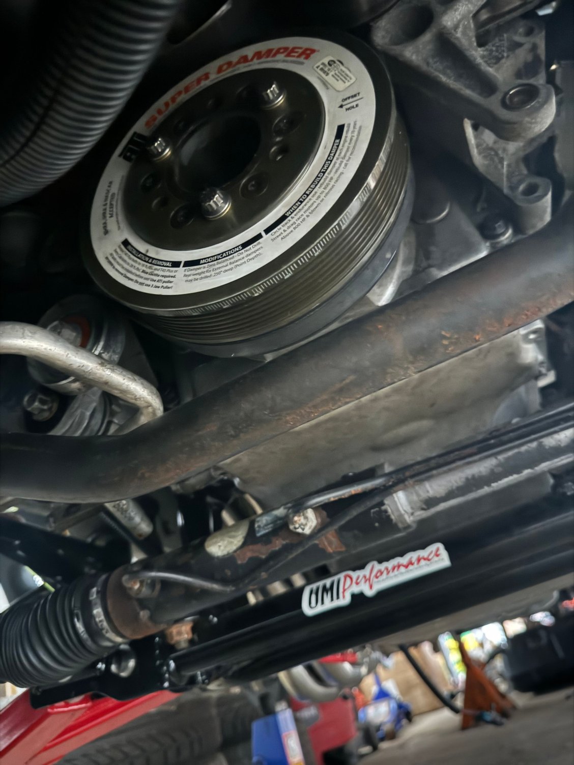

Pinned the crank earlier but a shot of the ATI dampener and UMI race kmember.

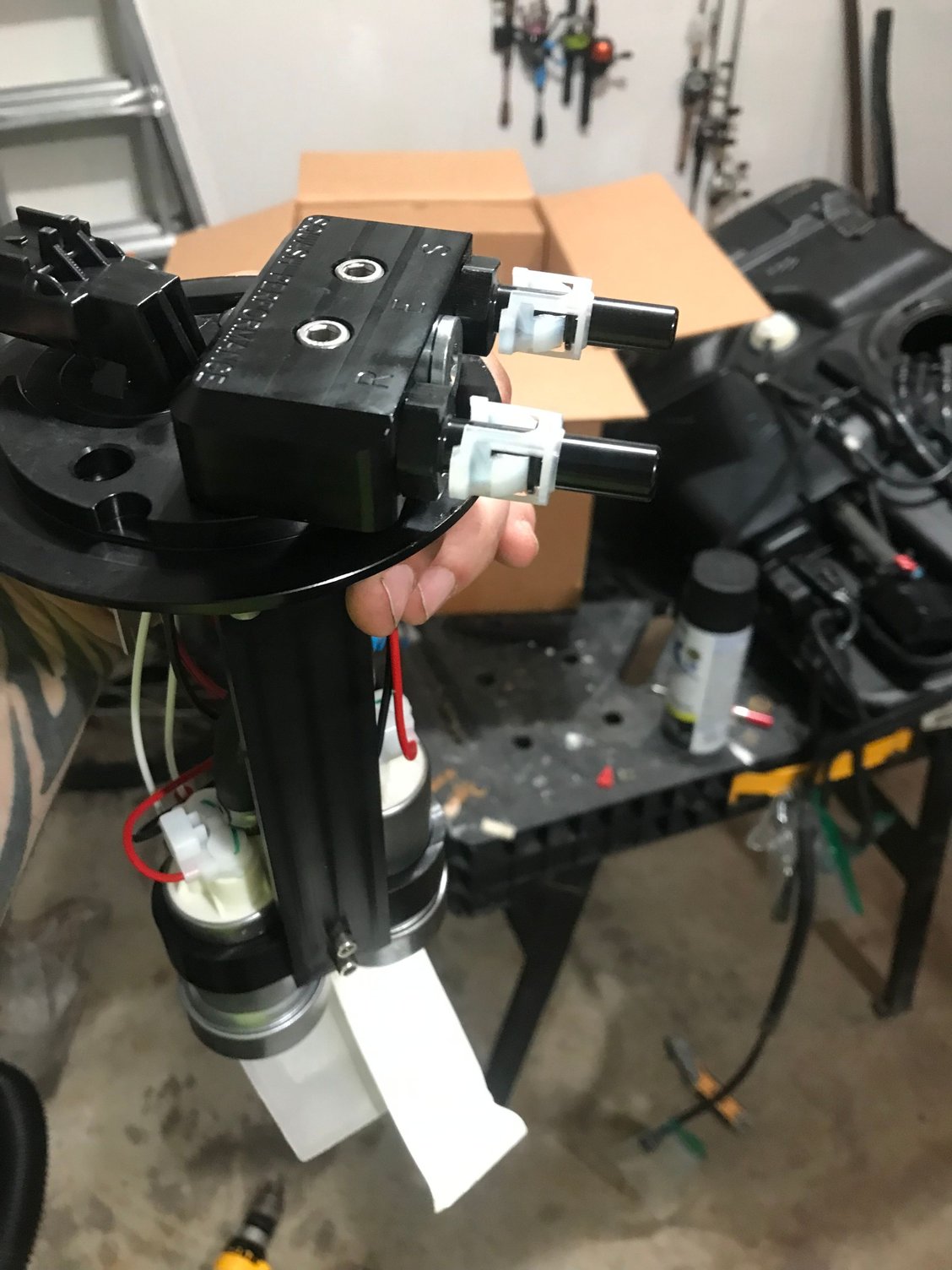

Fuel system time!
Brand new (from when I purchased it 5 years ago lol) squash dual 450’s. Hobbs switch and harness included. Changing out the feed/return to -8AN.

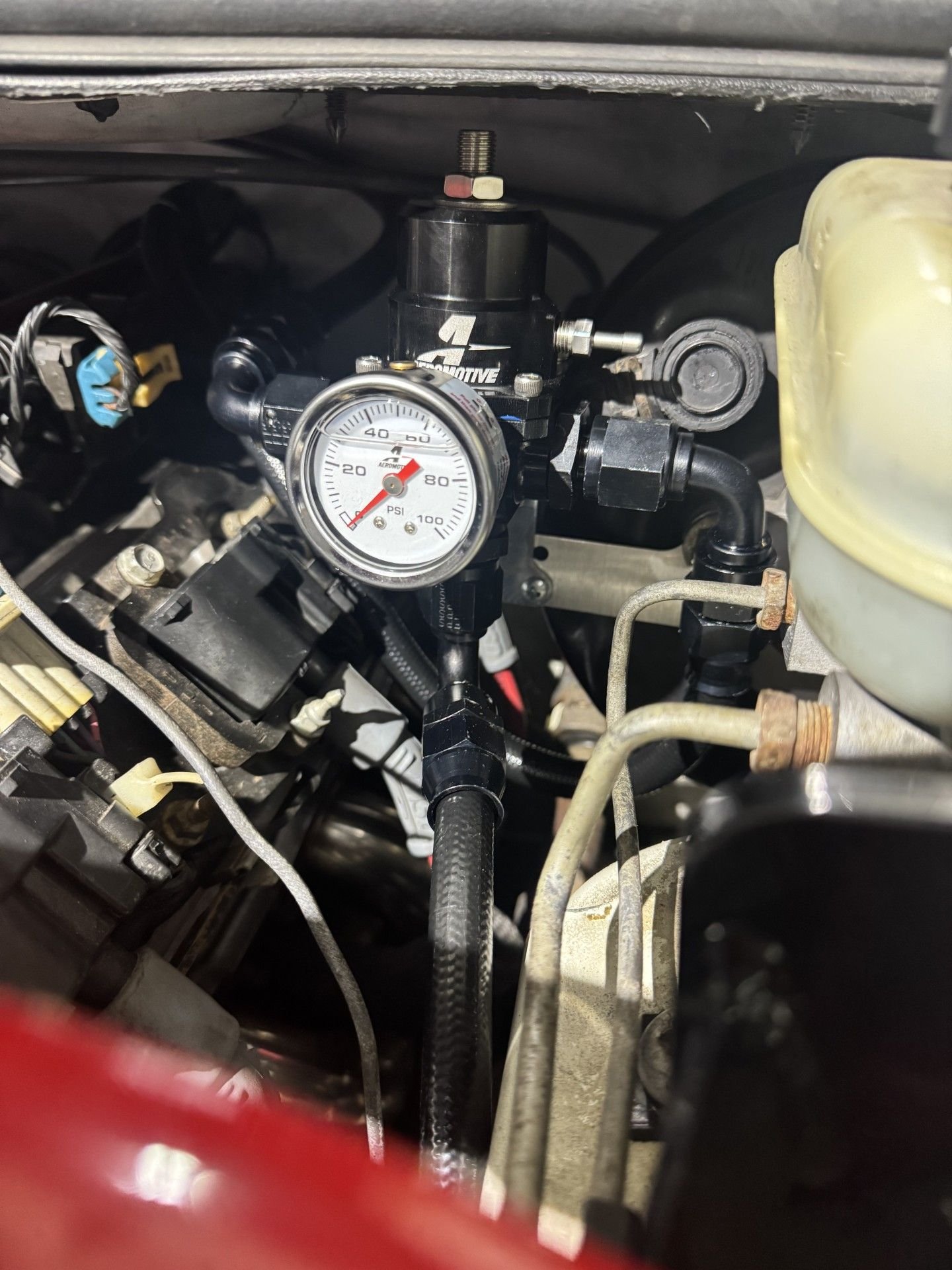

Can someone explain the difference between these two FPRs? The only difference is in the valve seat pressure. One is .188 while the other is .313. I've tried searching a bit and from what I can tell it affects the tunability? I'm going to be heading out in a bit to pick up a portion of the fuel system (Summit is having a 10% off sale on Aeromotive products) and need some guidance in this regard.
Aeromotive 13303 and 13305

The 13305 is the big dog version for use with their larger race pumps it looks like.
Look at the flow rates for each and you'll see the 13305 flows a lot more.
You'd be fine with either, they'll both maintain the same pressure but the 13305 would probably enable you to run a lower base pressure provided the return line was -08AN or larger.
I'm running a older Aeromotive BRFPR and have my base pressure set to 45psi but can't get any lower because the ports and return are all -06AN.

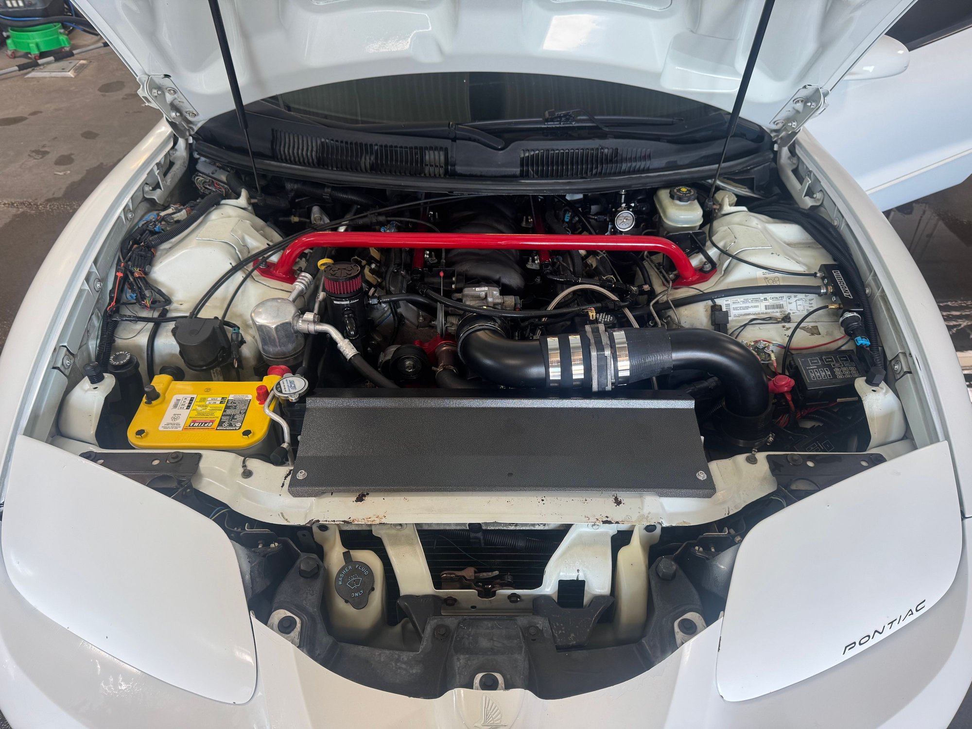

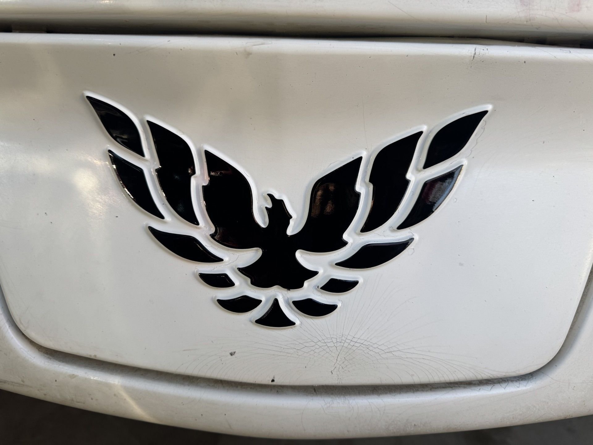

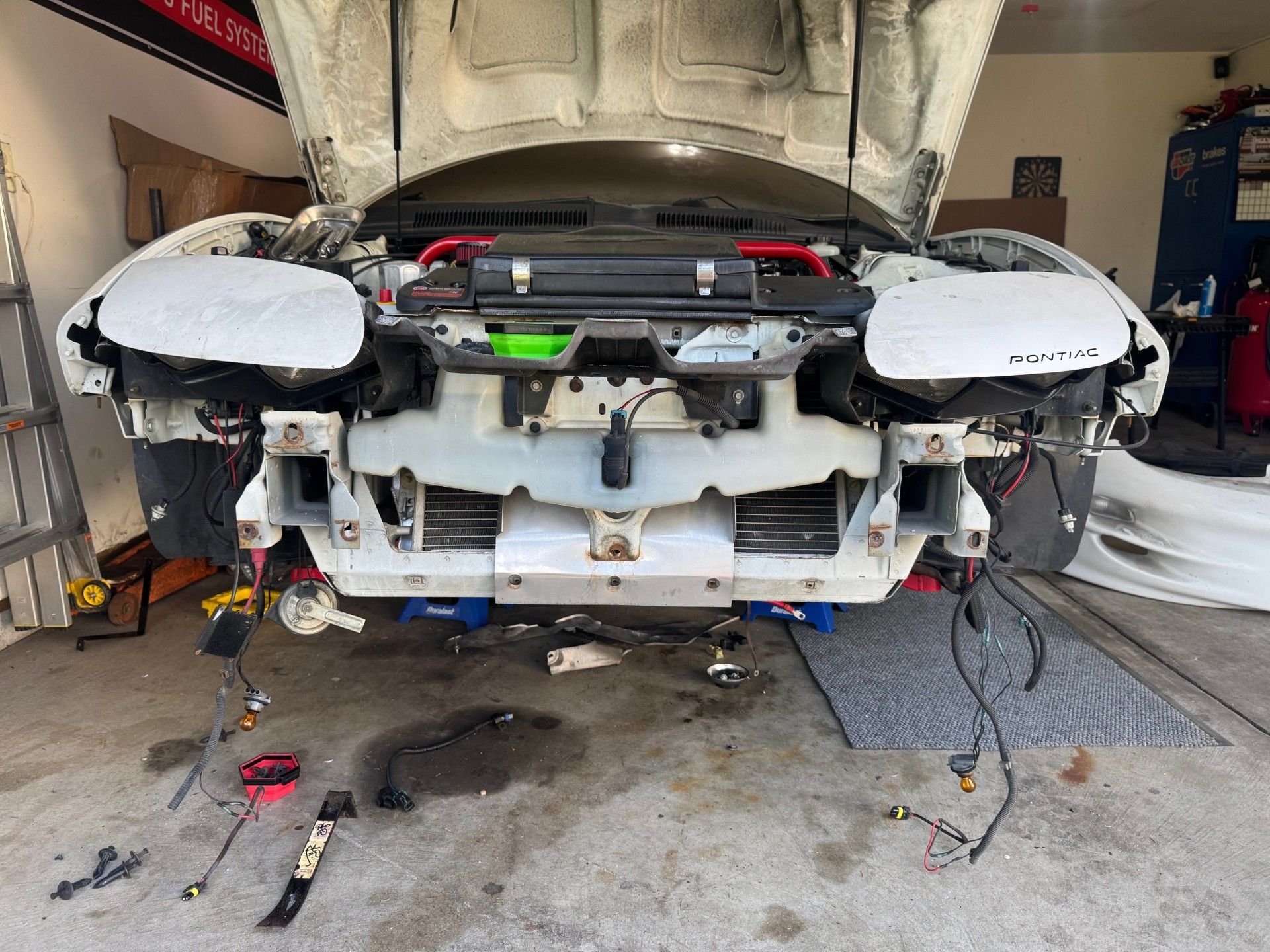

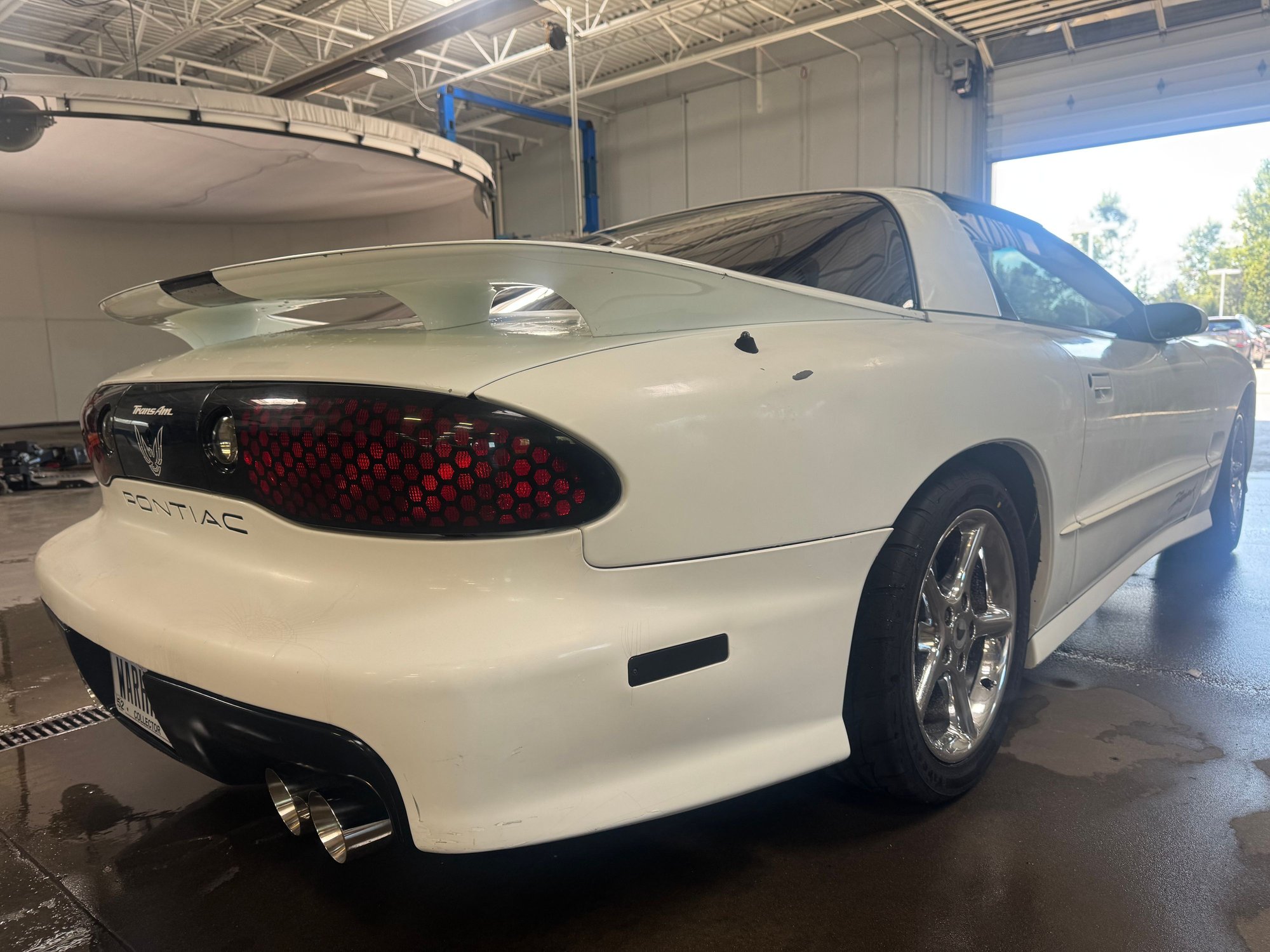

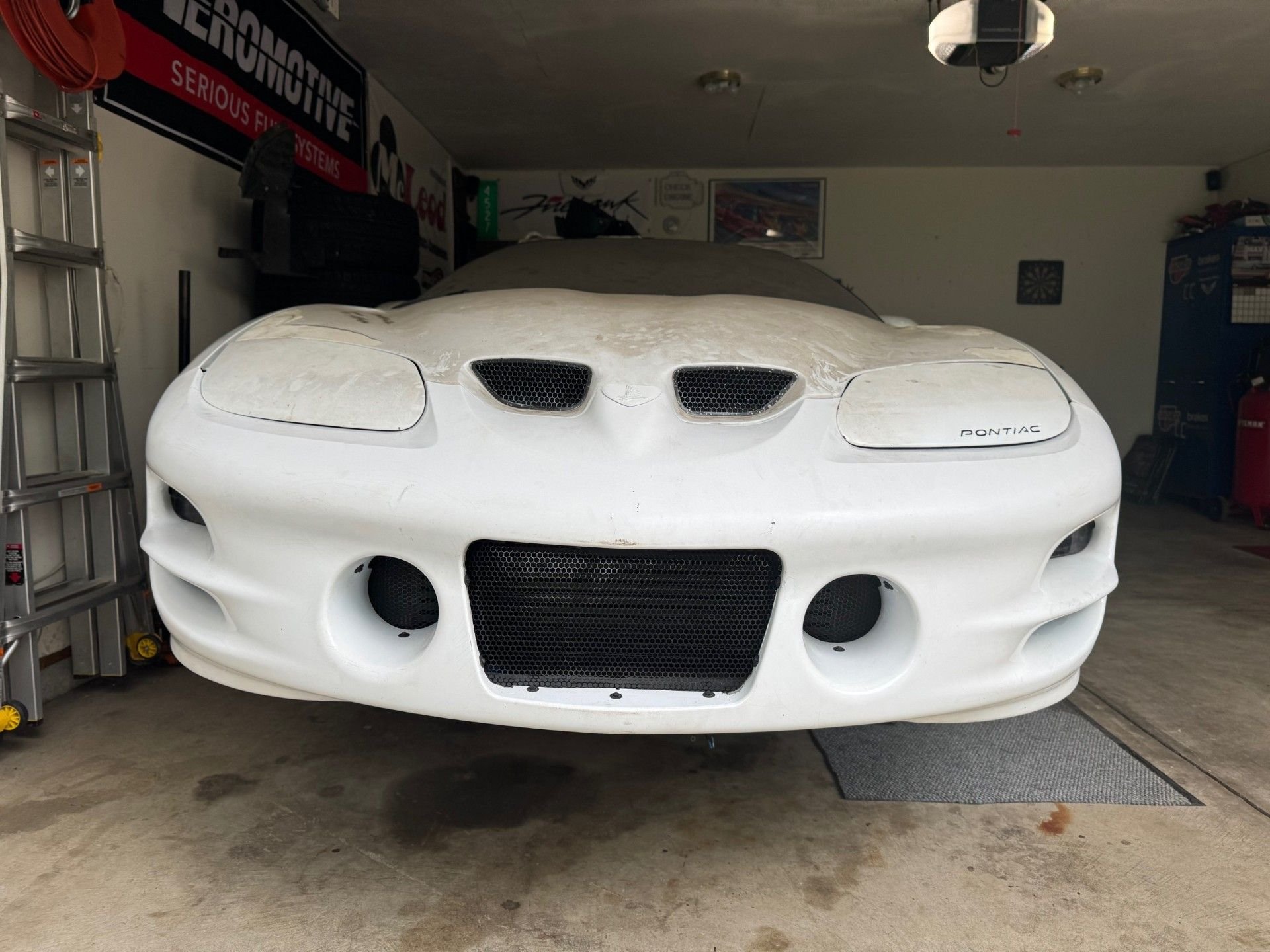

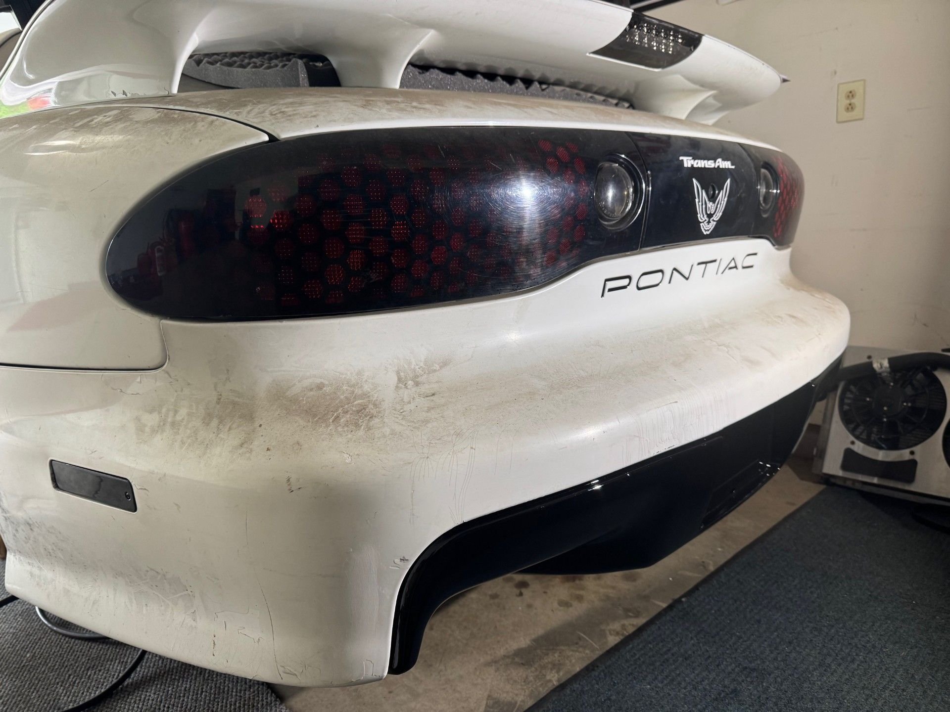

CETA Mod with blackout third brake light, side markers

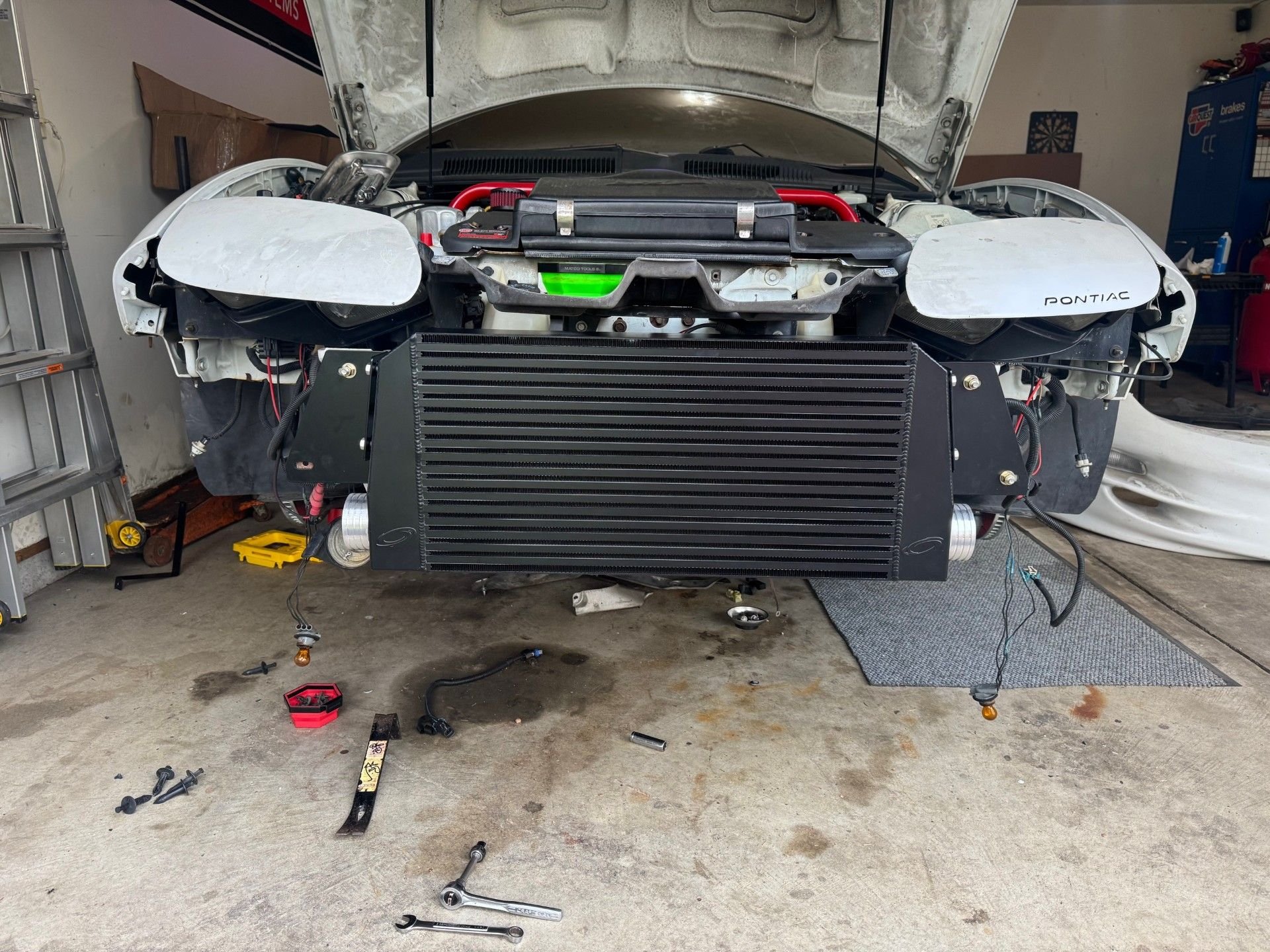

Procharger FMIC installed - honeycomb grille for center and fog lights.

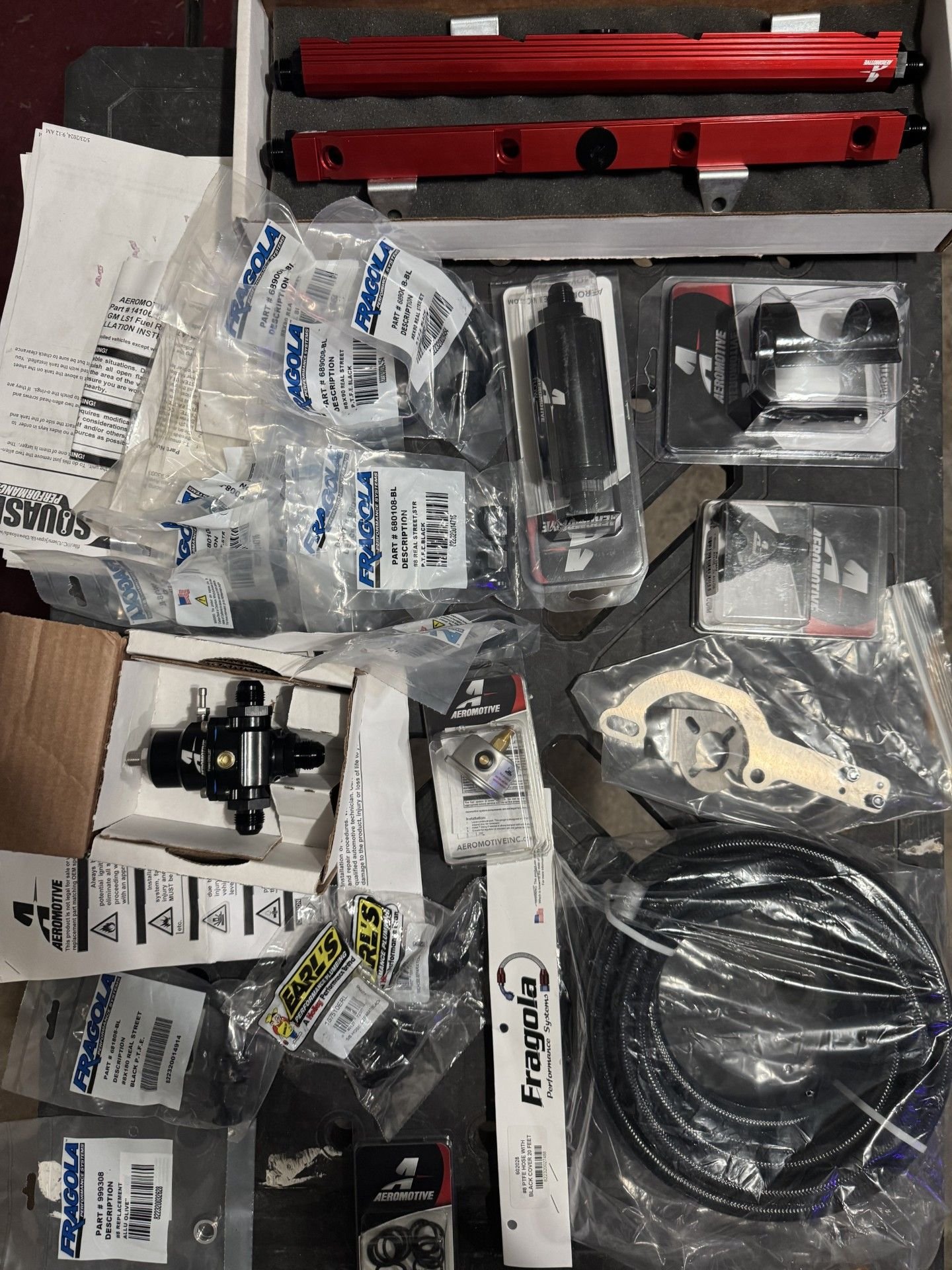

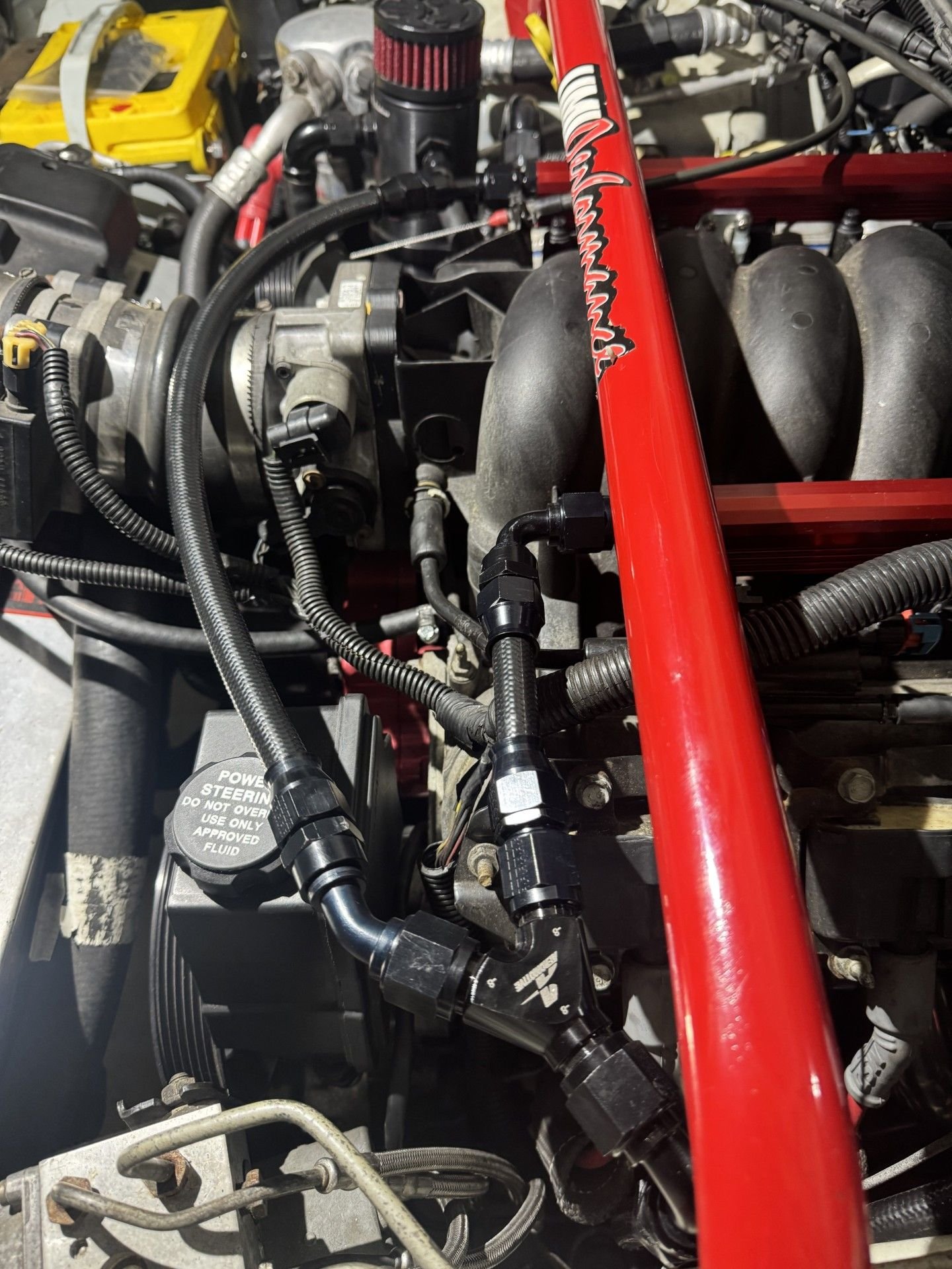

Fragola 8AN Feed/Return Aeromotive Rails & FPR

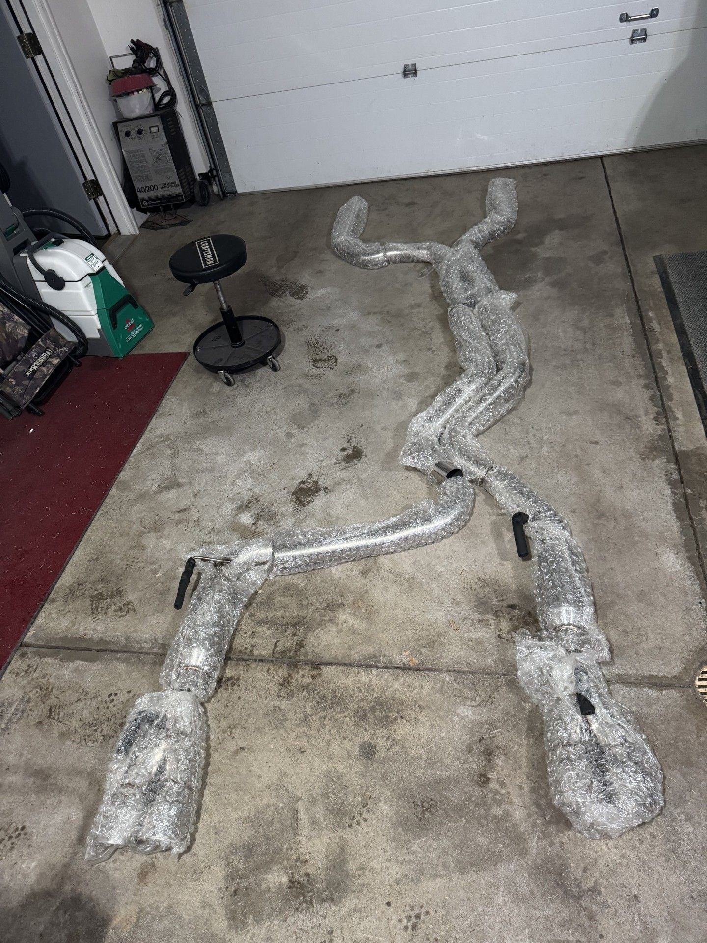

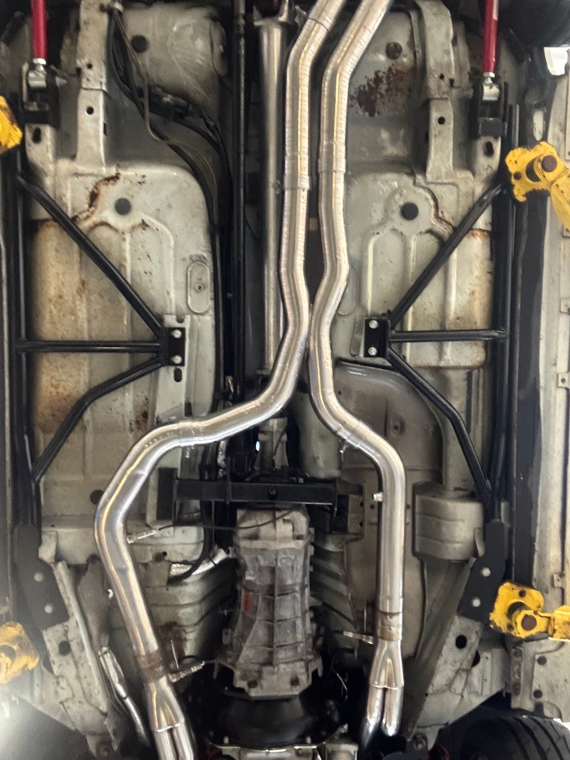

Texas Speed 3 inch dual exhaust

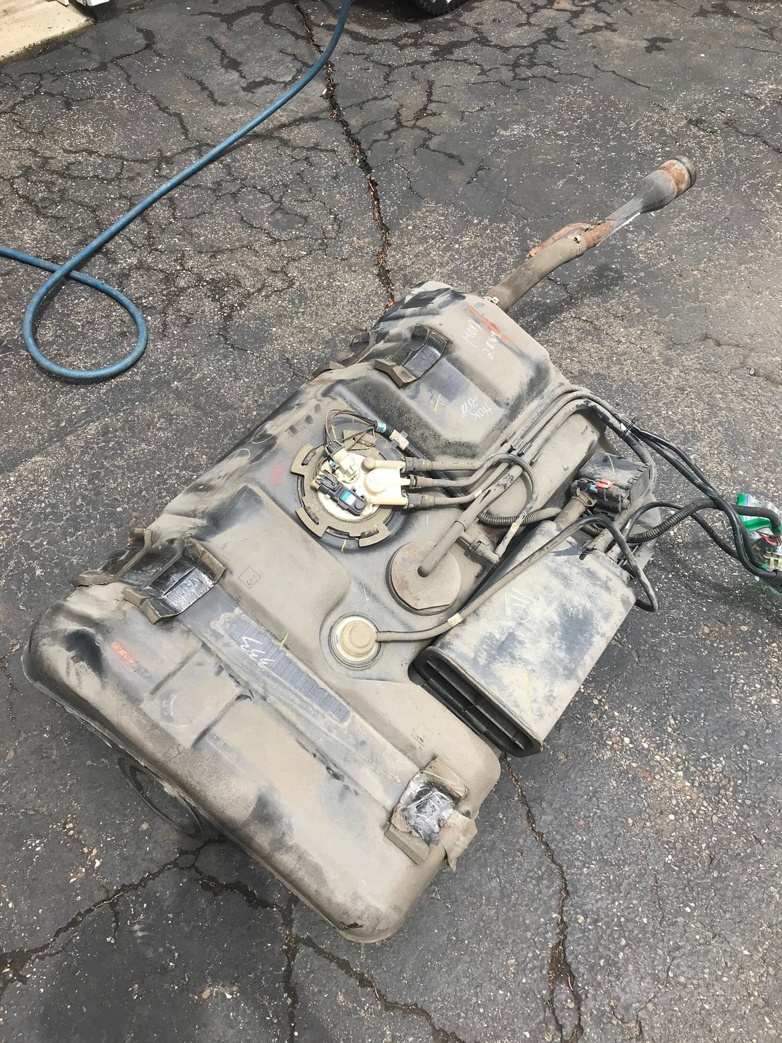

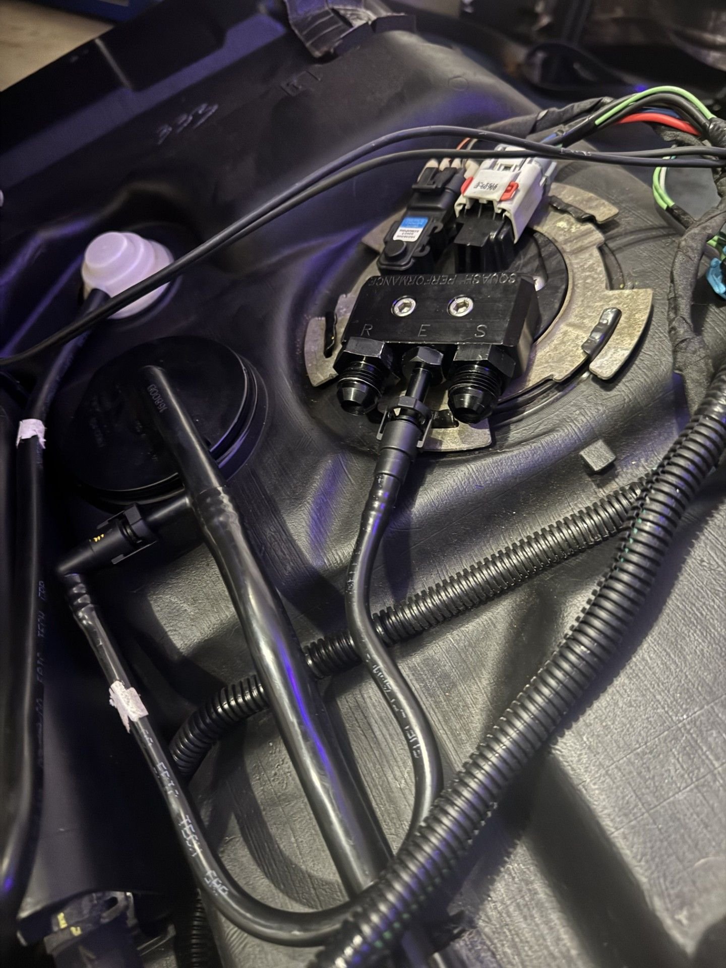

Fuel system routing - looks nice but I could have saved a lot of time and headaches running it to the back rails then 180* to the FPR
FPR mounted
FPR mounted
Before
Before
Old Emblem Package colors
This is just pinned to the wall now lol
Looks good with this color combination on white
Dual Squash 450s installed
Dual Squash 450's installed
Before
Before
After
After

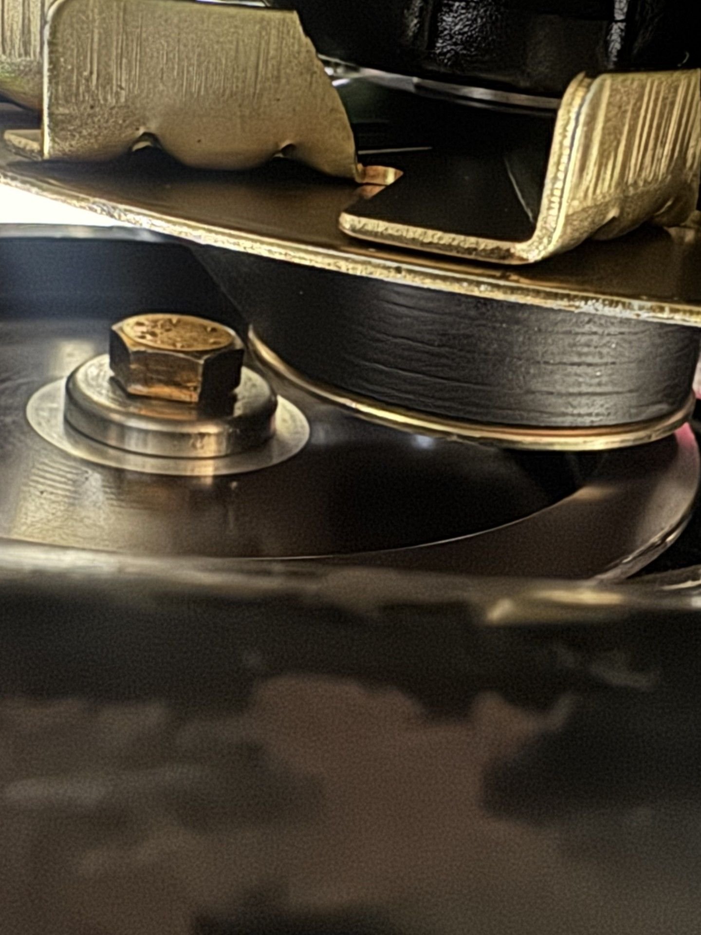

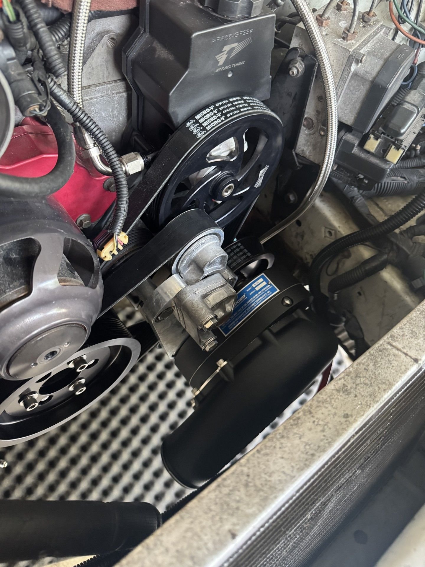

I did have the pulley machined - this is a shot of the room afterwards. Powermaster alternator for reference.

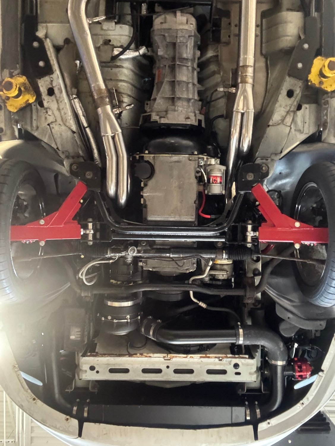

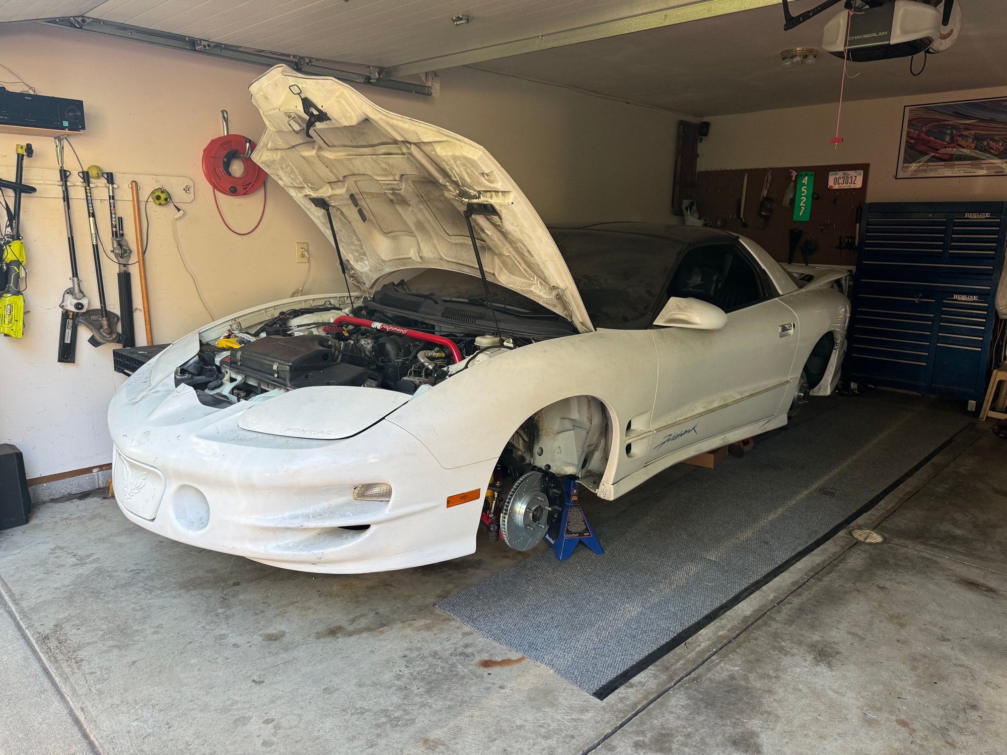

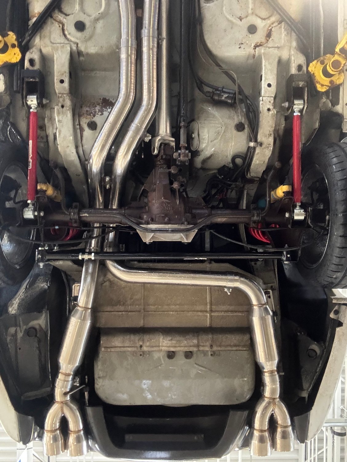

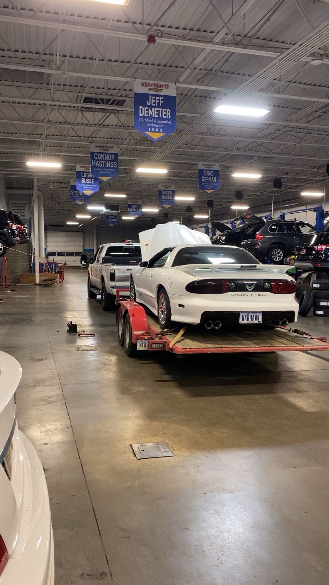

I towed the vehicle to work to get my alignment done. I used another thread here as a starting point. While
it was there, I degreased the underside and cleaned the bird for the first time in 6 years.
Running the final gauges, sway bars, x11 t-bolt clamps, and it’ll be ready to be towed out for a tune.

Is anyone running the aster bracket with a procharger set up and an electric meziere water pump? It looks like my belt for the blower is just barely touching the end of the water pump and it is giving it a slight angle on the belt. Has anyone encountered this issue before? I have the tune set up for September 17th and it's probably something that they'll want addressed prior to tuning.
EDIT: I found another thread referring to this issue - I have to run an LS2 water pump and have it pulled 11/32’s for alignment. The bell shape on the Mezeire pump is just long enough to slightly touch the belt of the blower on its way to the crank.

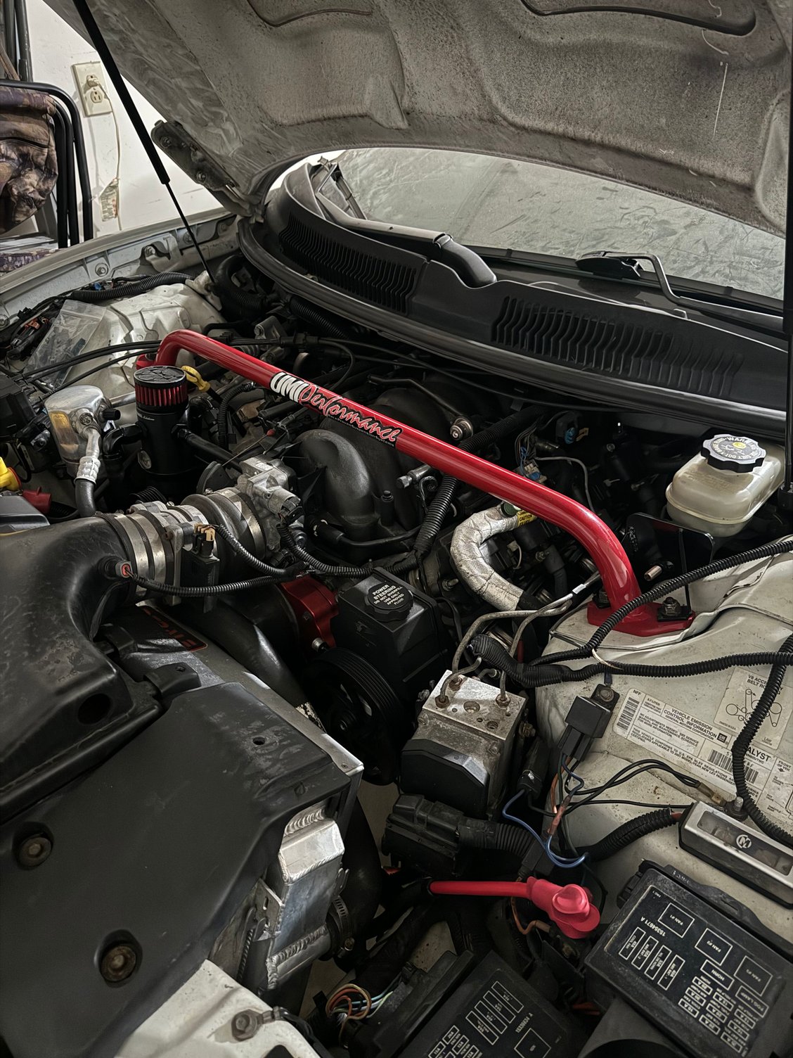

I see a MAF in the intake plumbing. I’d bet it runs out of range, if the tuner tunes with it. LS7 card MAF in a 4” tube would solve that.
Typically tuners like Speed Density with a blower.
I'm a tuner myself so just curious.

I do have the adapter to run SD tune. Told the tuner it’s up to him. Scheduled apt for September 17th. I had to swap out the electric water pump for the LS2 pump and pull the pulley out a bit.

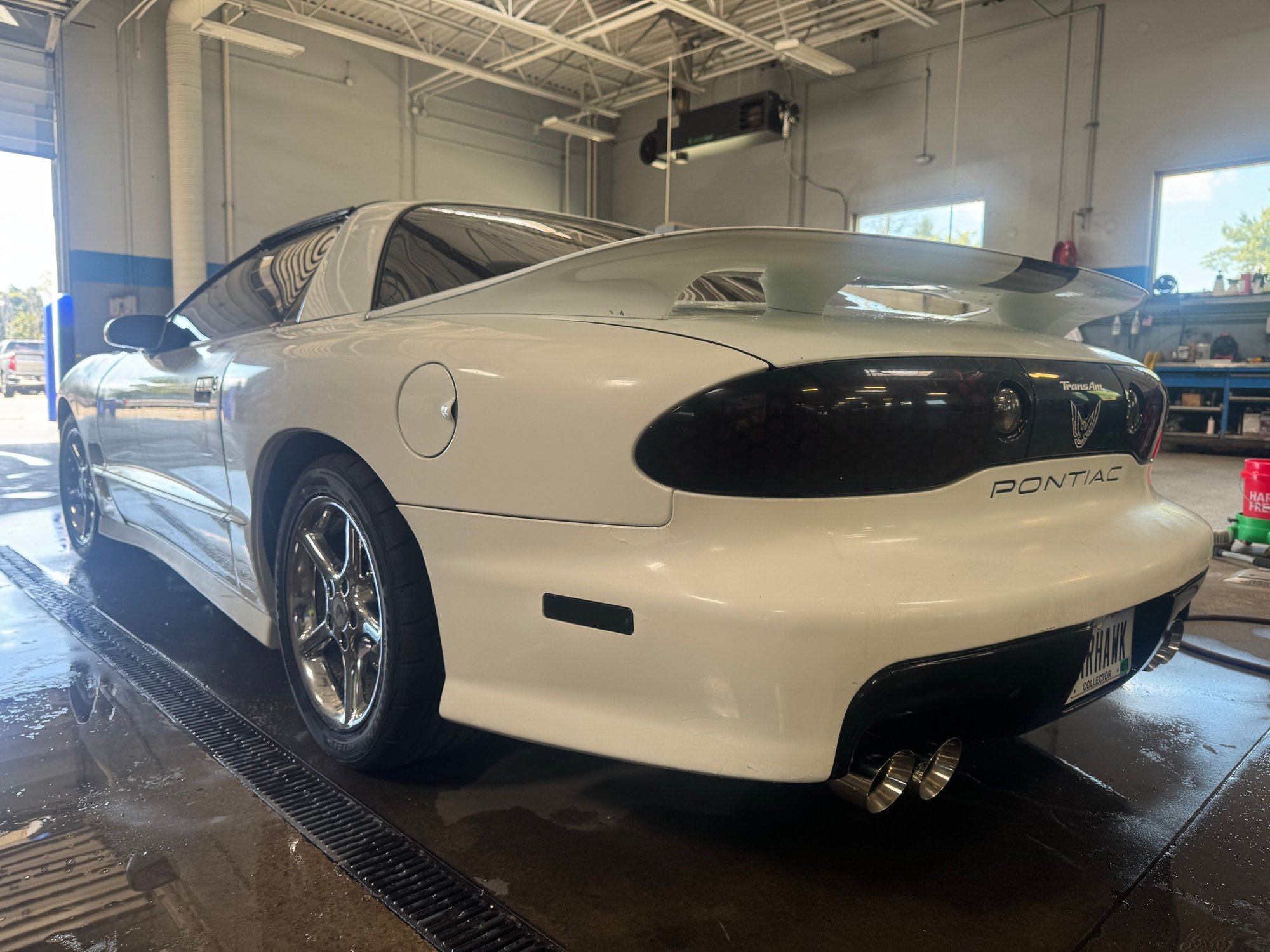

Leaving the shop this morning.

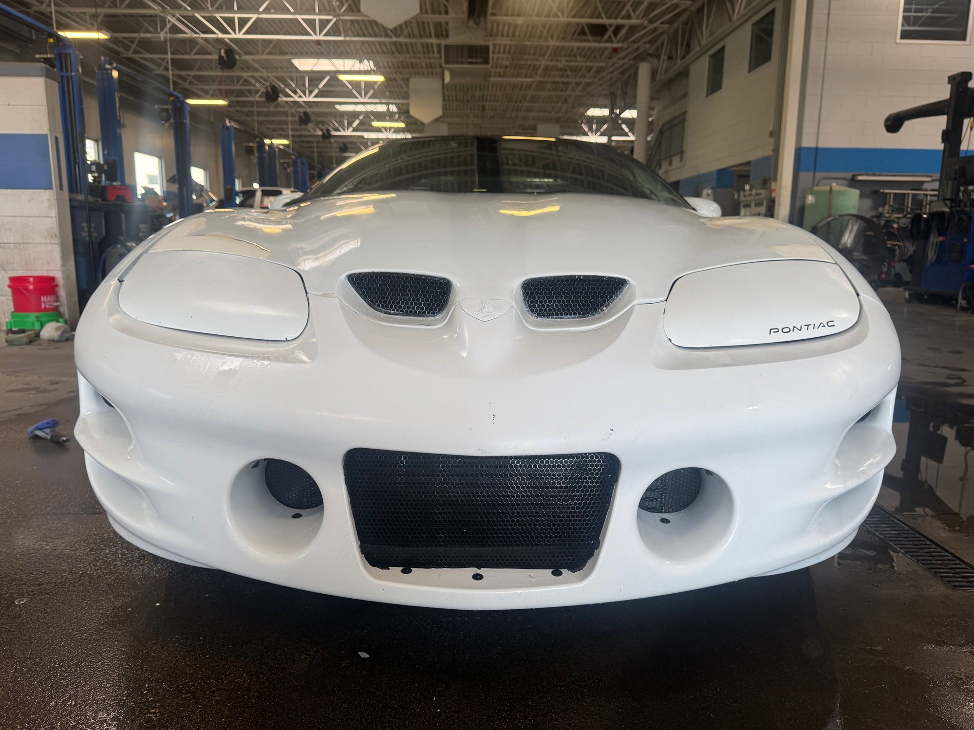

Signed and delivered to the tuner. I’ve dealt with this shop x3 since 2006 and through multiple owners and now at a brand new shop/location at Dragway 42. Buddy from work provided the tow.
