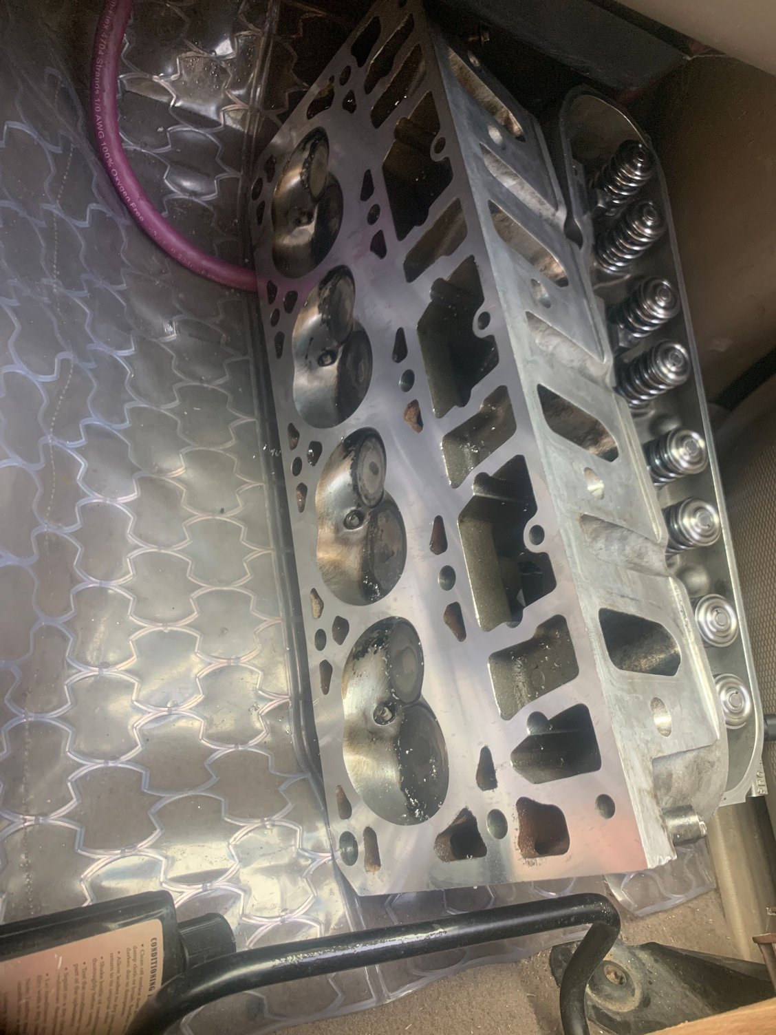

Got a new crank, changing it out today and heads where flowed and came out at 64cc and no signs of mill, plus they were resurfaced so there ready to go🙌🏻🤘🏻💪🏻

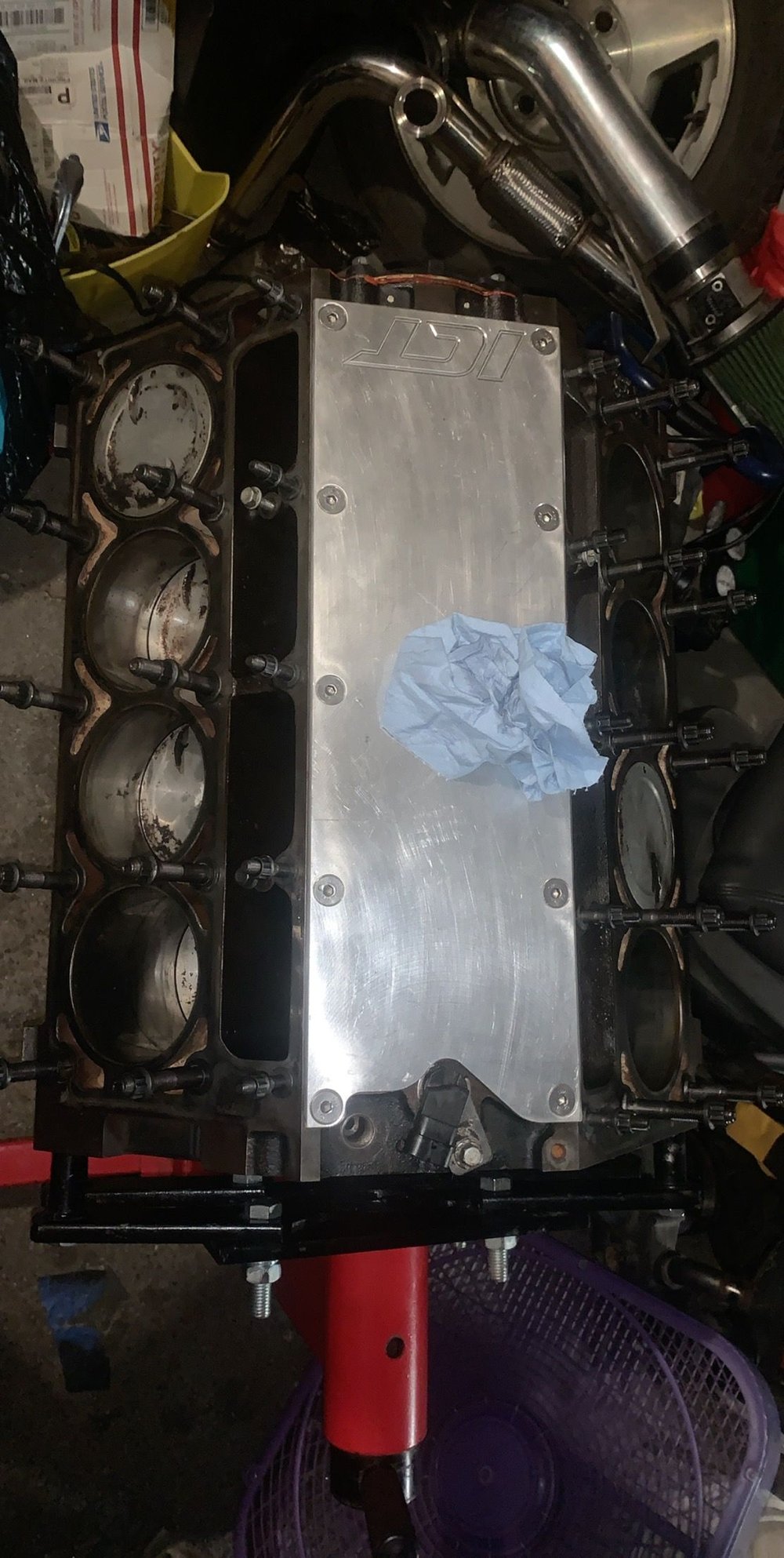

Well another step back on the motor, went to take the crank out and one rod bearing came out trashed, getting the motor honed and cleaned with new rod bearings tomorrow hopefully, glad I went into the motor and found that problem!

Finally an update, I got the motor put back together, all brand new bearing on rod and main caps, all pistons where cleaned and everything is put back together and torqued! I’ll finally be able to put the motor together today!

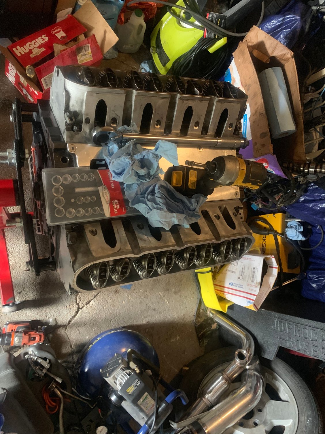

Head torqued, push rods on, rockers on an torqued, looking good guys🤘🏻
