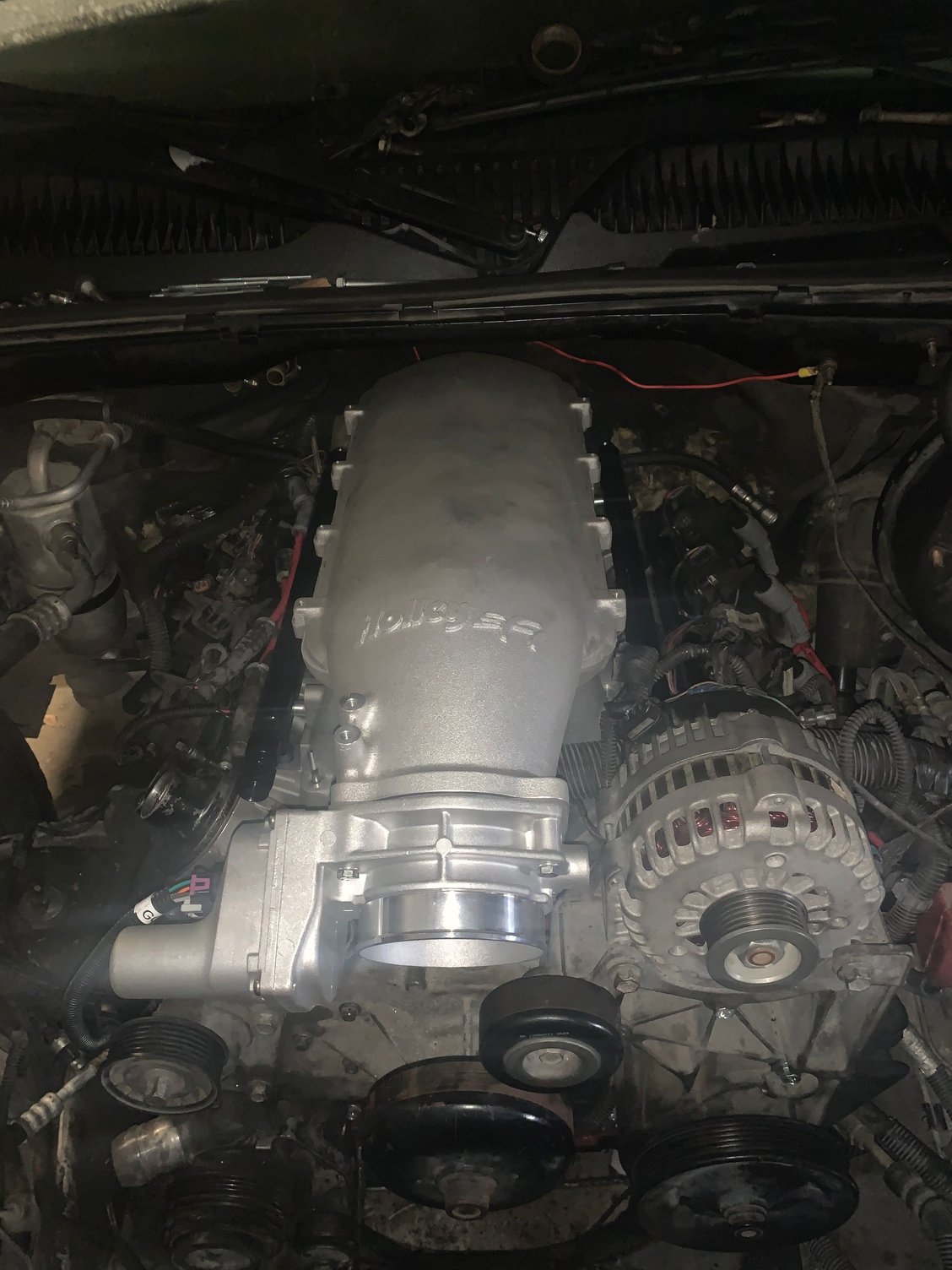

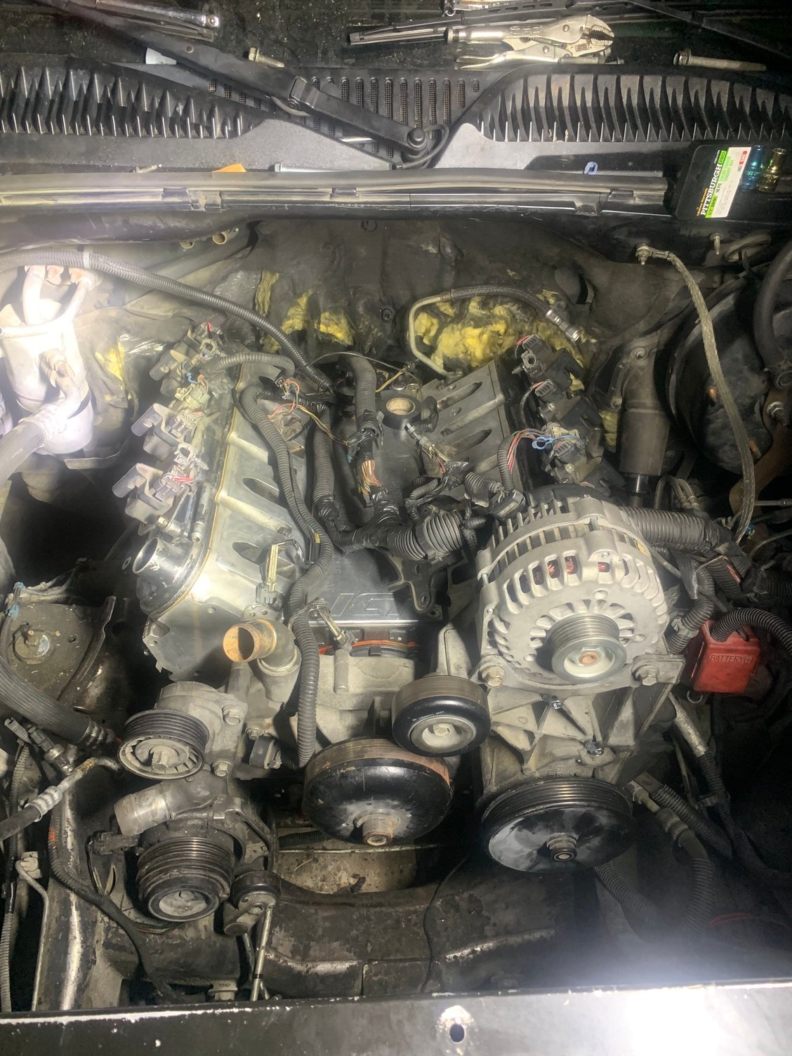

Welp powersteering and alternator is bolted some of the wiring is connected, just gonna make the wiring look a lot nicer and slicker

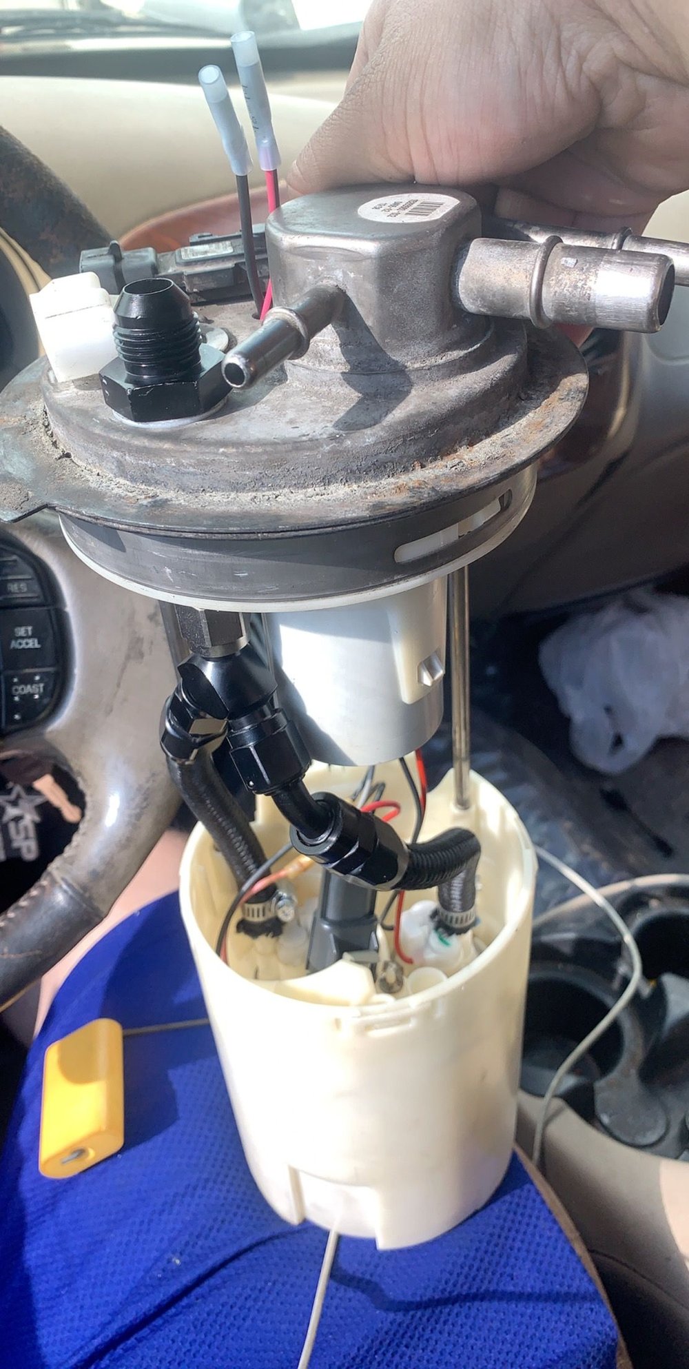

Double pump is done! Will be installing tomorrow and start running all the fuel lines and Hobbs switch lines

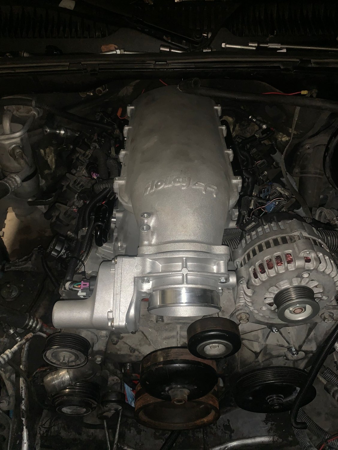

Did more wire tuck, got the injectors all connected and don’t have the adapters hanging everywhere(zip tied to fuel rails lol) got crank pulley bolted down, don’t have pics yet but started to run my 8an fuel line from pump to my door and waiting for the fuel filter to get here tomorrow to install and after that finish running the fuel line to the regulator then to the fuel rail, and run the return and also connect the flex fuel sensor.
Old Aug 26, 2019 | 10:04 PM
  #48
TLCPSilver06's Avatar
Joined: May 2012
Posts: 52

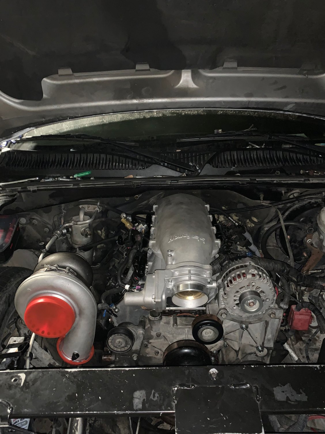

Haven’t really been able to work on it, but today got the fuel system finally done today, put up the headers, and moved up the turbo, she’s looking might fine finally!

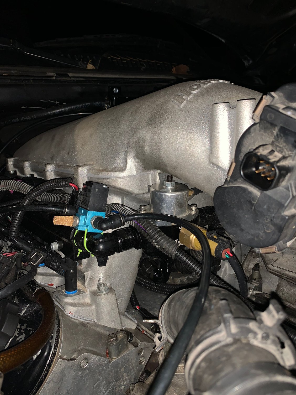

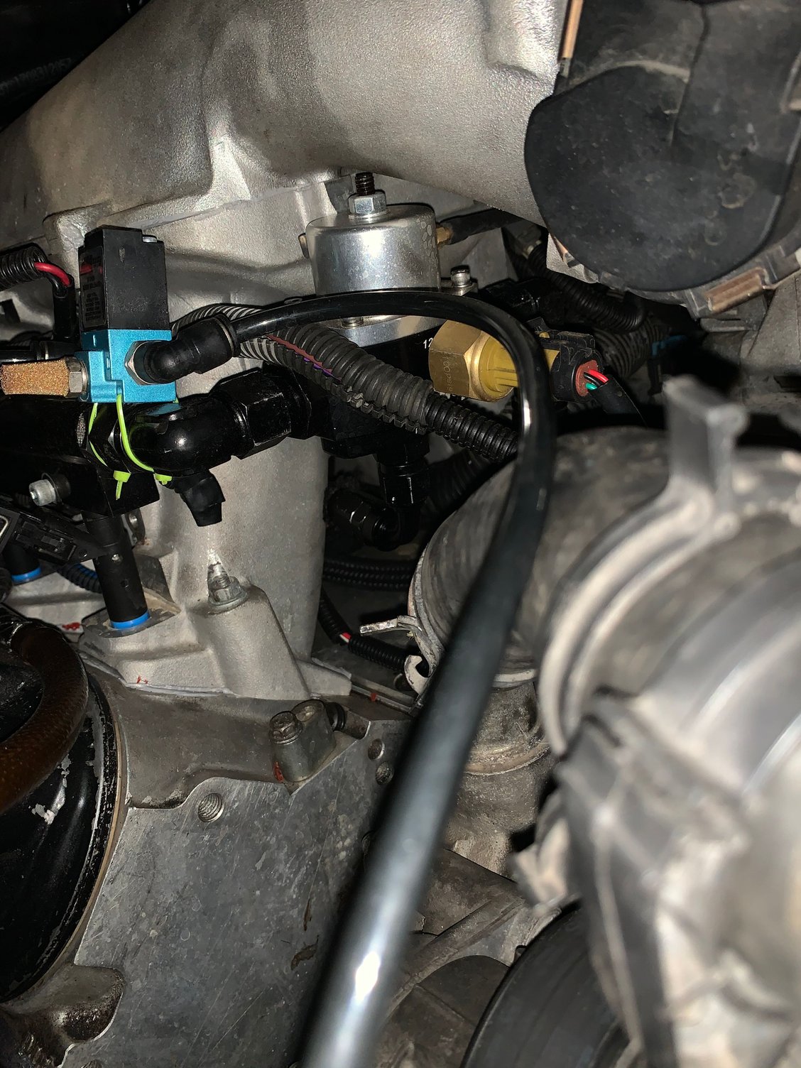

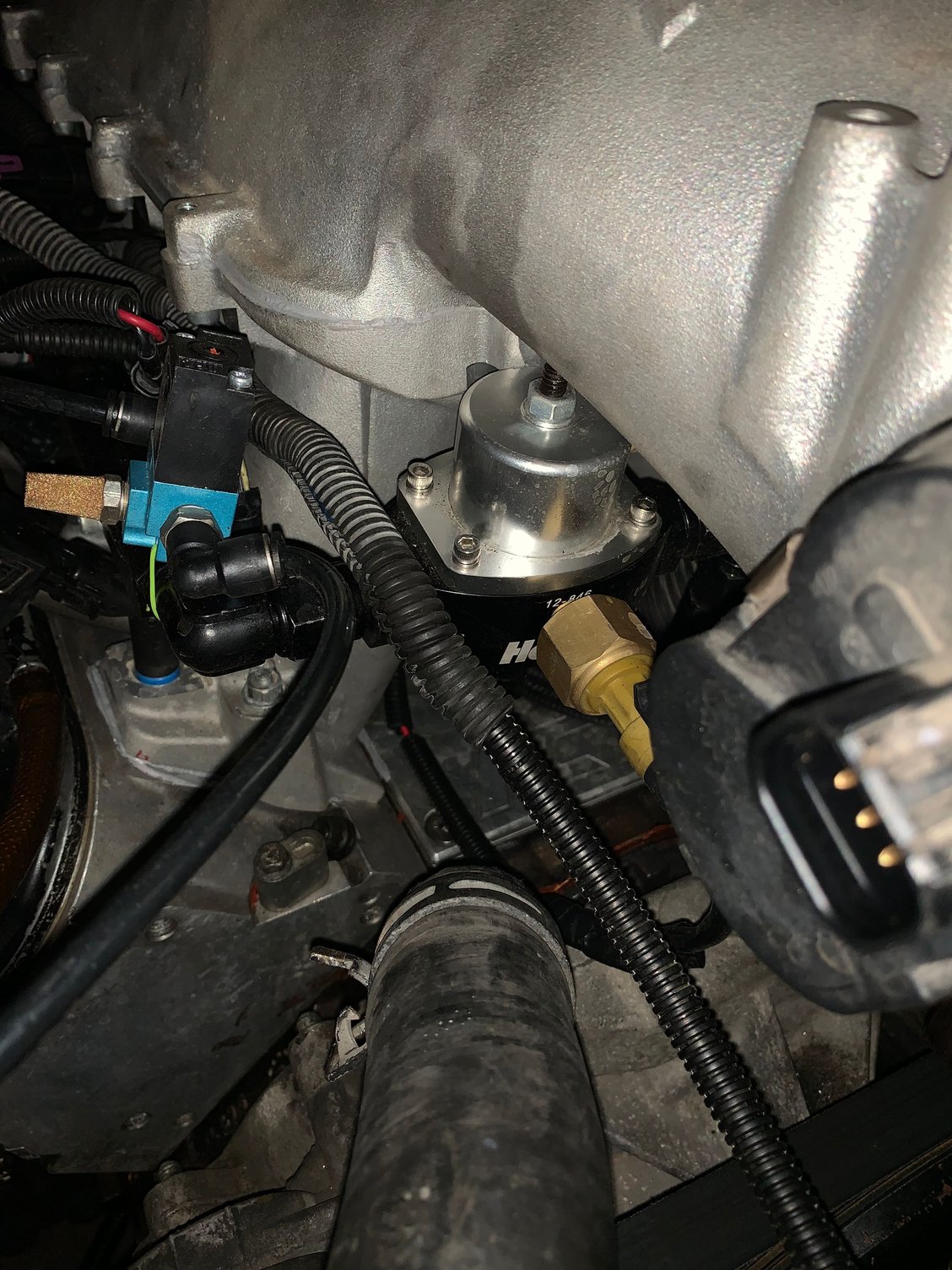

Any more pics of how you ran the fuel pressure regulator
Old Nov 27, 2019 | 06:57 PM
  #53
Joined: May 2012
Posts: 52
mill take some tomorrow, but it’s basically in the front of the holley, it 90s from the passenger side fuel rail and connect to the regulator on one side, the feed comes from under the holley to connect to the other side of the regulator, and return also under the holley to the regulator
Old Nov 27, 2019 | 07:05 PM
  #54
Joined: May 2012

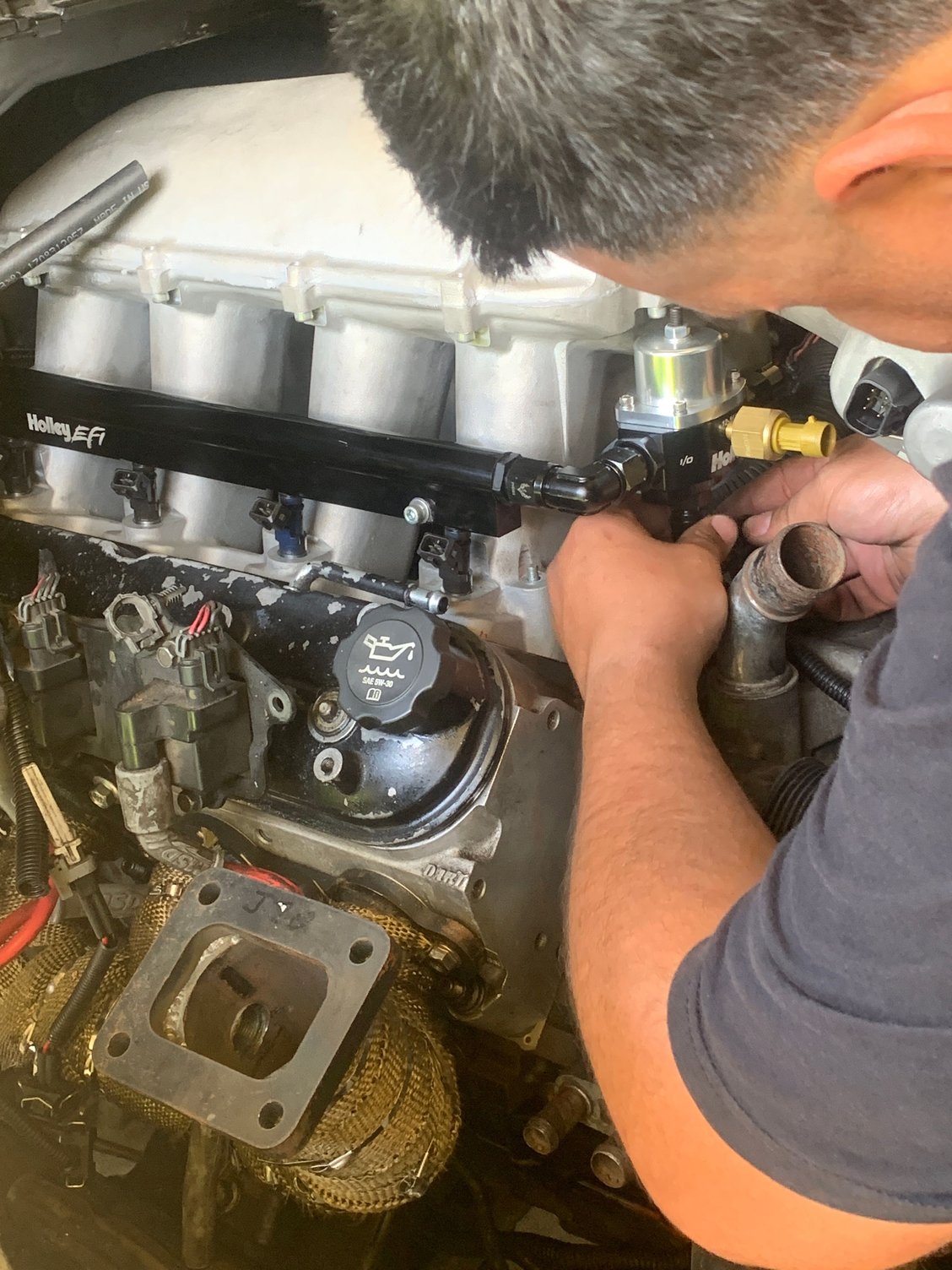

Posts: 52
Only pics I have of the regulator
