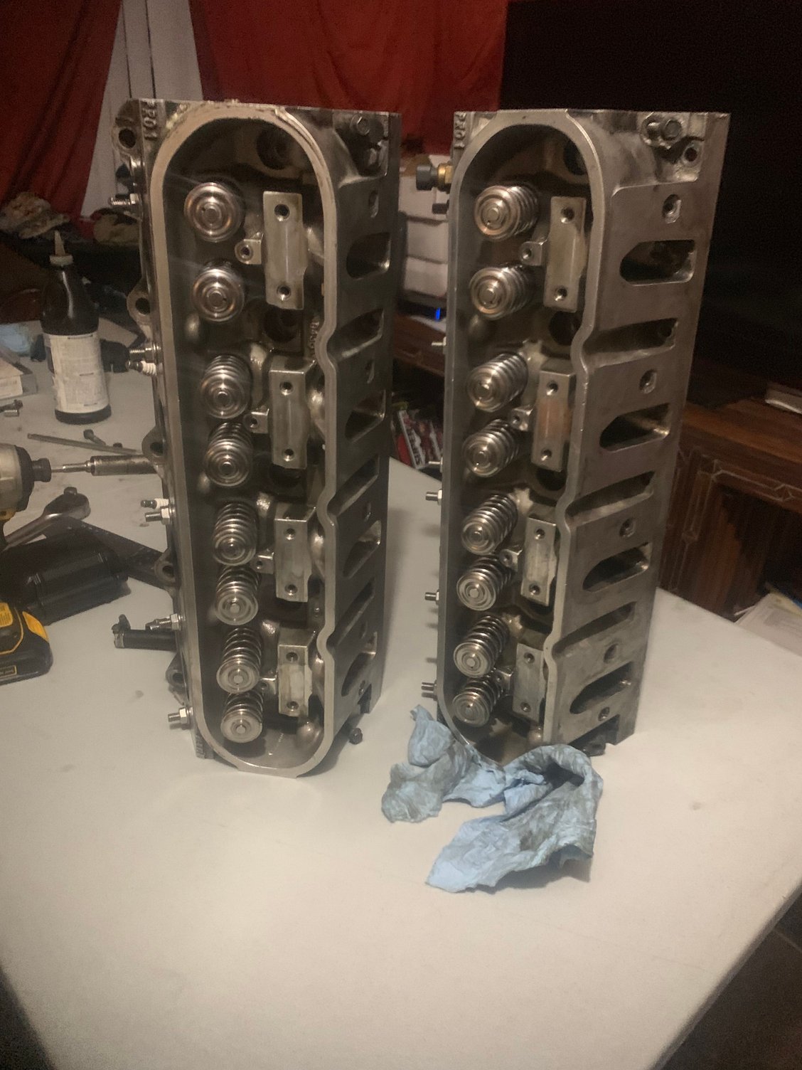

Haven’t been able to do much cuz of work, but got the dart heads all with brand new seals and spring kit, will be going on the motor tomorrow🙌🏻🙌🏻

Well going a different route with the heads, found out these dart heads are milled .50, so way to much for boost, so want to ask should I go 706 or 317 heads? I have 706 heads here, but heard 317s are better?
Old Jul 20, 2019 | 12:46 PM
brandon6.0's Avatar
iTrader: (32)
Joined: Dec 2009
Posts: 2,331
Likes: 29
From: Glennville, GA.
317s for sure
Old Jul 22, 2019 | 06:57 AM
408GT's Avatar
Joined: Jan 2008
Posts: 966
Likes: 19
From: GA
My truck has the 706's on them. I say it you already have them, run them. The 706's have been shown to be very comparable to the 243's, but I guess if you're looking to drop c/r then the 317's.
