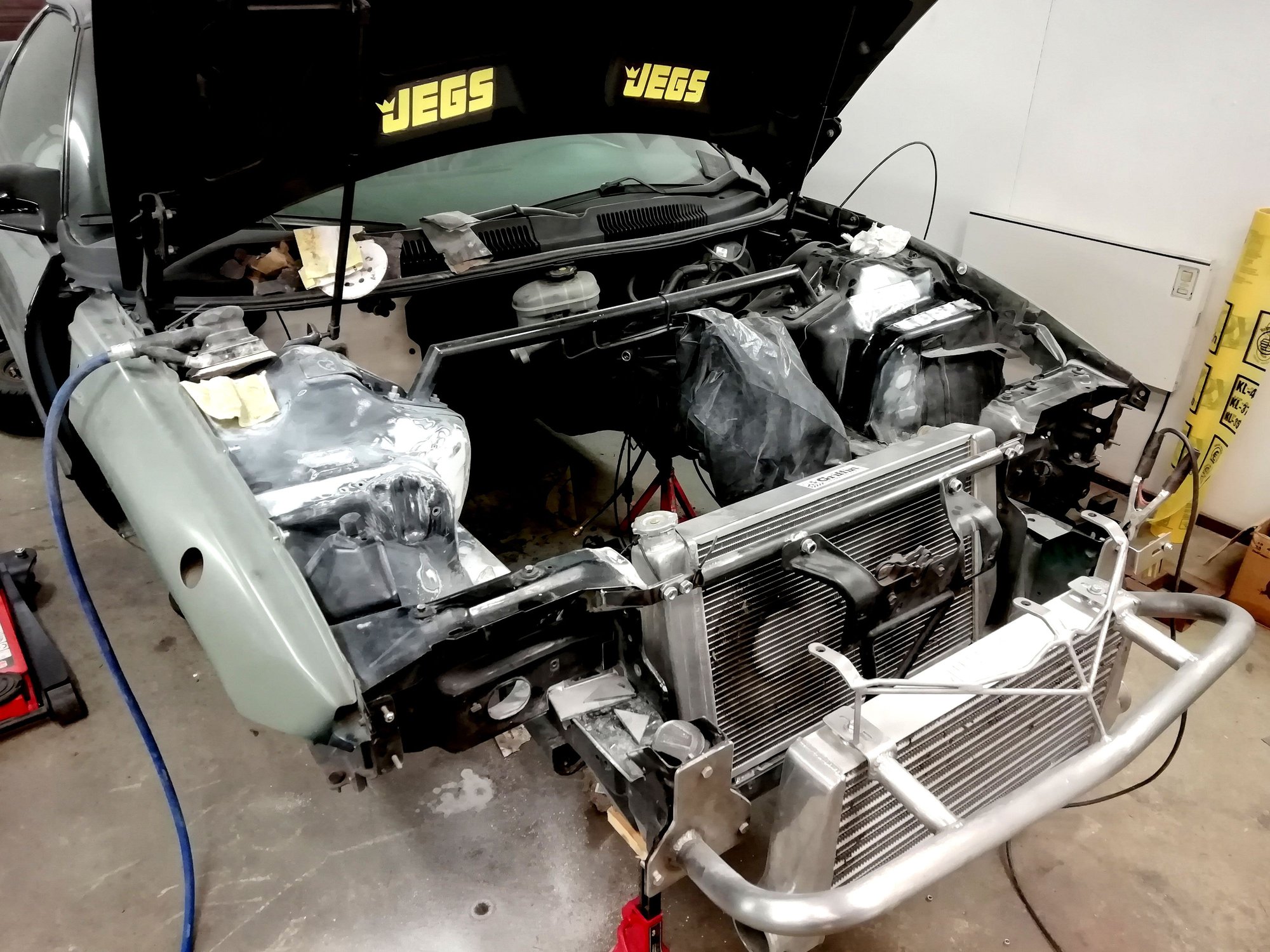

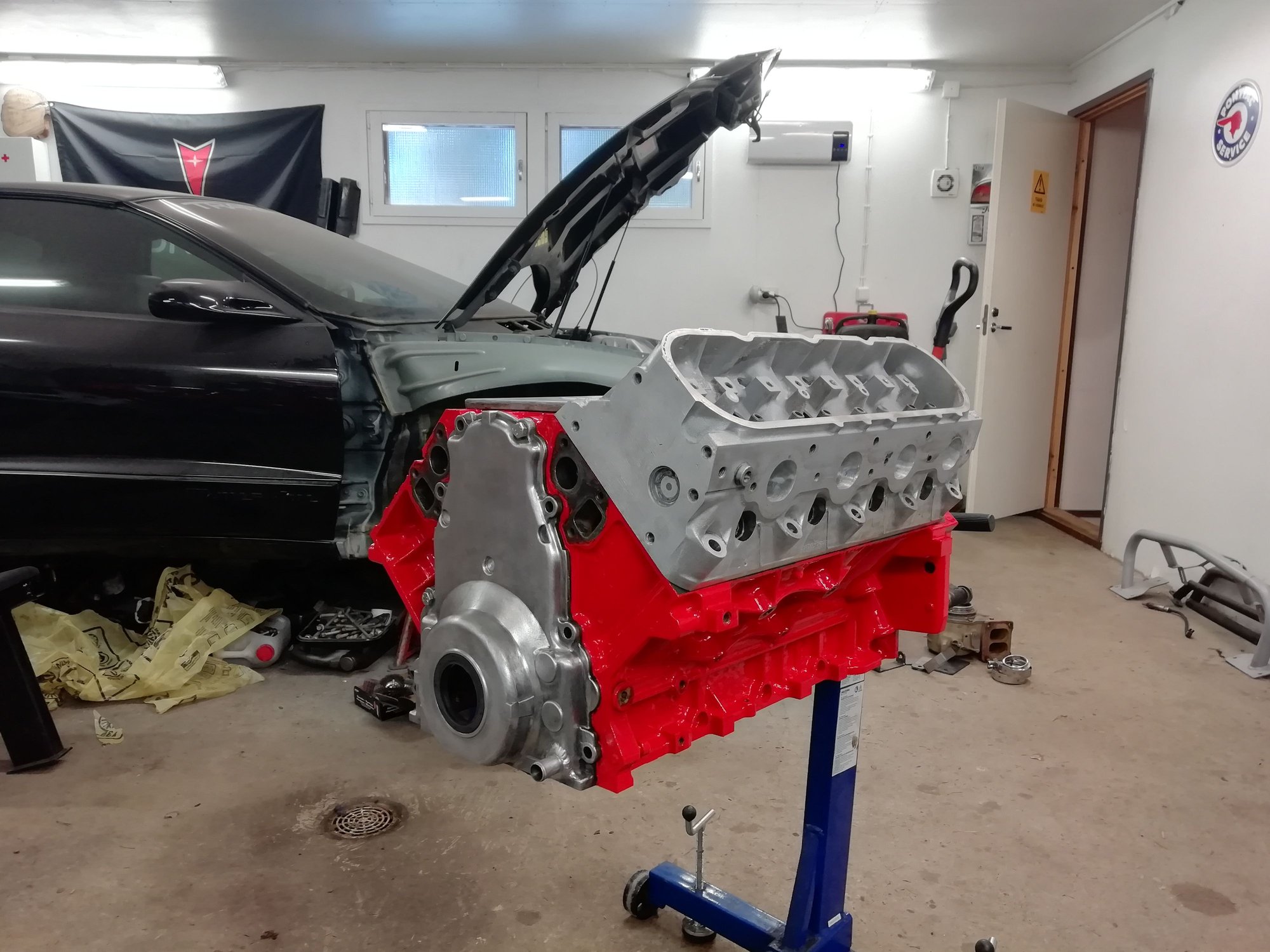

little update. Nothing fancy progress, just smoothing the s... out of the engine bay. Front supports are now fully removable, so i can just slide the engine in. And oh, i did order a new engine. 2002 LM7, 6 to 8 weeks until it arrives, i cant wait!

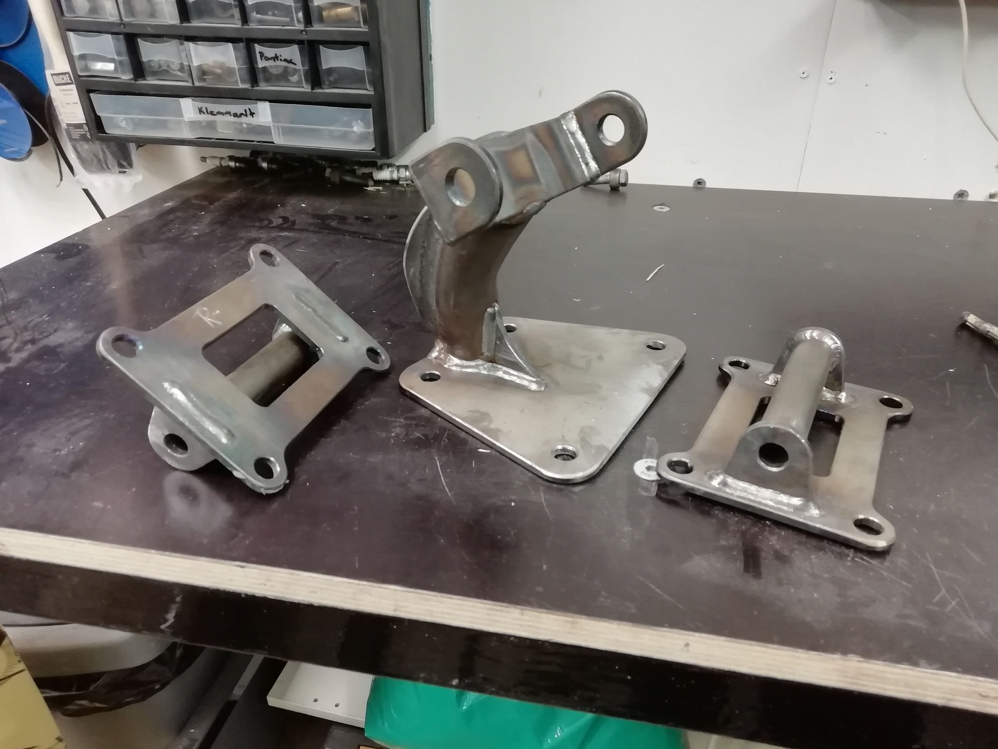

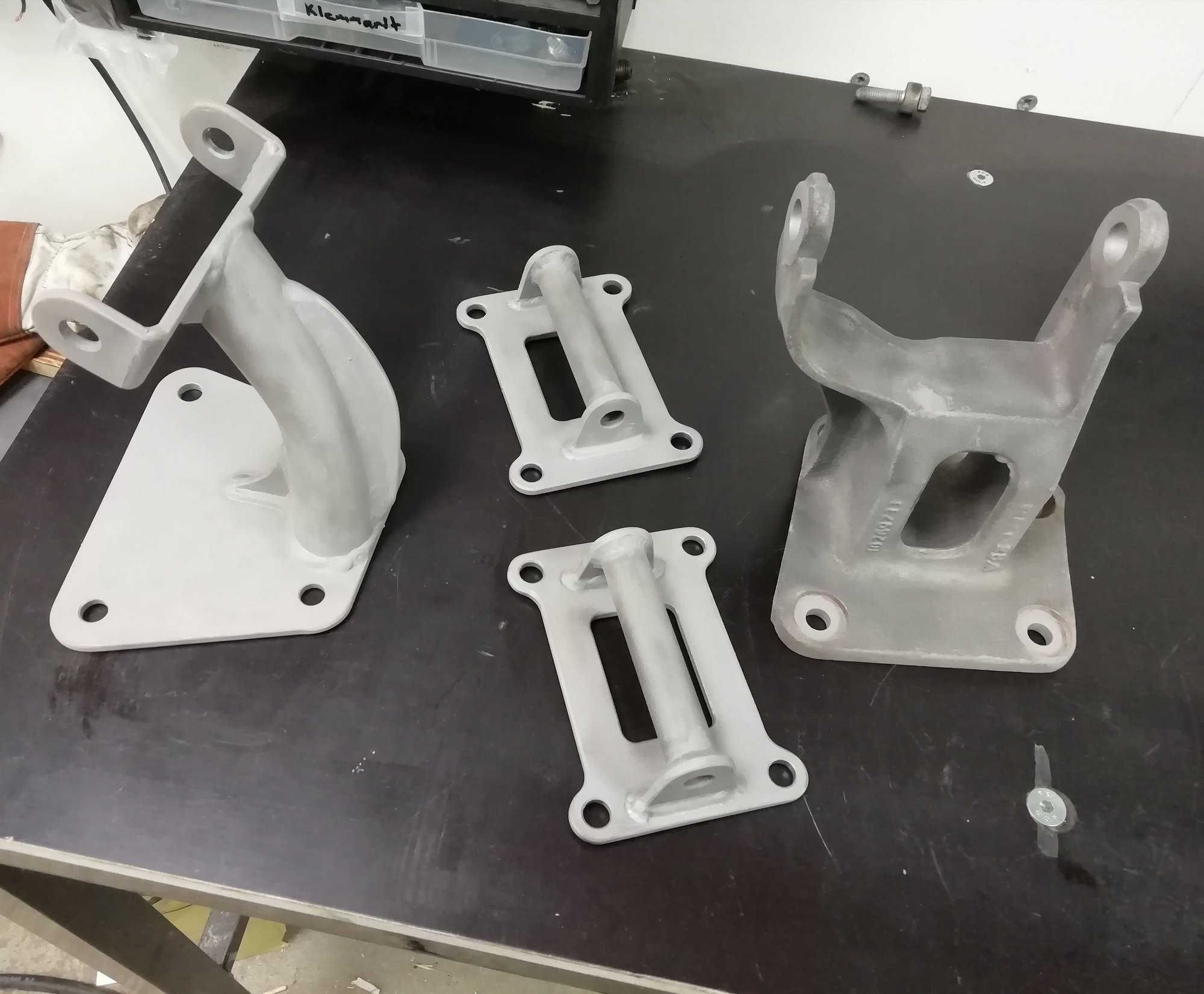

Heres my new sandblasted enginemount setup. Now i have zero problems making my 4.5" downpipe fit through stock k member. Also had to customize that a bit.

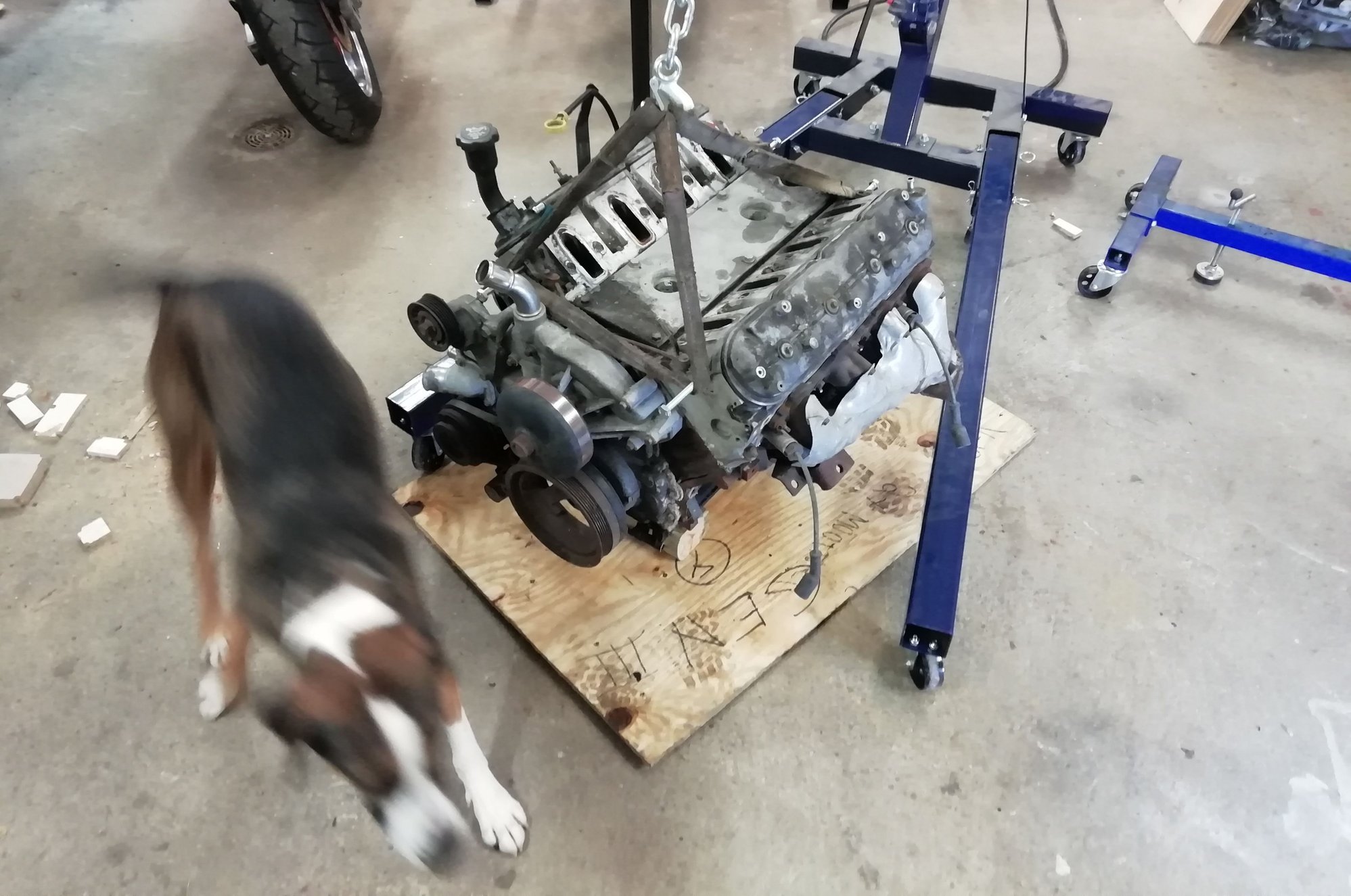

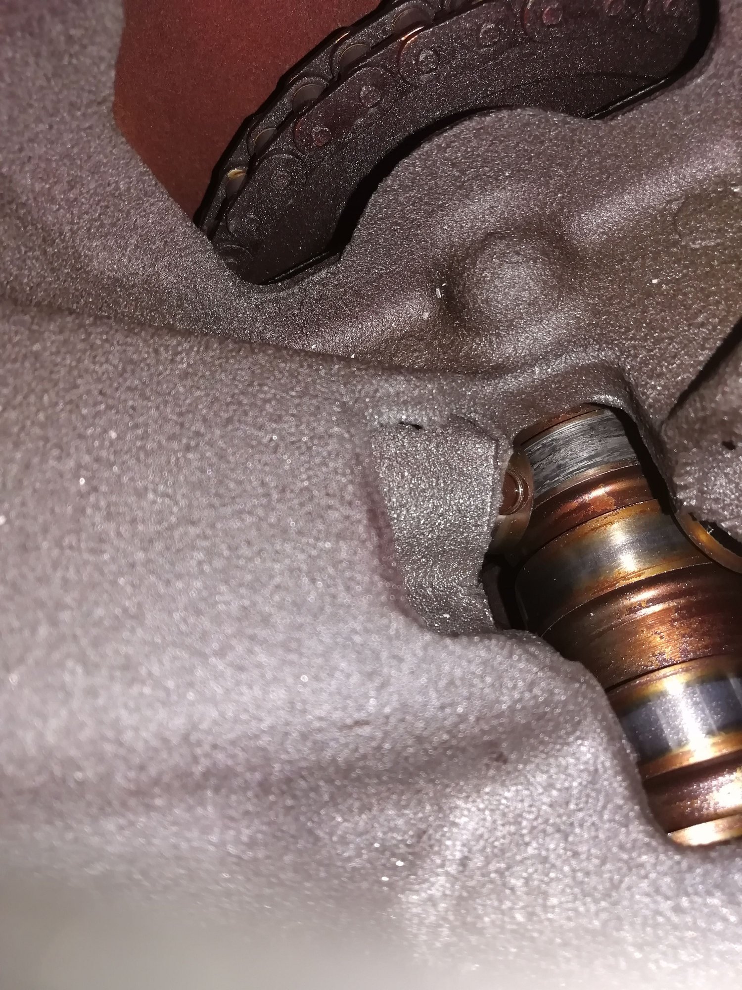

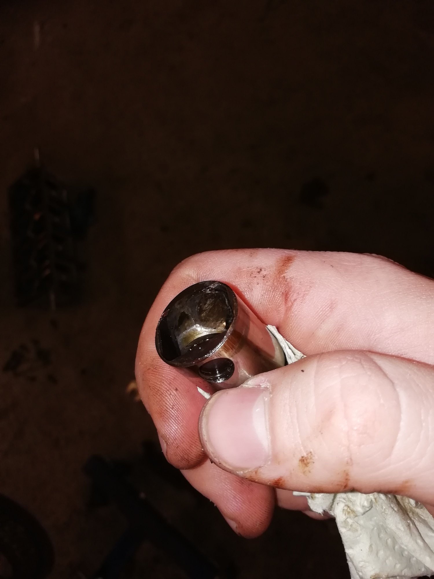

I started to open the engine and first thing i saw was one lifter drifting like a mad man.
I guess you can call that a former lifter. Also the inside of that block was black AF compared to the old one and lots of metal in the oil pan. Cylinder walls looked really good though, not a single scratch or anything. But because that lifter failure and metals in oilpan, should i overhaul the whole engine or change the cam and cam bearings, clean everything up and just send it?

Even visually there's a lot of metal dust there, over the camwheel etc.
IMO, that engine needs to come apart and be throughly cleaned.
And is that a small crack on the block just above the lifter bore ? Or just a casting mark on the photo ?
Man, i almost **** myself. Just a casting mark.
You're right, already paid so much for the engine, so it would be stupid just mess it up because trying to save couple bucks.

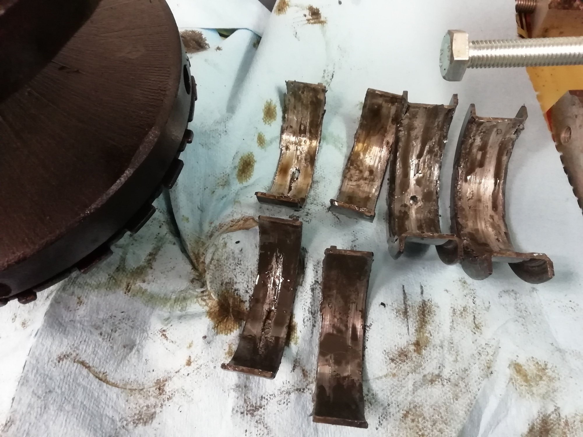

That was a great call. Main bearings here, number 1, 2 and 3. Crank is totalled and this engine is done. Now i will have two wicked tables.
Called the guy who sold this engine, i'll be having new bottom end soon, i hope.

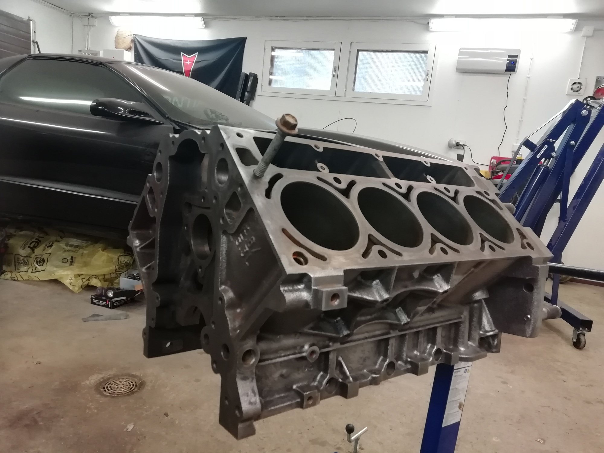

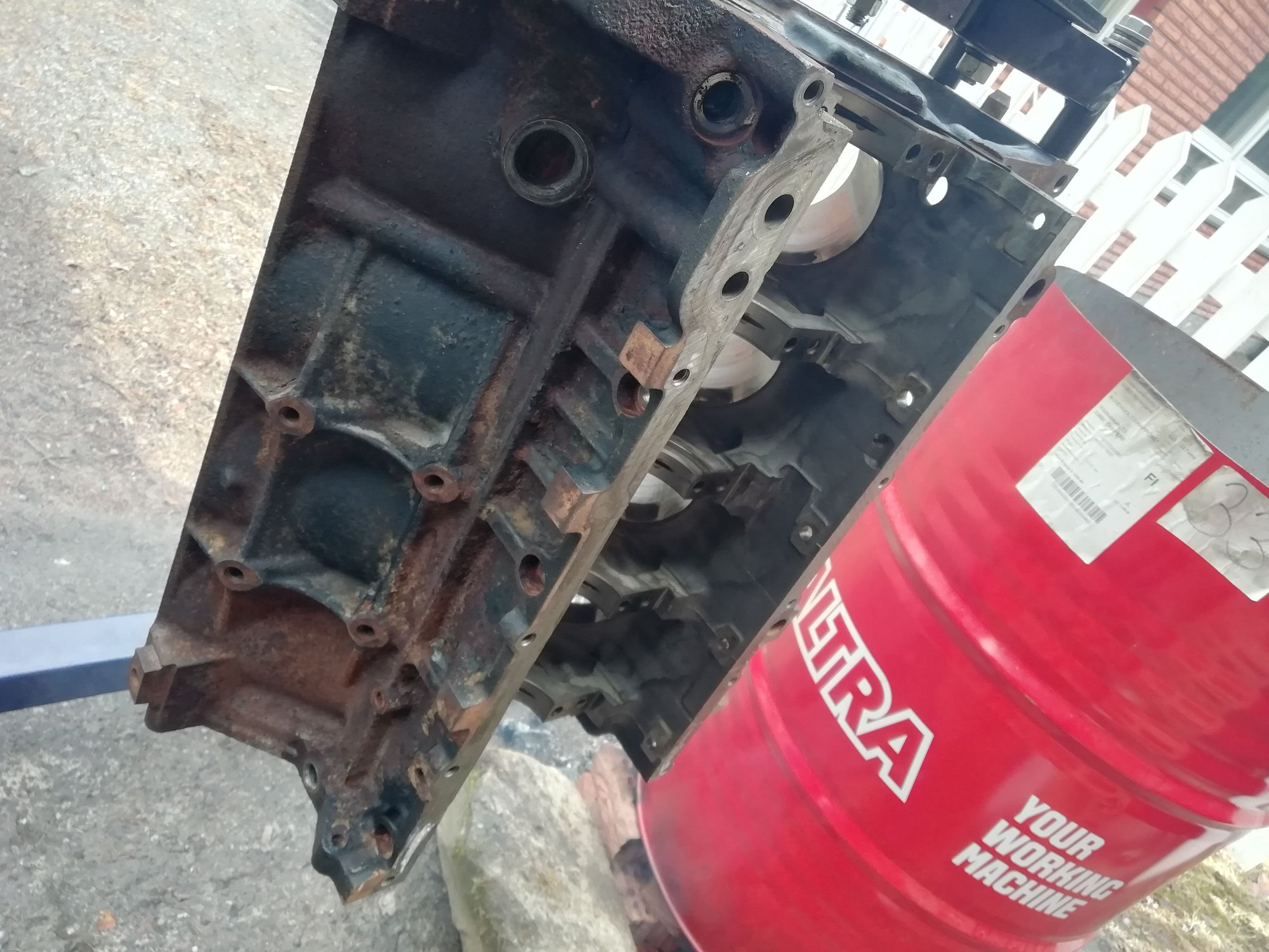

After my 24h ghetto bath, looking good.

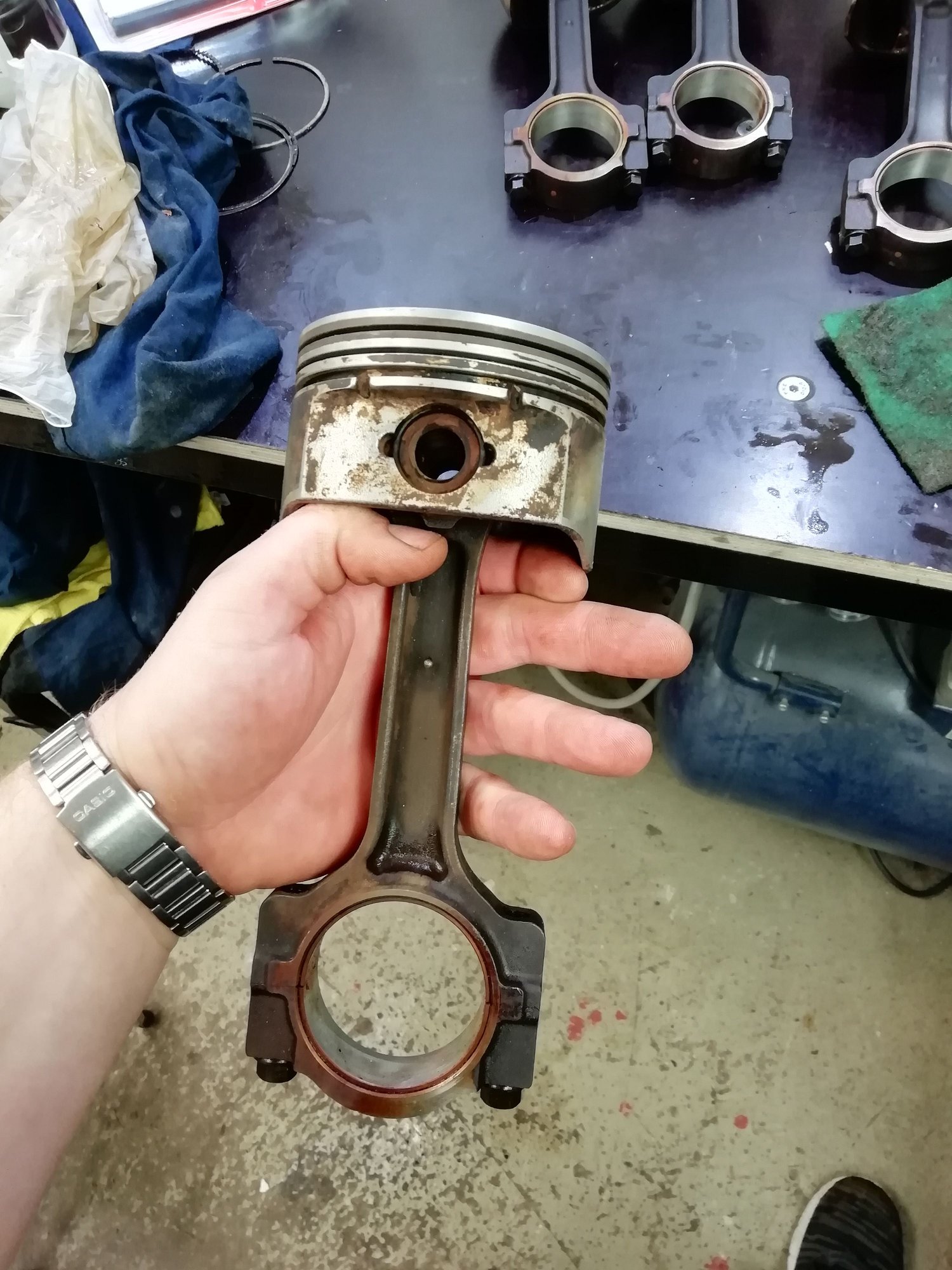

I have set of these bad boys. What do you guys think, im using my old LS1 crank, because it is in mint condition and the other one is for gen 3 5.3 rods and has remarkable wear. I checked my old 5.7 rods, pistons, rings, bolts and bearing combo and got 1293-1295g. Same gen 4 set was 1301-1303g. Weight difference is not that much, but do i have problem with balance because rods are indeed heavier? Im trying to avoid balancing these with mallory metal.

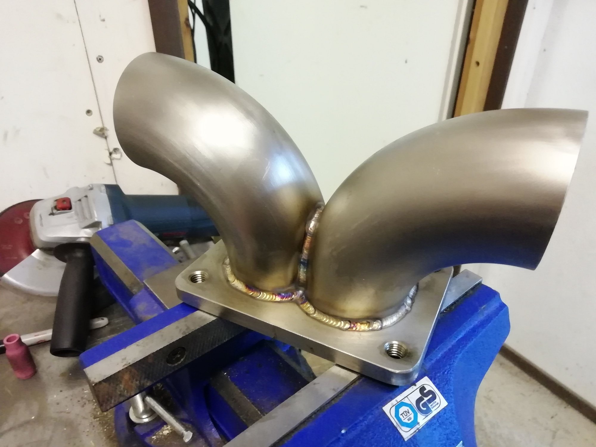

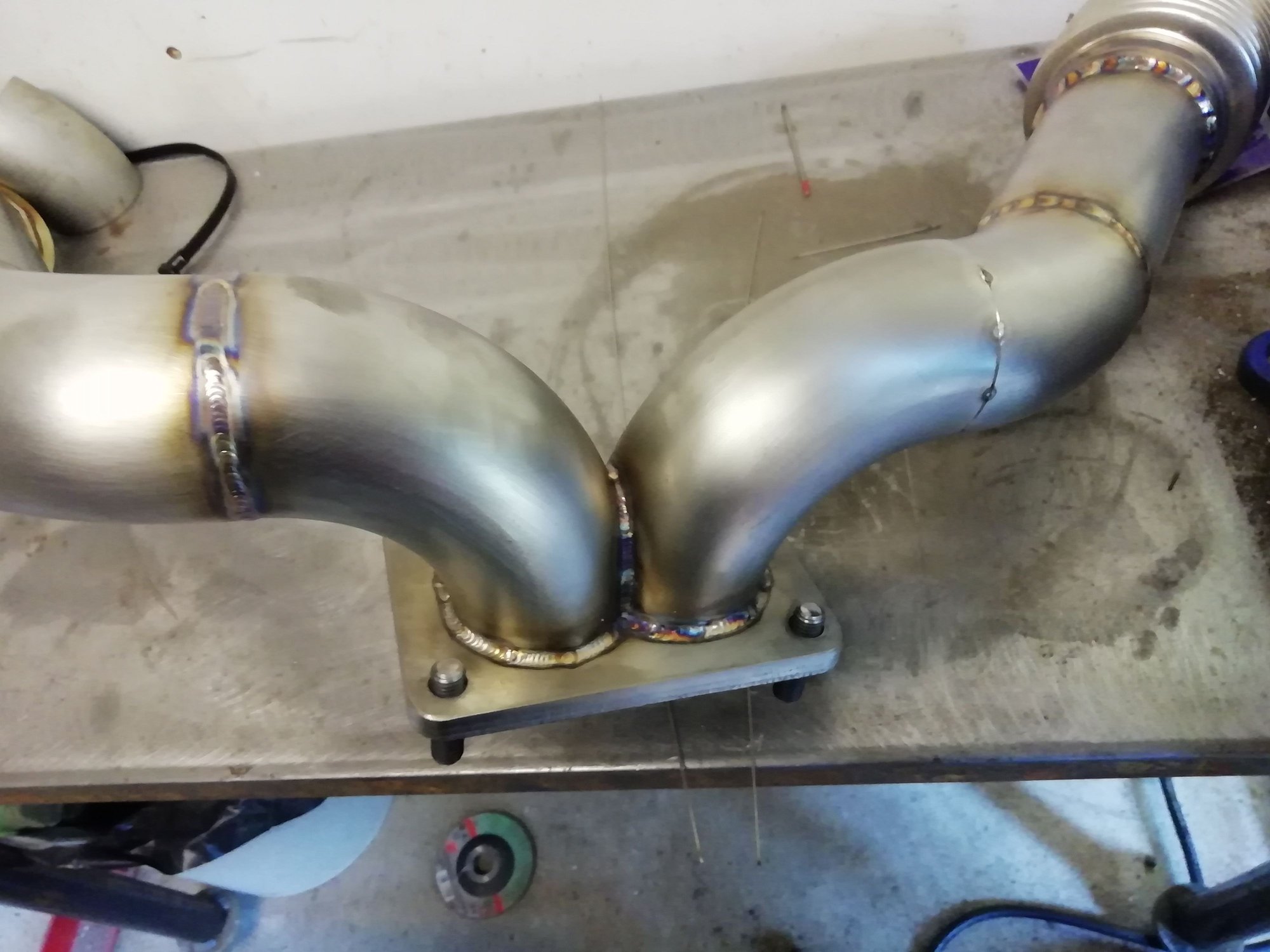

Mild steel crossover needs to go, stainless with v-bands coming through.
