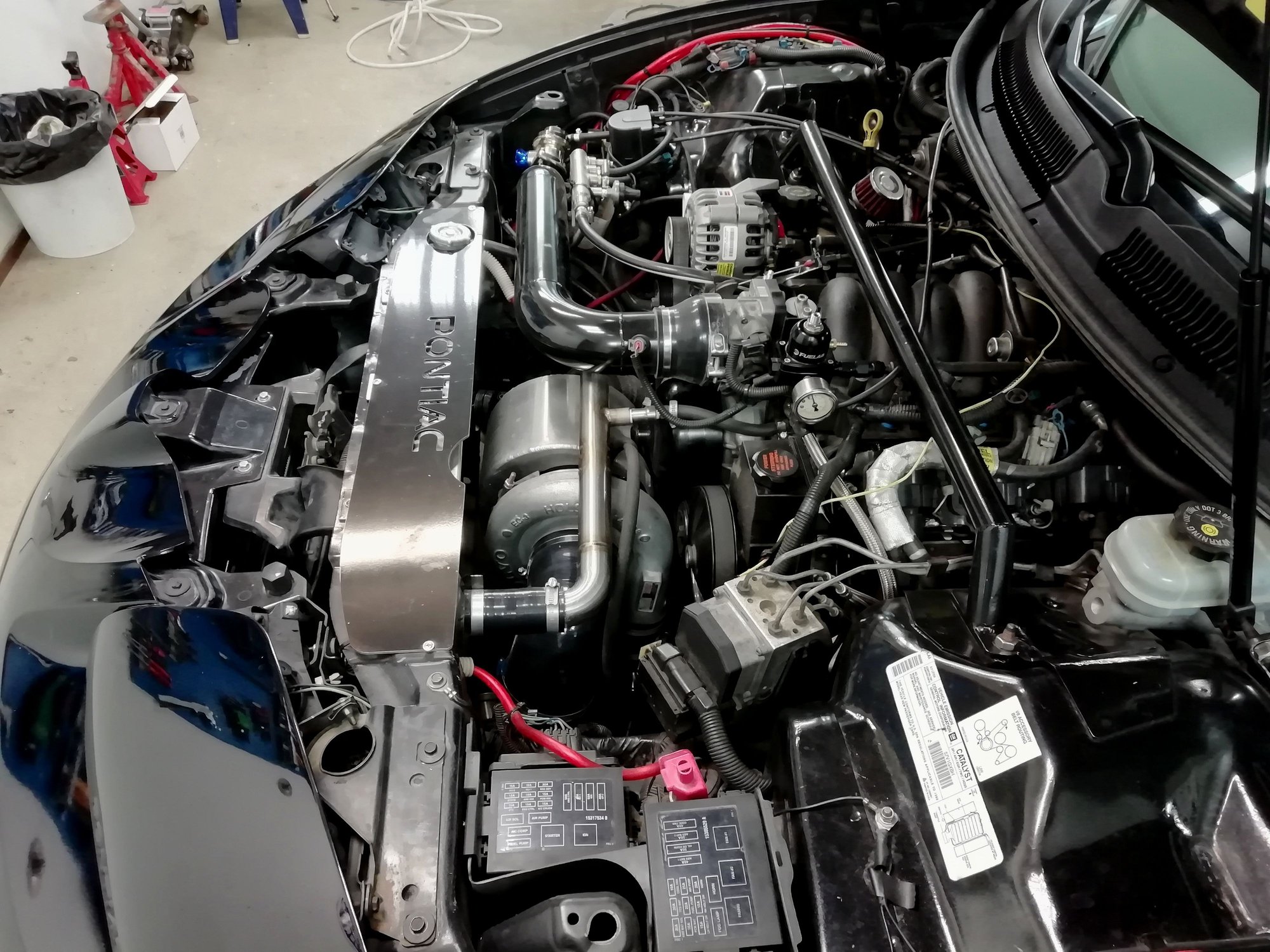

Heres my little build. Been owning this since 2012, bought it completely stock.
Its currently SBE ls1 + t56, with 228r cam, ported heads, dual valve springs, chromo pushrods, double timing chain, mellings oil pump and so on. With holset hx55, running about 8 pounds of boost now. Its been boosted about 15k miles now, maybe more.
I have no idea how much power it have, i tune it by myself with hp tuners, so no dyno pulls, but it goes like a maniac. Smoking 315 tires still at 3th gear, if the road is even slightly cold, it wants to go sideways at 4th. First it was fun, now a little scary, so i started to build 9 inch rear, so i can use some grippier tires (stock 10 bolt with 4.11). I'll make it myself from laser cuts, will be posting pics.

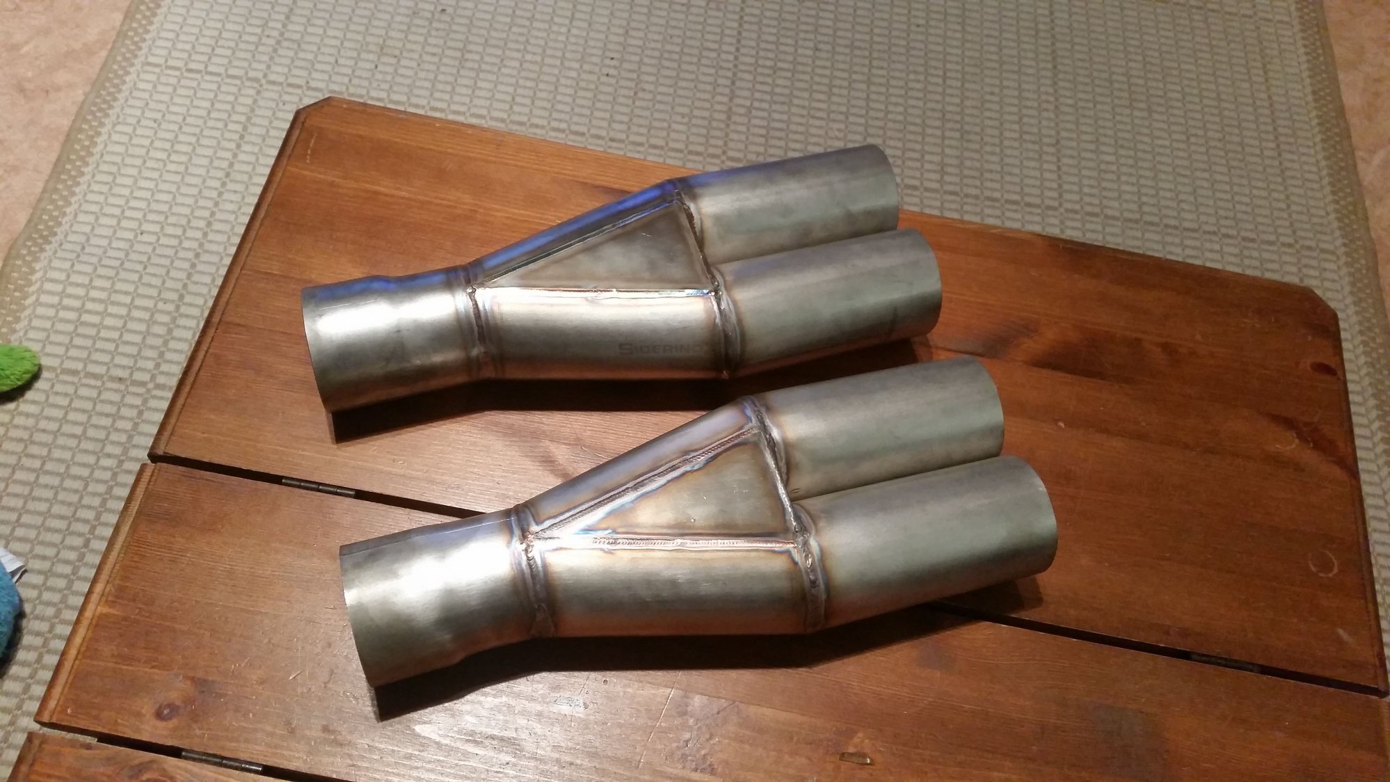

Exhaust tips i made couple years ago. 2x3" pipe, not the lightest i must say, but fills the bumper.

Holy smokes that's a tight fit. Interesting your cold side comes up from the pass side and not the driver.
I know..
I've relocated the battery in trunk, so theres lots of space for the piping.

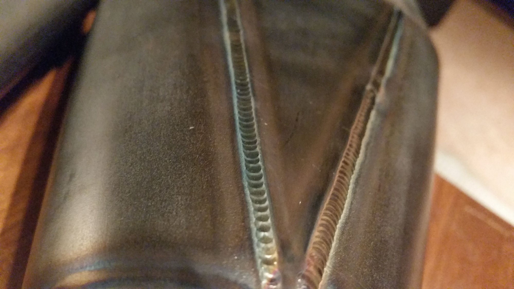

2.5" crossover pipe with 50mm wastegate.

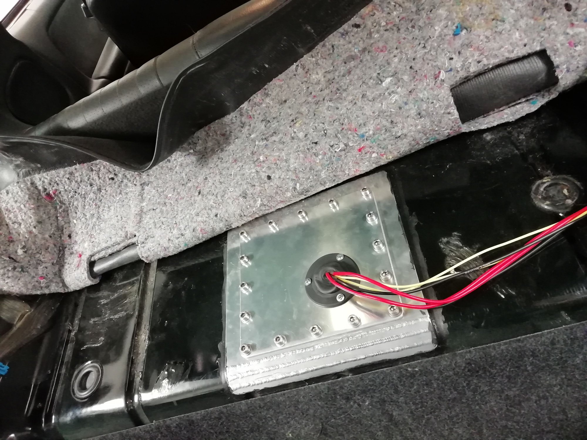

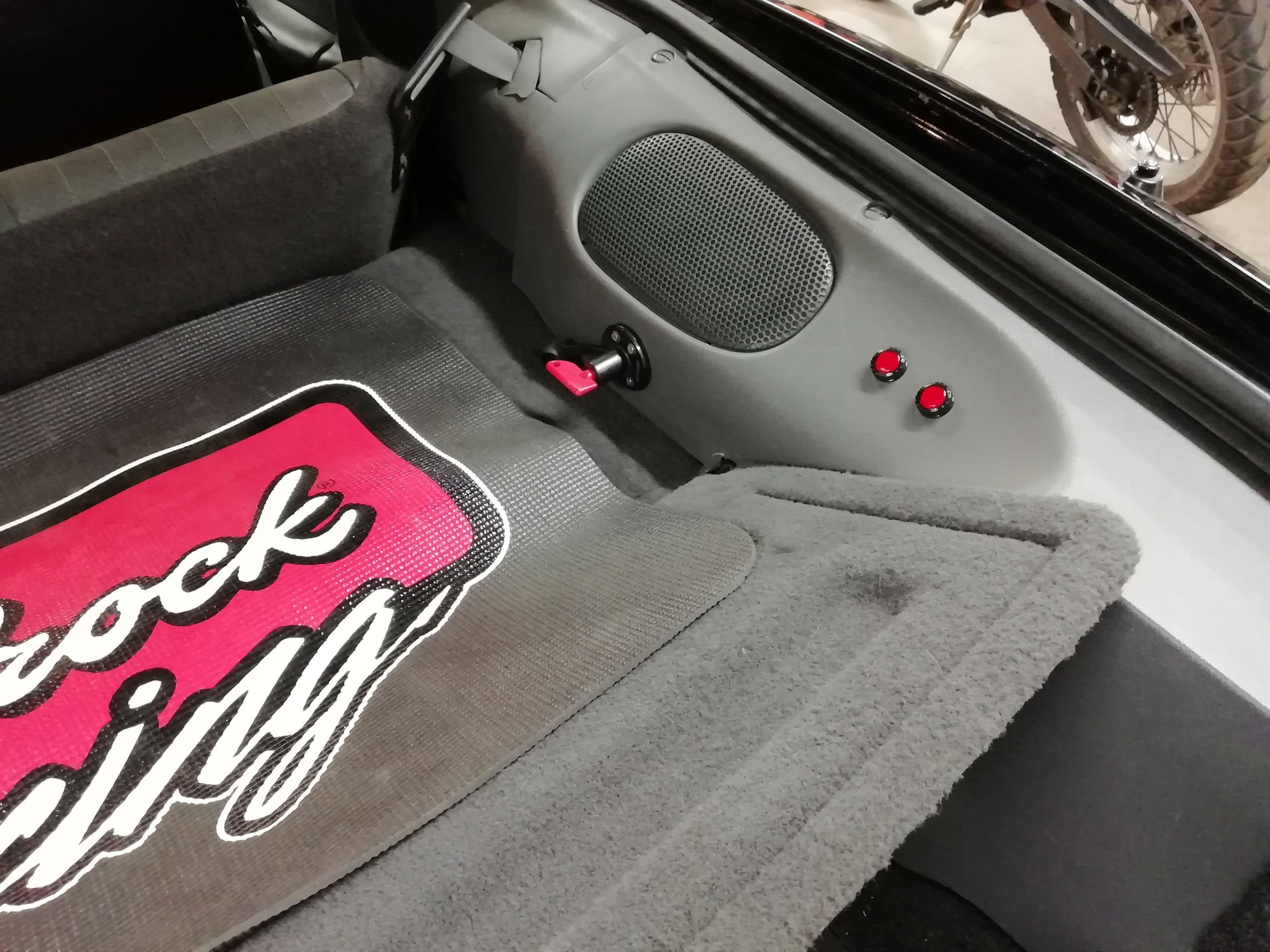

Trap door for fuel pumps (dual walbro 255) and lights, so i can see when the secondary pump kicks in (right at 4psi).

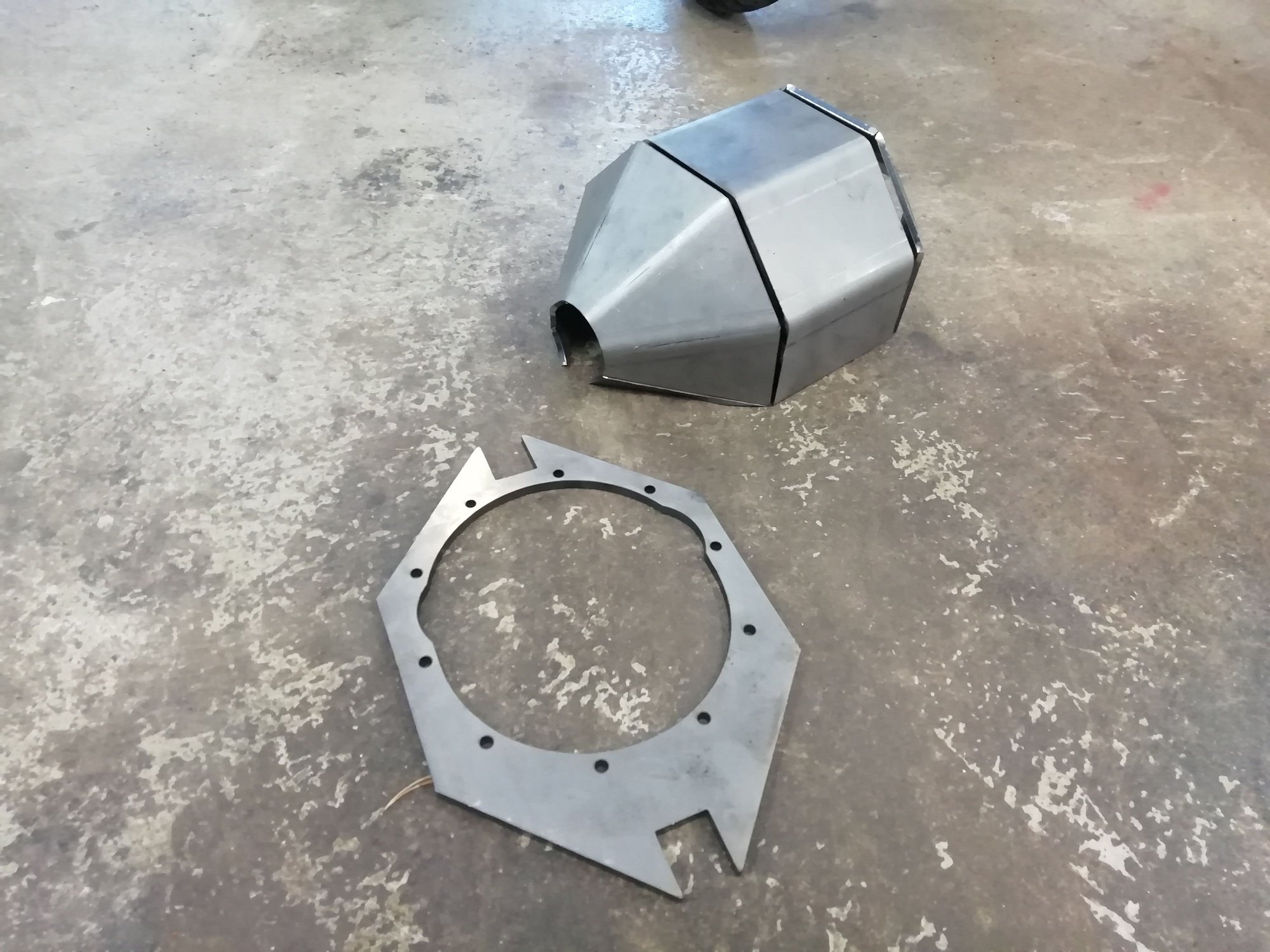

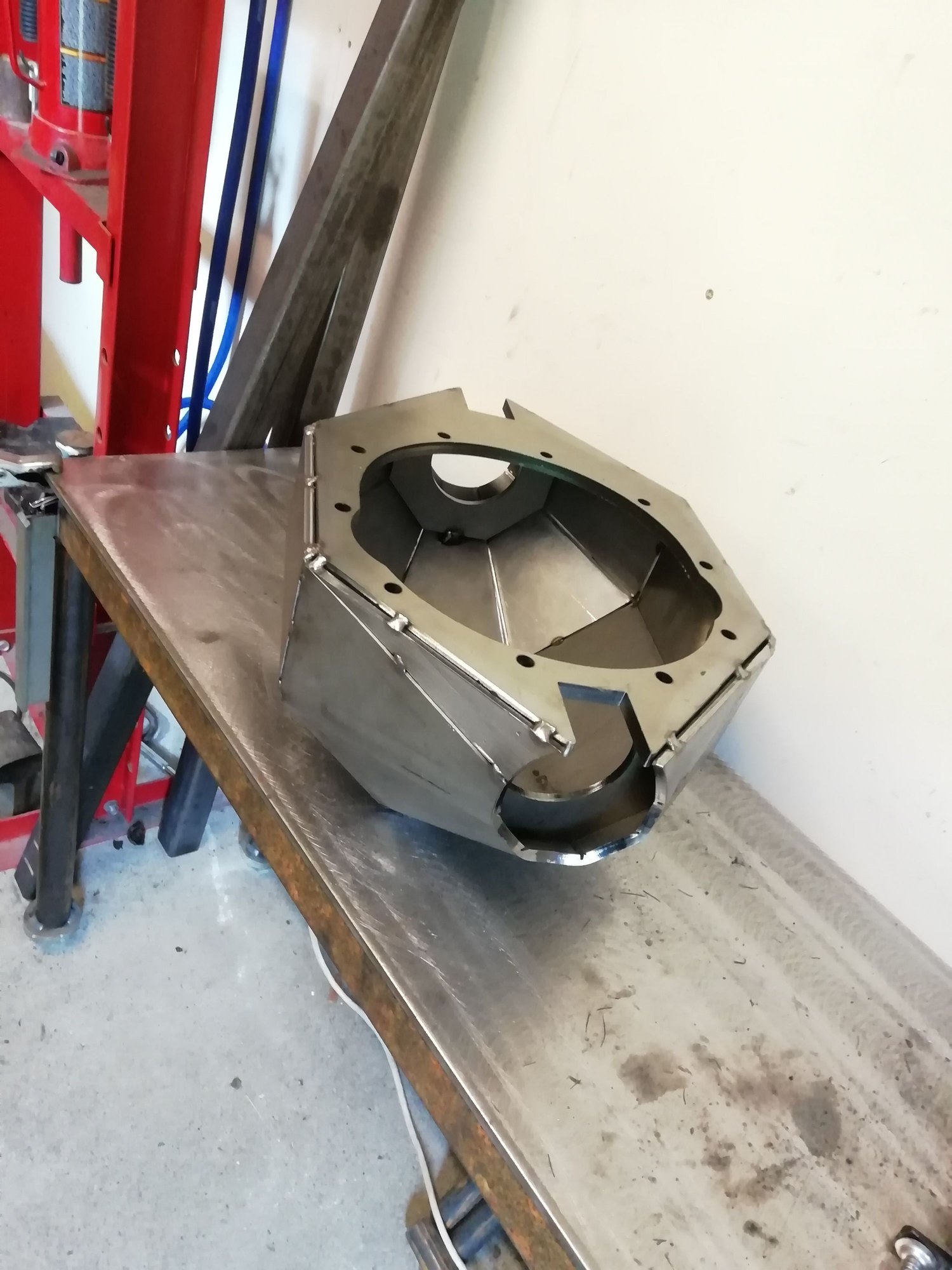

Starting this project.

If anyone has 9 inch third member (that sounds wrong) lying around and wants to help me with one measurement, i would be grateful. Measure from front plate to center of axle tube is 1.700 inch, im i right?
