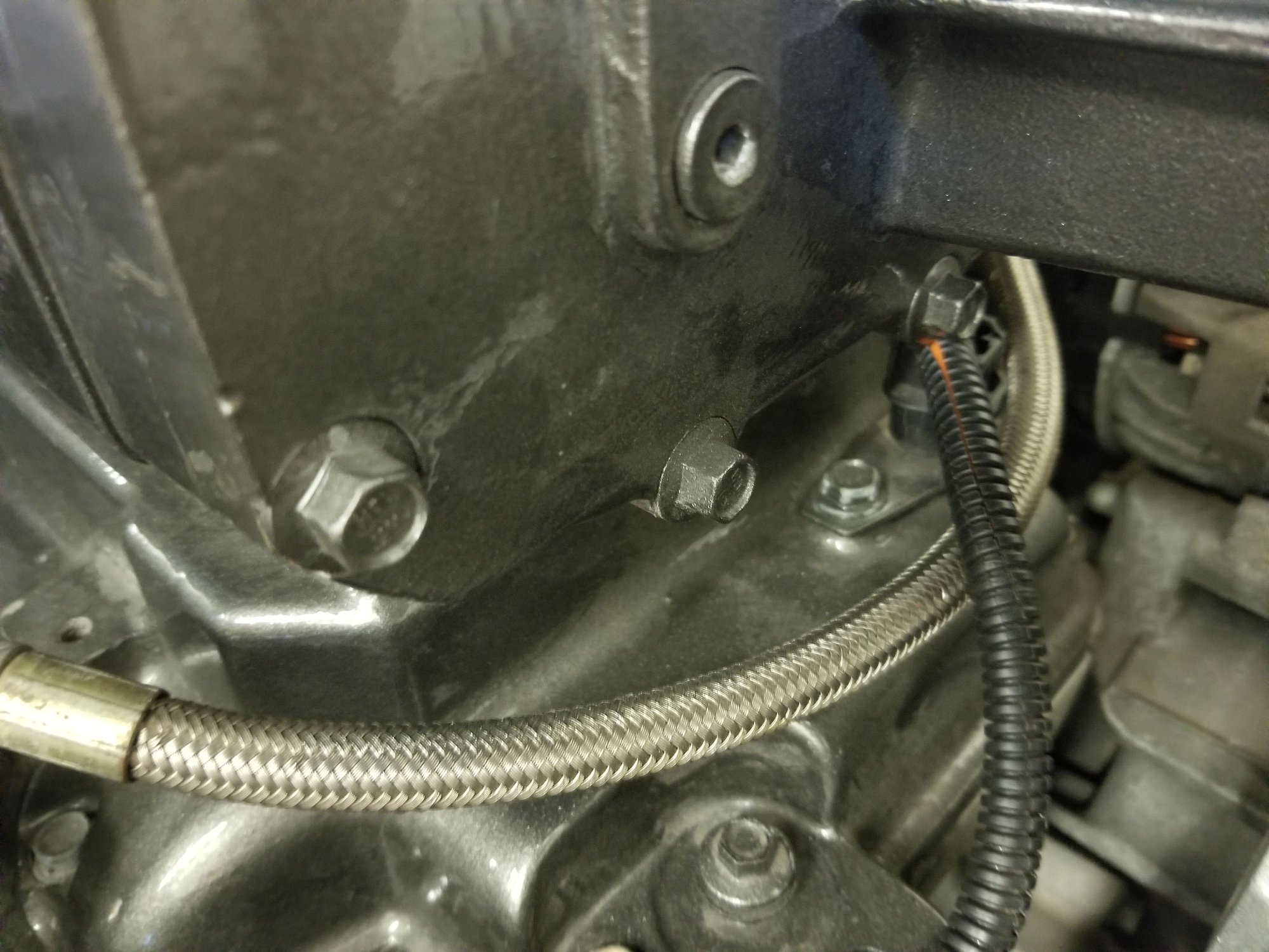

Thanks for the input. I may just go e85 or ice tank for race day. I did install a thermocouple under the intercooler and it is reading 8 to 10 degrees cooler than the sensor under boost so I may just use this also to dial it in instead of using the iat sensor. I will look into the exhaust temps also.
