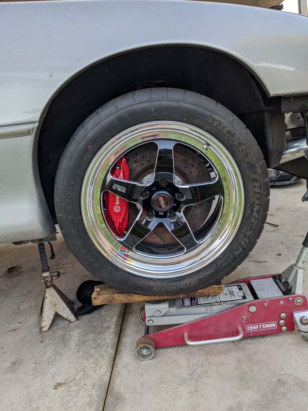

I have reading as much as possible on drag tires for my car and I am a bit confused. Based on my setup (noted in my signature) and 3.73 gears (hopefully 600whp), I believe I should be using 28" tires.
Based on that, I have concluded that perhaps these four may be an option; however, please direct me in the right direction if I am wrong:
  1. Mickey Thompson - ET Street R - P275/60R15 / 28X11.50R15 - #3559 (28.2")
  2. Mickey Thompson - ET Street Radial Pro - P275/60R15 - #3754X (28.2")
  3. Mickey Thompson - ET Street S/S - P295/55R15 / 28X12.50R15 - #3454 (28")
  4. Mickey Thompson - ET Street R Bias - 28X12.50-15LT - #3561 (28")
I was really leaning towards the ET Street S/S (#3). I've heard a lot of good things.
I heard that some tires give too much sway. The track is about 30 minutes from me, I would prefer to drive on the drag tires rather than swapping them out on-site just for convenience.
If it helps, I will be running Weld S71 15X10 (7.5BS) wheels.
Let me know your thoughts. Thanks.

I ran #3 on the street to and from the track multiple times.
Summit has them for $412 (for 2) shipped with their $20 off promo.
Thanks for you input as always.

I ran number 3 for both track and street duty. Got tired of fighting the launch with a radial and a 6 speed, swapped to Hoosier QTPs and never looked back. Street duty is still a radial though
28X11.50-15LT QT Pro DOT?
I got two tires for $372 on Summit. Great deal. I may just give the MT's a try. Not planning on competitive drag racing. If I notice the MT's are just too horrible to fit my purpose then I will give the Hoosier's a shot.

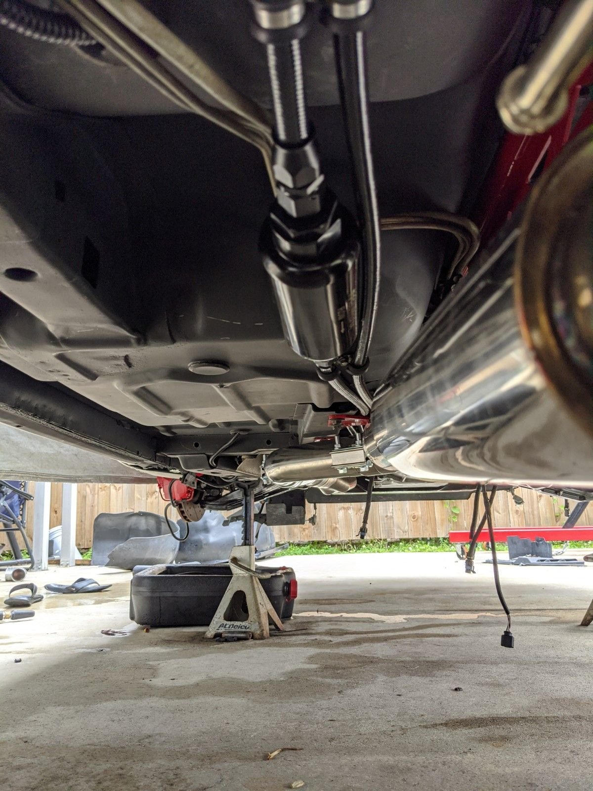

Alright. Update. Finally got the motor turned over on Monday. Today I filled all the fluids, got the bubbles out of the coolant system and let it run for a little over 35 minutes. Car maintained temperature and remained stable. I am missing just a few more parts such as the bypass valve for the procharger, finish the electrical portion of the meth system, and waiting on some hangers from Speed Engineering. I ordered the exhaust from them and apparently the box had no hangers so I mounted it all up by the rear is sagging.
Question: I did end up running PTFE lines (8an & 6an), though I was not planning on it, but the original lines were very rusty so I thought it would be worth the investment. Now with the exhaust mounted I see that the lines are fairly close to the exhaust. Moving the fuel lines would be an option; but it probably wouldn't solve the problem.
I will get a few pics uploaded on the exhaust and PTFE lines shortly. In the meantime, here are a few other pics. BTW, I made brackets for the intercooler to mount securely. What you see in this picture is purely just presentation to figure out what I would do to.

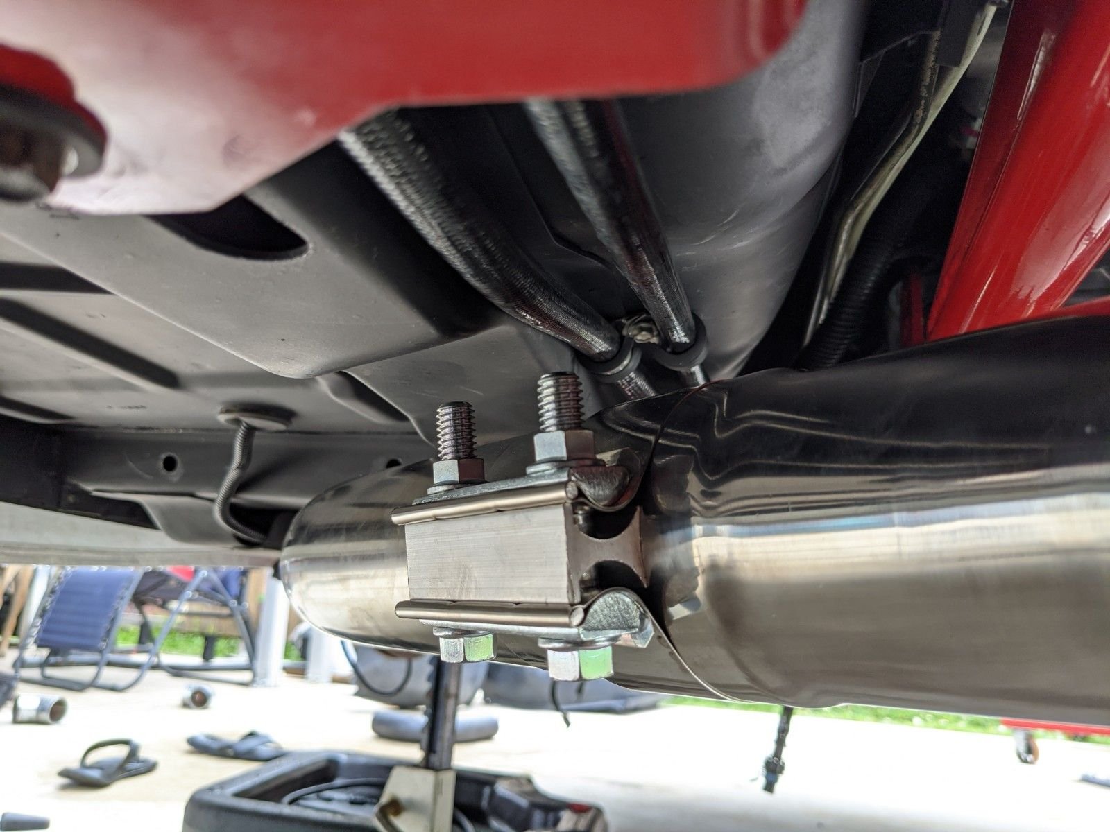

here are the pics of the exhaust system and distance to fuel lines.

Do you guys think the fuel lines will be okay or will I run into issues with vapor lock? Should I sleeve the lines to protect them from radiant heat? Or should I just leave it like that and I should be fine? They are PTFE lines.

Looks good man. Couldn’t you just wrap the exhaust in that area to keep heat off lines and wrap lines as well? Underneath looks good what did you paint it with? Thinking of using POR15 on mine but seems like a lot of work and wondered if I just used primer and paint rattle cans if that would be good... Camaro never sees rain, garage kept and just a weekend cruiser.

I was thinking the same thing. I guess i will order the sleeves for the hoses first. Wrapping the exhaust may be a pain around those clamps. The Clamp area is usually the area closest to the fuel lines. I used an undercoating paint. No POR15, though that is a very very good product. I used a local product. It isnt as thick as POR15 though.
