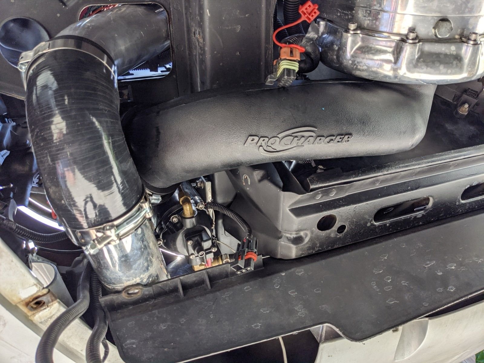

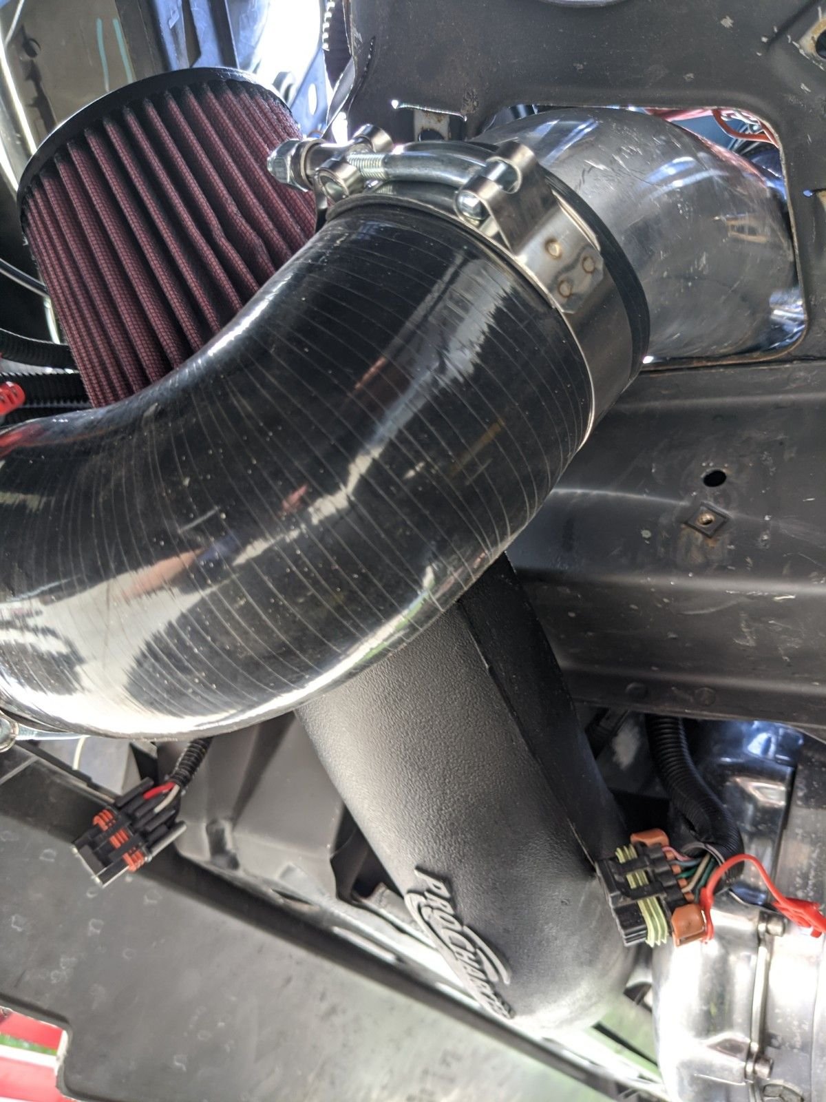

I finished the intercooler piping and I have to say, I think I found a pretty sweet spot for my procharger filter. Check it out. I have all the clearance I will ever need and its in a pretty safe spot. Just wanted to share.
The only downside, and I'm not really even sure, is that the filter is 5 inches in length.

Progress looks good, so is the filter down by where the horn is? When I had my Vortech on my LT1 I had the filter come down into the driver side fender behind the lights. I just cut the hole open bigger to fit a huge filter.
