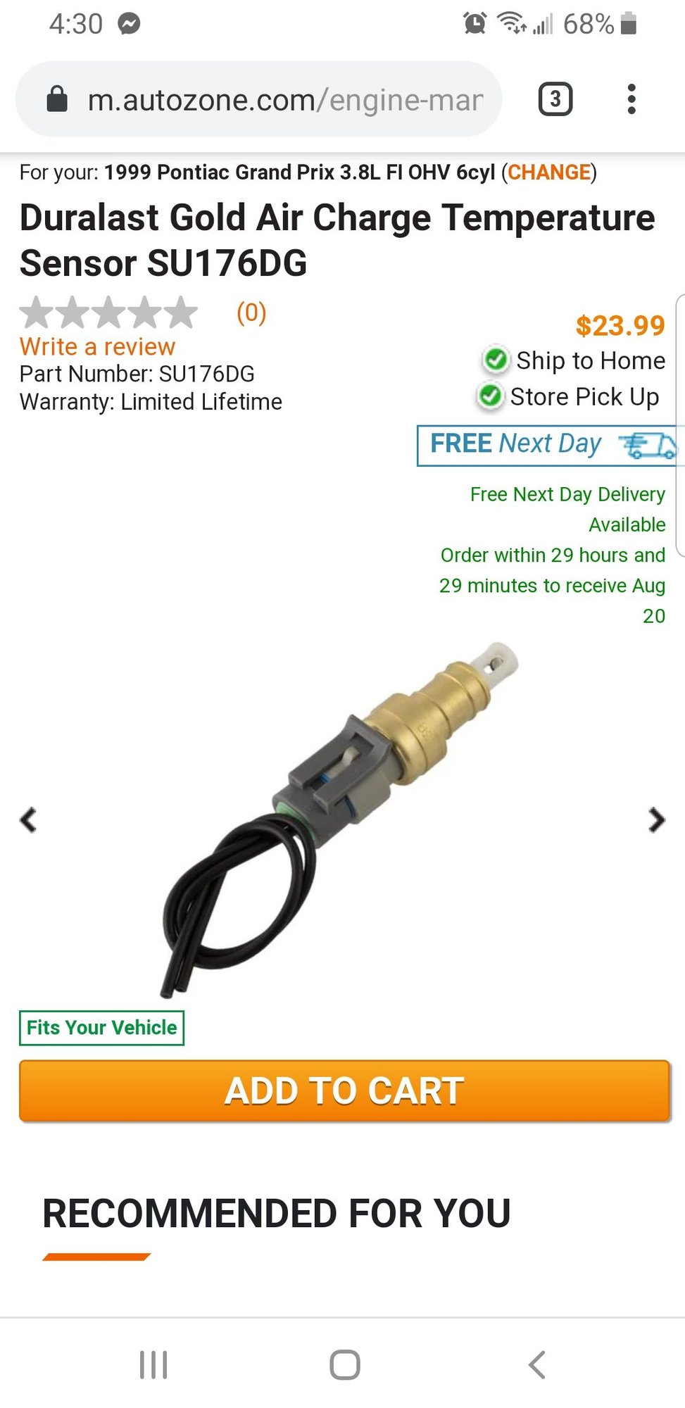

My thought with the grand prix iat: it's in the hp tuners supported vehicles list. So I could download a stock tune from the repository and see if the values match with my existing calibration for IAT?

I always use the plastic GM sensor with a truck intake. Its just so easy to do. Drill out the evap hole a little bit and smack in the IAT with a rubber mallet or a dead blow and a piece of wood. Hitting the sensor directly with a hammer will break it.
Excellent!! Did you have to change the values for that IAT to make it work? Think it's even worth looking at the grand prix tune to see if the values are close?
I do have a 1/2" drill bit so, sweet!! And do you just put the sensor by itself in? Or do it with a grommet? I feel like the grommet may be the way to go to make sure it seals nicely. And I'll definitely make sure to be safe with the sensor
Found a sensor with pigtail connector incase I cant find mine, it has the sensor, and pigtail but it is a metal cased sensor. Looks like it's the same design as the original. Think this will work for me?

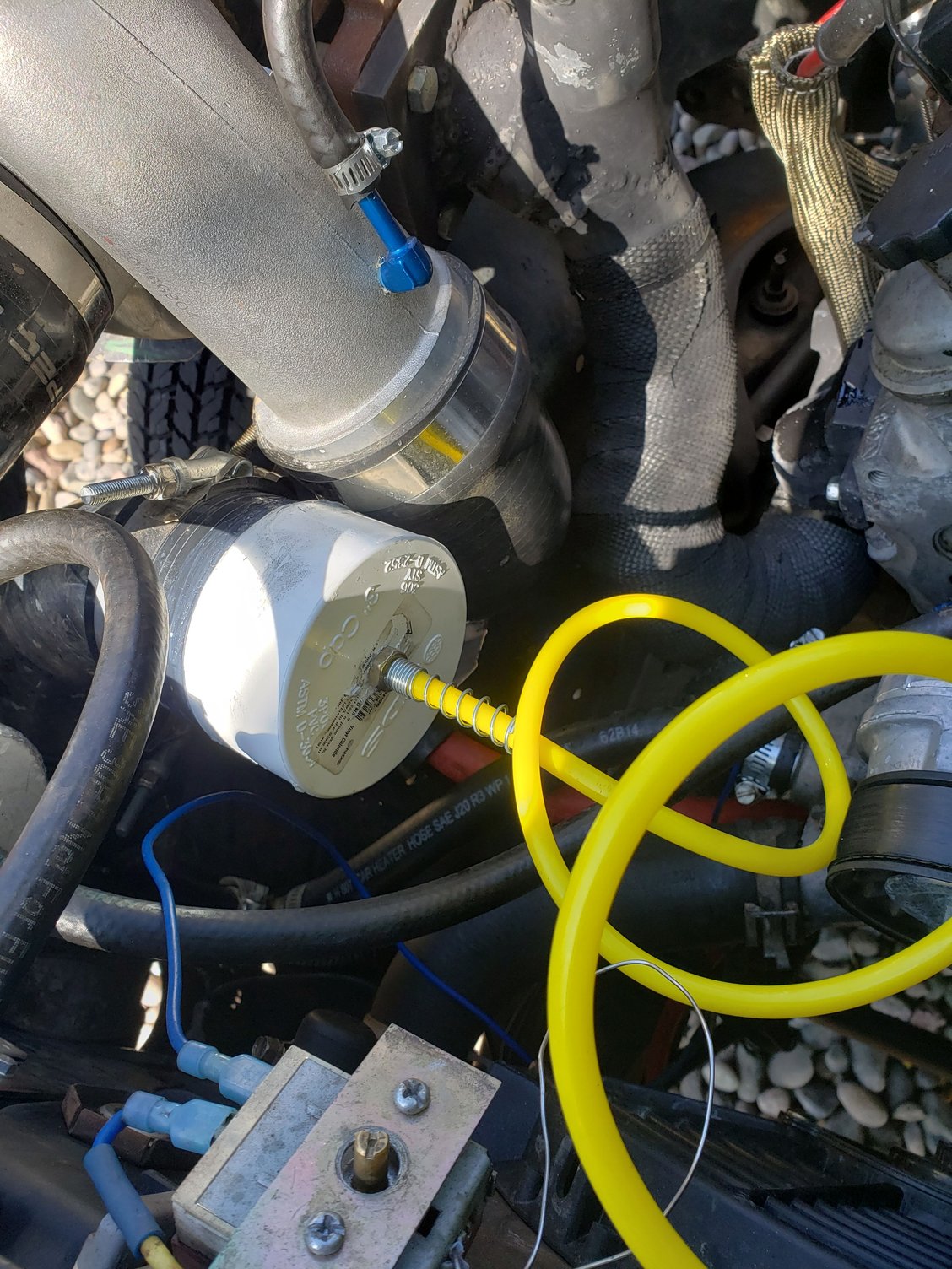

Holy crap boys!!! So.. I checked out the coil subharness' and everything looked good. I checked all of my grounds and sensor wires, took me about 45 minutes to disconnect all the plugs and ohm out EVERYTHING in my harness as requested. It all looked great!! .003-.004 Kohms on everything. I'm mighty impressed with this stock harness I modified. All of my other grounds in the harness and battery etc also tested out great! I have some 4ga cable that I'm going to use to make a ground from the engine block to frame. Took my exhaust u bend outAnd as far as I could tell, I didnt have any restrictions there. I capped one end up with a tiny hole for venting and pressurized the whole thing and it flowed really nicely according to my very untrained eye. May re visit later if I have a better way of testing it.
NOW... da-dida-da!!! I tested for leaks on my cold side. And I'm beginning to really kick myself in the pants for this xD I found a nasty leak from a coupler right after my intercooler. I tested it at 20psi. Its higher than the 7lbs I'm trying to run, but I figured to go above my actual pressure was the smartest thing, after all, I want to turn it up in the future
(Just a few more lbs I PROMISE &#129310 Nobody said no take backs!! Hahahahaha. As silly as this was, I was so happy to hear that leak. I'm going to tighten the bad boy up and re pressurize to make sure I haven't missed a leak. Thank you all sooo much for all if your insight into this issue. I'm gonna go ahead and make an *** out of you and me and assume that this boost leak could cause my map pressure to suddenly drop off? I've never been so happy to find an issue with a vehicle in my entire life. I feel like I'm on top of the world right now!! Once I get a new ground cable on this pig I'll be trying it out and seeing what happens!!! Definitely will post updates. Just wanted to let you guys know my findings before I continued with leak sealing. Every single one of you guys rock for having the patience and the know how to help me resolve this thus far. Even if I went through all the other stuff first, if anything you guys gave me the faith in all the other things to know this sucker is pretty solid. Back to leak finding!!

Quick update before I start cleaning up for the day, I found two more leaky couplers and got those tightened up. Also found a very small pinhole leak in my charge piping where I had welded it together *face palm* I sprayed everything down one connection at a time with soapy water to make sure there wasnt anything I missed. Kept blowing my oil cap off, so catch can is definitely next on my things to purchase. Gonna get the pipe welded up this evening after work. And retest it. If all goes to plan, hopefully I should be taking her out for a cruise first thing in the morning tomorrow!!
