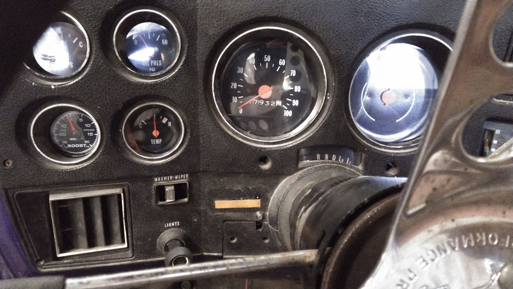

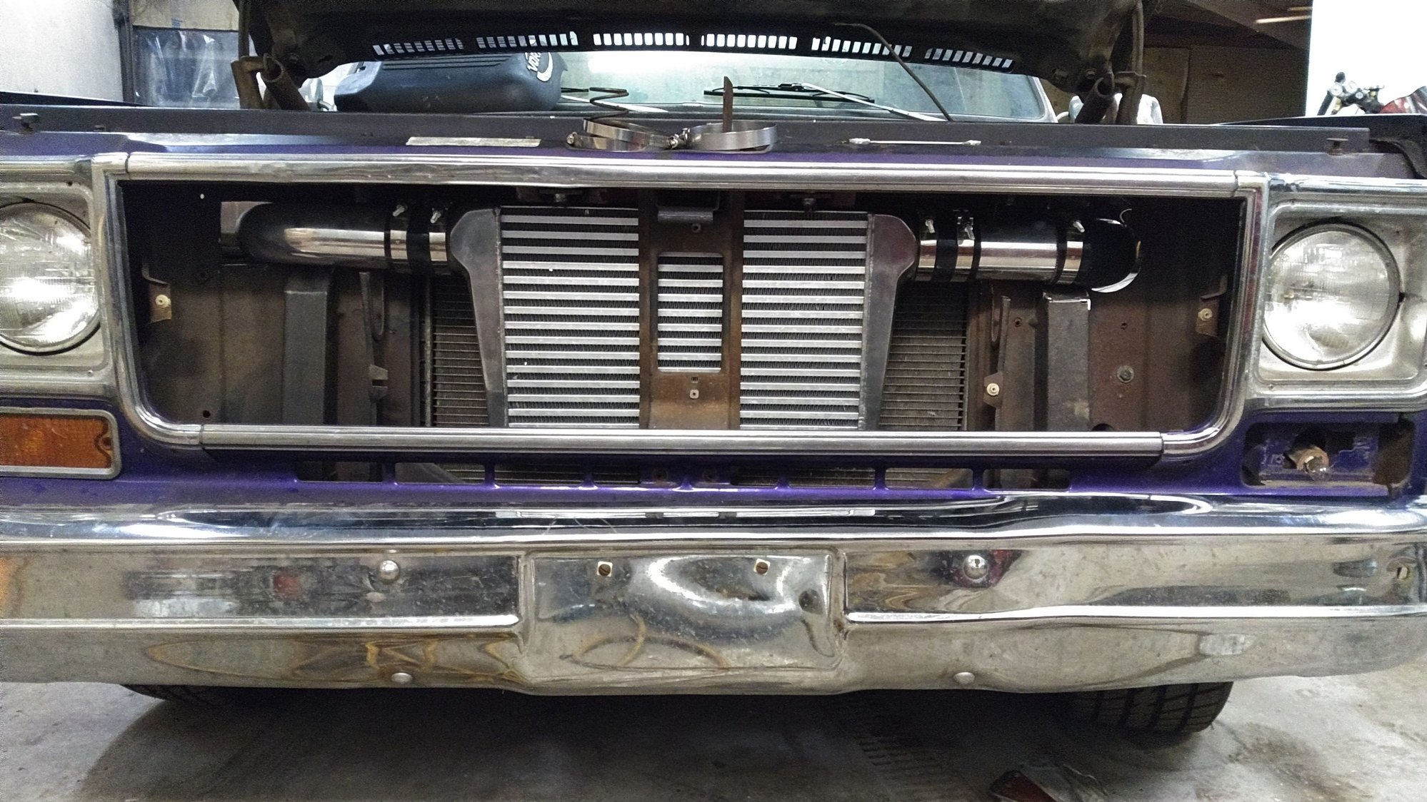

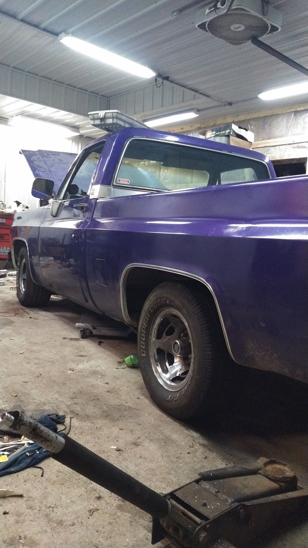

Thanks for the quick advice and input here are a few pictures of it
