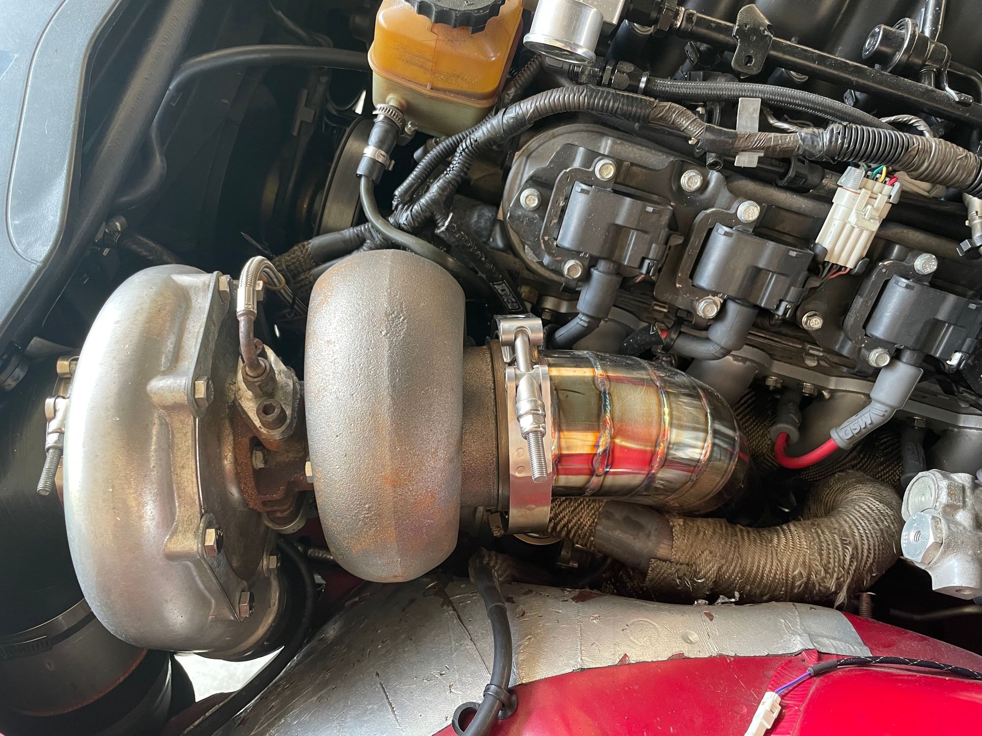

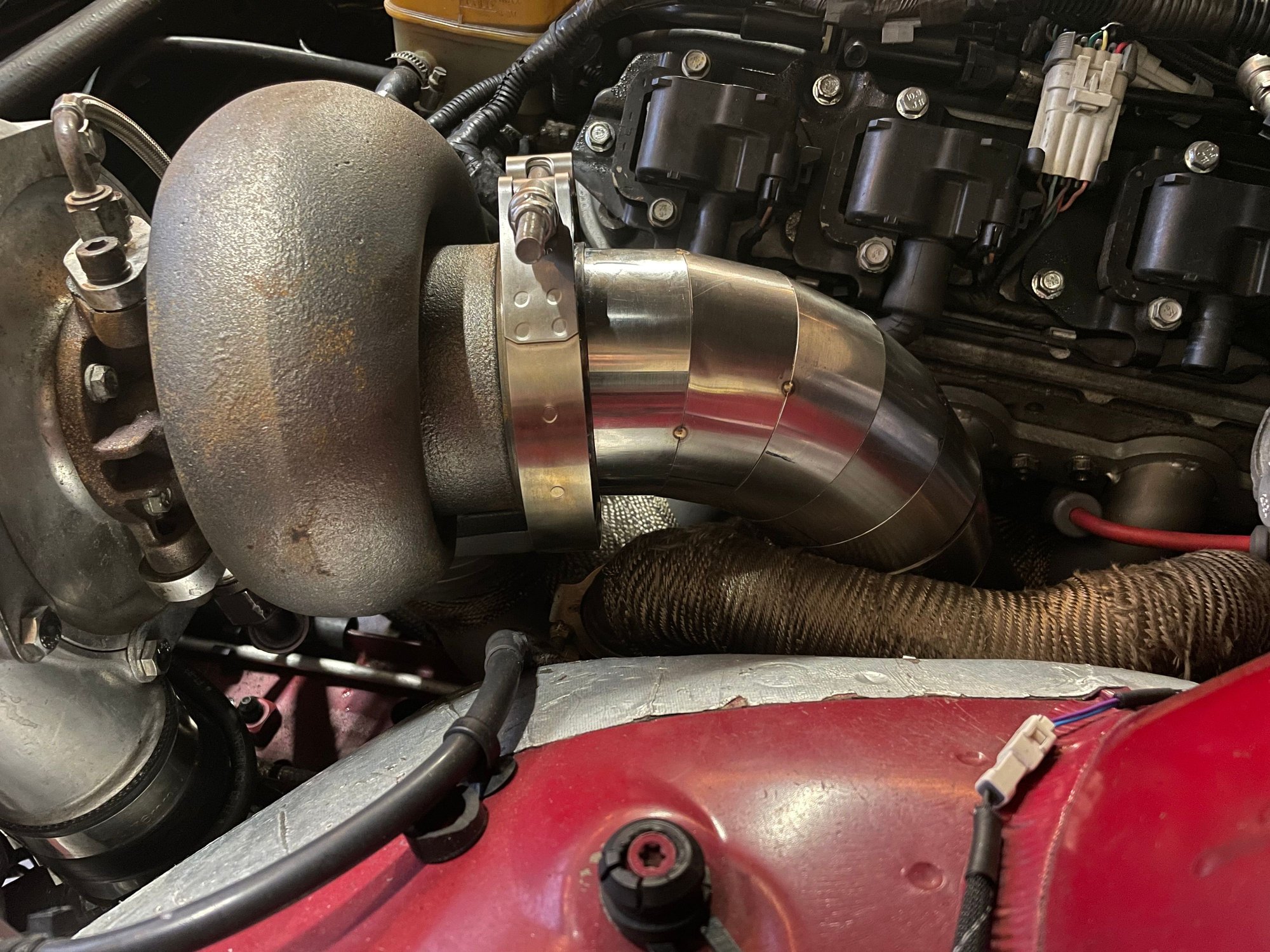

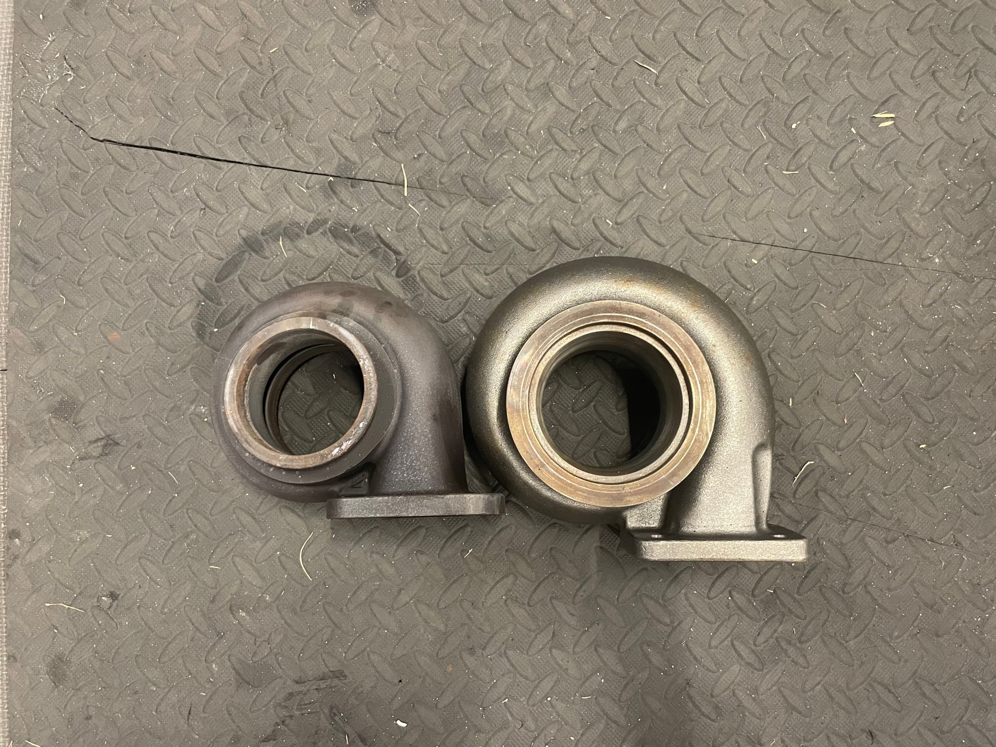

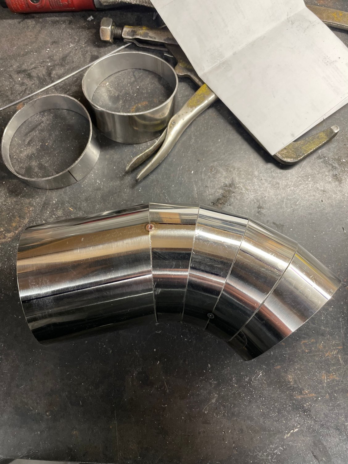

Thread resurrection. I bought the 1.25 housing quite a while back. And I haven’t had time to fool with it. I got a wild hair yesterday and started cutting pipe for it and jacked up the car to start taking it apart. I’m still nervous about losing my excellent spool I have not. She comes into boost quickly and not abrupt. I hope I don’t mess that up. Here’s a couple pics as I work on getting ready to start cutting up the original down pipe

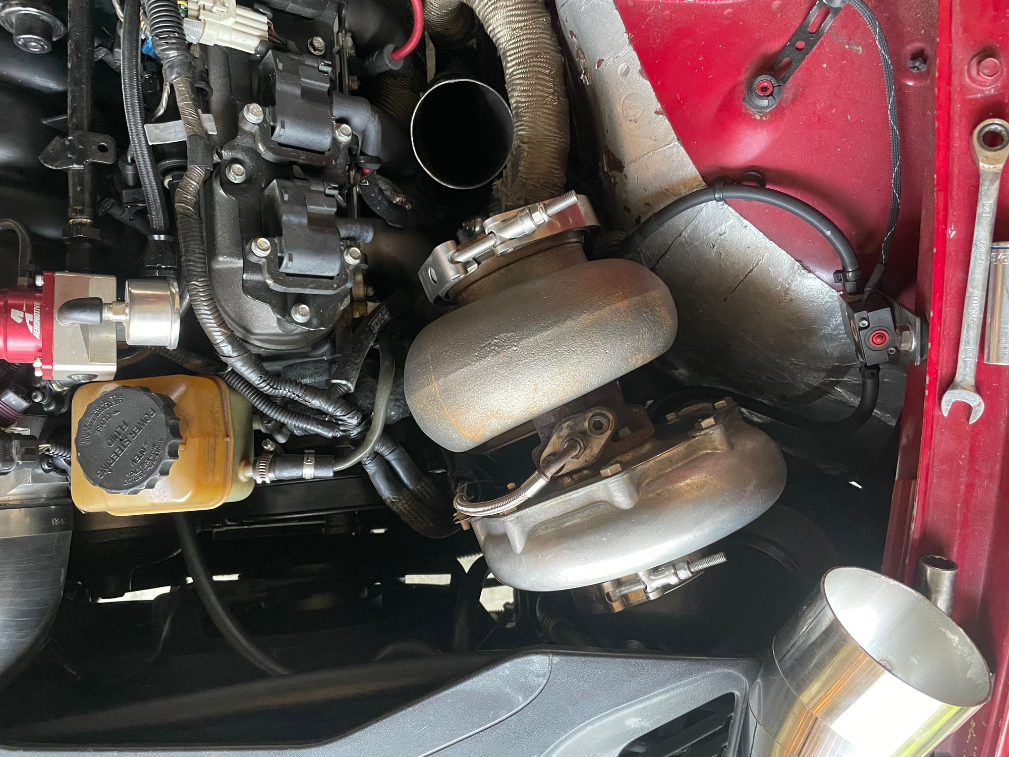

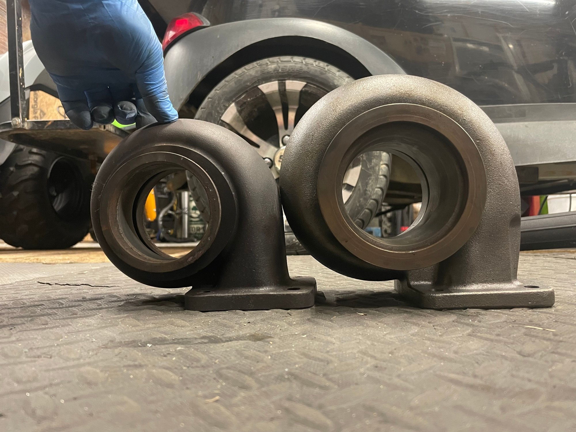

Jesus. Look at the size difference!

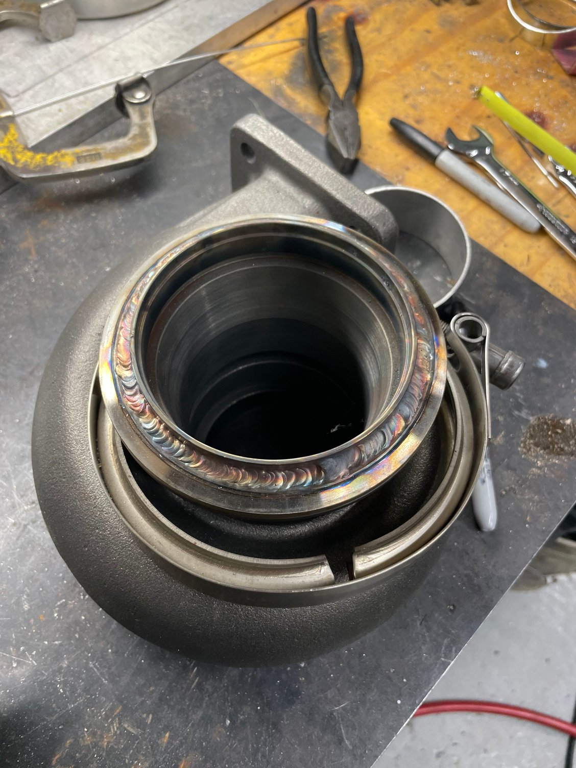

Housing mounted. I’m cutting and welding the down pipe right now

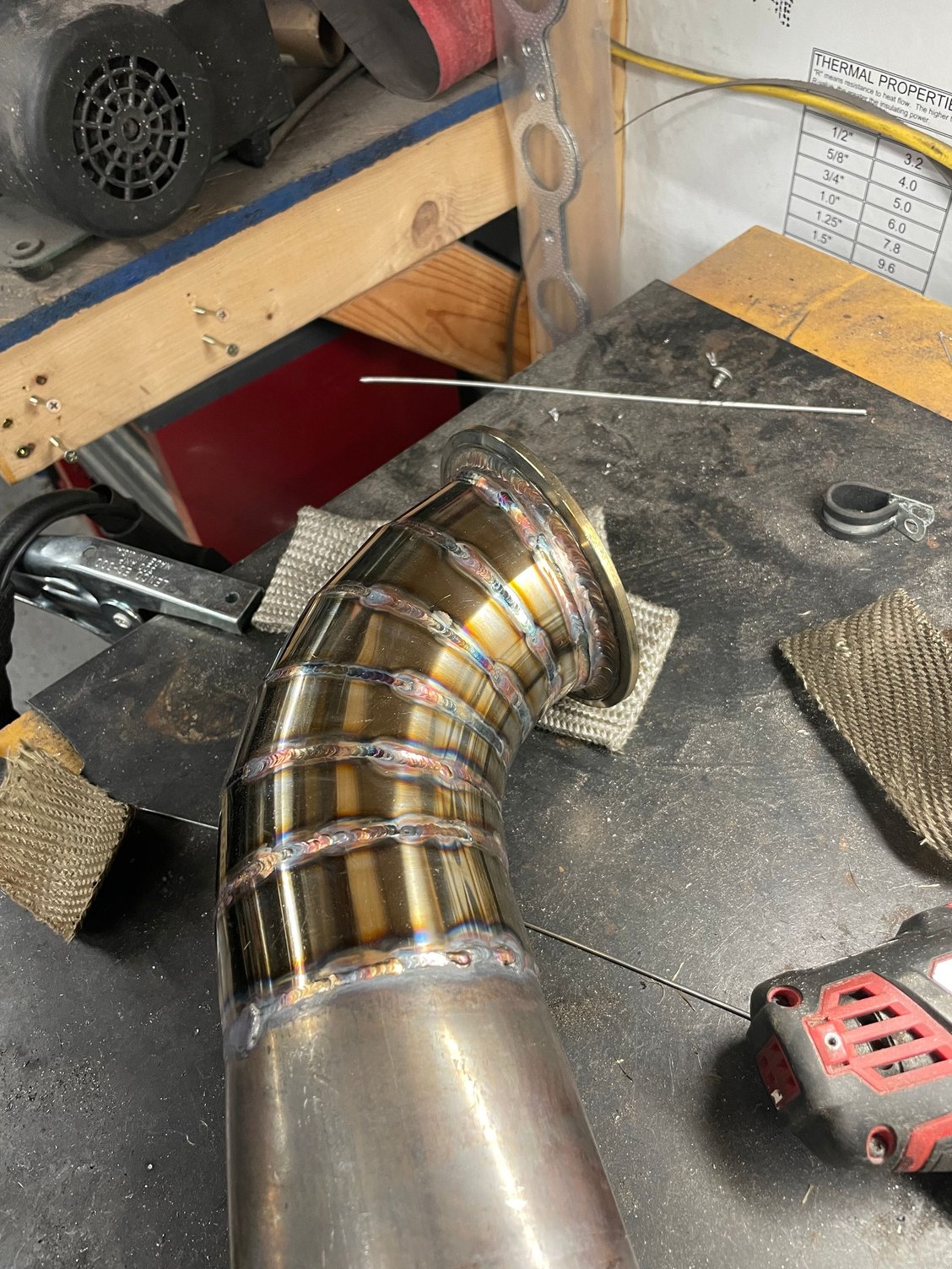

I’m fighting getting the downpipe to fit

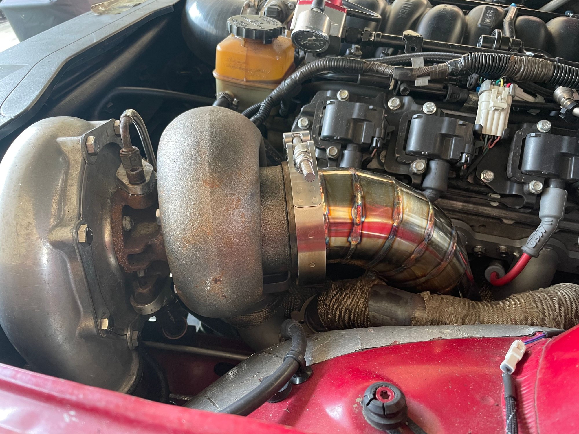

Got it done. Test fit everything and it’s good. Cranked it and it actually sounds better. I gotta pull the down pipe back off and wrap it.

Looks good. Curious on the results.

Looks good, the 1.25's are girthy units! I had good luck with them.

i know. I sure didn’t think it was going to fit and I almost put the car back together. I even marked the down pipe where I cut it just in case it didn’t work out. I’ve gotta go pull it back apart and wrap it. It’s a shame because I love the way the pie cuts look.

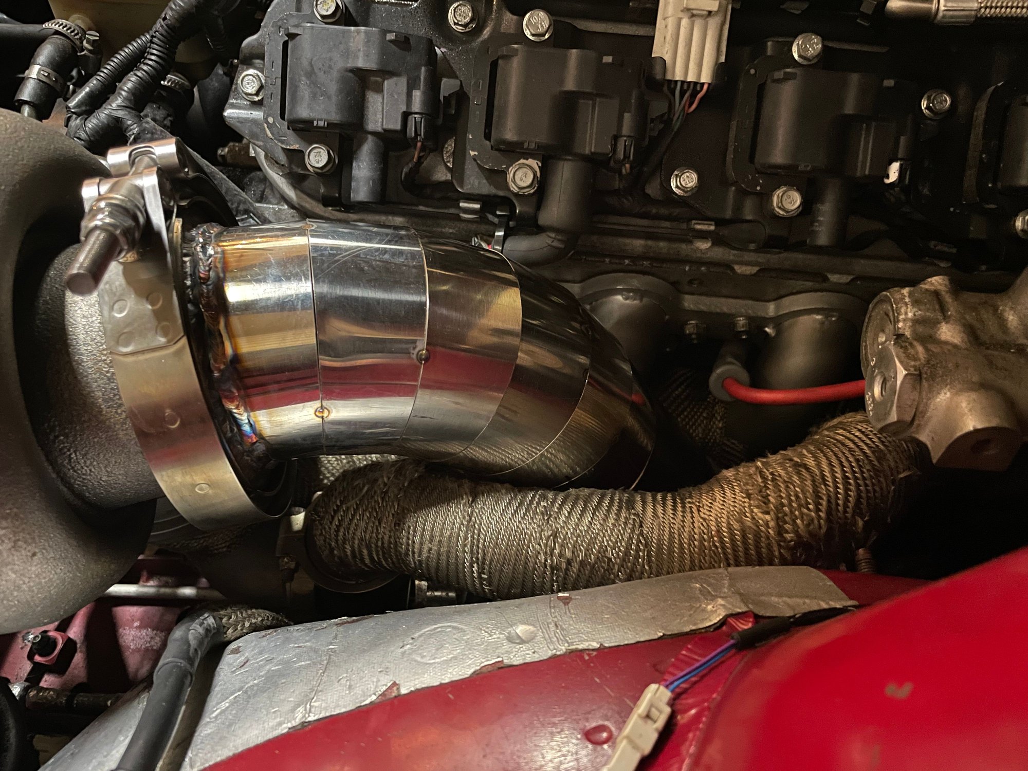

One last pic and a question. Do you guys think I could add another degree of timing on the higher rpm range? Like past the torque peak. Right now I have it at 11 degrees pretty much straight across. Still on pump 93 with a 5gph nozzle shooting washer fluid past 15psi.

I'd read some plugs.

I looked in my tune, I had already ramped it to 12. I’m gonna leave it where it is.

I always ramp timing down to peak torque and back up to peak rpm. Fuel burn rates stay nearly the same, so peak cylinder pressures will arrive too late for maximum power if you do not add timing as rpm increases. You need a lot more timing at 7krpm than 4krpm. You can also lower EGTs and make life easier on your turbo with higher timing at higher rpm.
