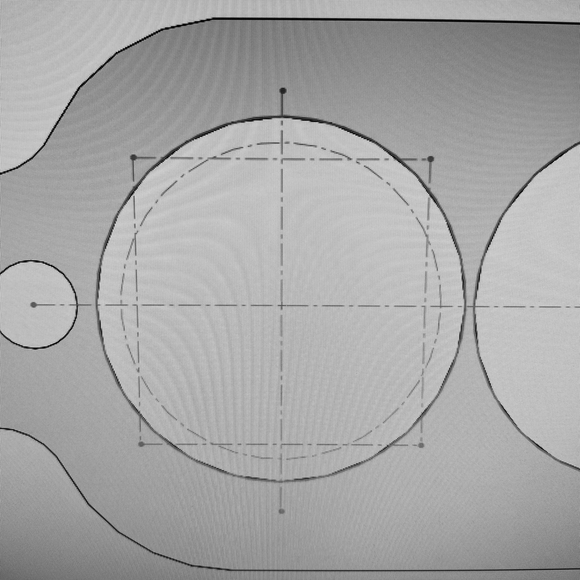

So as I am stuck with crappy D port heads, and I want to minimize the amount of fab work required. Thinking of laser cutting a flange that has circle ports for SCH10 1.25 OD stuff. Square dotted is head port, circle is the elbow diameter.
Should I be concerned with the overlap?
Most of me is thinking is a 383ci motor pushing a T4 76mm and its overkill to begin with so the overlap won't hurt.
