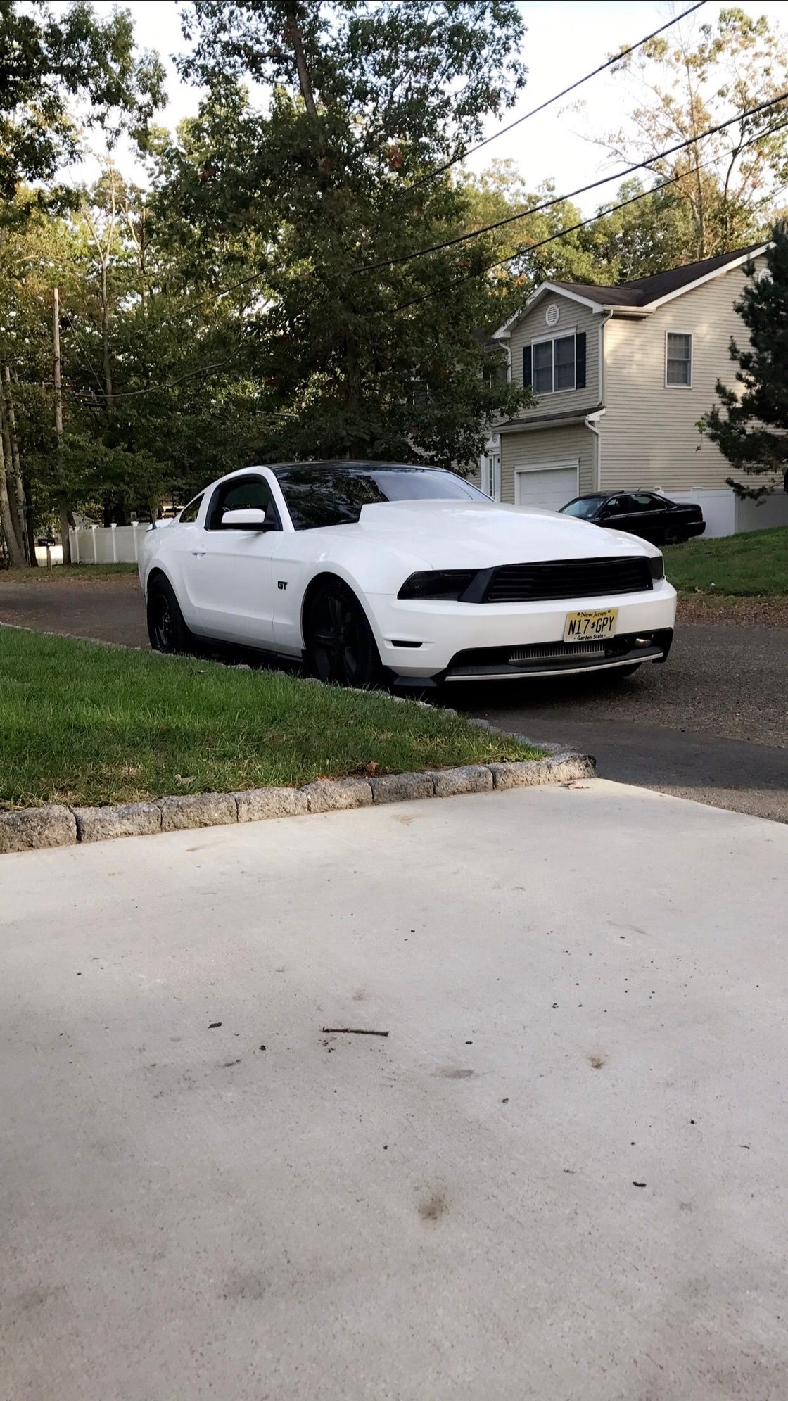

Here痴 the car 😁🤩 I love it lol

so forgive the blasphemy, but why not SC or turbo the ford motor? i see plenty of those at the strip running solid times.

If you look reaaaaal close you値l see the intercooler in the grill lol unfortunately it痴 the odd year 2010 4.6 3v so I was tapped at about 500hp and I want a lot more lol plus I got this gen 4 5.3 for peanuts so hell, why not lol I致e always wanted to do one and I love how my car looks. I think the set up would be pretty mean
