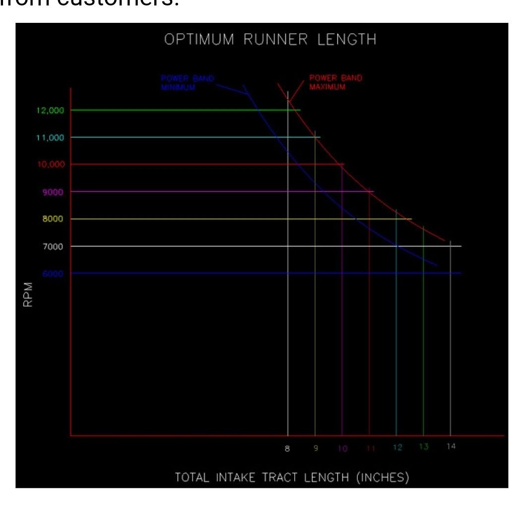

shawn hoger's Avatar
Joined: Jul 2015
Posts: 38
Likes: 9
From: Il
Old Feb 7, 2020 | 02:09 PM
Brolan04z's Avatar
Joined: Oct 2013
Posts: 12
Does this length include the intake tract in the head or just the intake manifold runner length?

manifold+cylinder head
