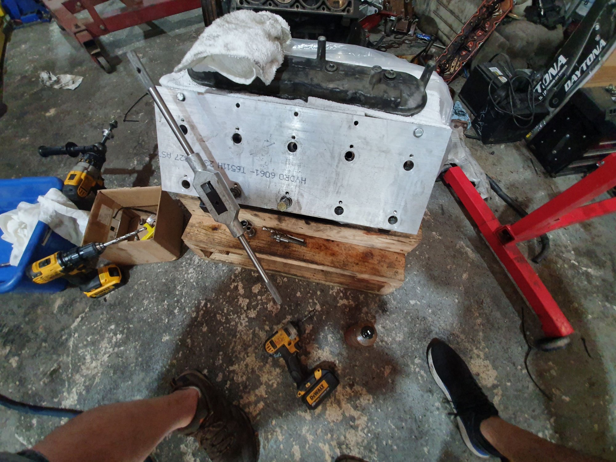

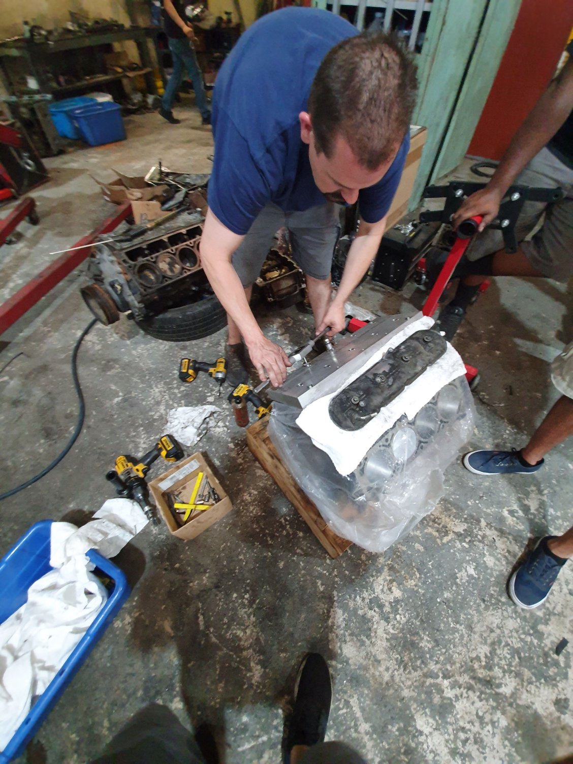

I had badass68 come over (ryan) and do the 1/2" conversion on the 370"
he suggested the viper studs but I am doing the cleveland studs, despite them being made out of a "weaker" material, they are definitely an upgrade over factory style fasteners.
Ryan doing the 1/2" conversion, he had already done one bank by the time I took this picture.

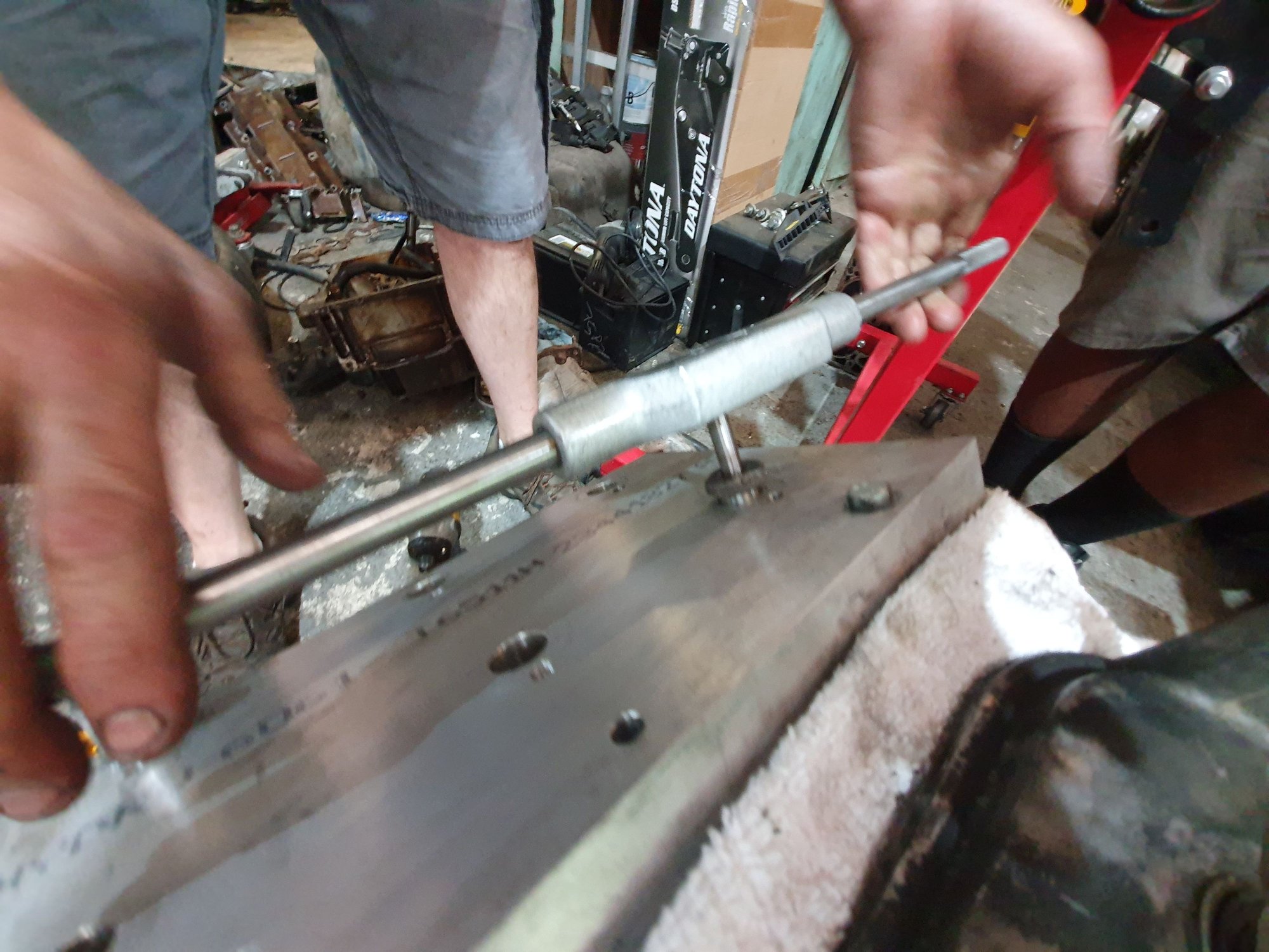

A simple dewalt drill, a drill bit and some collars is all it took ryan to ****** me out of some $$$ lol jk
Tapping the block by hand, fixture was also made by ryan

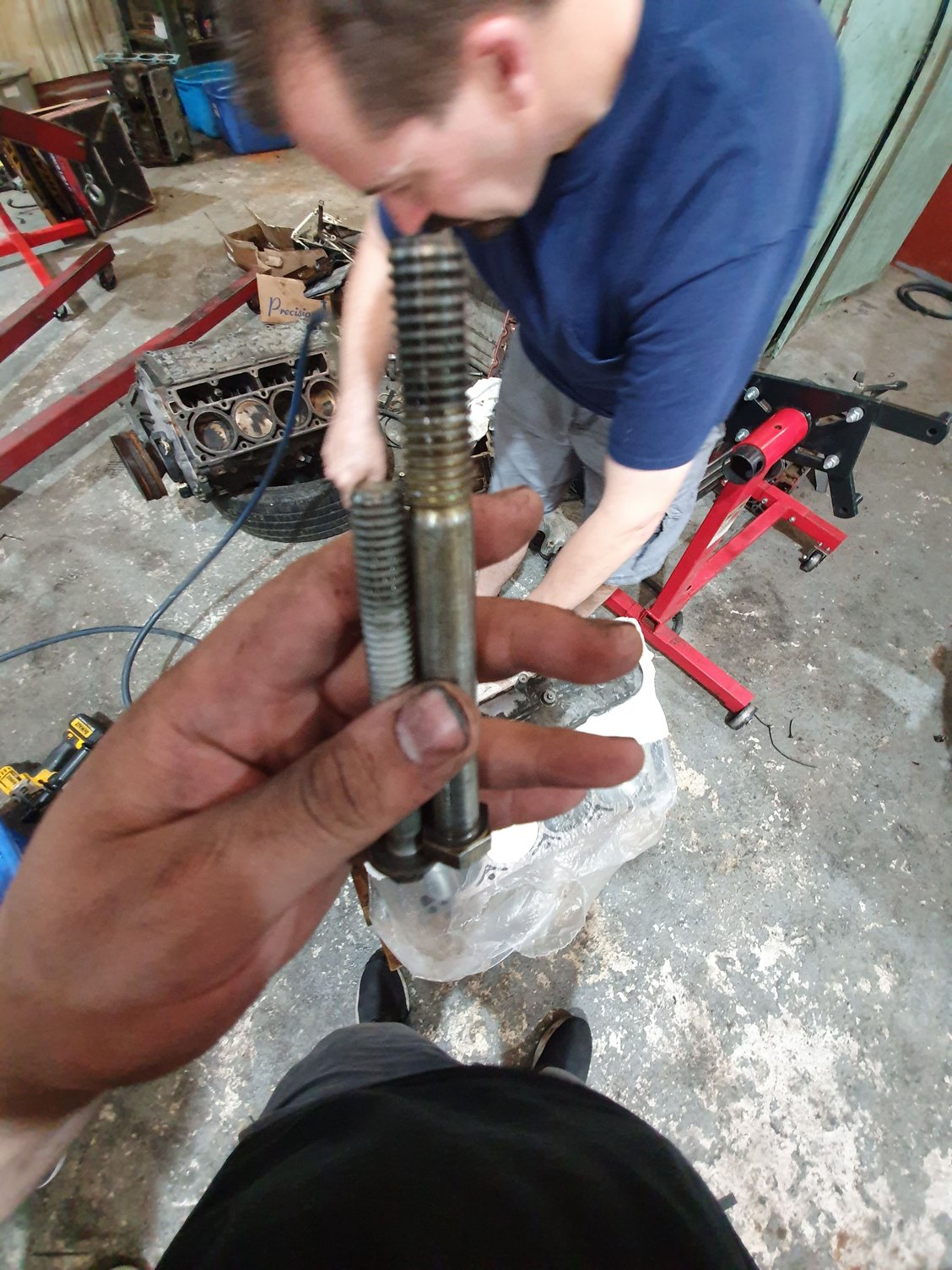

1/2" bolt vs standard bolt

a drill jig? what is this 1941? pretty slick set up Ryan!

Haha! The blocks are too big for the mill so I made a drill plate. It works awesome. 2 hours and done.

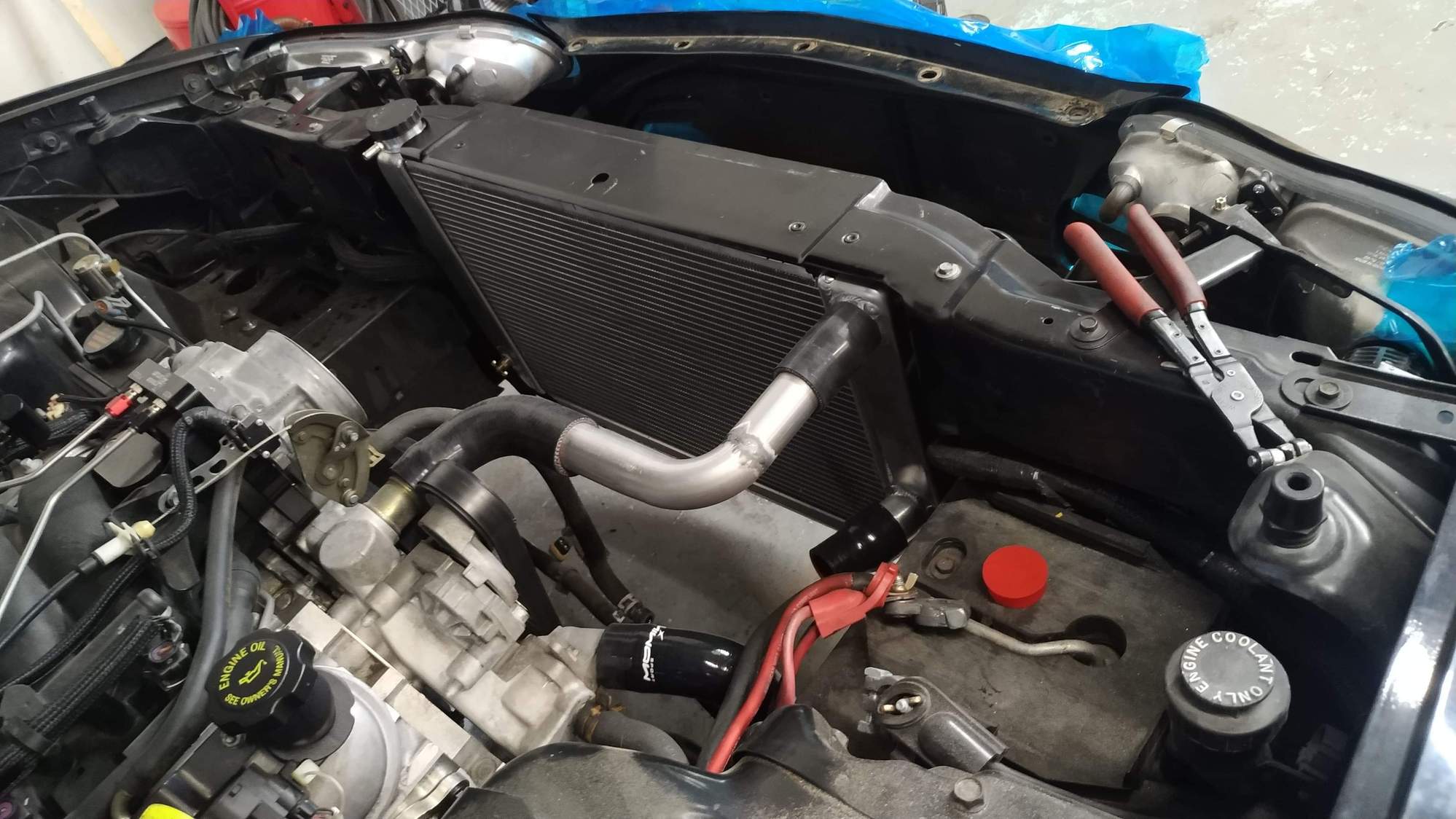

Radiator is in thanks to my friend michael page
