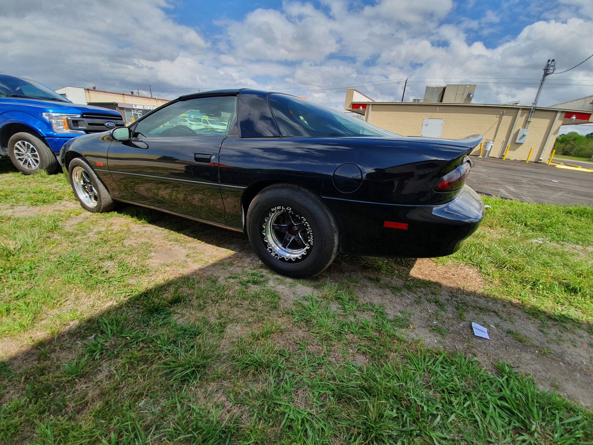

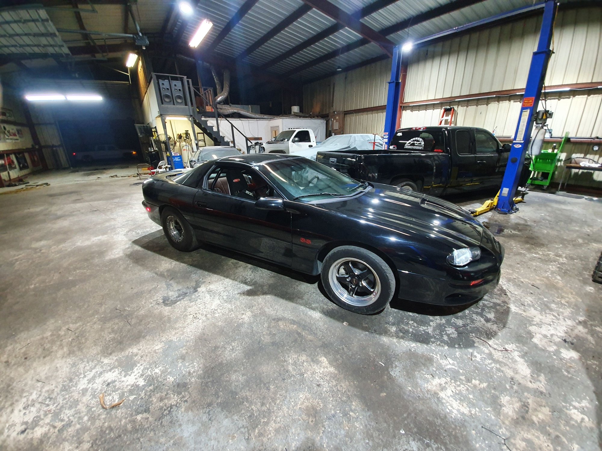

Just bought an 01 BLK SS with 60,000 miles! Ive always wanted one but every single one I would see was just clapped out.
The car was originally from Alaska, and has some nice parts!

This is the day that I got the car.

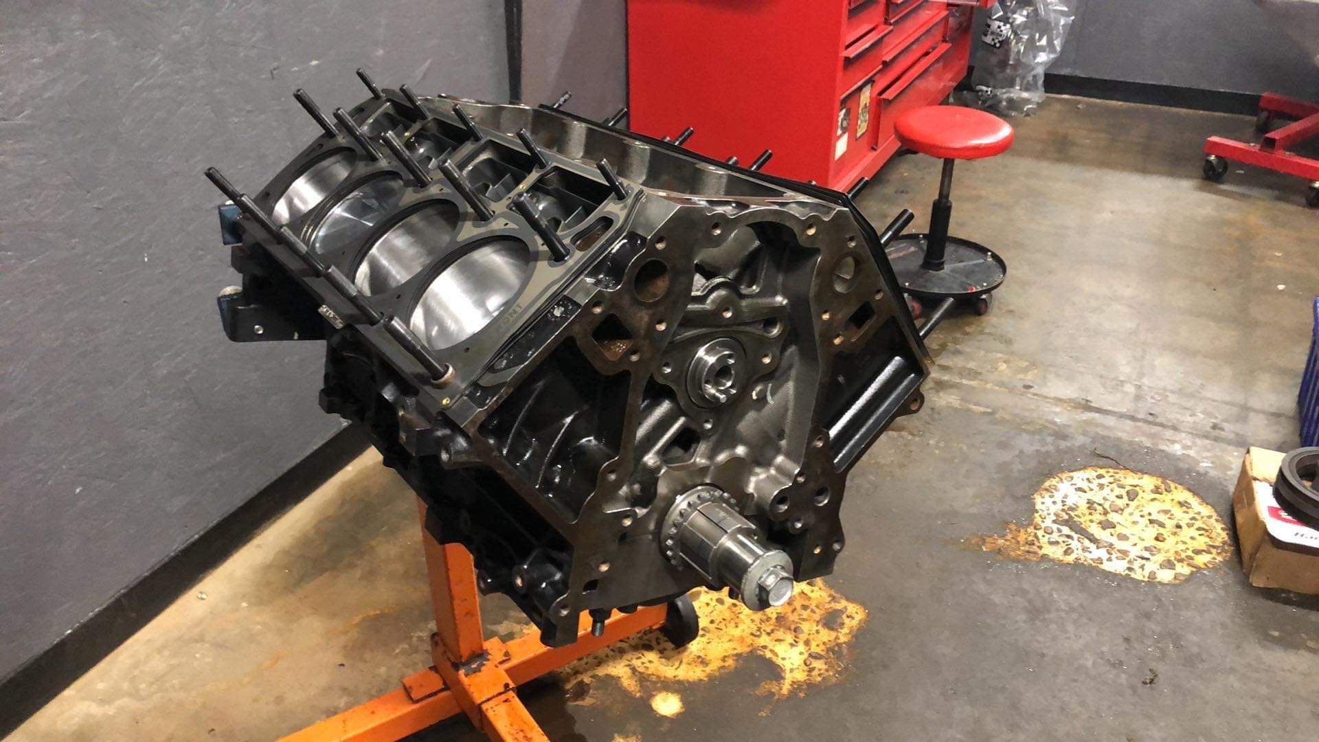

Got the guys at Ricks Machine shop here in Houston putting my 370 together.
I am using CP bullet pistons
China EPW rods
Factory GM crank

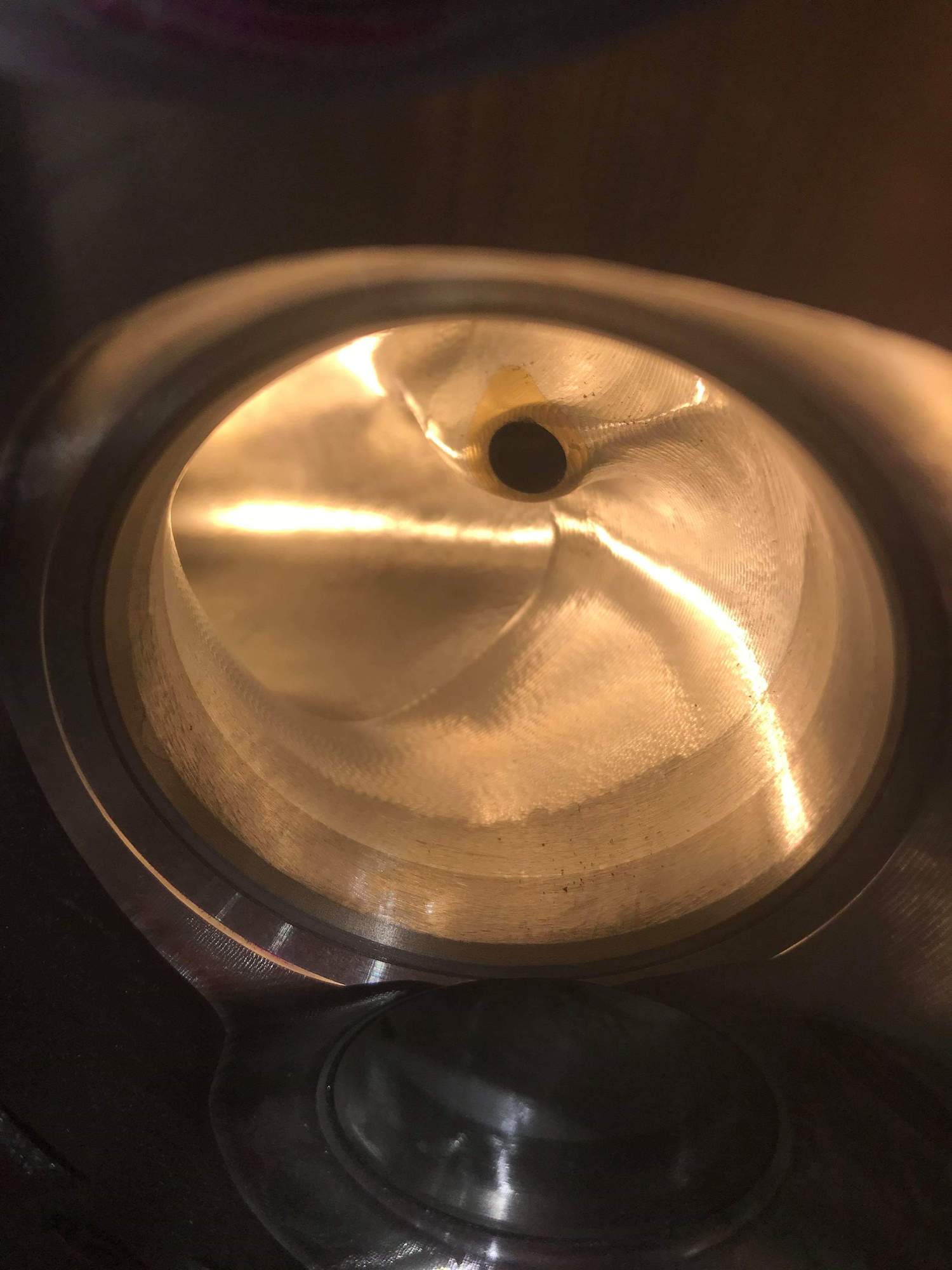

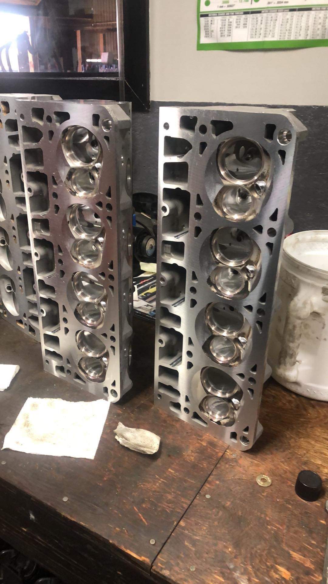

Still undecided on the heads, I have some worked LSA heads laying around somewhere so I may stick those in with some ca625s. I also might buy some TFS 235s. Not sure yet.

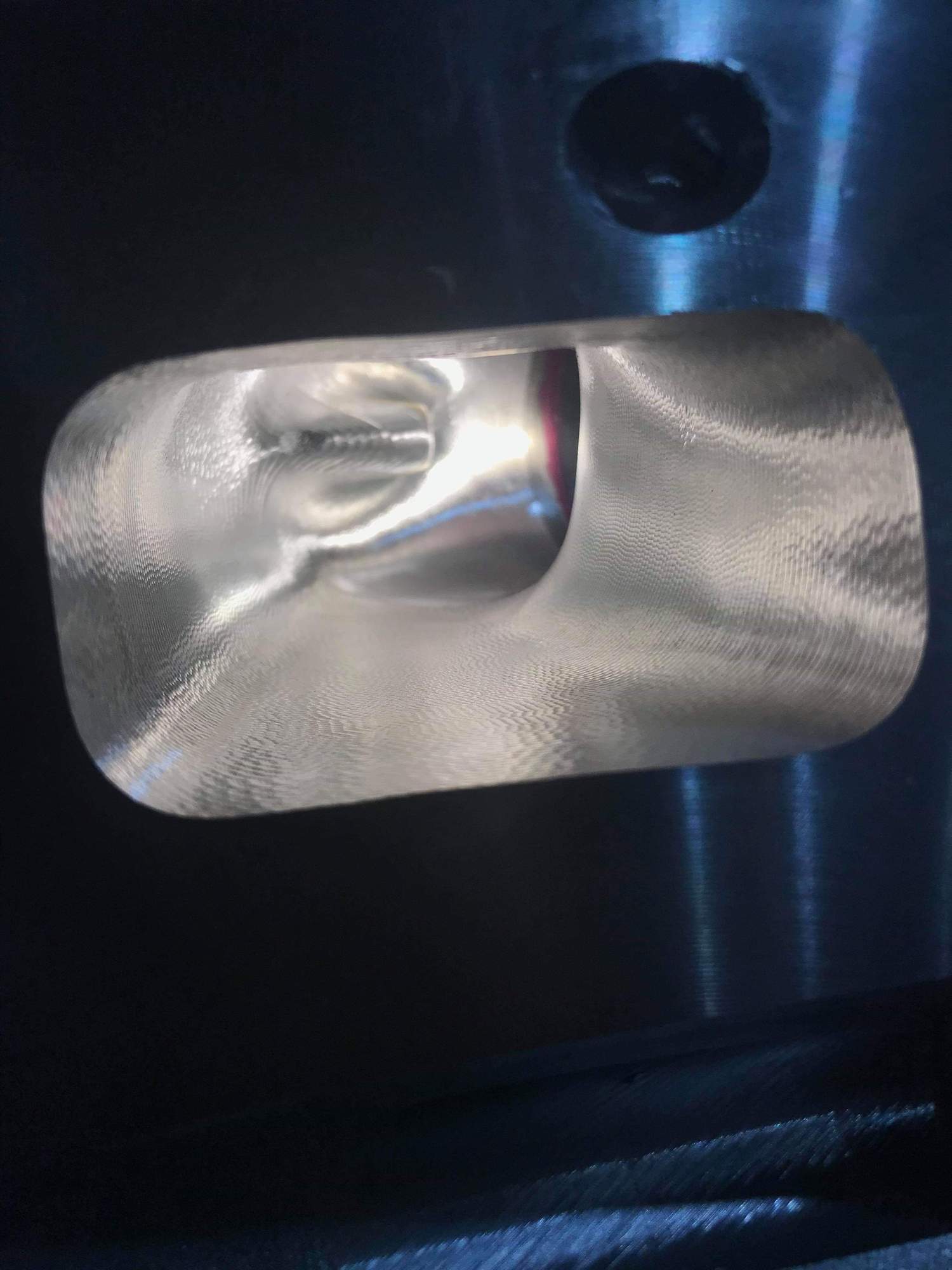

LSA head, bowl. Done by shawn hooper out of houston TX

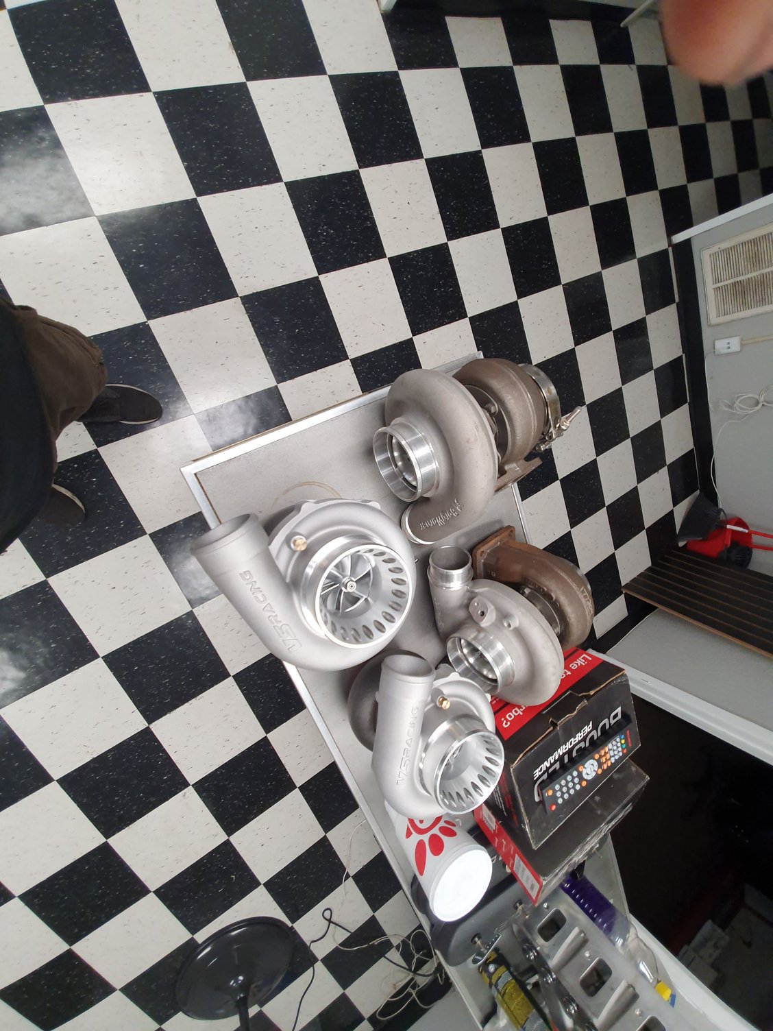

I purchased a twin turbo v3 kit from huron yesterday too with the bumper exit so cant wait for that to come in. I got several turbos laying around but recently found these s369s so probably going to run those. Seem to be regular out of the box sxe borgs.

Are you having the mains line honed?

What do we have here 🤔
And yea it was align honed, wasnt off by much however.

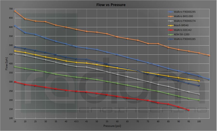

So after seeing how much of a **** show it was to run triple pumps on Mavns SOM, I have decided to stay with a dual pump setup. After some careful thinking, and some self motovation to not run a fuel cell, I decided I will experiment and try a new pump setup.
I plan on running dual 295 series pumps. They are essentially a 535 LPH variant of the 450 LPH.
Courtesy of Radium The 295 variant flows almost 100 liters more at 70 psi (target fuel pressure at 30 psi of boost).
An extra 200 lph will be almost equivalent to having 2 450 walbros and an extra 255 gss342 without the complicated wiring mess or the extra current draw. Not to mention the **** show in the fuel pump hanger.

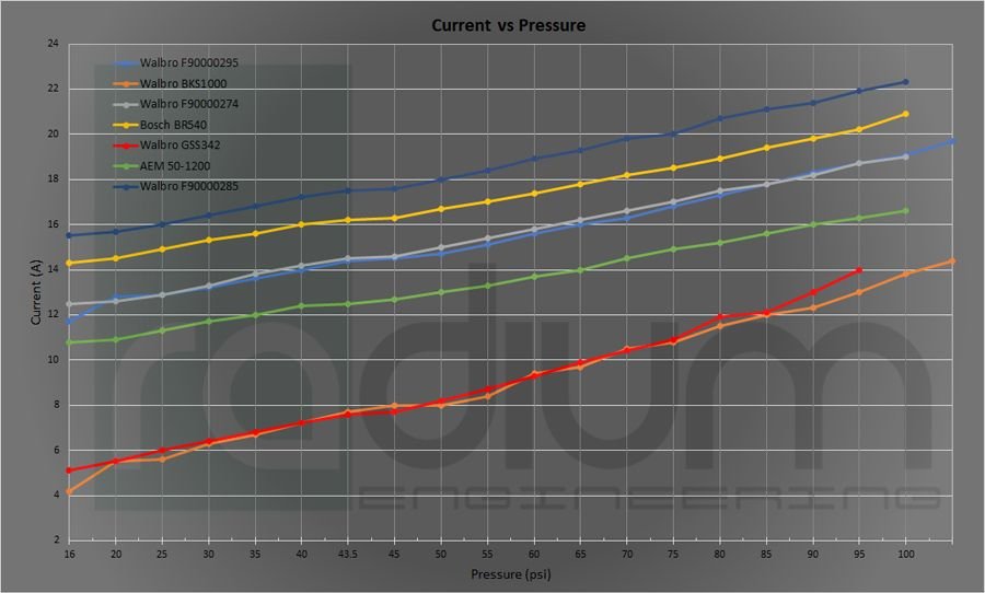

Another pro of going this route is the current draw.
Courtesy of Radium. The 295 variant slightly edges the 274 (450lph) variant by an amp or 2 at 70 psi, and over 3 compared to the 285 (525) variant.
This is always critical in an fbody with 2 ecus, a sound system, & derale pusher fans (these ******* draw so much when they turn on lol).
There is however a drawback 😂. All of this is possible because the 295 pump does not have a check valve. Flow is improved and of course the restriction is reduced, hence the lower amperage draw. For people trying to stage pumps, it will be impossible to run a setup like this. I plan on running both pumps at all times, and priming wont be a problem as i wont be limited by the 1 second prime timer offered by the factory ecu. With holley i can set the prime time to whatever I wish.
Lets hope this setup works however.

So once i get the engine back ill have ryan (badass68) come to the shop and do the 1/2" stud conversion for the block. I decided to splurge and buy the PRC 6 bolt as cast 250cc. I also got a free cam! They decided to sponsor me a bit with other stuff too I'll show you guys once its here.
