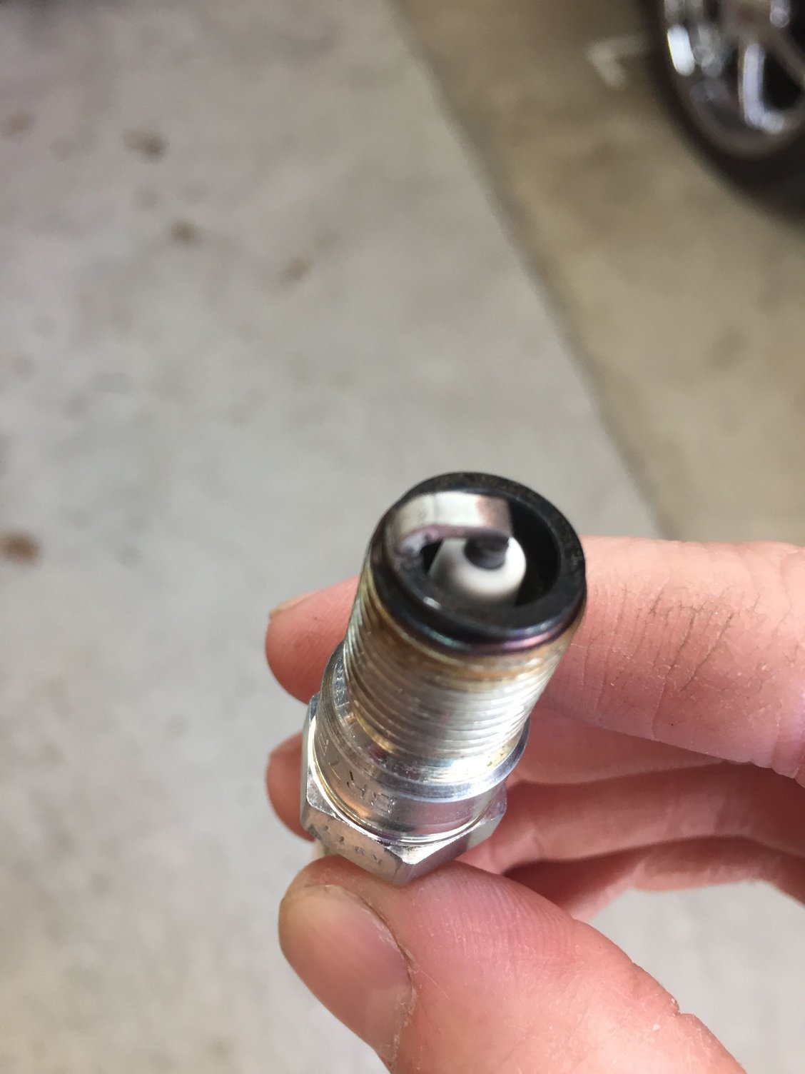

#7 hole 16 psi 10.5 to 1 static compression 11.5 AFR on the gas scale 17.5 degrees peak timing 50 percent Ethanol.
Old Apr 24, 2020 | 11:37 AM
rel3rd's Avatar
iTrader: (43)
Joined: Nov 2005
Posts: 2,874
Likes: 314
From: Baltimore County, MD.
And #7, that's the "bad" hole, right?
