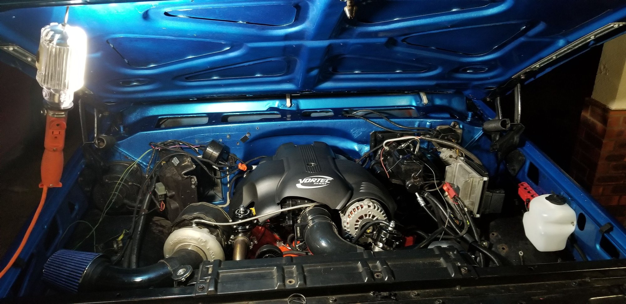

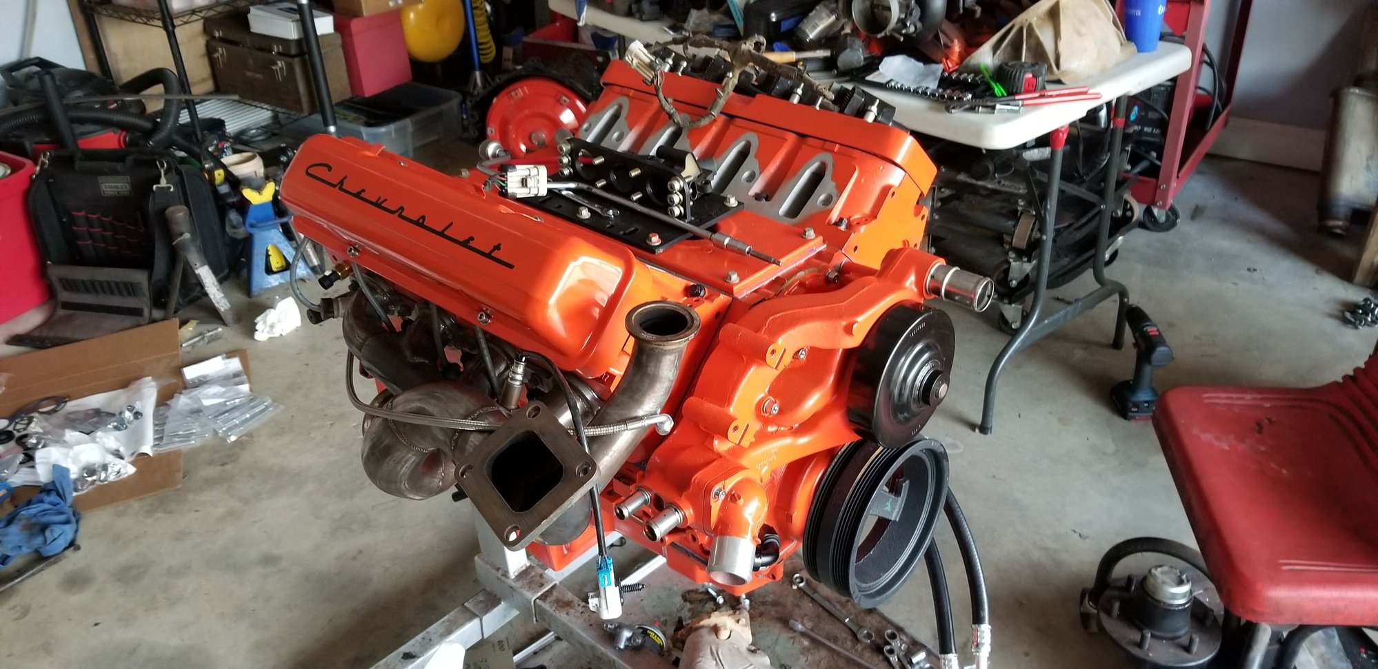

6# spring. This is an On3 kit originally for a 99-06 Silverado. WG placement appears to be good but not perfect(90 degrees to the exhaust entry into the turbo). I'll try to post a pic.
It spools instantly. I wanted it to come on early but this may be too early. This 66mm turbo is really the only deviation from a lot of tried and true recipes.

The wastegate placement looks terrible in that picture. It wouldnt get much flow to it at all if it 90*s off of the main log feeding the turbo

The wastegate tube is the tube going up towards the engine? That's doesn't look like good placement at all. You want it I'm the path of exhaust flow. Maybe it's just from the angle.

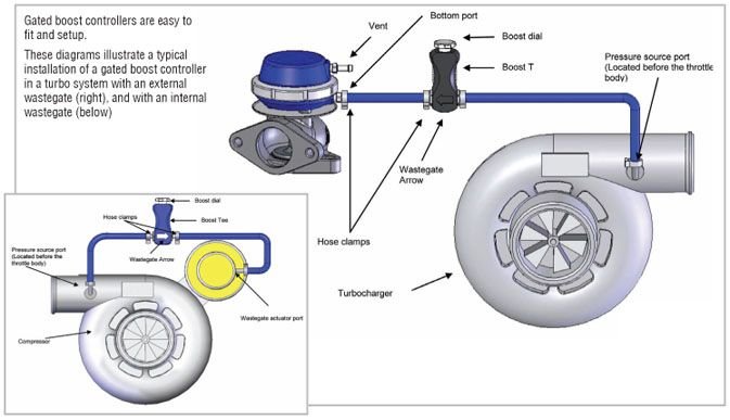

90 degrees to the flow (maybe a little less, the truck isnt here) then turns up to the location in the pic. Wastegate/Boost controller plumbing is like in this diagram. It's been double checked.

1) 90 degrees off a hotside is lousy for WG mounting. I'd be more concerned about the angle than the size of the gate.
2)forget the controller. Run the vacuum line from the turbo to the side port of the WG directly. Start with this and see is boost is more controllable.

Finished pic.
You can see how the wastegate piping comes off the main in this pic.

Yes the wastegate placement is terrible on that kit. Adding a second wastegate or moving it to the front of the log will help fix the issue

No surprise you're having trouble controlling boost. Get the controller out of there first of all and run spring only. If that doesn't fix it then you'll have to fix the wastegate tube regardless of staying the same size or stepping up in WG size.

Gate takeoff doesn't look that bad at all. But yes, just throw a larger gate onto it, it's by far the easiest option.
