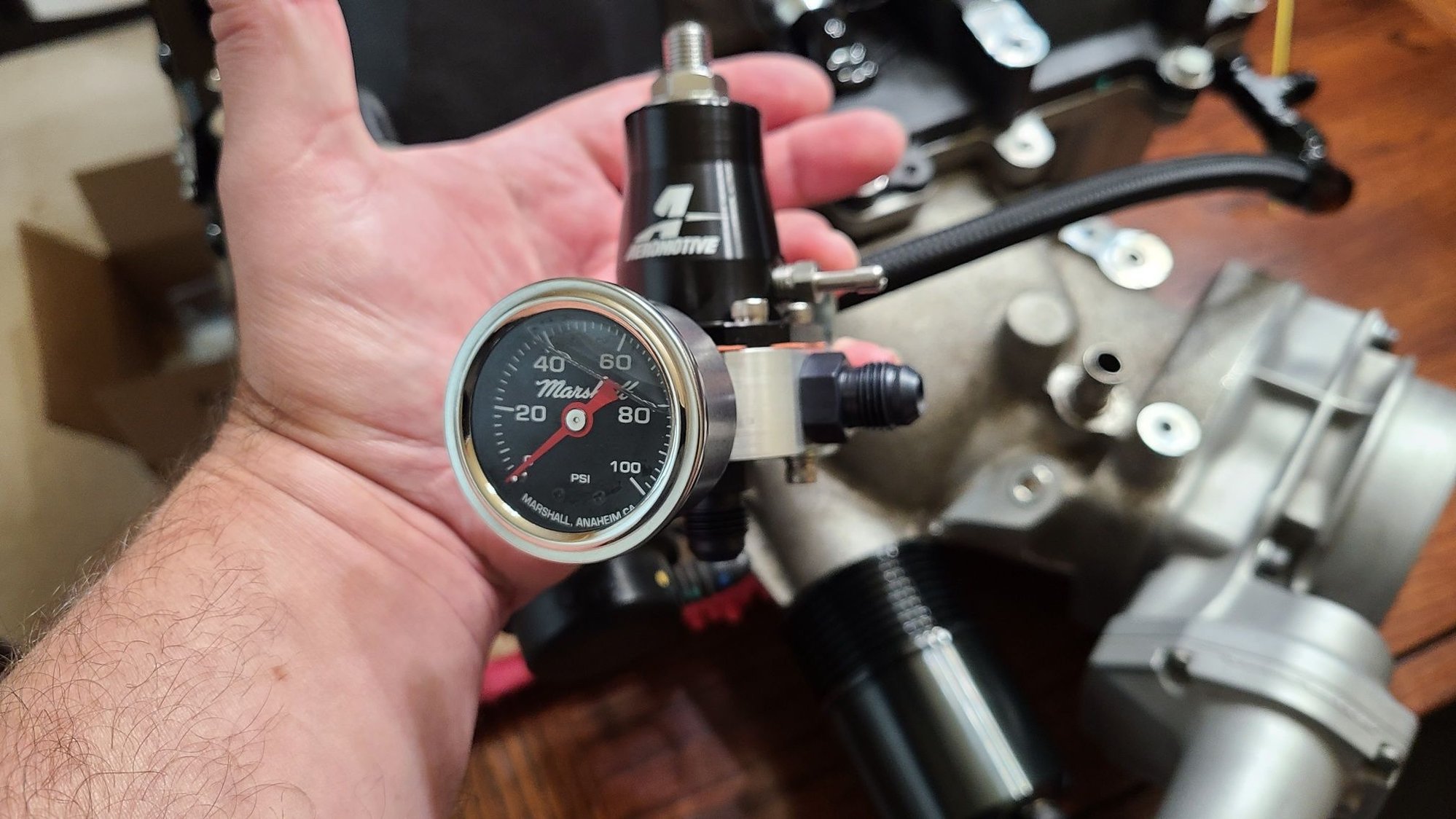

I need to figure out what I am going to do for a regulator. I was leaning towards the Aeromotive 13129 but now I am contemplating using one of the Chinese copies just for the sake of keeping this budget friendly low buck boost. That being said, I will not sacrifice reliability for being cheap.

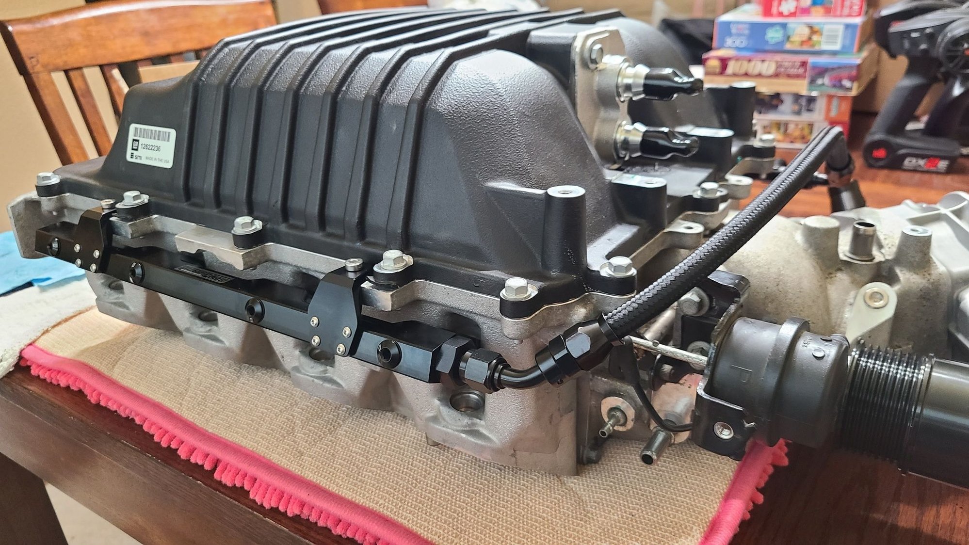

Partially assembled my fuel rails today. Gonna be a little tricky making a decent looking crossover hose. Ordered 325 bucks in PTFE hose, fittings, plugs, and an Aeromotive regulator, gauge and injector connector adapters. Still well withing budget. Especially if I go with the SEP injectors.

I really like those rails the more I see them on there. Maybe I’ll upgrade! The sep injectors are definitely the budget way to go. This is going to be a blast! Almost there.

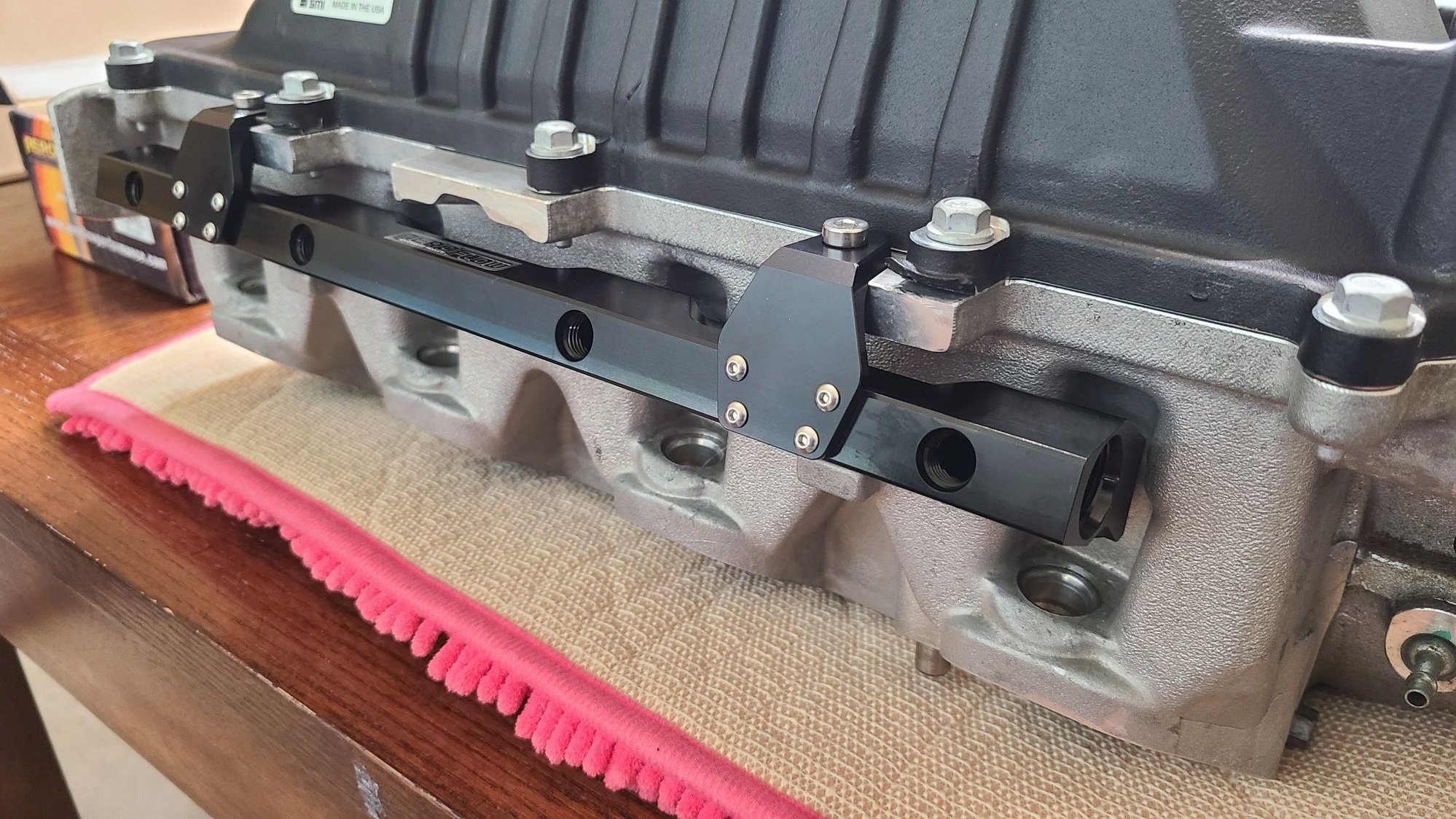

More fuel rail goodness for swapstang.

Haha it’s like billet fuel rail ****. The gratuitous rail shots. Looks awesome I think you’ve convinced me to upgrade. When I install my flex fuel sensor I’ll probably do it. Did you look into the MAP sensor conversion harness I mentioned? Unless you’re ok with cutting the plug off your old one. I only did this so I could convert back. Also, is your intercooler brick reinforced?
