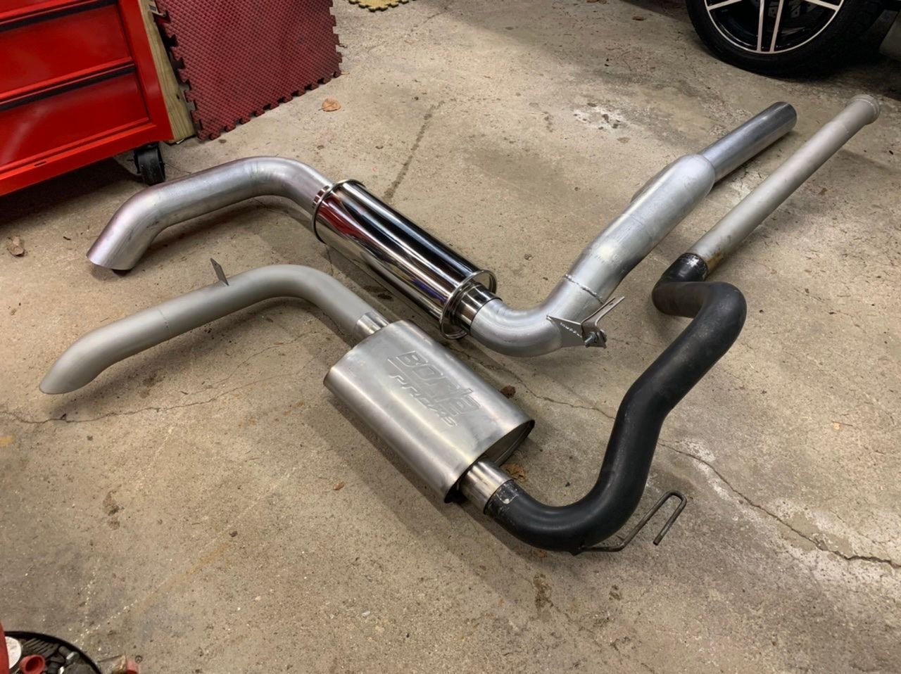

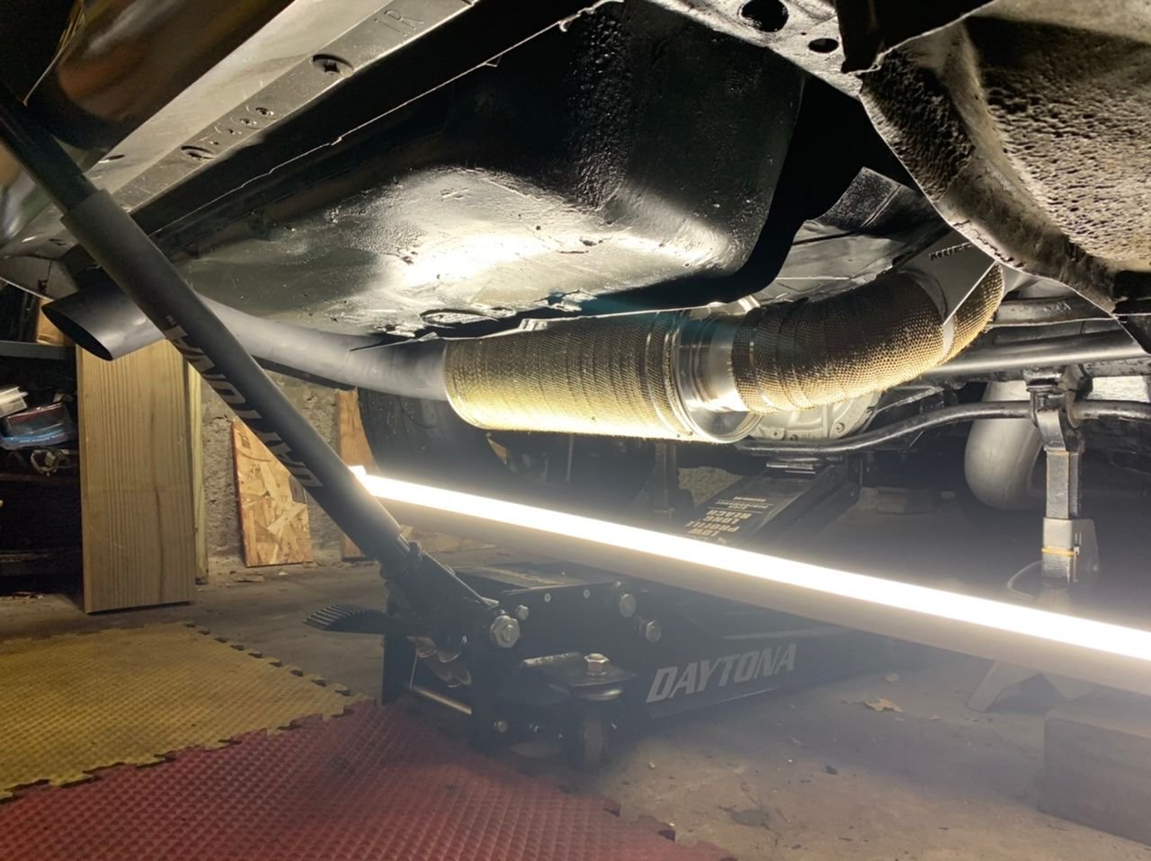

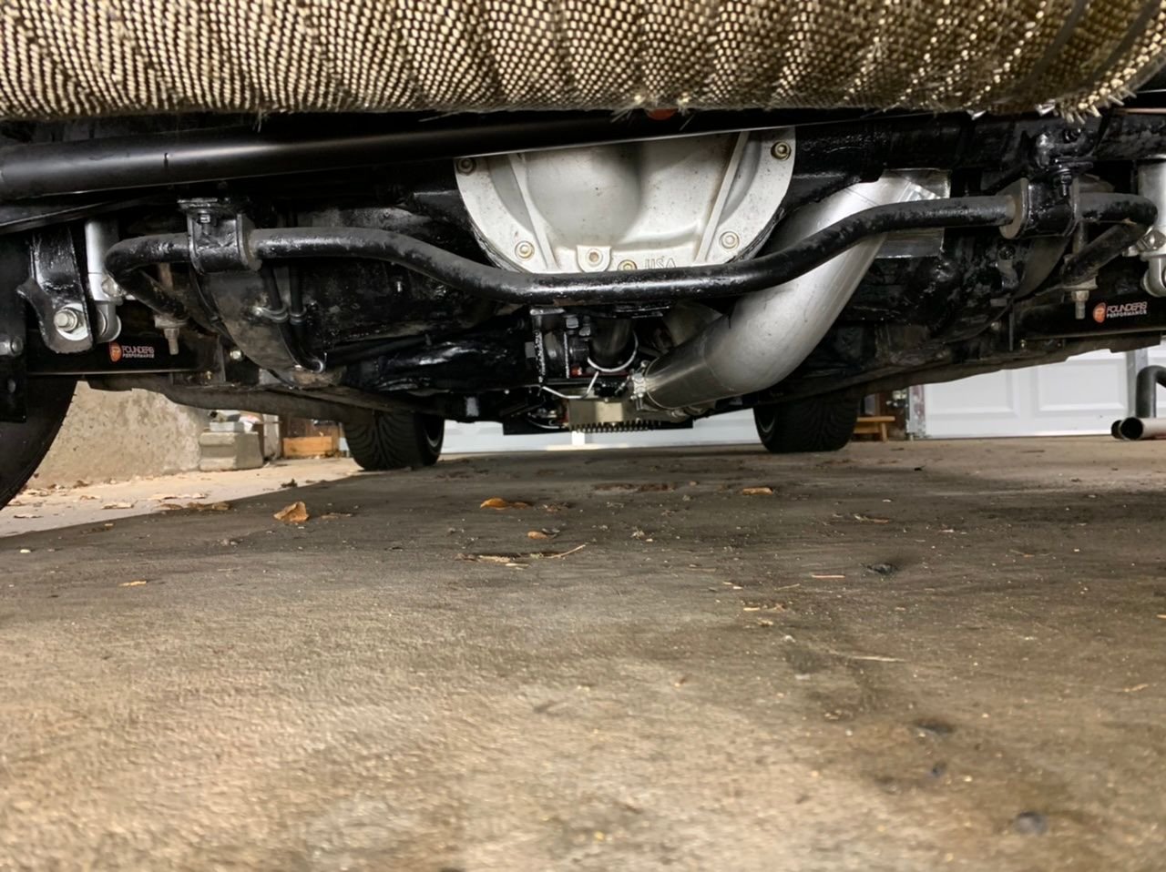

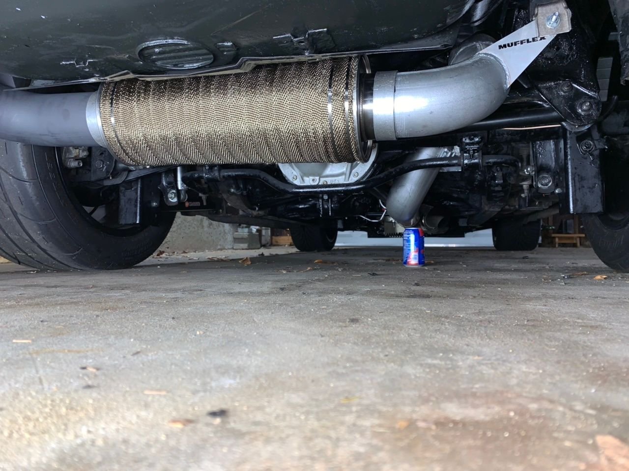

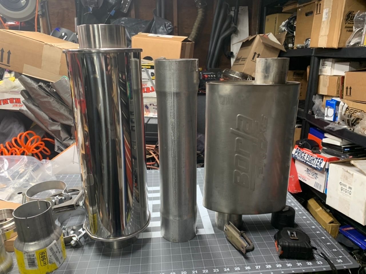

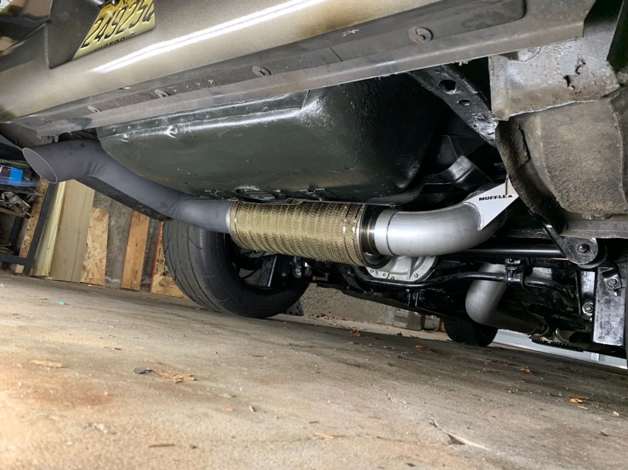

Got a vibrant 4” inlet 18” x7” round case @22” total length. Got my 4” sinister exhausts yesterday and installed it last night. They use mufflex parts apparently but it fit the stock PHB support and I got lots of ground clearance. Hoping to start the car today to hear it but the 7” muffler fit no problem and has a gap between it and the gas tank hest
shield. Hope it helps with taming the sound.

Started it up and shocked by how quiet it still is. Here are some videos
here is the before video with the borla proXS muffler idling.
here is the after video with the 4” catback
Driving the car down the highway with 4” catback
honestly I took the car out for a drive and the car is much quieter than I thought. It’s louder than the borla 3” but not as loud as I was expecting. I was able to get alittle more turbo spool through the full exhaust but still nothing compared to what the cutout provides. Overall the car is still pretty quiet and I can cruise down the road with the windows down and not hear the exhaust much. Depending on how I feel I can always do a muffler delete or put something smaller in

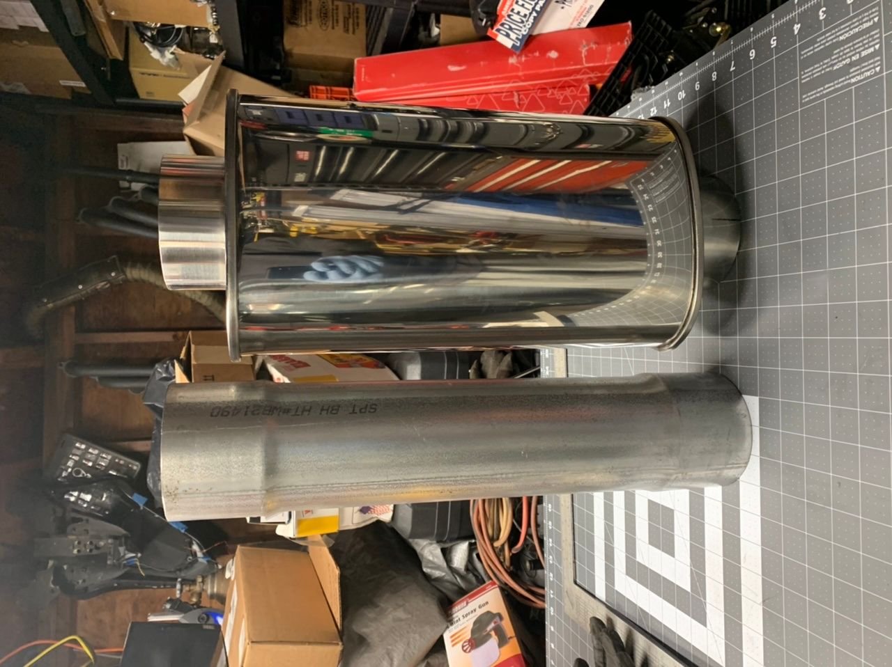

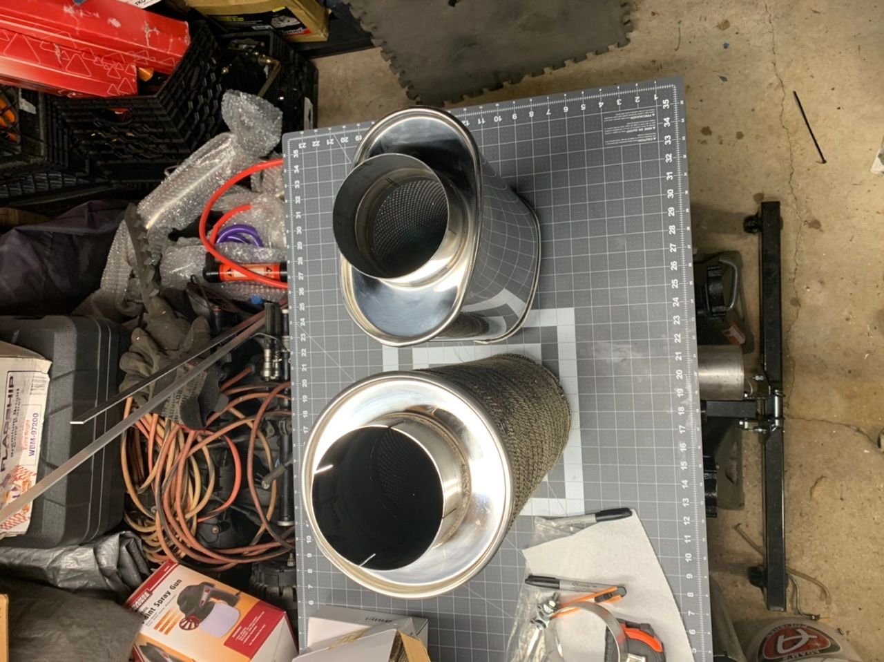

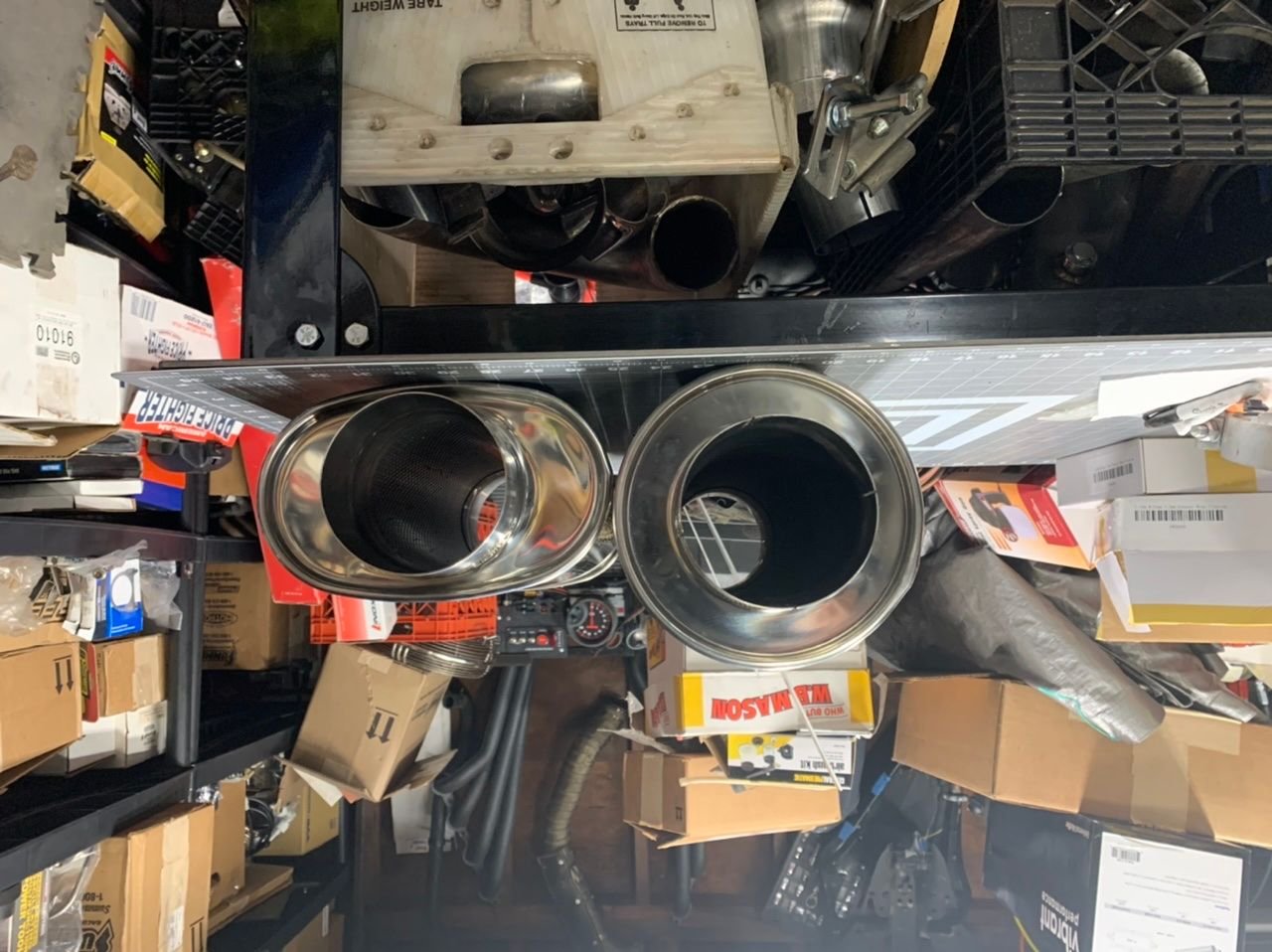

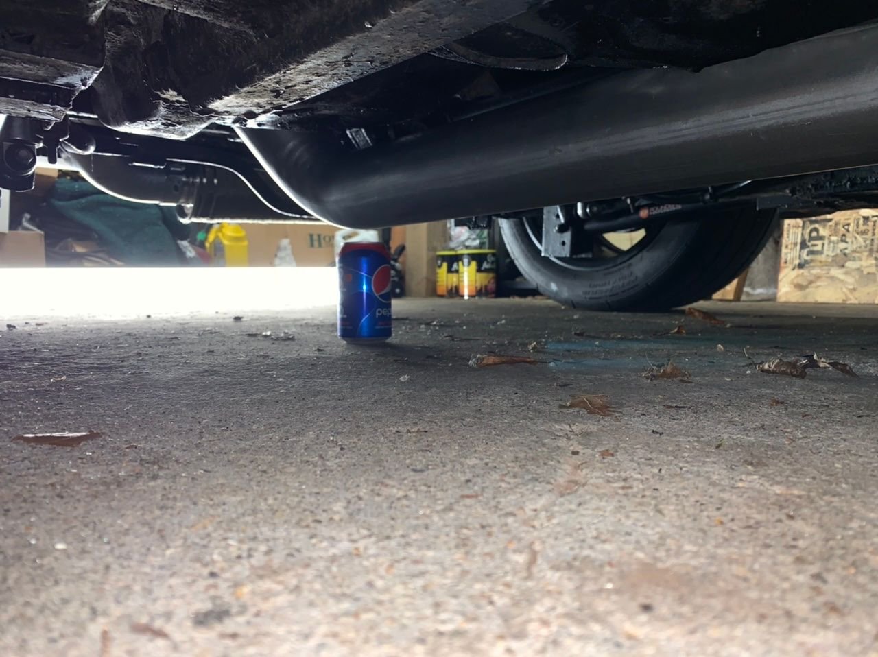

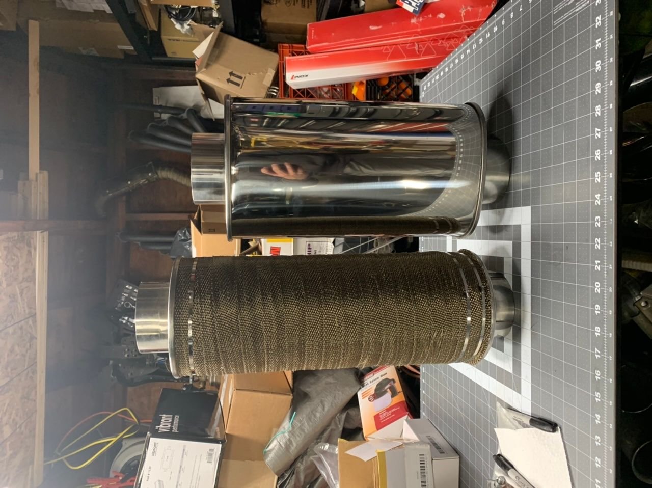

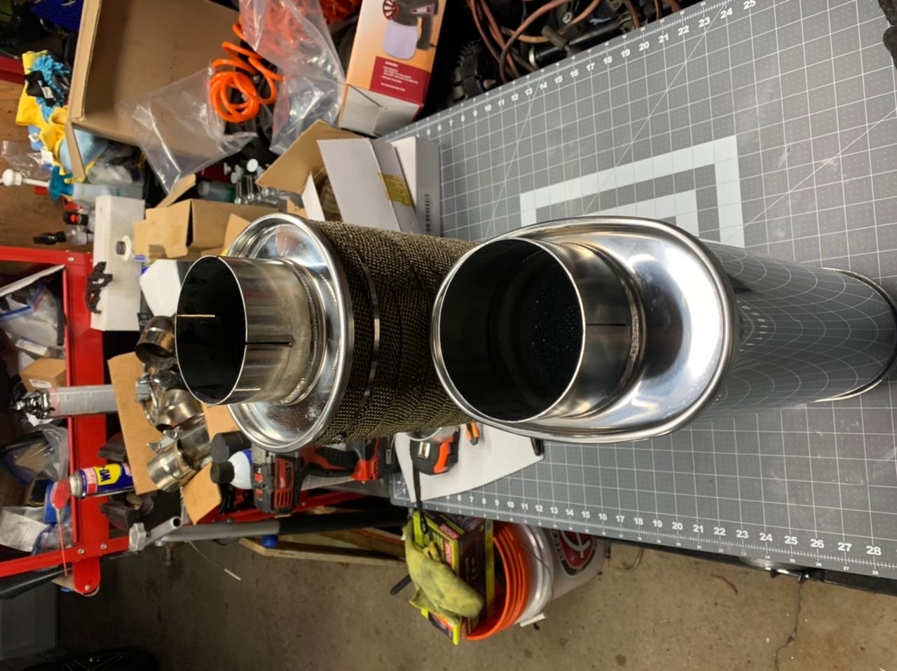

for those of you wondering my smaller oval case vibrant randomly shipped 3 weeks early from Jegs and arrive today. It’s a 5x9x15 case with 20” tota
length however it’s really 5.5”x9”x15” and a 19”
overall length. The way I fabbed the exhaust it fits the 22” long 7” DIA round muffler better after test fitting tonight. The smaller vibrant is a direct swap for the Hawks muffler delete pipe (same 19” length) and it’s a good bit cheaper than the maggy. The 7” round only hangs .75” lower than the oval so im fine with that and its not lower than my rear. I did not like how much gap is above the oval muffler than the heat shield... almost wished I could tuck the over axle pipe up higher and if I could then I would run the oval smaller muffler. I def picked up power over the 3” catback and got alittle more turbo whine but still
nothing compared to the cutout being open. got nothing bad to say with this hawks/mufflex catback, lots of ground clearance and great fitment.
