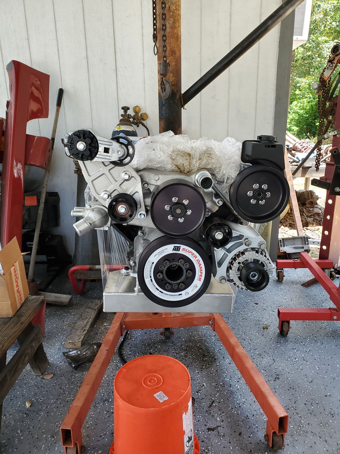

Picture of it all installed. If you're wanting to run the ati 10 rib setup this belt works great with OEM LS3 accessories Dayco 5100994
what size is your damper? Sweet setup. I’ll be switching over to single belt 10 rib drive soon when I swap out for more cubes. Currently running forged 6.2 with LSA drive but no AC.

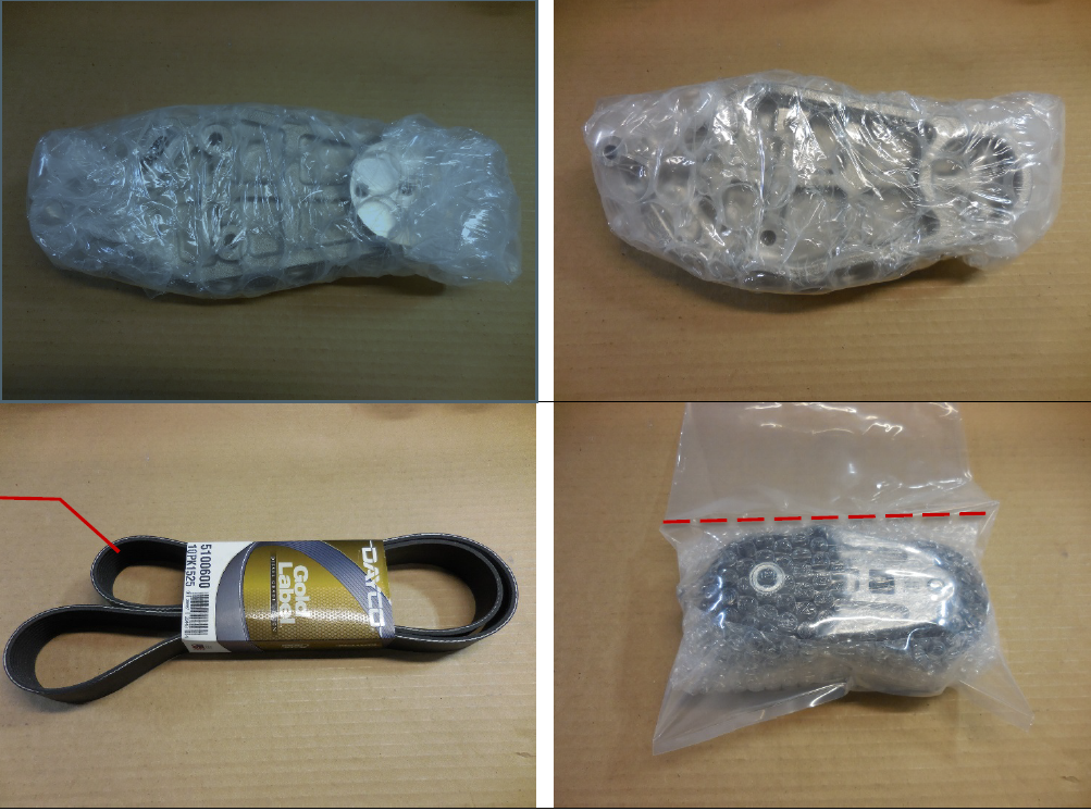

magnuson actually makes all the copo camaro supercharger parts if its a copo with the Maggie tvs2650 on it. I called them up and they sent me the tensioner, tensioner bracket, idler, and bolts for the tensioner bracket for around $600. You just call them and tell them you need a tensioner setup for a copo camaro with the tvs2650 on it.
Old Aug 26, 2020 | 10:22 PM
masonS13's Avatar
Joined: Mar 2013
Posts: 127
This is everything they sent me. The belt they send will not work if you're running an alternator or power steering.
im running the ati 8.19" 6% OD LS3 camaro damper.
