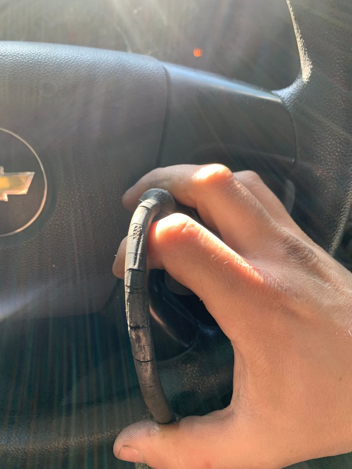

4 days ago I leave my buddy’s house, clutch kicked first gear and boosted who knows what lol. Should’ve been the 14psi spring though. Anyways, I melted 3 plug wires cause they were resting on exhaust manifolds. Limped car home.

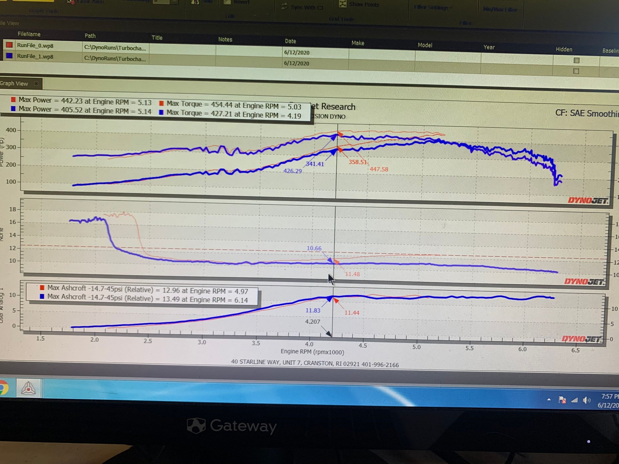

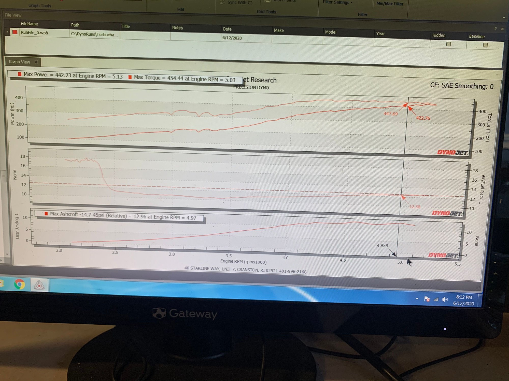

So my tuner is busy for few weeks so I put car on dyno for 2 pulls last night to confirm my sputter I was feeling is not my setup but something fixable in the tune. I have a cruise next weekend for my best friend who died years back. So I wanted to make sure I can drive car next weekend without issues... here is results. The feeling I’ve had is just a bunch of gas.
This first run was locked regulator at 48psi, I let off cause started to lean out at 12.3 air fuel. This was not how it’s been driving.
This next pic is how cars been driving. 48psi regulator with boost line added.
Never been so anxious waiting for something. Need it tuned so bad.

that was before I realized where it was at other night... last time I put it on dyno the swap was brand new and had no exhaust etc. now car is tune ready but I put on dyno to be 100% an issue I was chasing was tune related after playing with melted plug wires and wastegate issues.
now I know where I am with tune and I know the swap isn’t at fault. No reason to bring car for tune if I have other issues.

Most widebands stop at 10.0 so you have no idea how rich you were. Breaking up in boost with an AFR that rich isn't surprising.

The street loads it differently than a dyno. It puts the load cells in a different spot on the fuel map. When you had the stiffer springs you were at more boost, and likely the tune wasn't as rich at that boost level, so it didn't break up. So when you put lighter springs in it lowered the boost to a point on the map that was much to rich and broke up. When you went to the dyno again, it still wasn't in the same load cell area as it would be on the street, so it's not going to act the same on the road once it comes off the dyno. If the AFR is ever reading 10.0, just stop and have the car tuned. No reason to flog on it, it won't get better.
