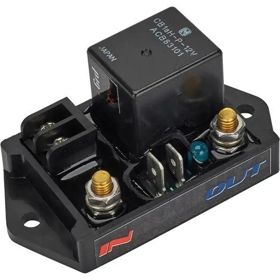

I have been using a Leash single relay for the fan. I'm not recalling if I used 8 gauge, I might have. I'll let you know what Jay ends up doing.

That looks like a quality piece, have you checked the current draw on your fan ? I think you mentioned it's an aftermarket version?
