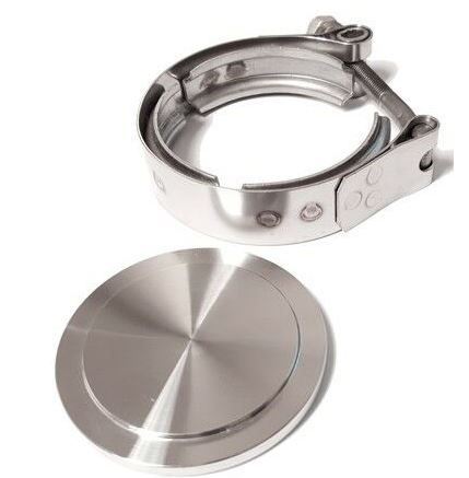

Probably making 600+ easy with a 427 NA. .96's aren't too large IMO. I was seeing similar spool times as him with a 8.9:1 5.3 on twin 72/68's. w .9x hotsides. I'd think a healthy 427 would light those off at 2-3k easy!
Are your wastegates and BOV "v-band? You can buy Vband block off's semi cheap on ebay. I'd get a set. Start with the BOV because it's easiest. Then block the WG's.
Have you tried simply adding more spring to the gate and BOV? Don't those units usually come with additional springs? Lets see some pictures of the WG and BOV.

I'll get some pics when I get home. I did put a larger spring in the BOV, I'll test drive when I get home.
