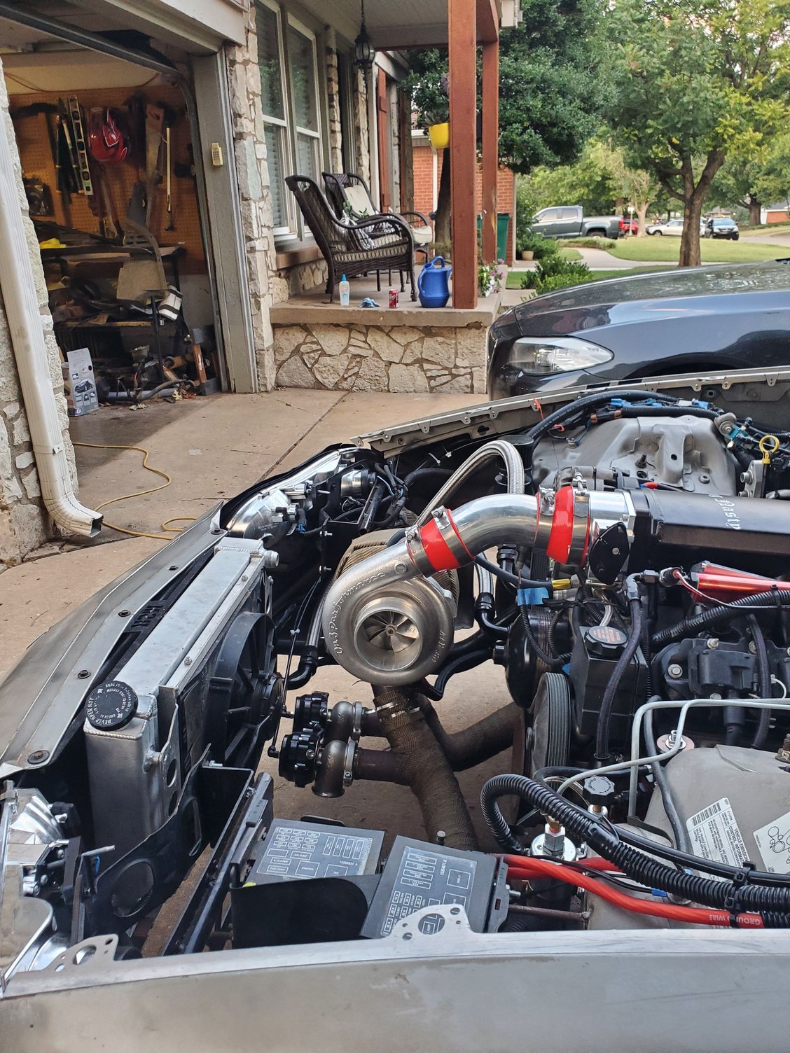

Turbo ls1 having issues with breaking up right when it sees boost. 3500rpm is all I get and itv sounds like a 2 step.... which I don't have. Twin 450 lph pumps, 1000cc injectors, all new as well as coil packs and even tried replacing all 8 br7 plugs gaped at 25 thou. Any ideas??? Stock ecu. Afrs are good on wide band. Now I'm not the tuner so I can't answer alot of the specifics on the tune, just mainly asking if anybody has experienced anything close to this. It runs like a beast to 3500rpm!
